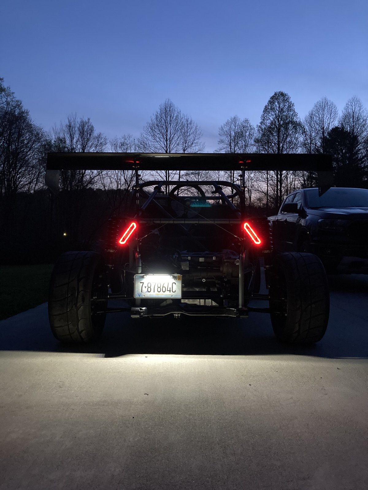

I was pleasantly surprise when I saw this today! @GoblinGal

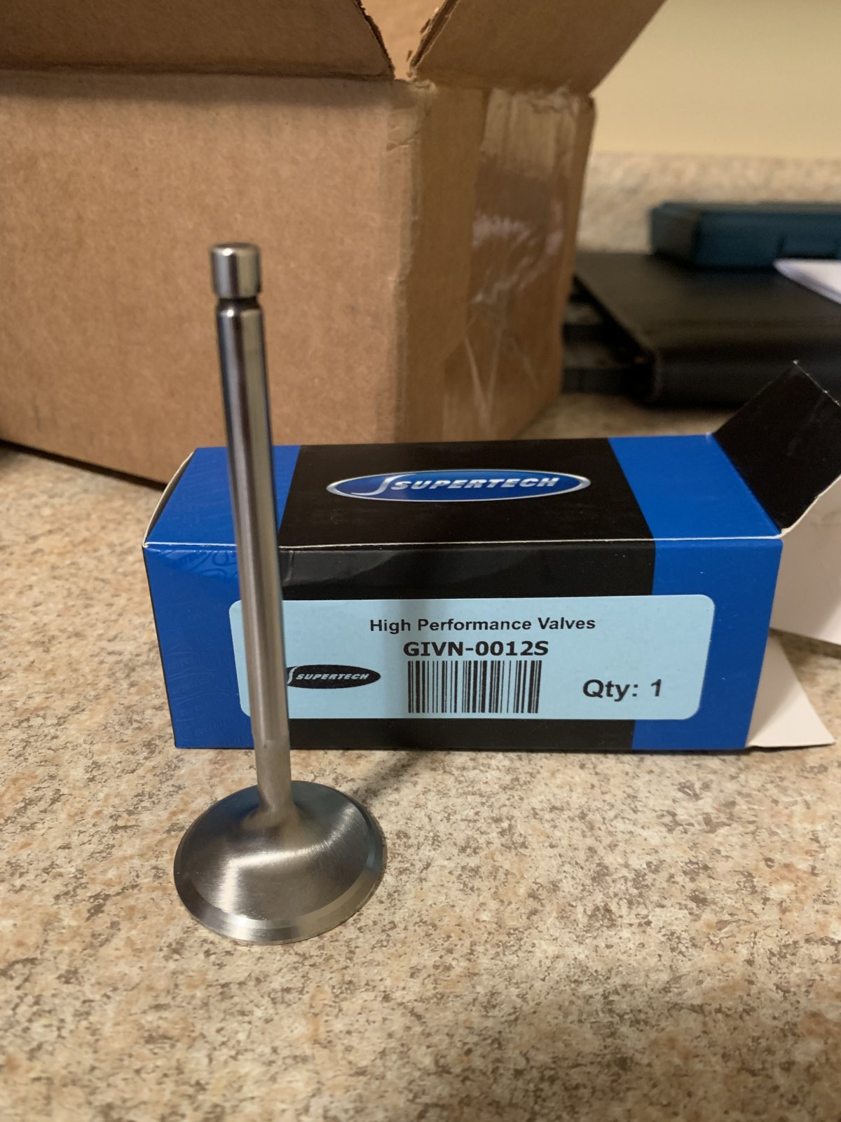

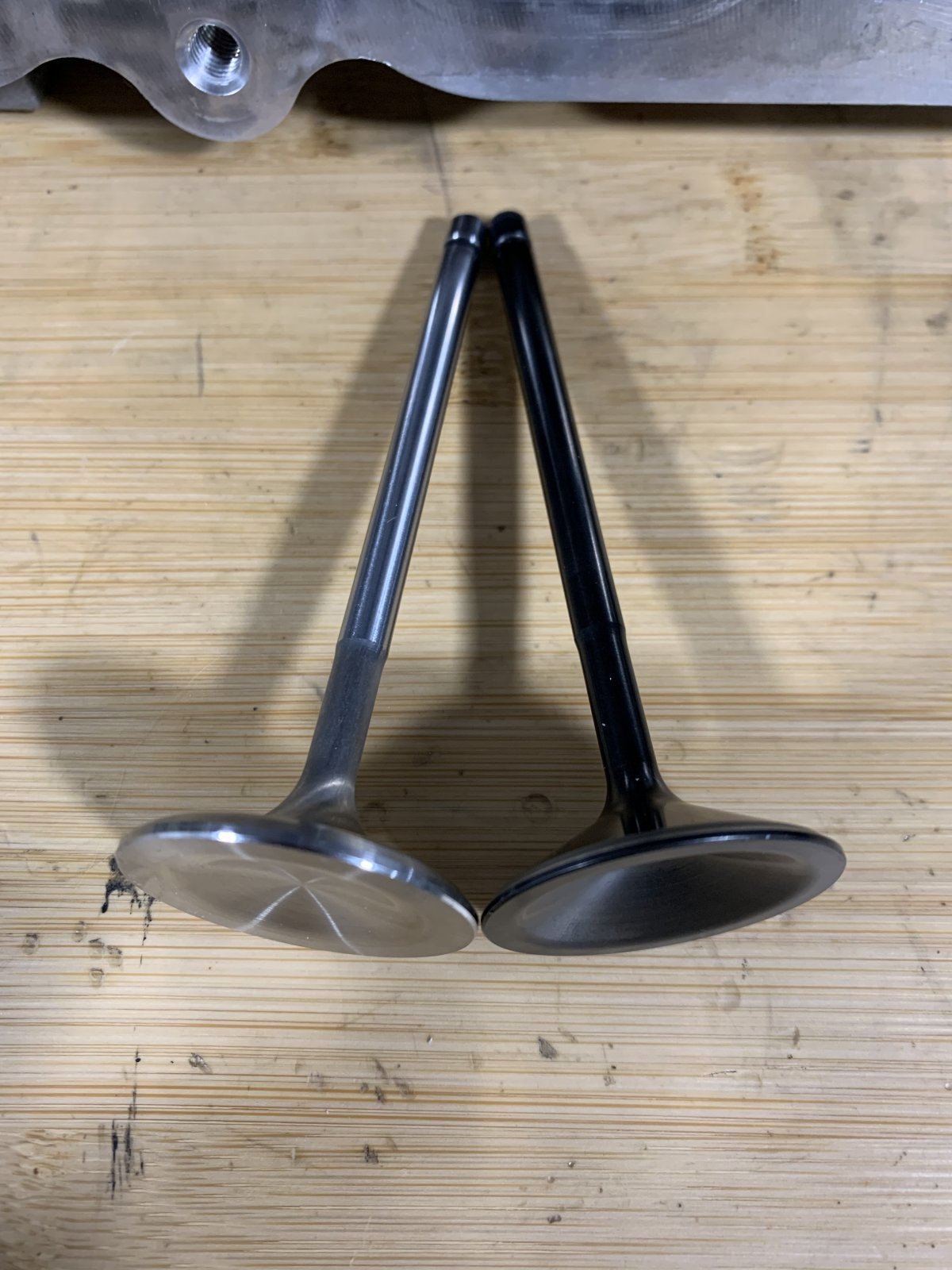

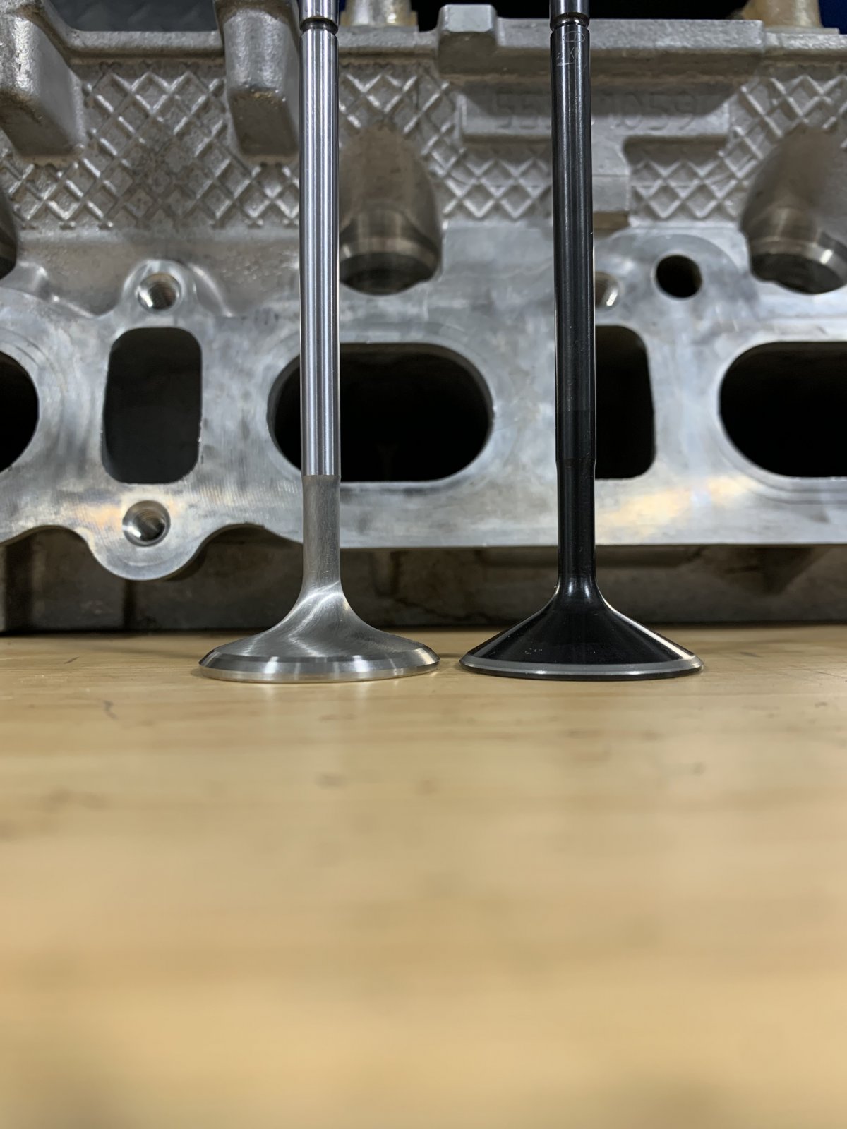

Here is a quick ho-hum summary on what has transpired over the last month.
Valve arrives March 11th. Said valve was unwrapped and dimensionally correct but obviously different (See attachments). Retailer offers to exchange with a 3 month lead time. SuperTech offers to exchange the valve free of charge so that I have 8 matching intake valves with a 1 week lead time. Valve for exchange arrives at SuperTech March 23rd. March 30th, SuperTech states that the valve shows signs of being lapped and installed, so the exchange is invalid, but will contact me once they have a valve made and reach to ship.

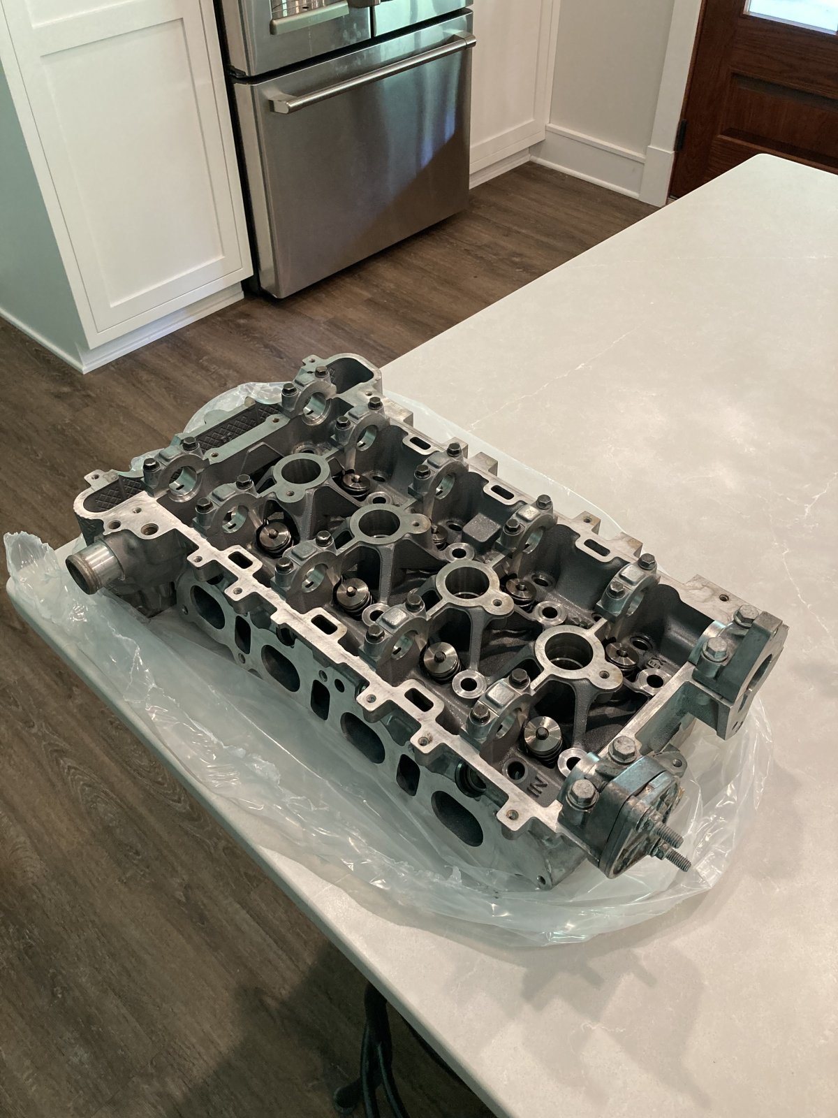

I did take the head, seals, retainers, springs, keepers, and exhaust valves to the machine shop. The head has been decked and the oversized exhaust valves are installed.
We are just in a holding pattern until I have a complete set of intake valves...

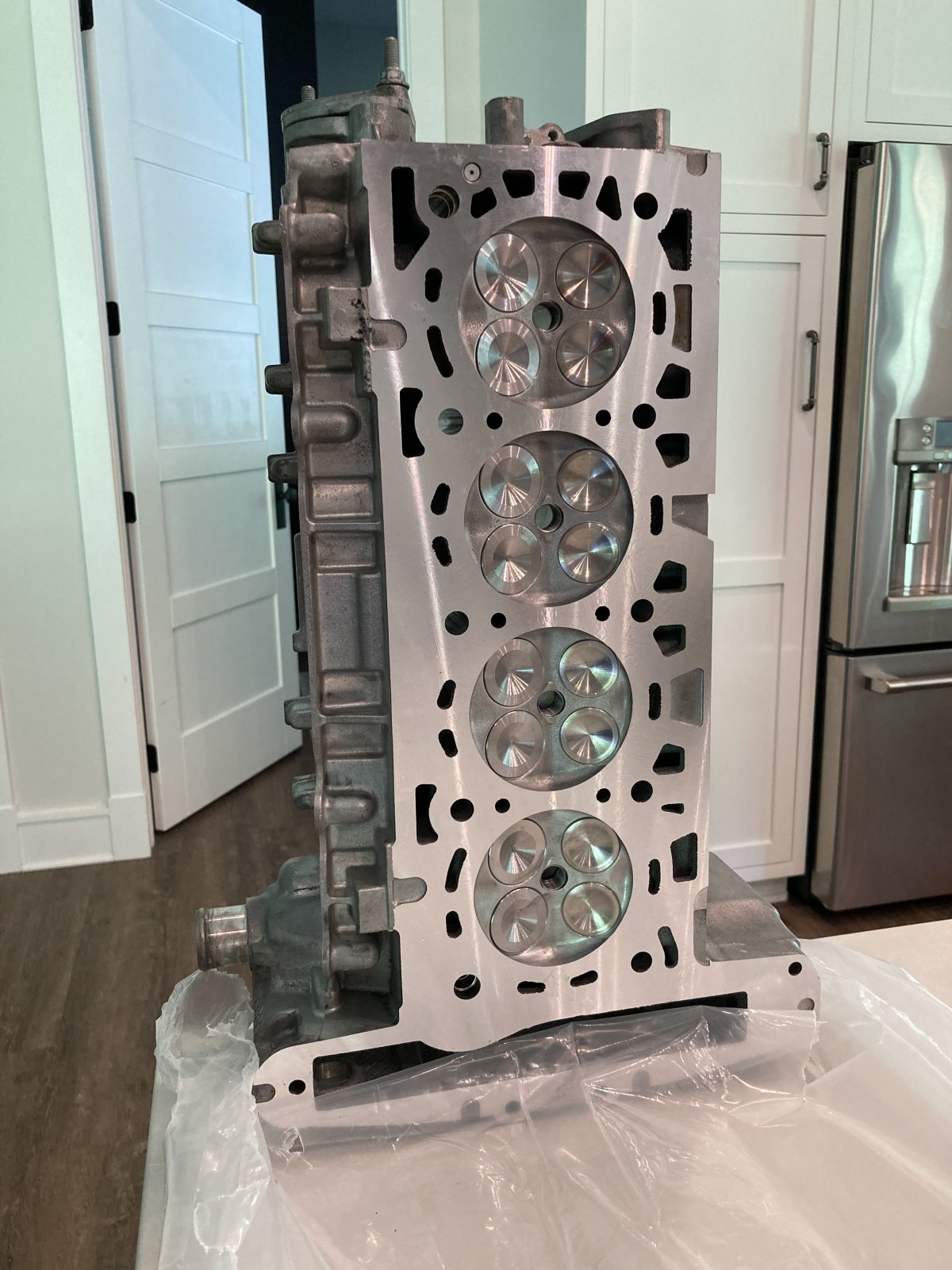

Lechlis

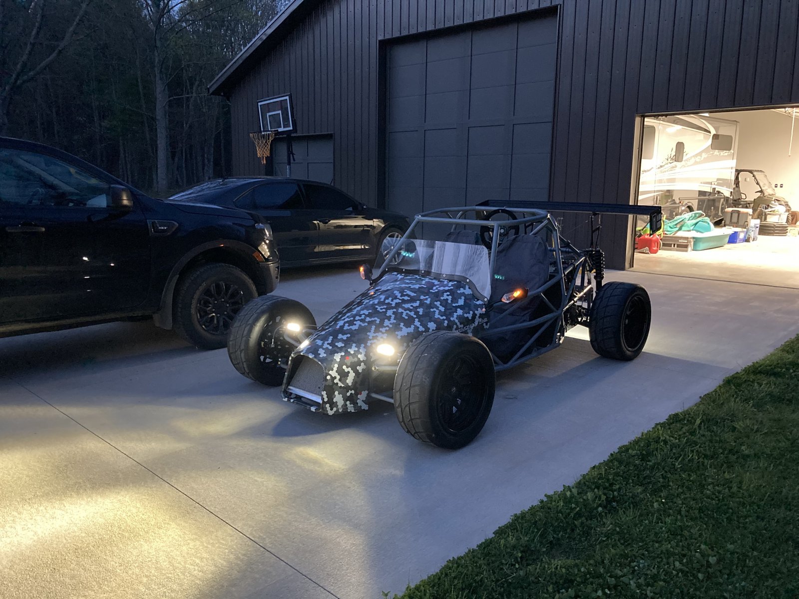

I have kind of lost interest in the Goblin recently but the weather is finally getting nice and I am on vacation for a couple weeks, so I decided to spend the day catching up on my neglect.
I made all new oil cooler hoses and replaced the oil cooler to alleviate any worries of contamination from the bearing failure last fall. I then installed a fan on the cooler with an inline thermal switch to control it. I also installed the coolant hoses with a thermostat this time. Coolant temps obviously fluctuated depending on ambient temps and vehicle speed with no thermostat, so I think this will help ensure stable tuning and drivability. I was then able to get a few miscellaneous items installed and put the wing on as well.
After that was all wrapped up, I spent like 2 hours wiping the dust layer off of everything. It was bad... The engine was sealed in plastic wrap, so no worries there.
At this point, there is not much I can do until I have the head wrapped up but it should go back together in an evening once I have it.
