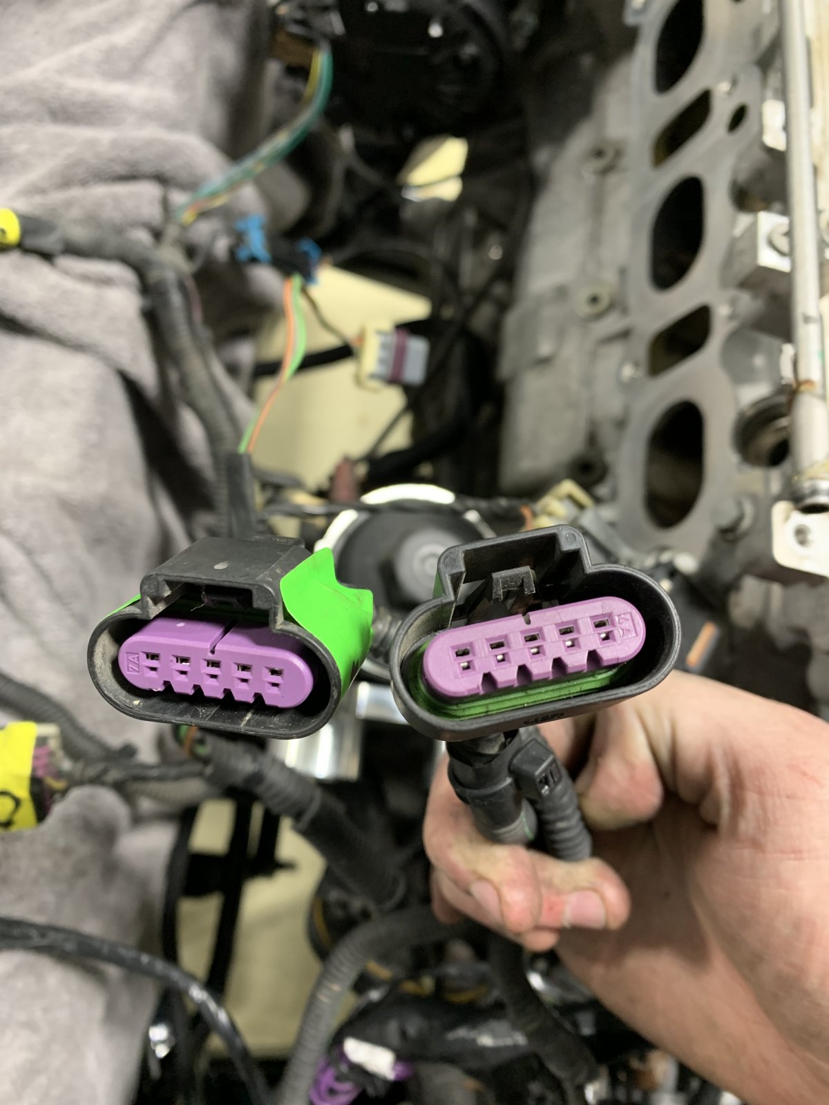

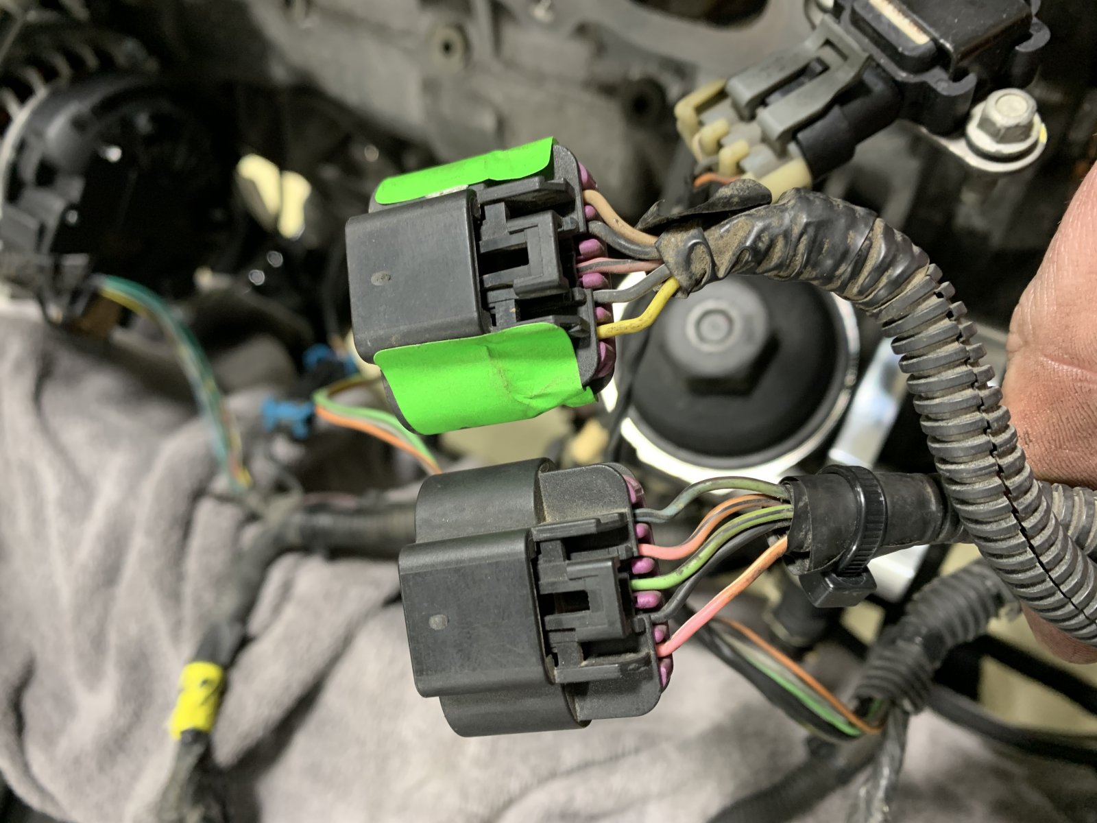

Needing to tap into the brain trust...
What could the connector without the green sticker be? I matched up the green sticker connector to the MAF pin out, but the other, I cannot find much info on.
Luckily, everything else laid in easily and connected. I have at least a handful of connectors which can be deleted so I believe I’ll be pulling it back out and start cutting.

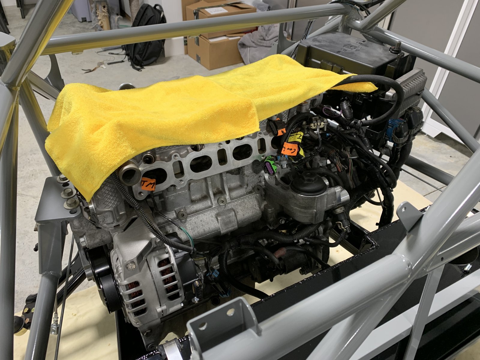

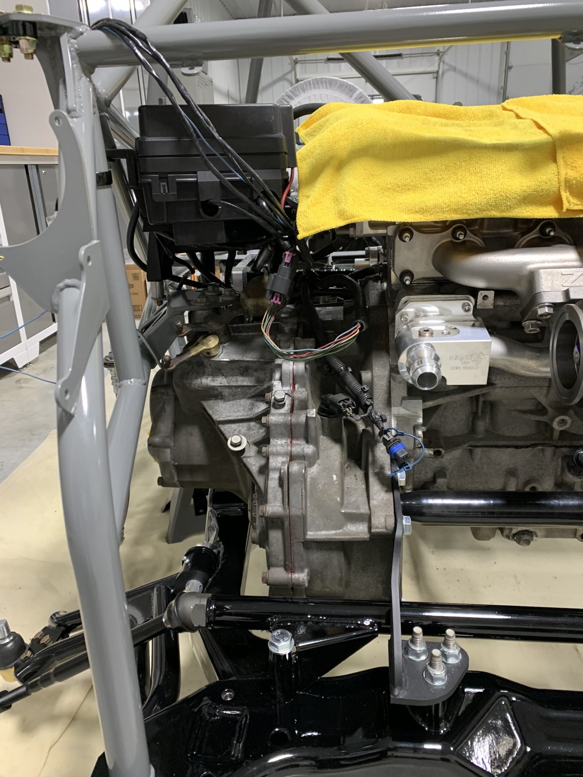

Lechlis
Minus the need for some electrical tape and final wire management once the rest of the parts are installed, I think the engine harness, fuse box, etc is done.
I removed the AC, intercooler pump, SCIP, EVAP, purge, rear O2, and radiator fan plugs. I only cut them back a few inches, applied heat shrink, and tucked inside the conduit just incase. All of the grounds also lined up very nicely. It should tidy up quite nice once everything is finalized.
I was able to turn the key on and fire up the electronics without any smoke being released!

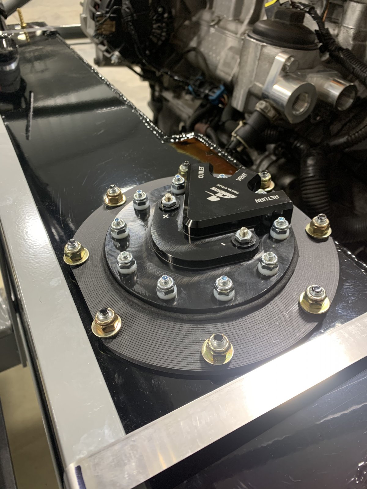

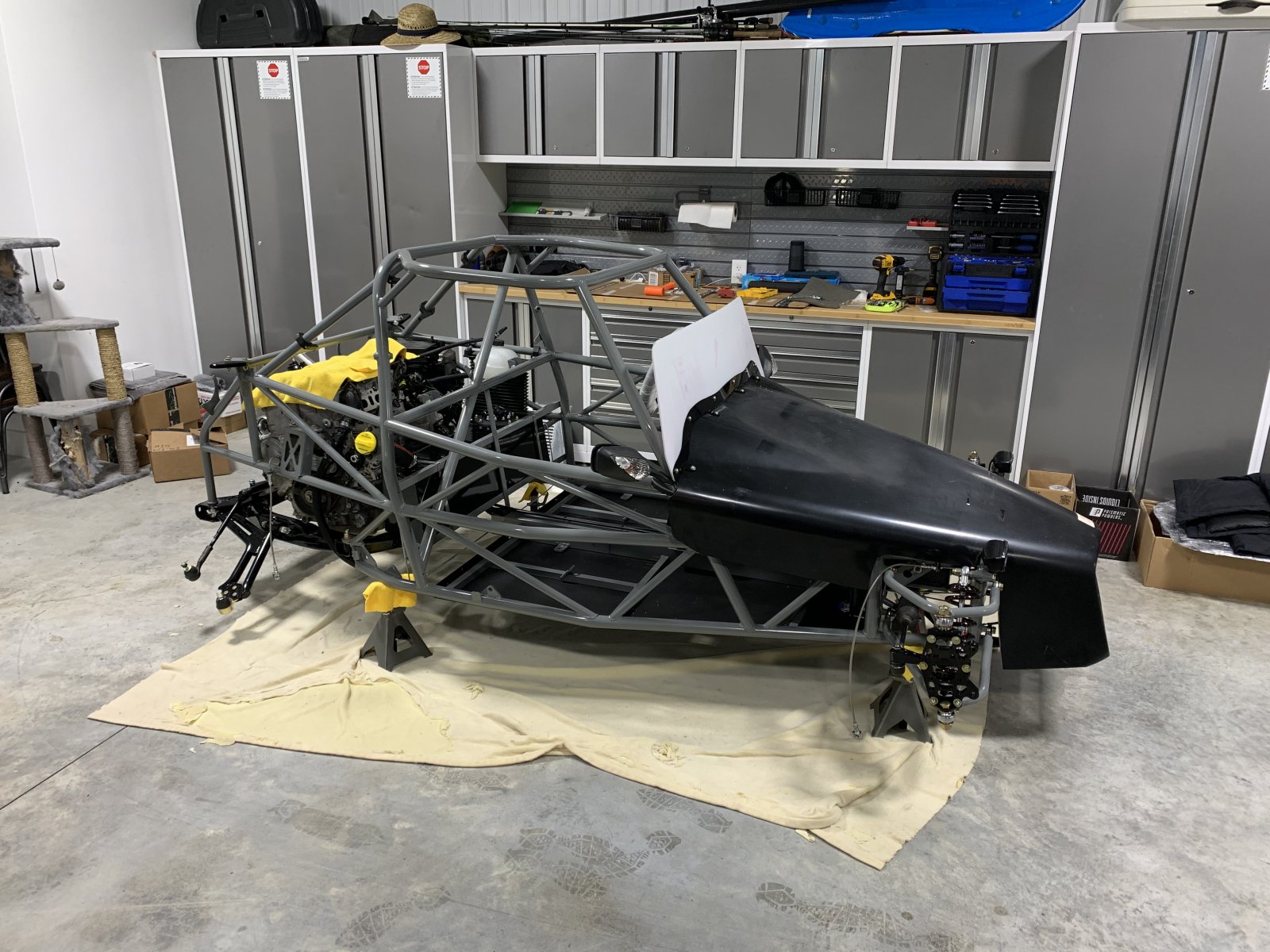

Not much new this week.
I installed the fuel pump. I had to make a couple adapter changes but it’s pretty slick. Currently mounting the oil cooler and intercooler. All of the AN fitting/hose stuff has came over the last week so I’ll get everything piped up this week.
The throttle body works with the pedal and the engine turns over. The first start will be shortly after the intake manifold arrives!

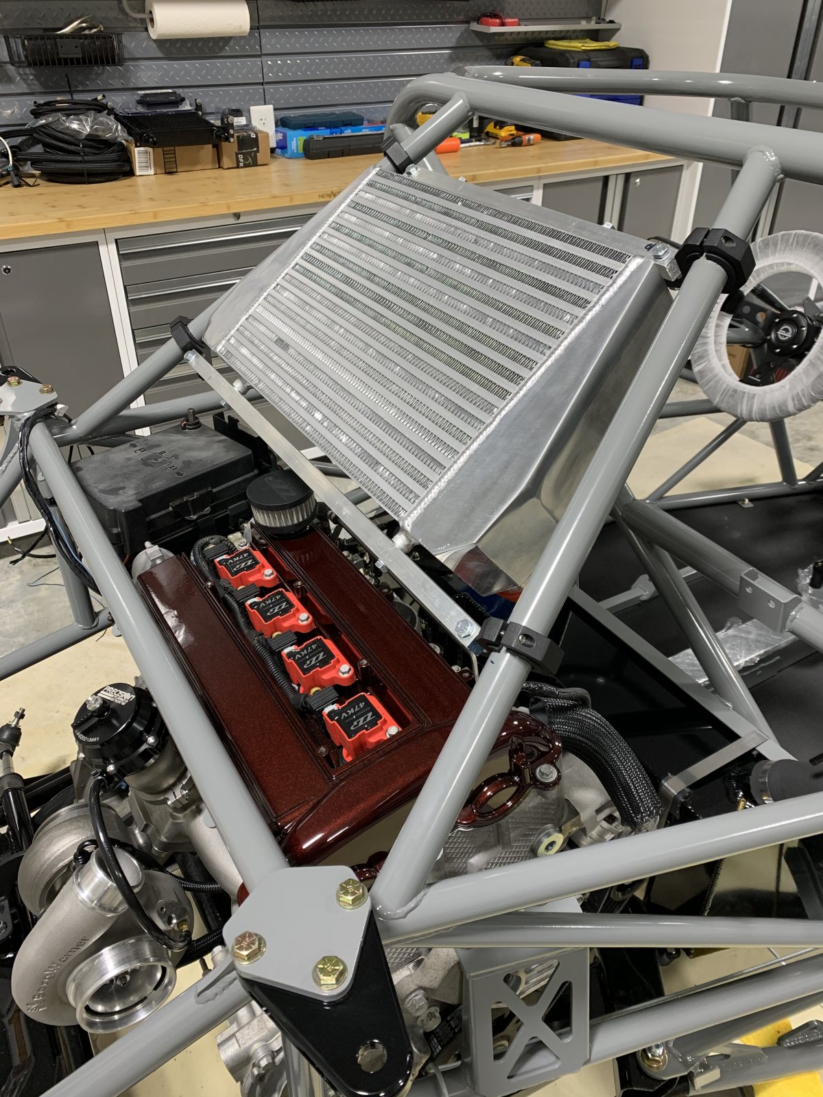

Lechlis

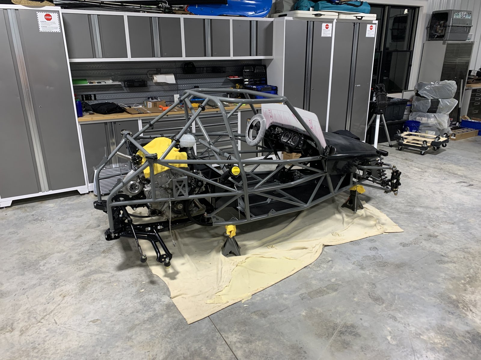

Wrapping up for the night.
Intercooler in. I’ll pull the cross bars tomorrow and paint them black. The piping is going to be quite easy! I probably spent too much time looking for the perfect intercooler with end tanks to match the bar angles, but it fits absolutely wonderfully. The turbo feed and drain are plumbed. The oil cooler is ready to mount, I just need three 1.25” P-clamps. Lowe’s only carries up to 1”... Oil cooler and coolant lines are pretty much ready to hook up. I am just awaiting a few other hose ends.
Against my better judgement, I put the valve cover on. It looks gorgeous! I’ll definitely be keeping it covered.

NICE!!! :D 3 inch A2A should keep your IATs down no matter how hard you drive. Are you putting fan(s) on for some forced air cooling? Just asking, because with the windshield installed you will find the air goes over the top and around the sides of the car and comes forward over the top of the engine - which you may already know. The fans should be blowing forward through the intercooler to take advantage of the cool air coming around the car rather than trying to push air back though the intercooler pulling the hot air from the engine area.
Lechlis
It’s funny you brought that up. I had actually been reading about how much the windshield changes the airflow so I figured I wouldn’t be getting much ram air from the front. I think for the sake of getting this thing built, I am going to put the fans on the “post-registration upgrades” list.

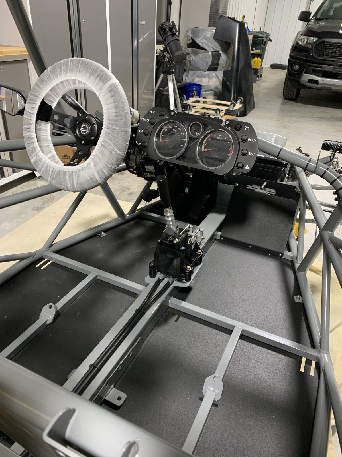

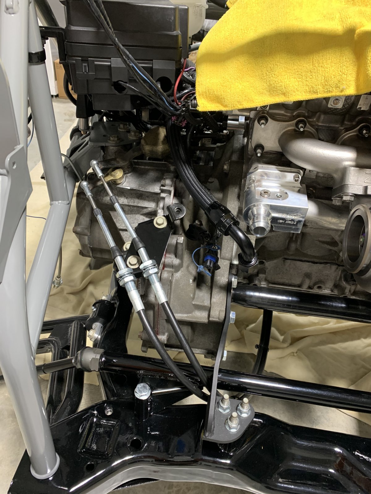

Lechlis

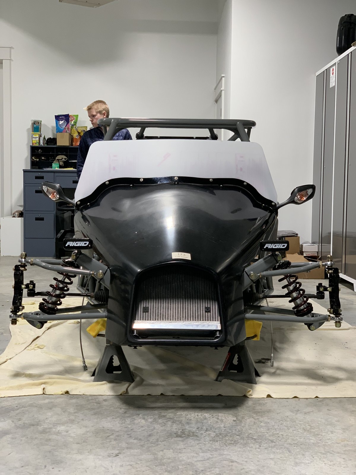

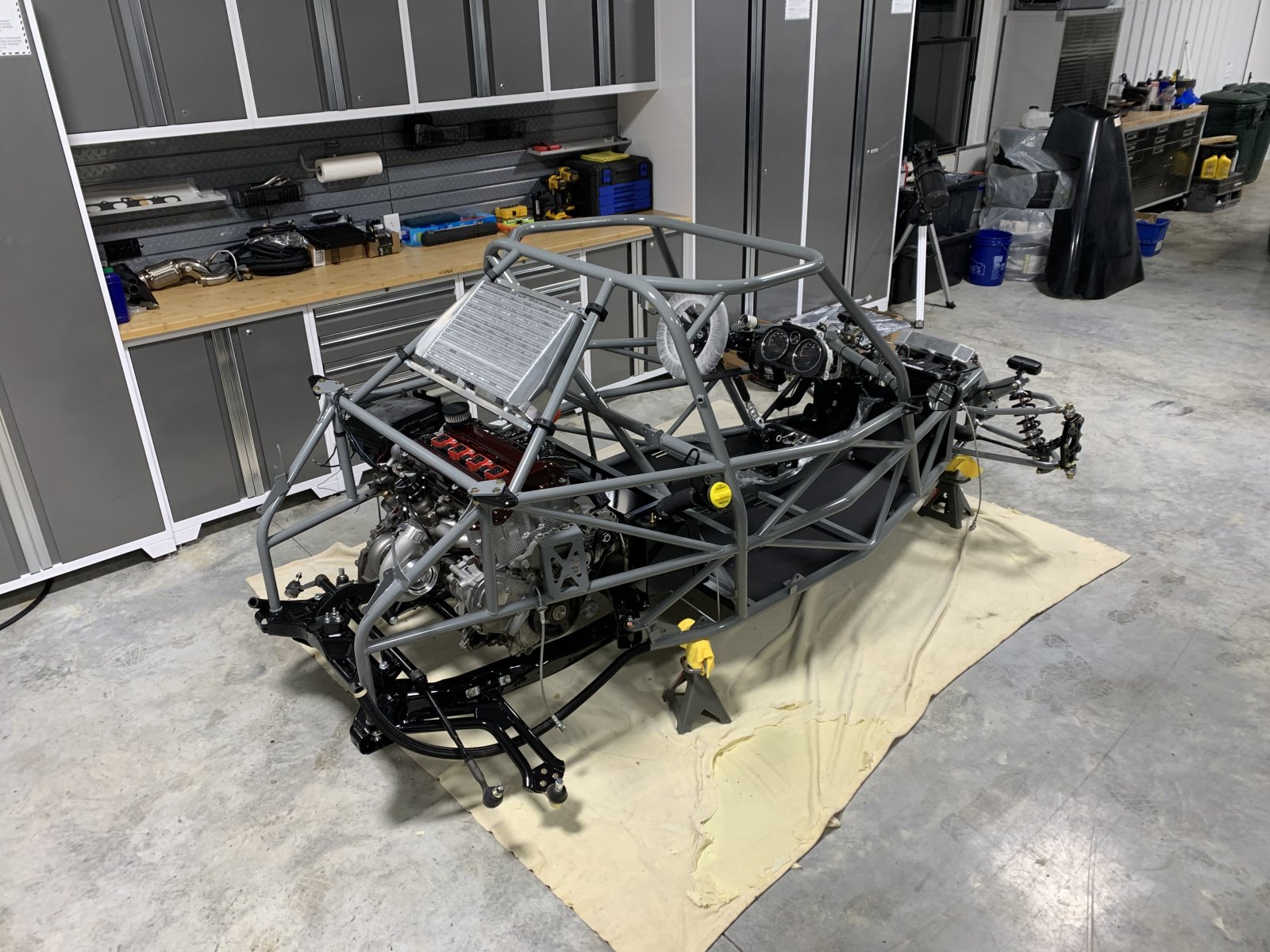

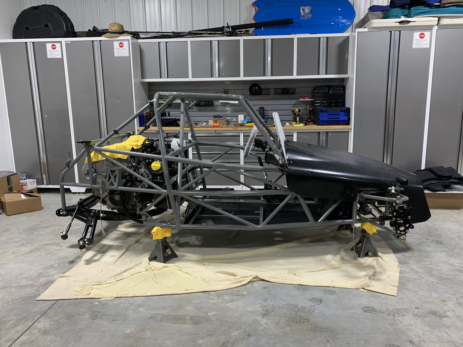

Shifter, shift cables, tunnel cap, intercooler, oil cooler, hood, windshield, switch panel, etc, etc complete.
Minus wrapping up the fuel/oil/coolant/intercooler piping and taillights, I believe I’m done until I get the backordered stuff from DF. The intake manifold will be here soon, so the first start will follow shortly after!

JeffsGoblin

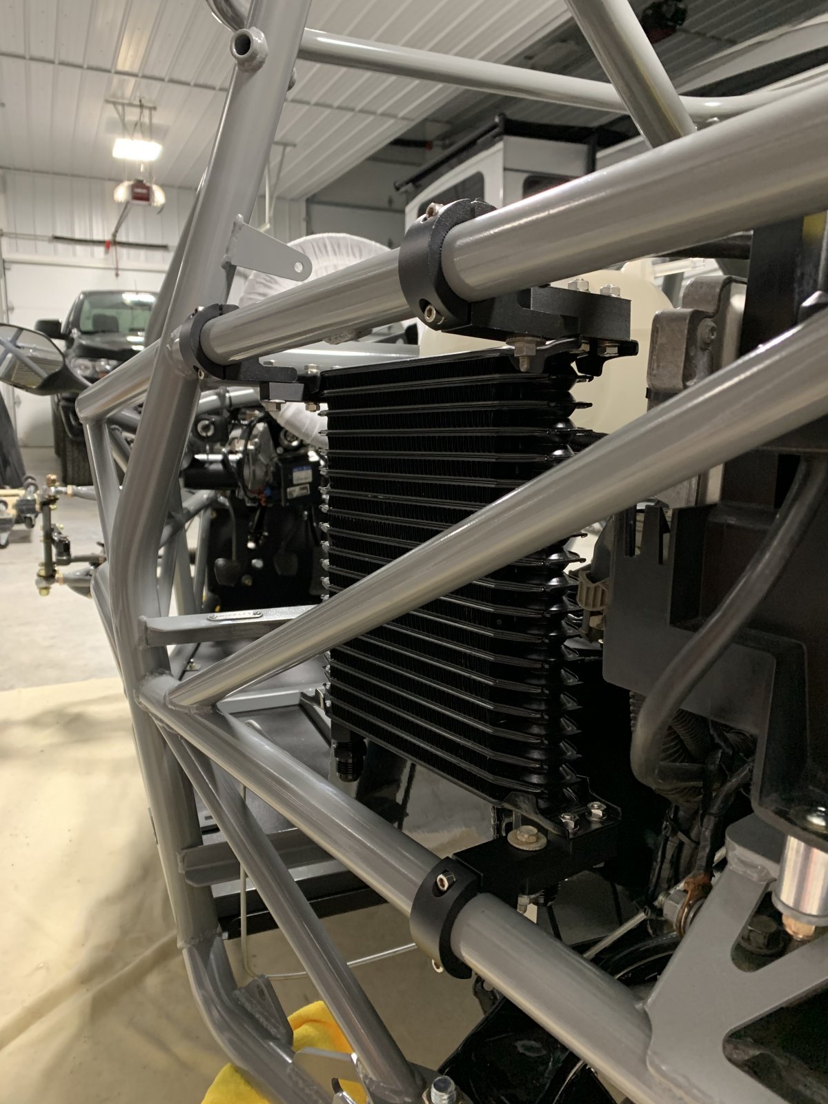

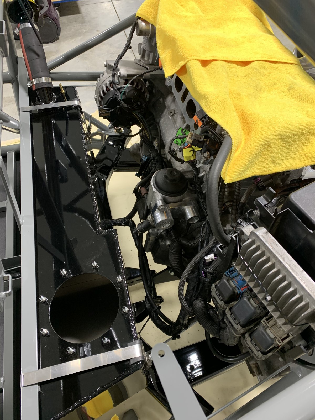

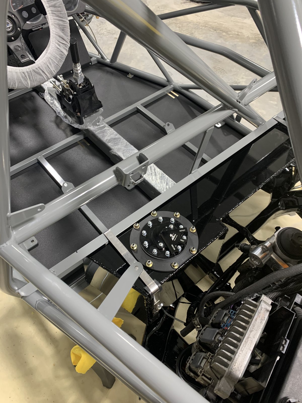

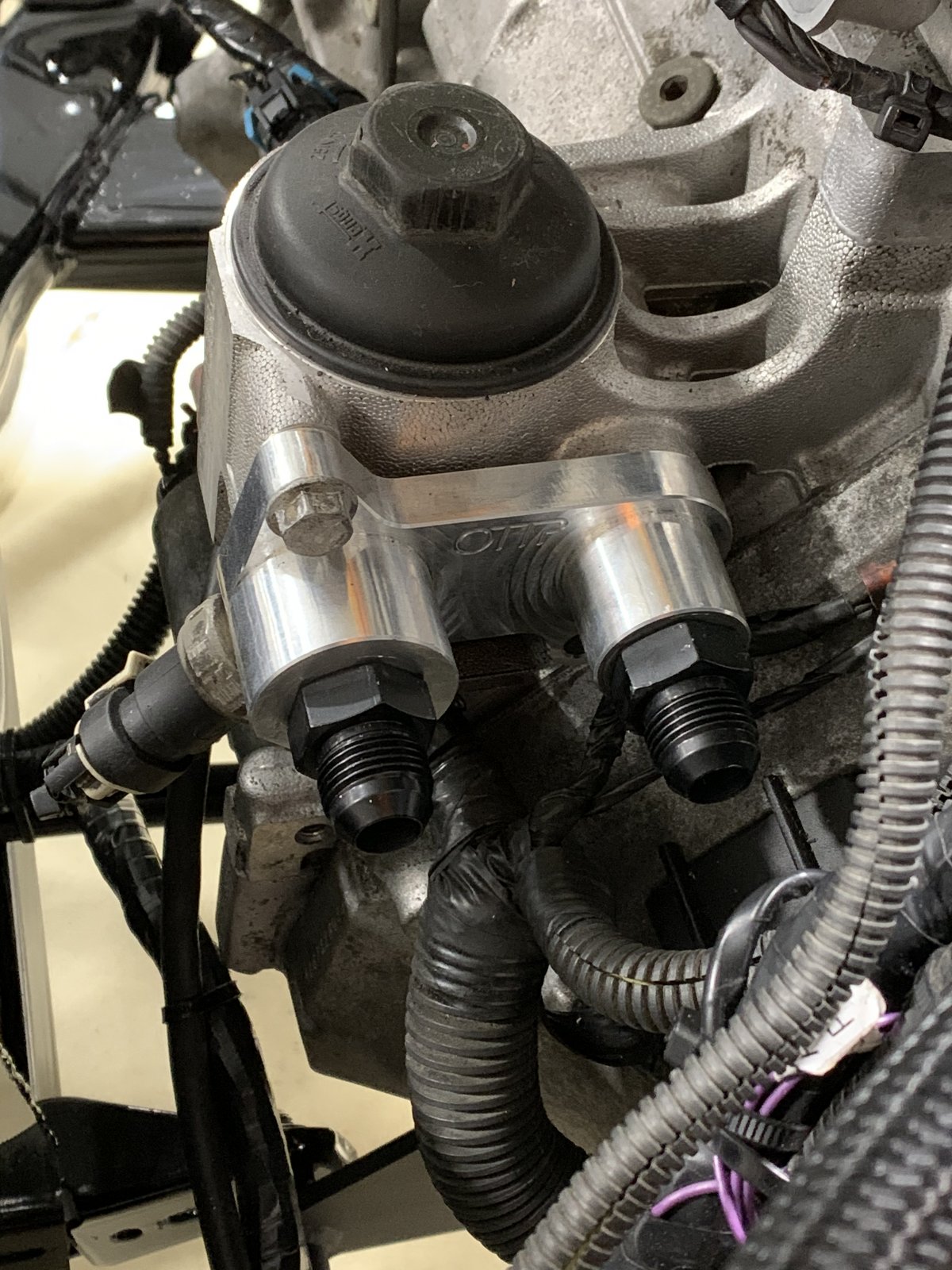

Agreee with Ark! Looks good! Could you share the engine oil cooler and hose part numbers shown in the 2nd picture? I was thinking of putting my oil cooler in the same place.

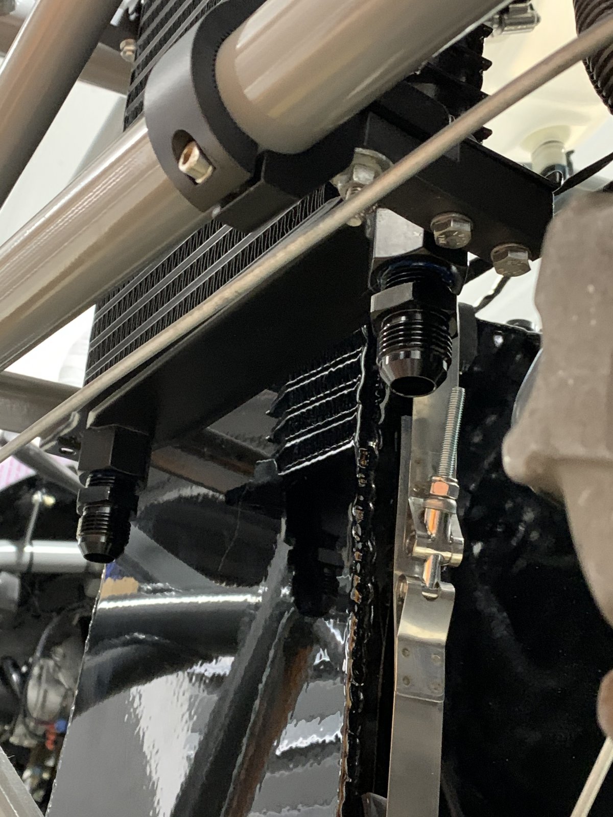

Lechlis
The cooler is a Frozen Boost Type 112. It came with the kit to be used as the stock intercooler heat exchanger. It comes with 10AN fittings, and I am using the OTTP remote oil cooler adapter which is also setup for 10AN fittings. I am putting 90s on the oil cooler and 45s on the remote mount plate to run the lines down and around a few other harnesses/hoses in its path. Regarding mounts, I just bought some 1.25” “P-Clamps” from Amazon and 3D printed adapters.

OptimizePrime

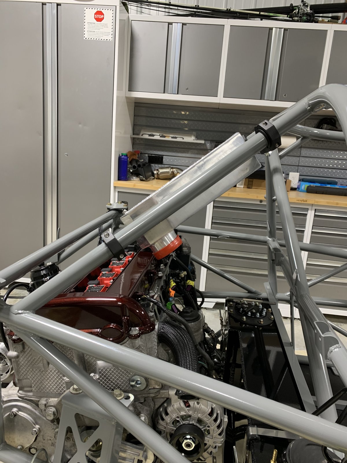

When you get a chance, can you take some pics of the FMIC (back mount?) mounts?
Where did you get the square bar stock and what size? I take it you drilled / tapped the end?
I'm interested in seeing how you're routing the piping. I think I'm going with the V-Mount FMIC in the same place and have the purchase list dialed in except for the mounting solution running across. I have carbon steel round tube that I could weld in but I feel like there may need to be some play and not have it that rigid.
Lechlis
Yep, I will get some next weekend when I get back to VA.
I used 3/4" aluminum barstock from MetalsDepot (Link below). I bought a 4' stick for $16.16 and had a few inches left. The bar clamps and intercooler I used are below as well.
Piping wise, I am going to get the final measurements and BOM once the intake manifold is on. Dyemond Fab had some supplier issues and is expecting delivery to me late next week.
Barstock --> https://www.metalsdepot.com/aluminum-products/aluminum-square-bar
Bar Clamps --> https://www.amazon.com/gp/product/B01LWOINCE/ref=ppx_yo_dt_b_asin_title_o07_s02?ie=UTF8&psc=1
Intercooler --> https://www.cxracing.com/IC0047-B?search=IC0047-B
