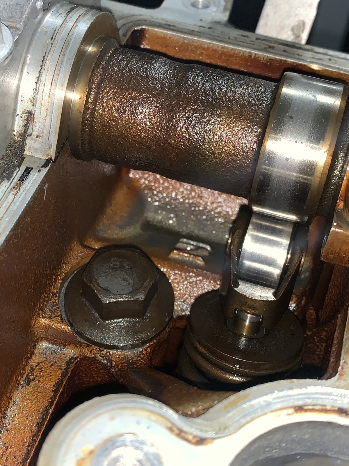

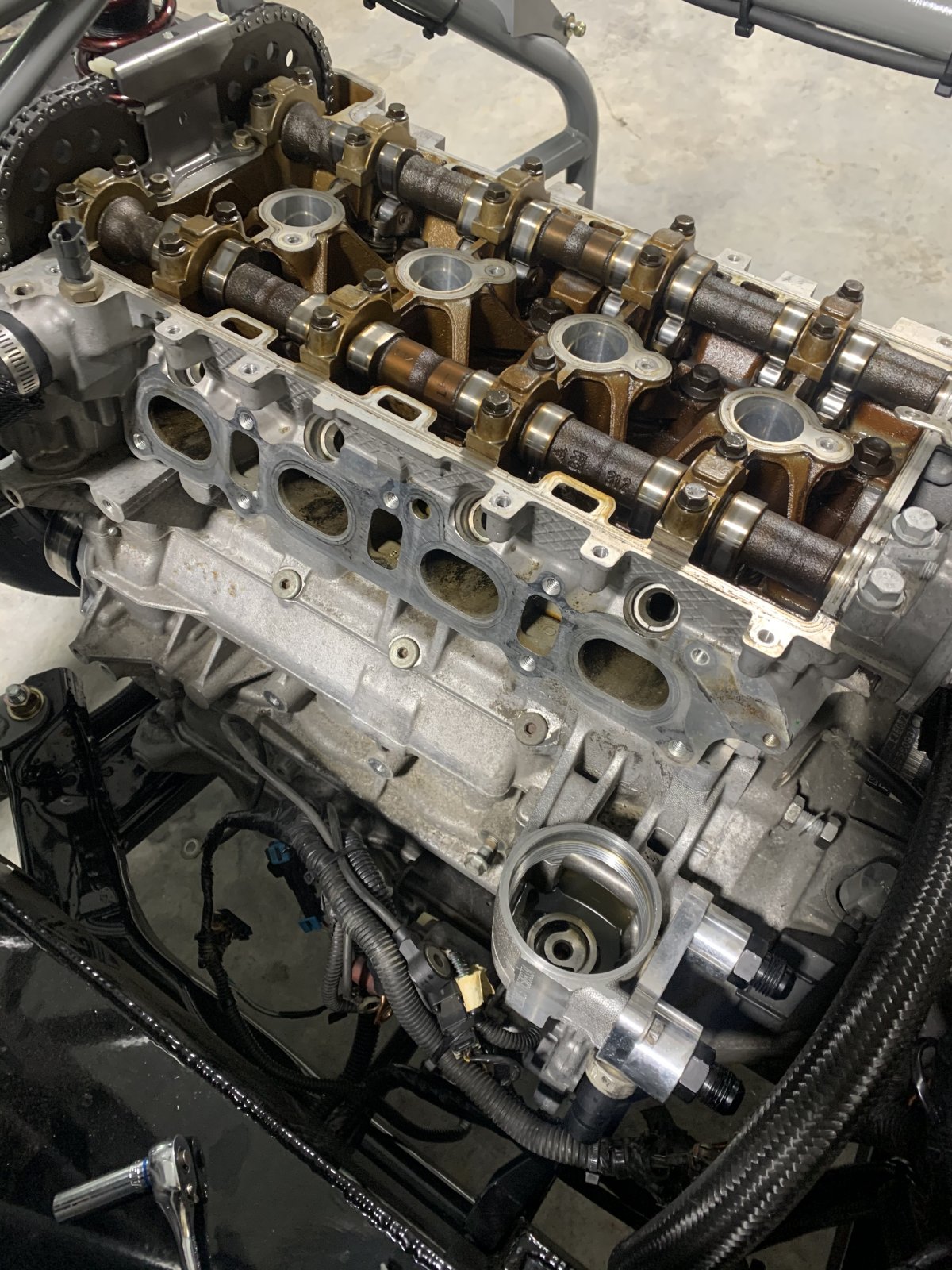

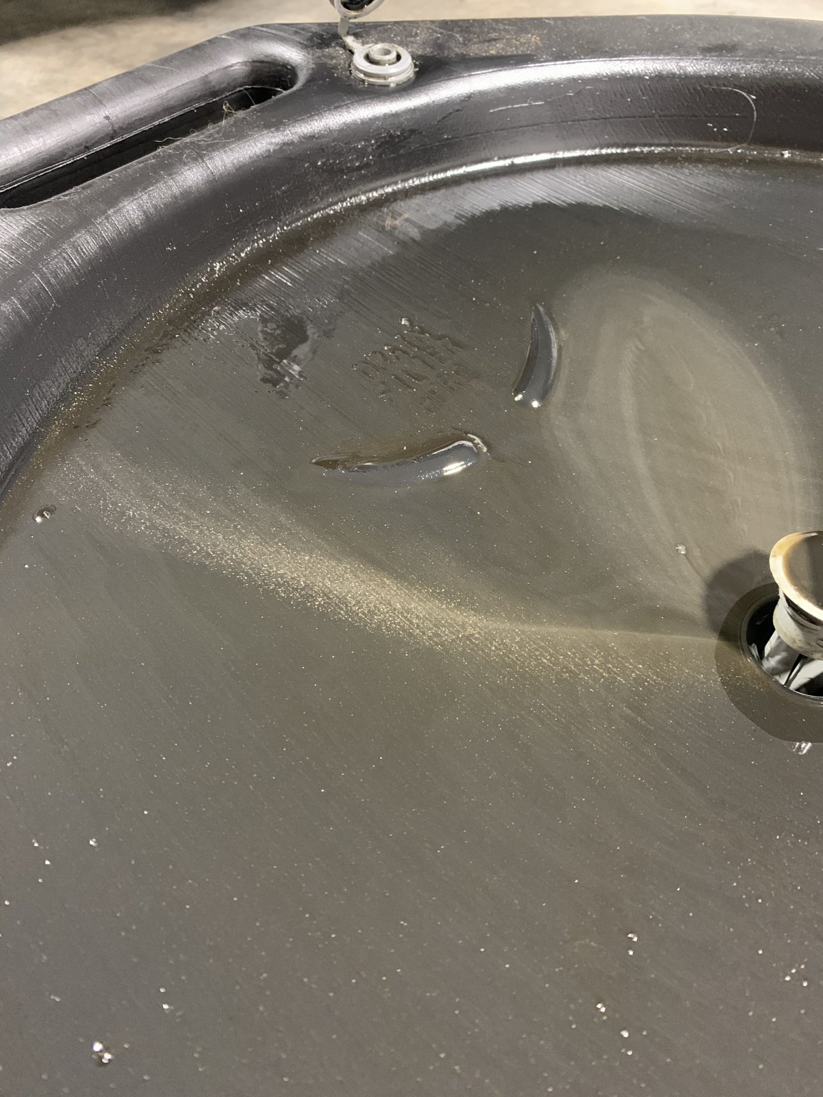

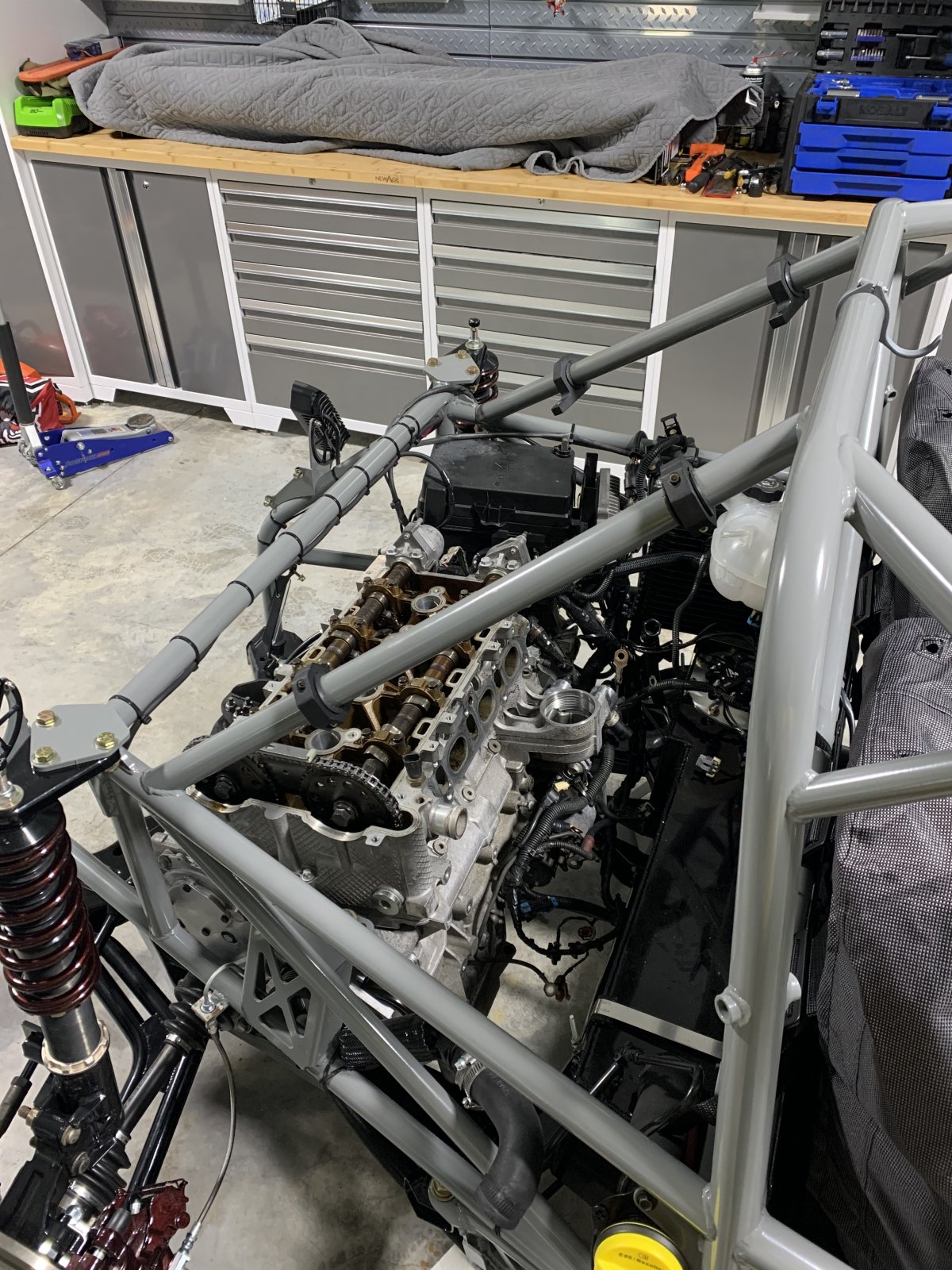

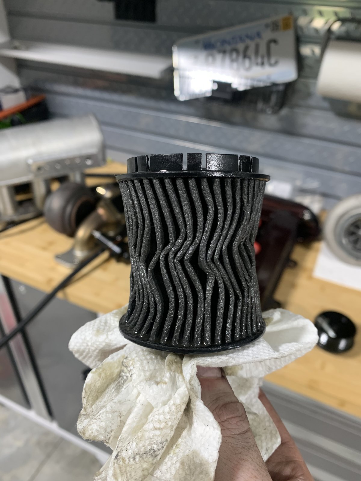

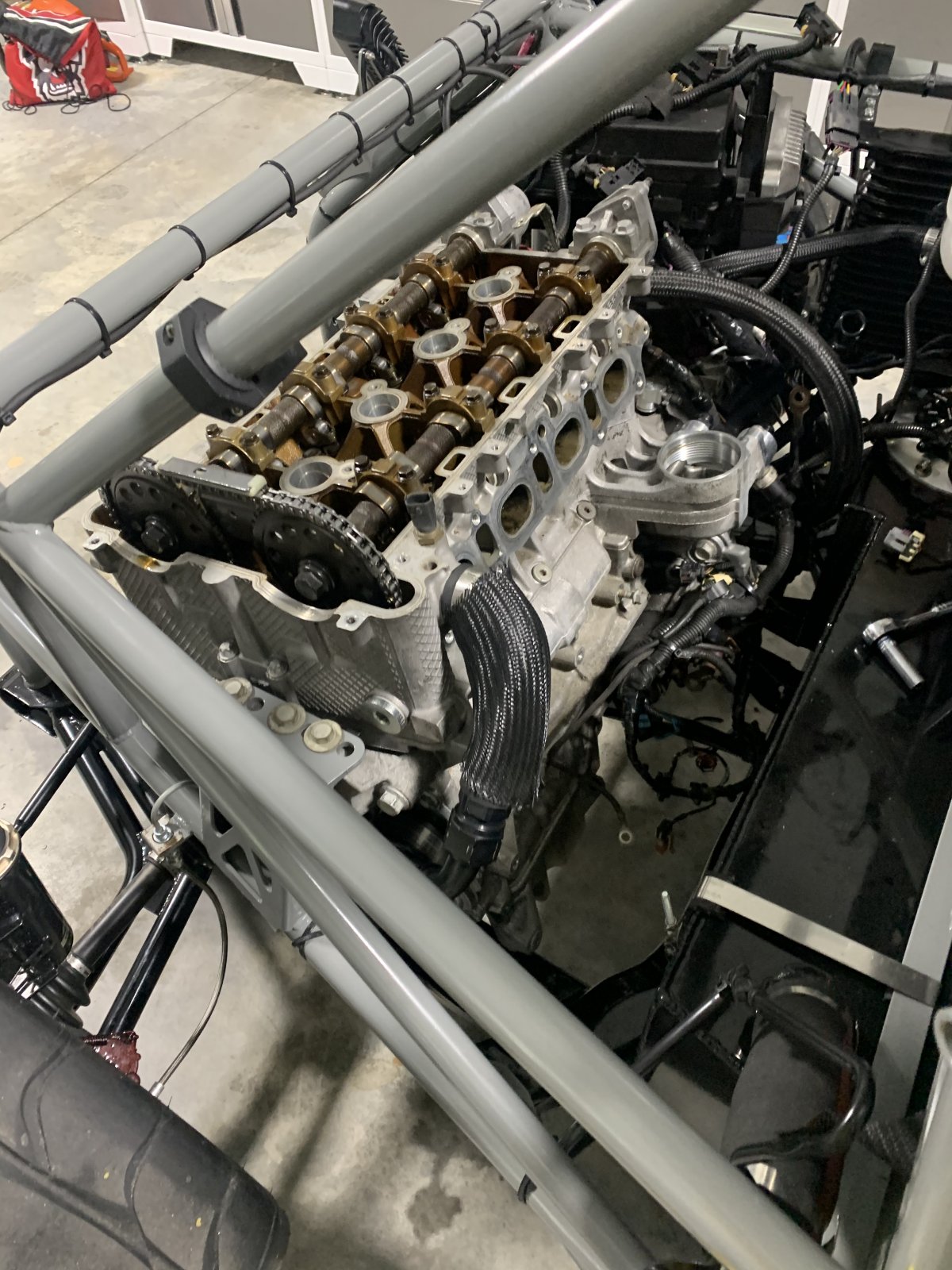

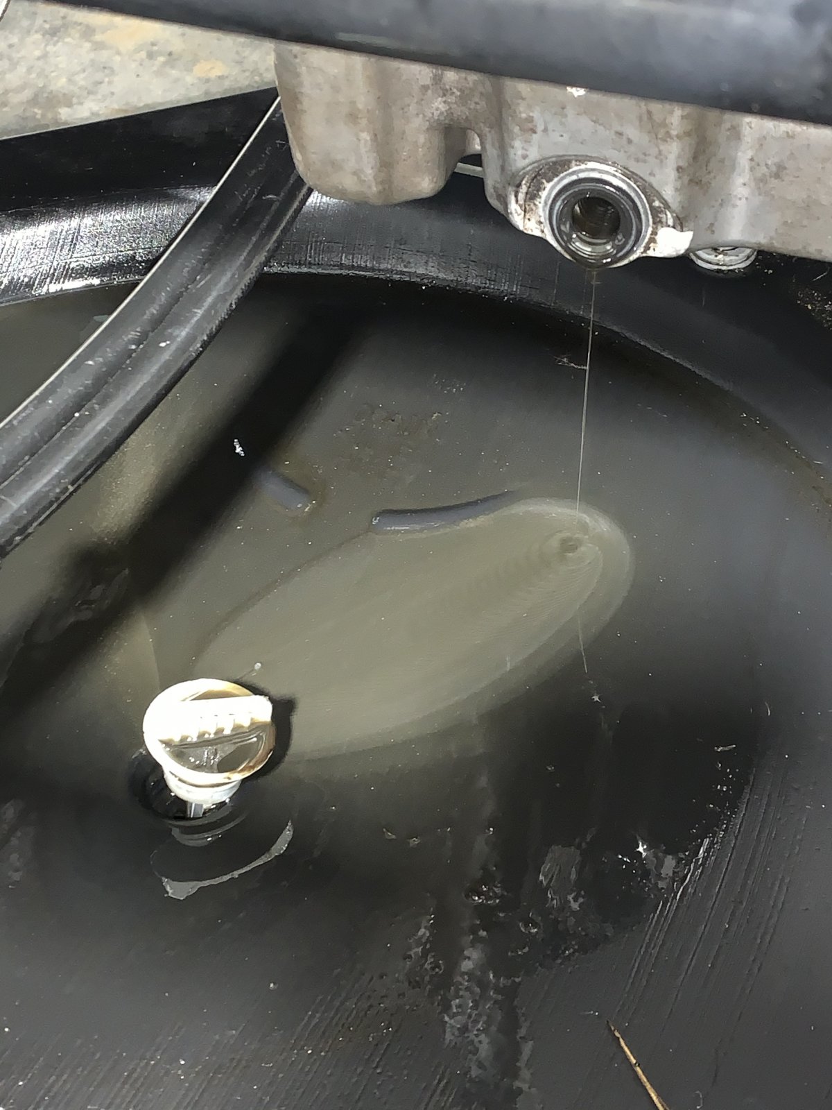

Some pictures I thought everyone would enjoy. I have not pulled the engine out yet, so I am not sure what else is hurt. I am curious what the crank looks like. The anti-seize looking stuff in the head is metal shavings... lol. Yes, that oil filter only has about 30 minutes of run time on it... The poor thing is toast.

Lechlis
What happened?
I am not 100% sure at this point. The turbo bearings failed first. I replaced them but knew something wasn’t right. I changed the oil a couple times with only idle time on it and it was coming out glittery. I pulled the valve cover and timing cover to take a look. I found the balance shaft tensioner has no spring pressure on it, so the guide and chain are just flopping around. I am assuming this is the root cause at this point but haven’t opened it up all of the way just yet.
