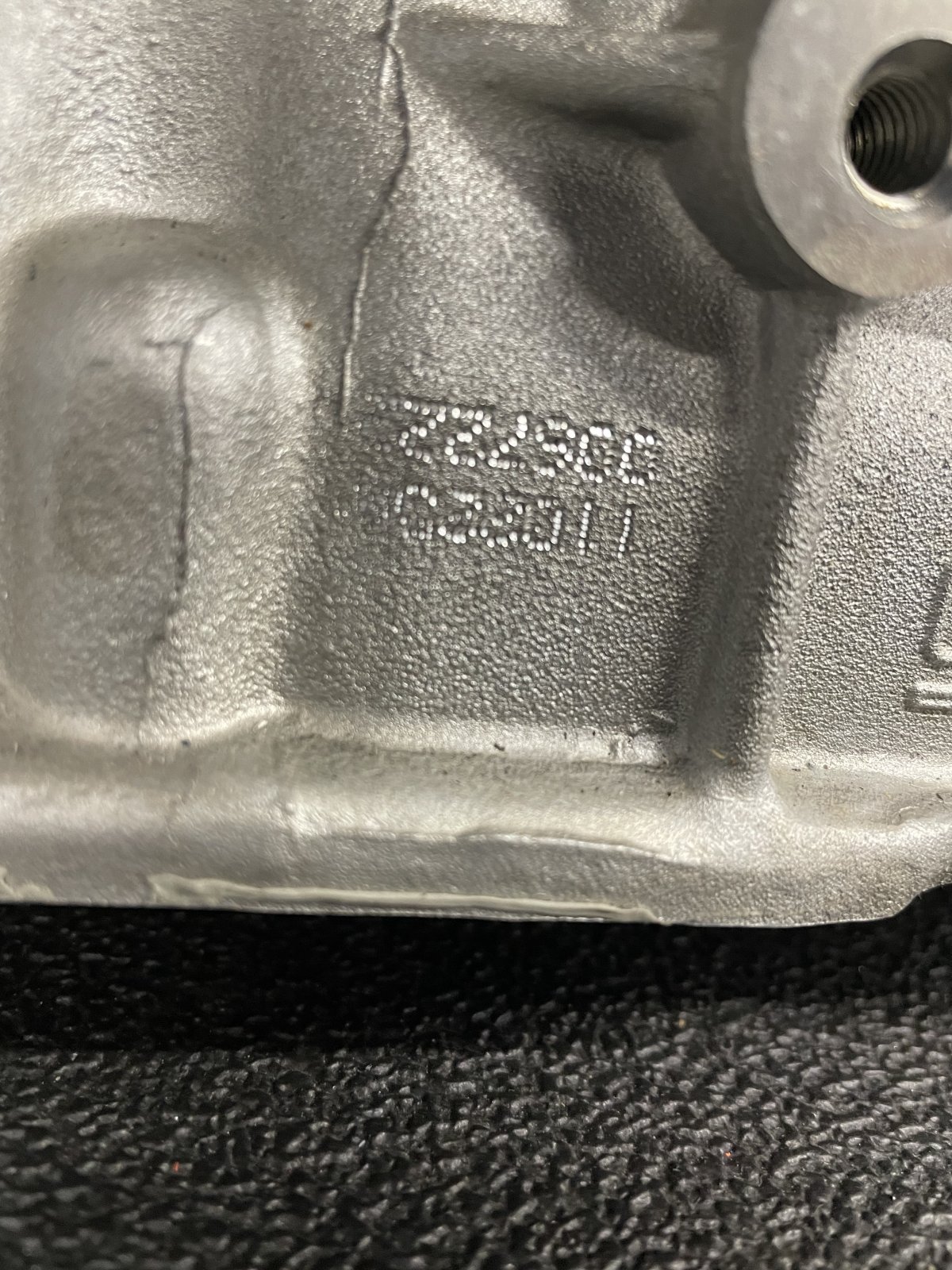

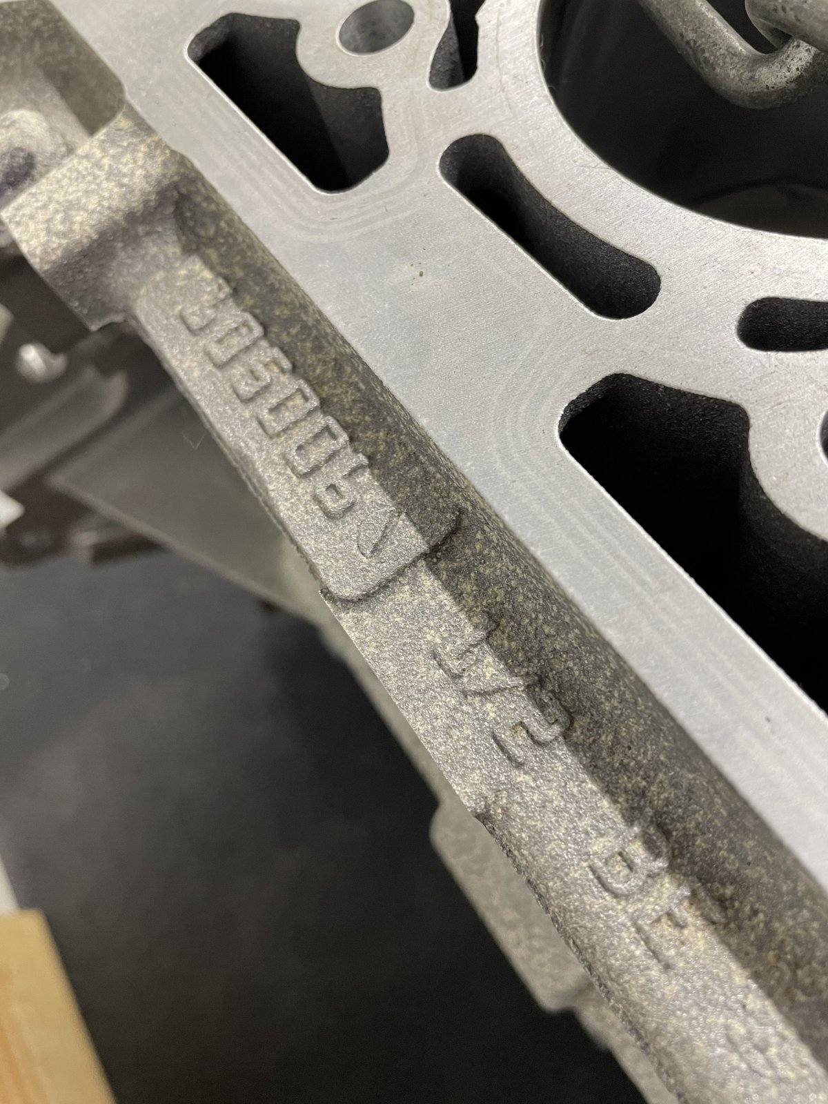

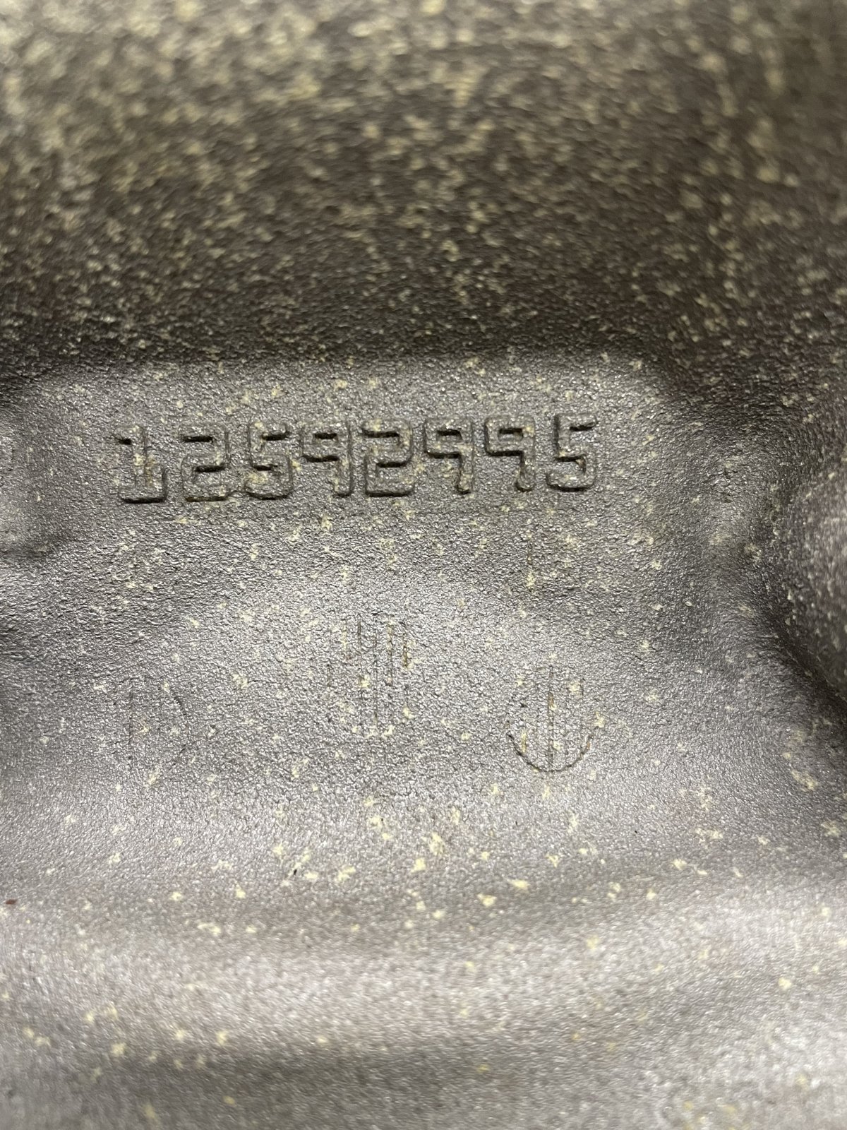

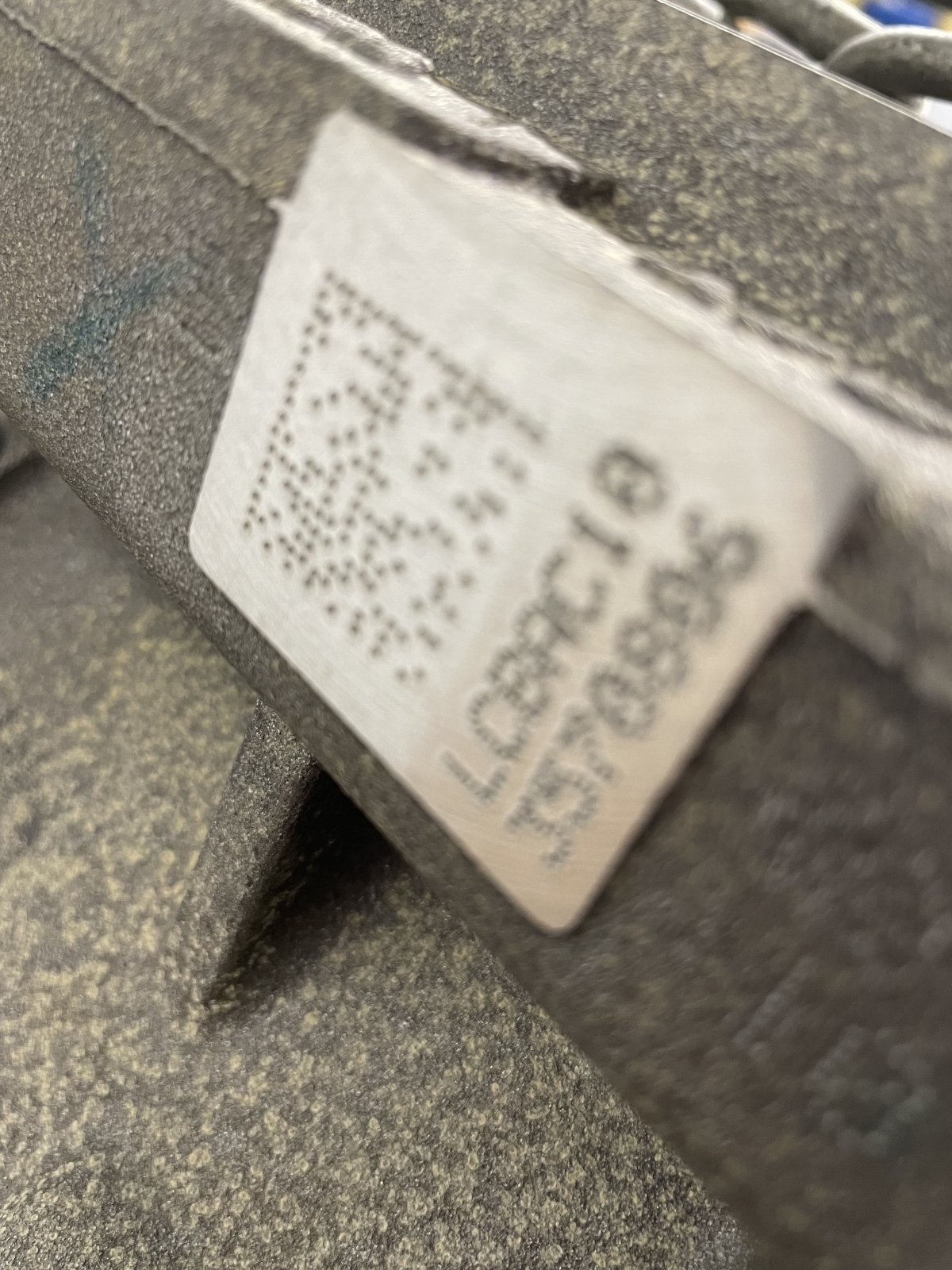

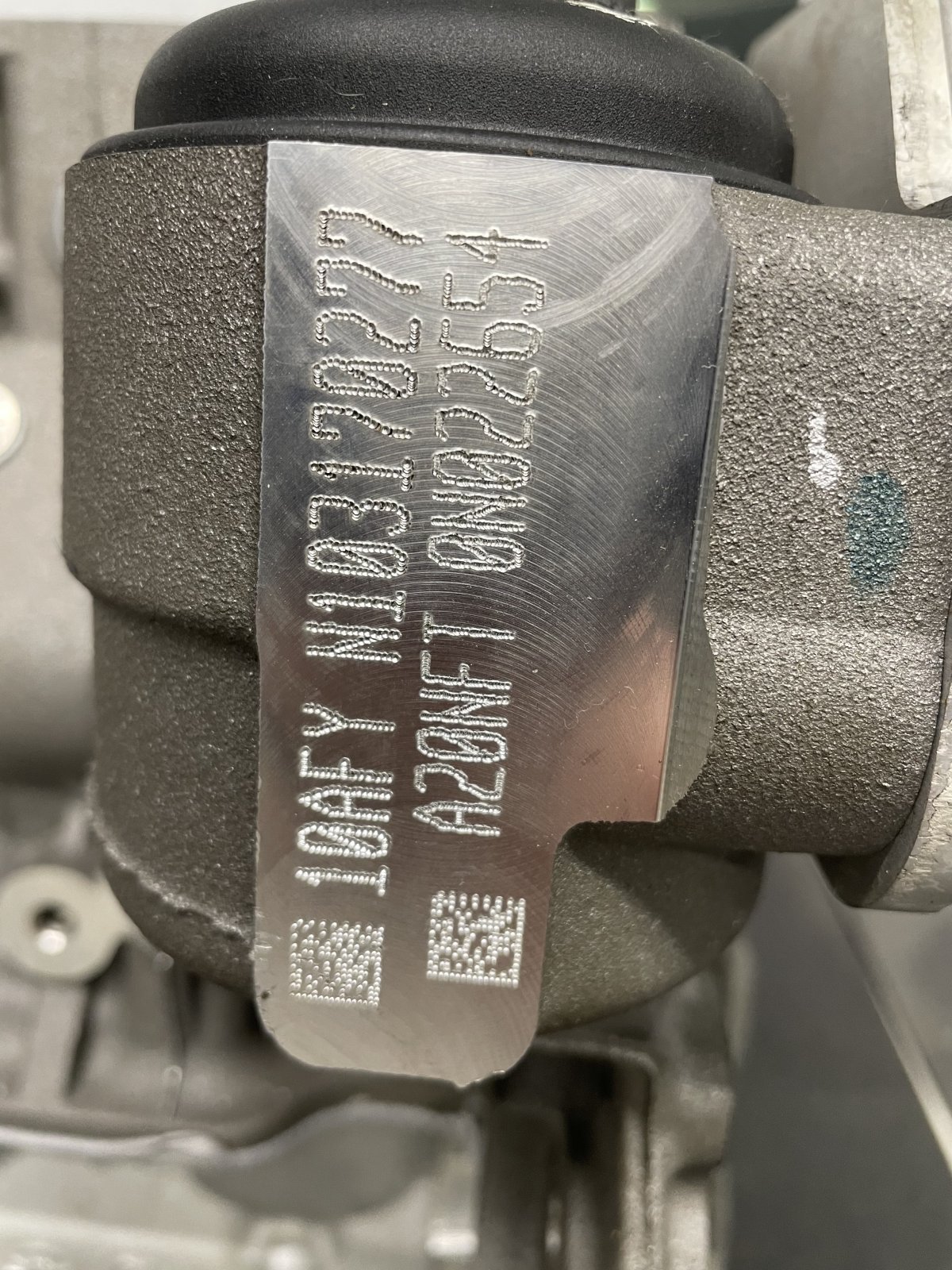

So I ended up getting a “GEN 3 LSJ Shortblock” as ZZP calls it. https://zzperformance.com/products/gen-3-lsj-short-block
I got it with the donor I bought off marketplace. The owner had bought the engine from ZZP with intentions of putting it in the car but did not attempt it. Long story short I was asking about block numbers and I now have some insight to share. Here are the pics of the gen3 block for reference to anyone that may be interested.
