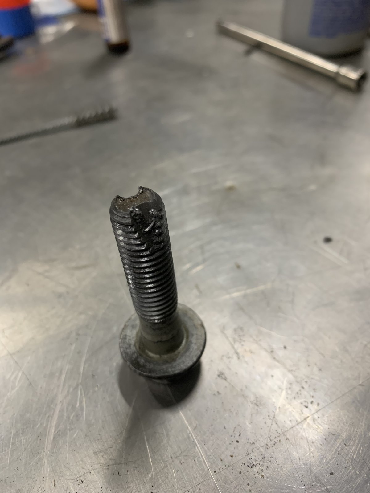

I ended up with the Fx400 and zzp aluminum flywheel. I put them on last night but the transmission didn’t want to mate up to the block and ended up hurting threads in one of the holes so more fun for this weekend. Clutch went on easy though.

Did you use a clutch alignment tool when putting on the clutch/pressure plate?
Yeah it all lines up. The splines went in but the burr on the aluminum wouldn’t let it fully mate up. The threads could’ve had trash in them. The bolt is straight, just won’t go in very far without hitting a “wall.” I’m gonna put four flats on an extra bolt and either use it to hold or at least clean it. My tap kit only has a T handle attachment and it would be impossible to use on that spot.

A bench grinder can save a life. All clean now lol. 5AEE080B-E41D-4430-BA86-98720DC555CA.jpeg
