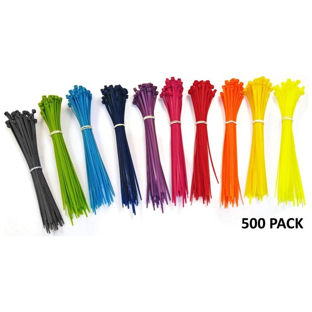

Once you get it running I recommend color coding the two plugs mentioned before and the MAF plug. You will be pulling the engine again at some point so better to plan ahead for that.

I got these and put one matching color zip tie on each mating connector :-) I also used this method to keep track of wires I ran through the tunnel.
