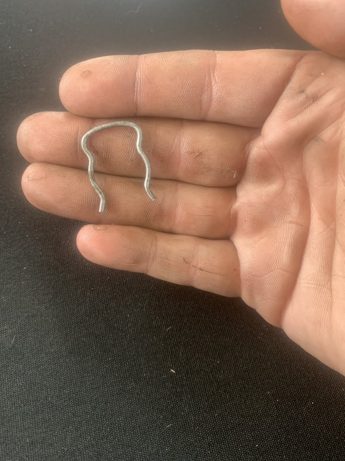

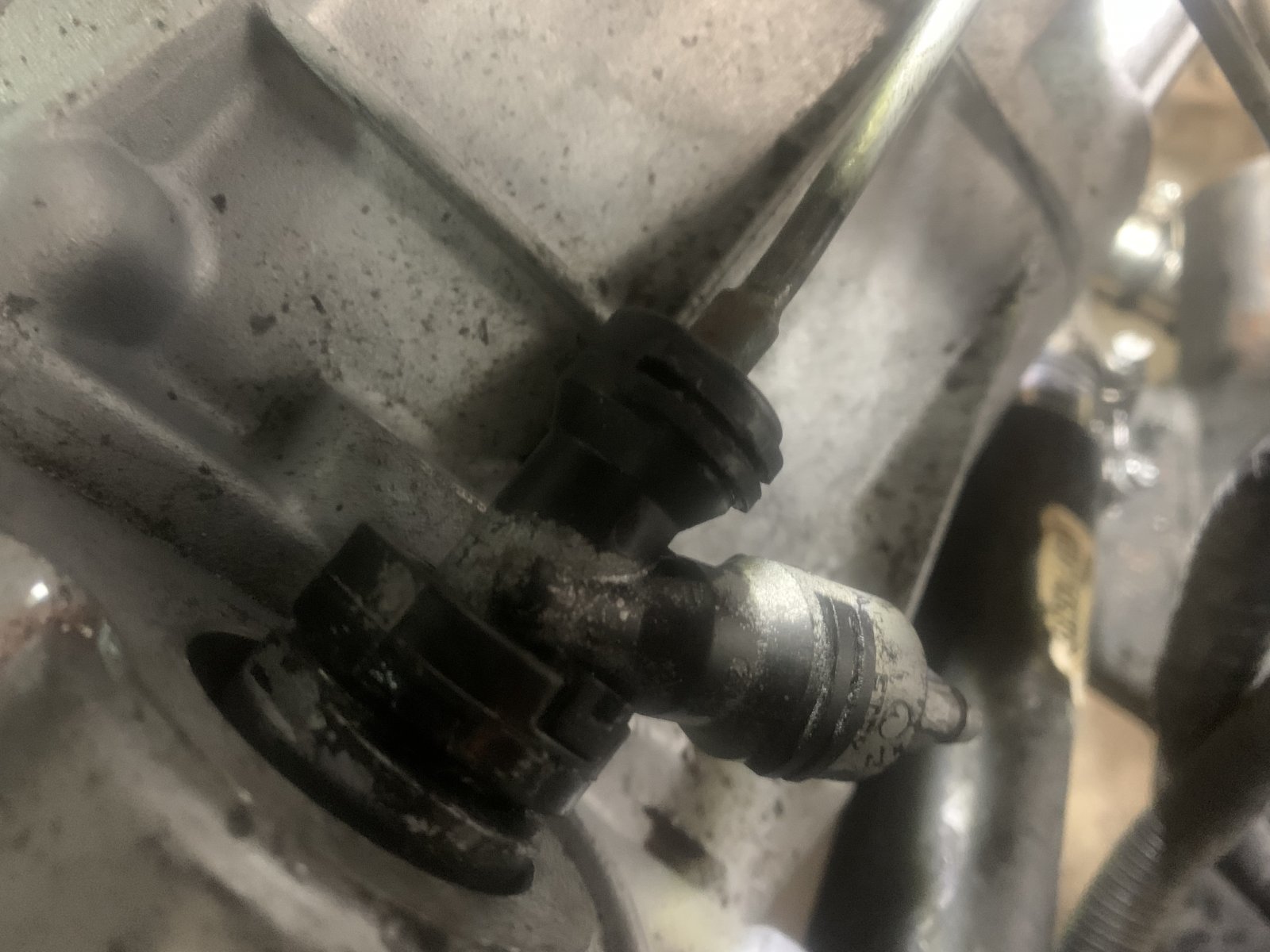

Does anyone know how to get this clip back in the connector of the throw out bearing
And also how do I do a crank position sensor relearn that’s a code it’s throwing
Usually the clip goes in first, then the line will snap in. You should be able to put the clip in with the line already in, but you’ll need to push on the line to make sure everything is set correctly.
Bajakid1450
I did the exact same thing...spent like an hour trying to figure out how to get it in before I just did it the right way out of frustration.
I’m glad someone said something because I spent like 3 hours researching how to get the line through the clip with it in the fitting and no data anywhere. So thank you guys :)
