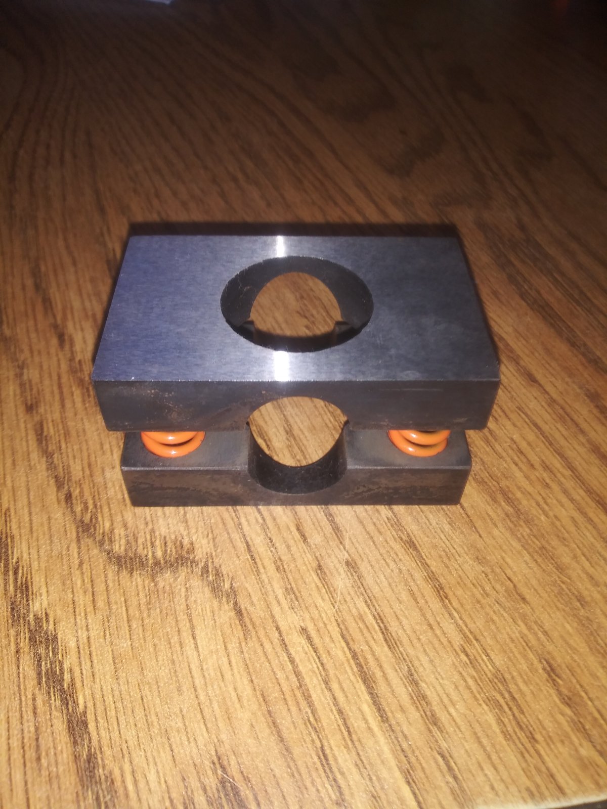

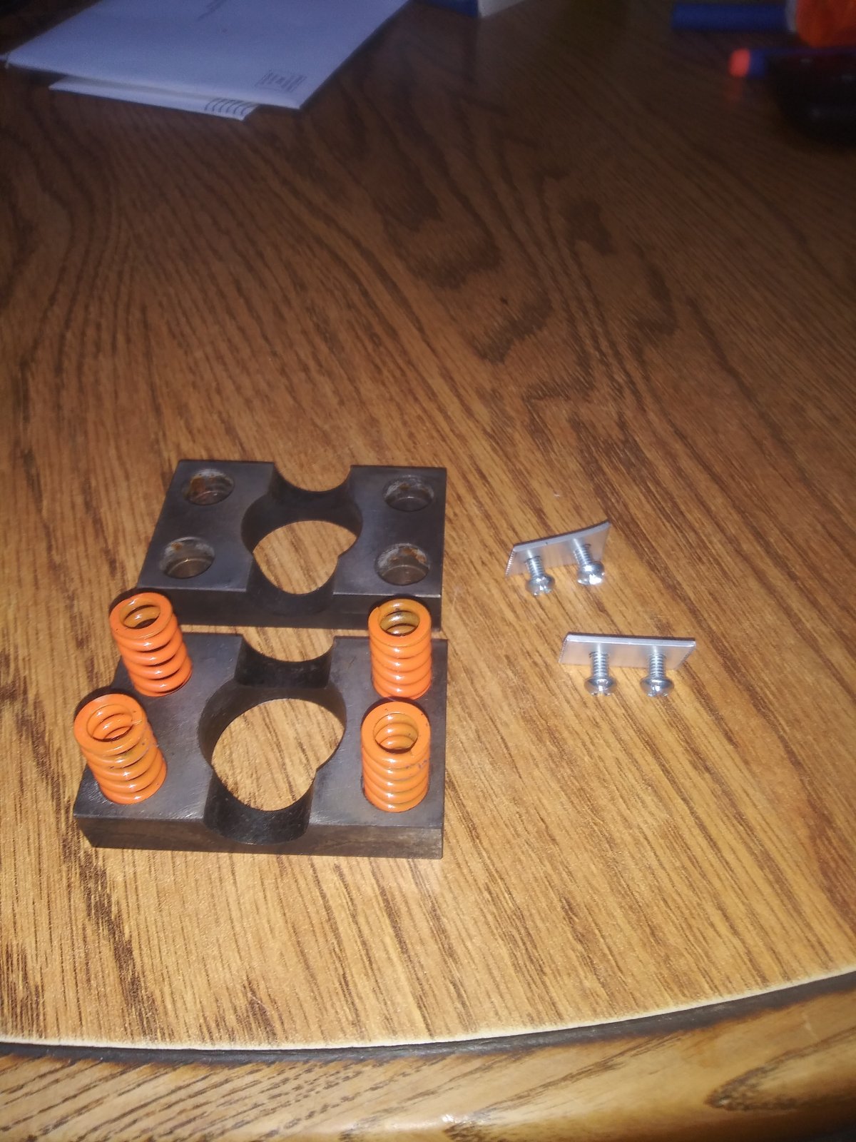

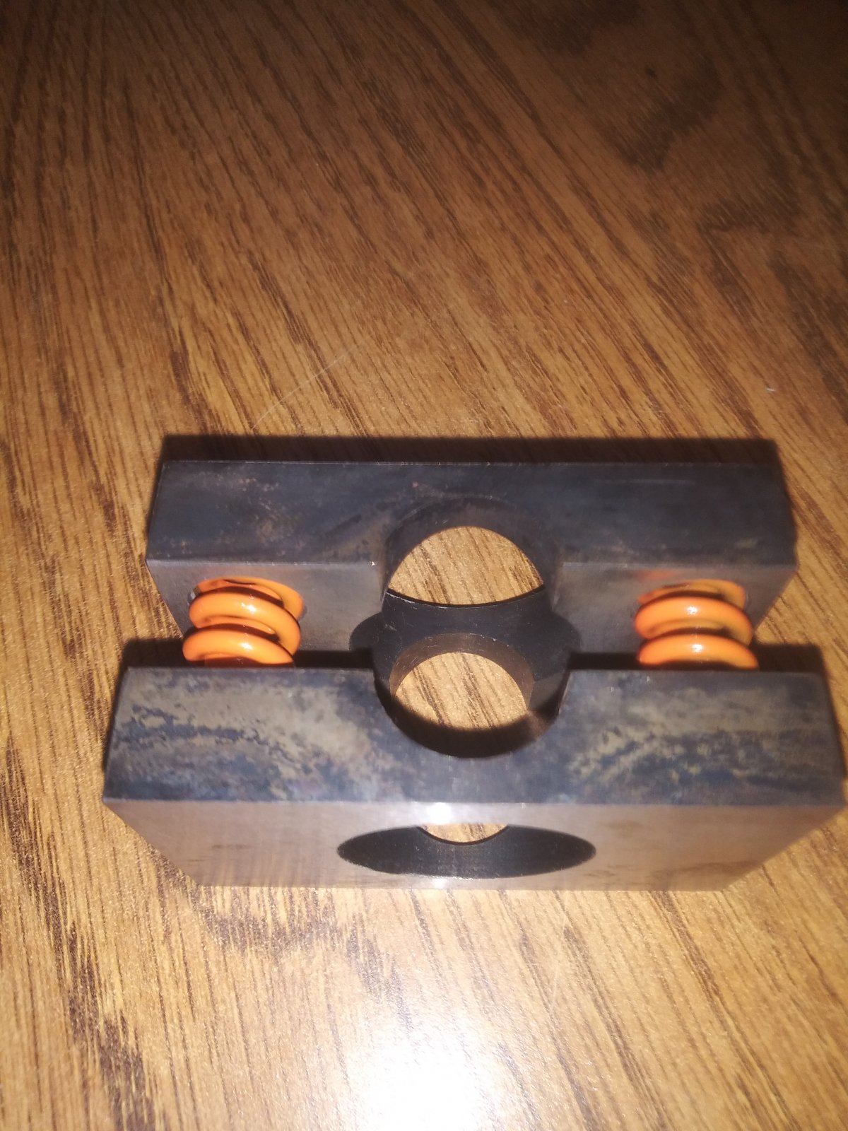

Anyone on here run an insert style limited slip differential (I.e. a phantom grip) ? Im looking at limited slip options for my F23 and im leaning heavily towards the insert style LSD from Team Green . They seem to have quite a few happy customers. They have been around for several years and from my research generally have positive reviews about their product. I did find a few unfavorable threads on different forums but it seemed to be mostly second hand hear say type commentary . Im looking for some first hand experience from someone whos owned a vehicle or at least driven a vehicle equipped with this style of limited slip differential. How does it perform was it effective? How do they hold up over time? Any unfavorable driving/handling characteristics? Funny noises? Im somewhat concerned about the longevity of the insert itself as well as its effect on the differential carrier assembly and side gears. Luckily F23 trasaxles can be had very inexpensively and I have an extra so if I destroy a differential in the process I will just chock it up as a science experiment...
Ok so I had to try it out I ordered it and they had it shipped same day I will update with pics of install and hopefully at somepoint review of how good it works when I get the goblin built

Hmm, depending upon the forces being applied to the steel block, the sections between the hole and side cutout looks thin in the photos - imo. I hope my view is incorrect and this piece works very well becoming an alternative to a full LSD install. :cool:
