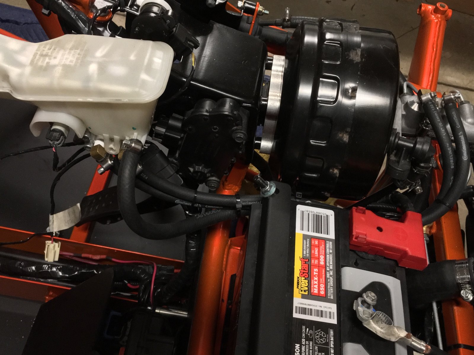

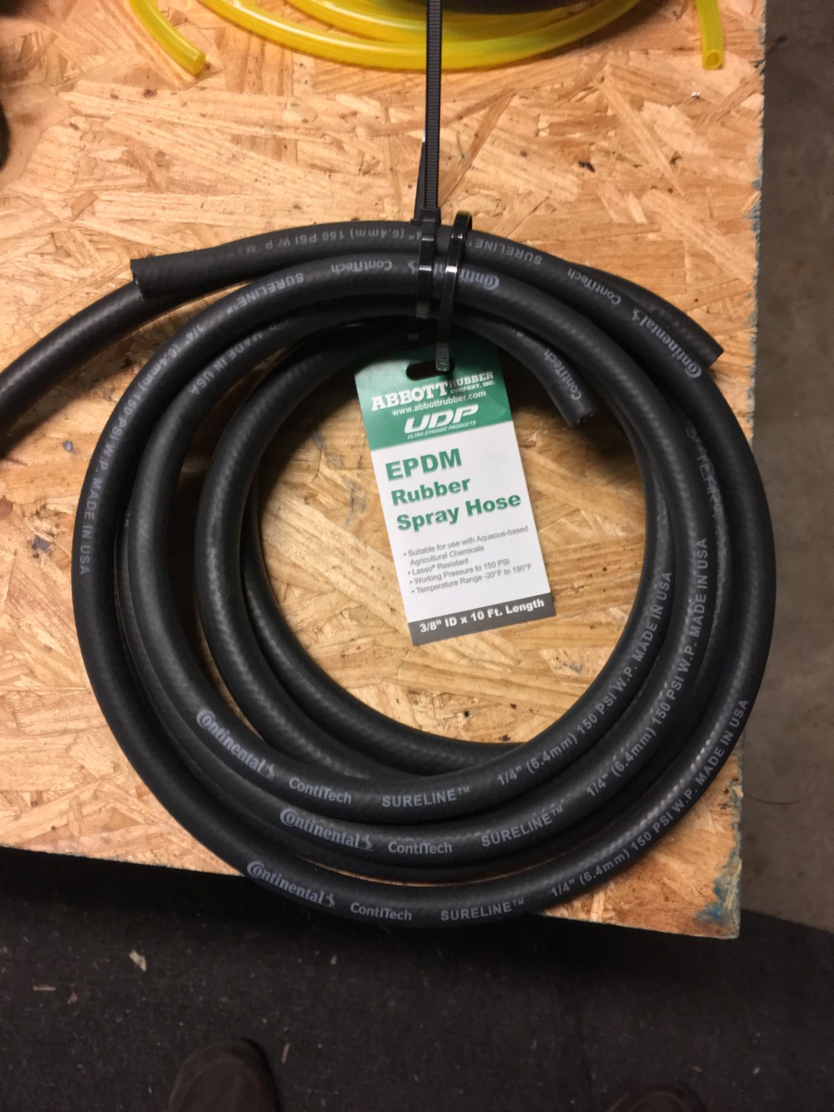

Thought I would share, I found a cheap master cylinder remote lines at Tractor Supply. EPDM tubing - 10' roll for $9.99. It is compatible with brake fluid. I picked up 2 rolls: 1/4” for the master cylinder lines and 3/8” for the clutch line.
Indy Lonnie

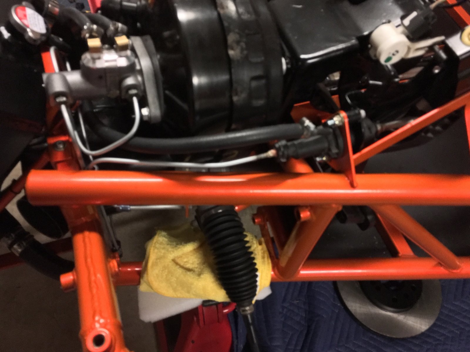

I thought I would show what the EPDM hoses look like installed.
And you also need to pay attention to I.D. vs nominal size. Indy Lonnie's picture shows 1/4 id hose being sold as 3/8 nominal. Of course at 7mm, that was probably id since 7mm nominal would likely be to small.

The pic shows 1/4” as 6.4mm. I can’t remember how tight it was, but I used clamps. It has been almost 5 years now with no leaks with the clamps. I know on the clutch line - I had to use the 3/8”. The 1/4 wouldn’t fit.
In the pic, there is actually 2 different sizes. Both 1/4” and 3/8”. I used 1/4” for the brake lines and 3/8” for the clutch.
