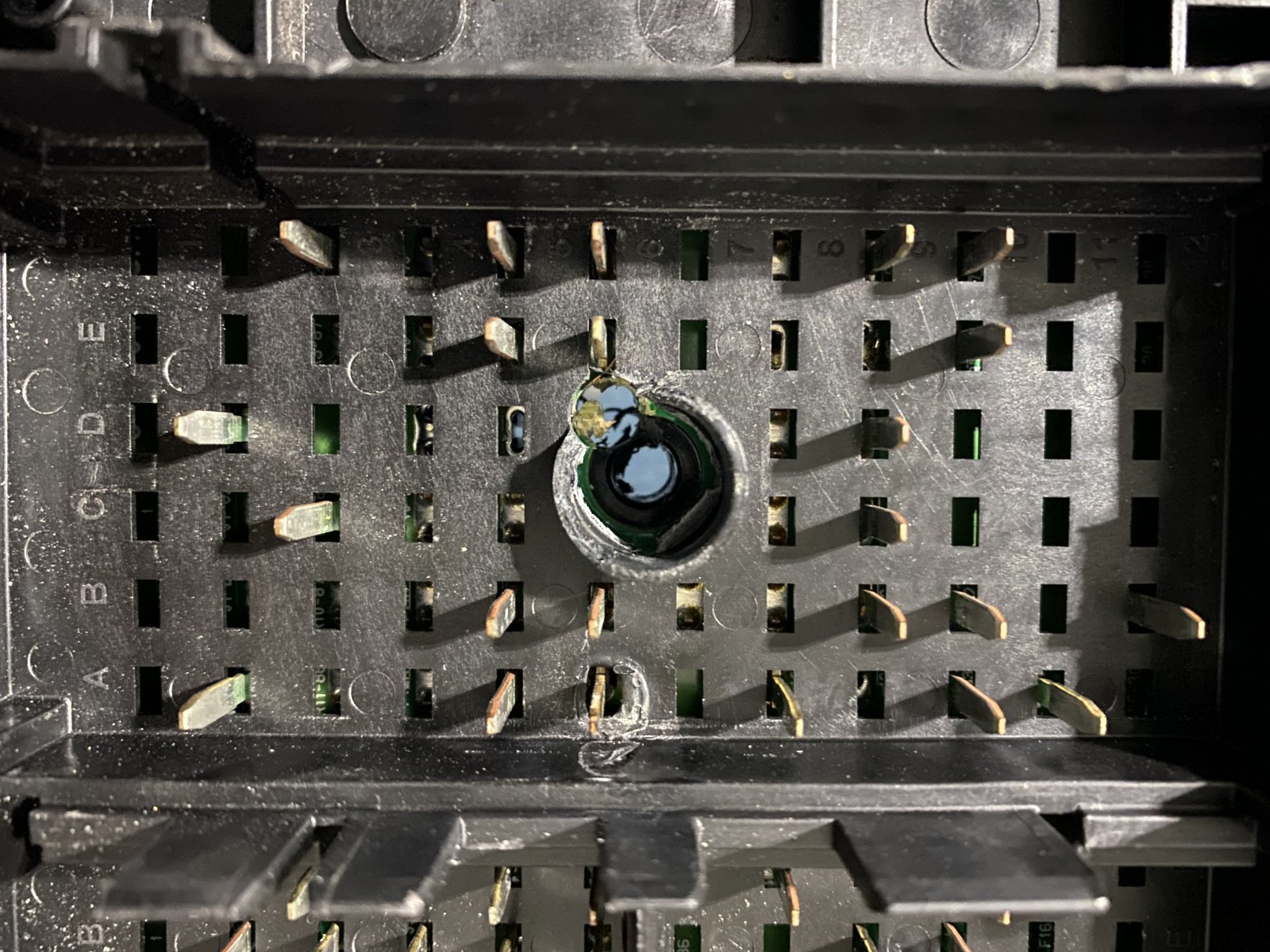

It appears to be fine. The car ran before I picked it apart, and I did my own harness, so it's honestly likely something I goofed up on along the way... although Lonny's instructions were tedious and long, they weren't too hard to follow.
The hole I drilled through was for a piece of wiring that is no longer used in the build so I may try to slap it back together for the sake of being productive during my 2 weeks of vacation while I source a new box. Not exactly a safe bet, but desperate times call for drilled-out fuse boxes for sure.
Mayor West
RIP.
The whitish part at the bottomn doesnt appear to be a melted point it's just sorta discolored.
Classy
I mean, as long as the part you drilled through doesn’t try to arc to anything else, I think you are safe if that pin goes to nothing you are using
Mayor West
Yeah I just fired it up (doesn't run still) but it didn't seem to have issues due to my drilling. I have royally jacked up that box, though. I think I will continue to look for a new(ish) one but continue to work on my issues while I'm on vacation.
At least it's not a complete loss of my time.
Mayor West
I noticed that when I first had the car and it ran fine before disassembly.
That is a thick white wire that goes to "cooling fan low ref", according to my schematics (unless I'm reading it wrong)
