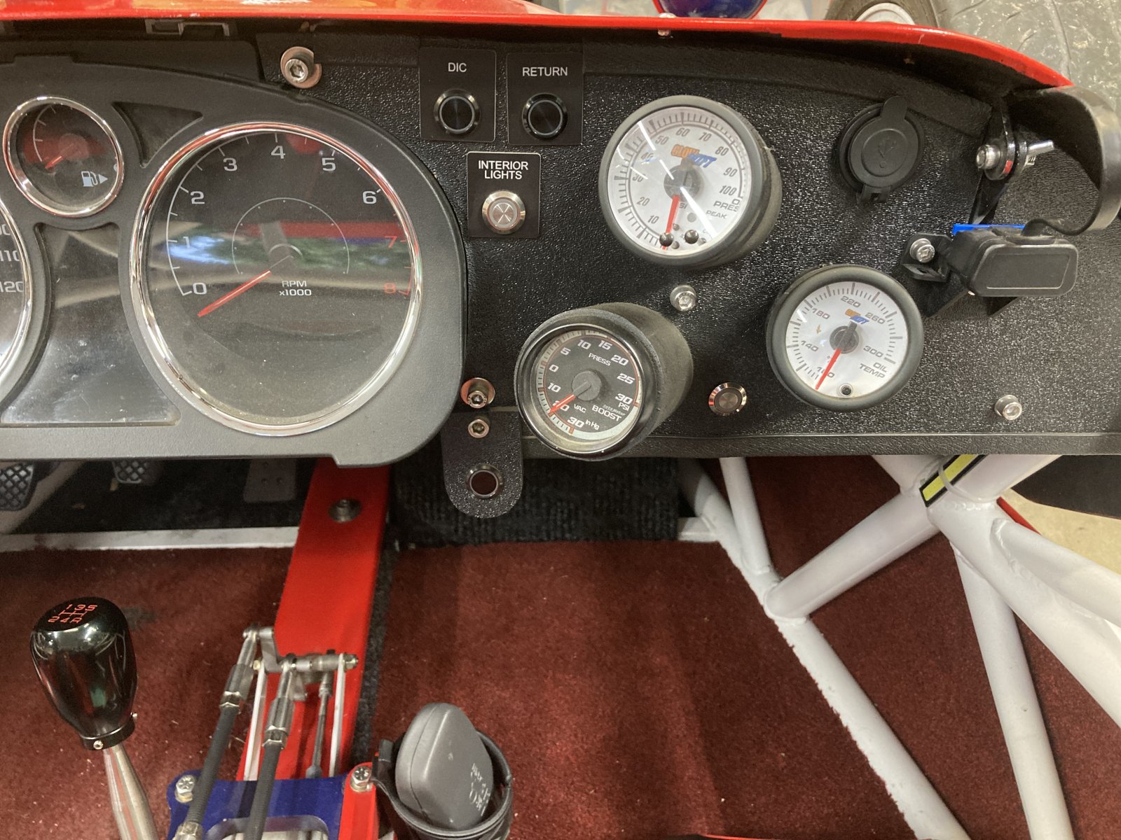

So I want to get three gauges. Voltmeter, water temp and oil pressure.
What is a good budget friendly brand? I know of Autometer and VDO but they seem pricey. There is also glowshift which I used in the past but that was mainly for a show car i built years ago.
Not ready to buy just looking at options at the moment.
I’m running glow shift oil pressure and temperature and no problems with them. The glow shift fuel pressure gauge in my vette hasn’t worked worth a flip. The sensors only last about a year.

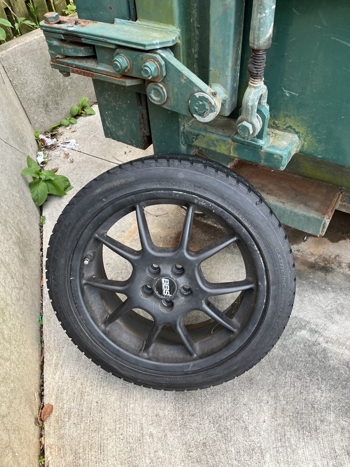

No build progress but scored some free wheels. At first glance they look fine. Gonna give them the once over later.
Don’t plan to run them permanently, but then will let me get the goblin on the ground sooner till I get the other wheels powder coated and wrapped in rubber

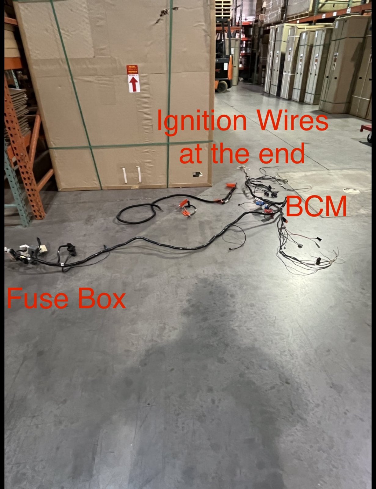

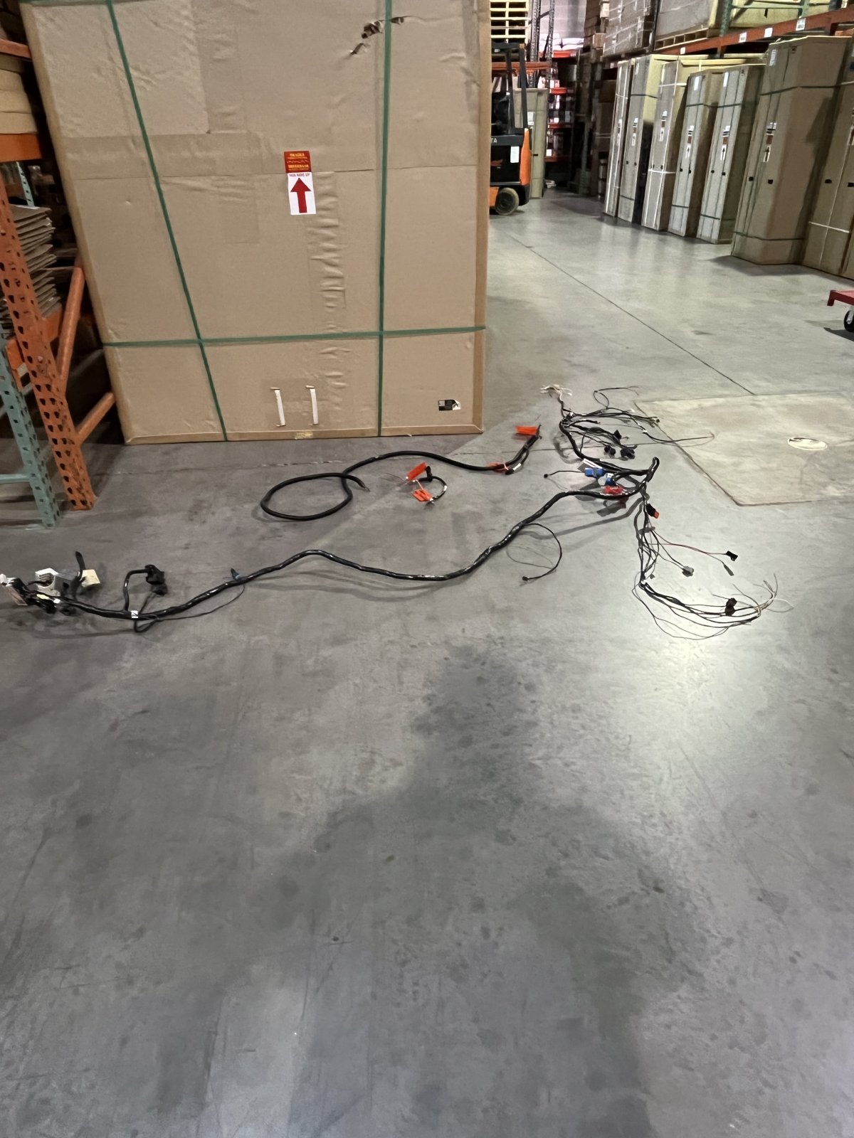

Ok it’s been a while but time for an update.
First the wheels in the previous post. I had them checked out. Two are in good shape, two are bent and have flat spots. They aren’t good for driving on the road, but they are good for driving around the neighborhood, storage and trailering. So I am gonna keep them for that usage.
Second, my wiring harness came back yesterday. Opened it up today and layed it out on the warehouse floor. Even though I knew it would be less, it’s still shocking to see how much less it is.
Of course all my label tags were removed so there will be the inevitable “where does this plug go” questions in the near future.
I already had questions about two but I will post those later. For now a pic just because.

Traé
In this situation it may be beneficial to watch the harness videos when they are laying out the measurements on the piece of plywood. It will help orientate the harness and give you a relatively close idea of what the connectors get plugged into.
it’s in the first part of this video;
The videos are also pretty good at showing connectors while thinning the harness. There a decent amount of videos but could help watching them all.

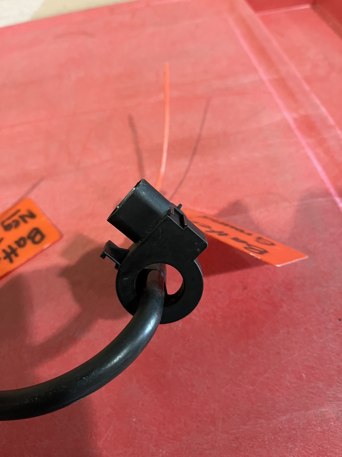

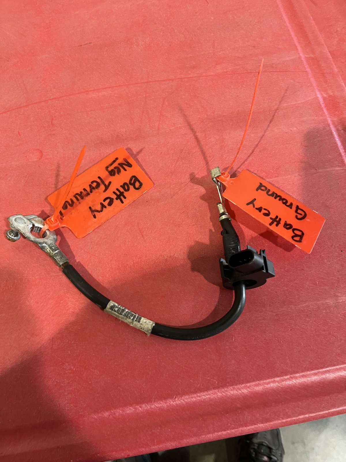

Like this one. What is this plug/ring thing on the ground harness? I don’t remember it and it looks like he spliced into the ground.
Yep, current sensor and it is in the ideal location at the negative side of the voltage source (battery) to capture total current in the system. :p:cool:
If your harness doesn’t support that voltage thinggie it can be left disconnected. Or even destroyed in removal. Just ground everything and you’ll be fine. Nice clean grounds are your friend!
