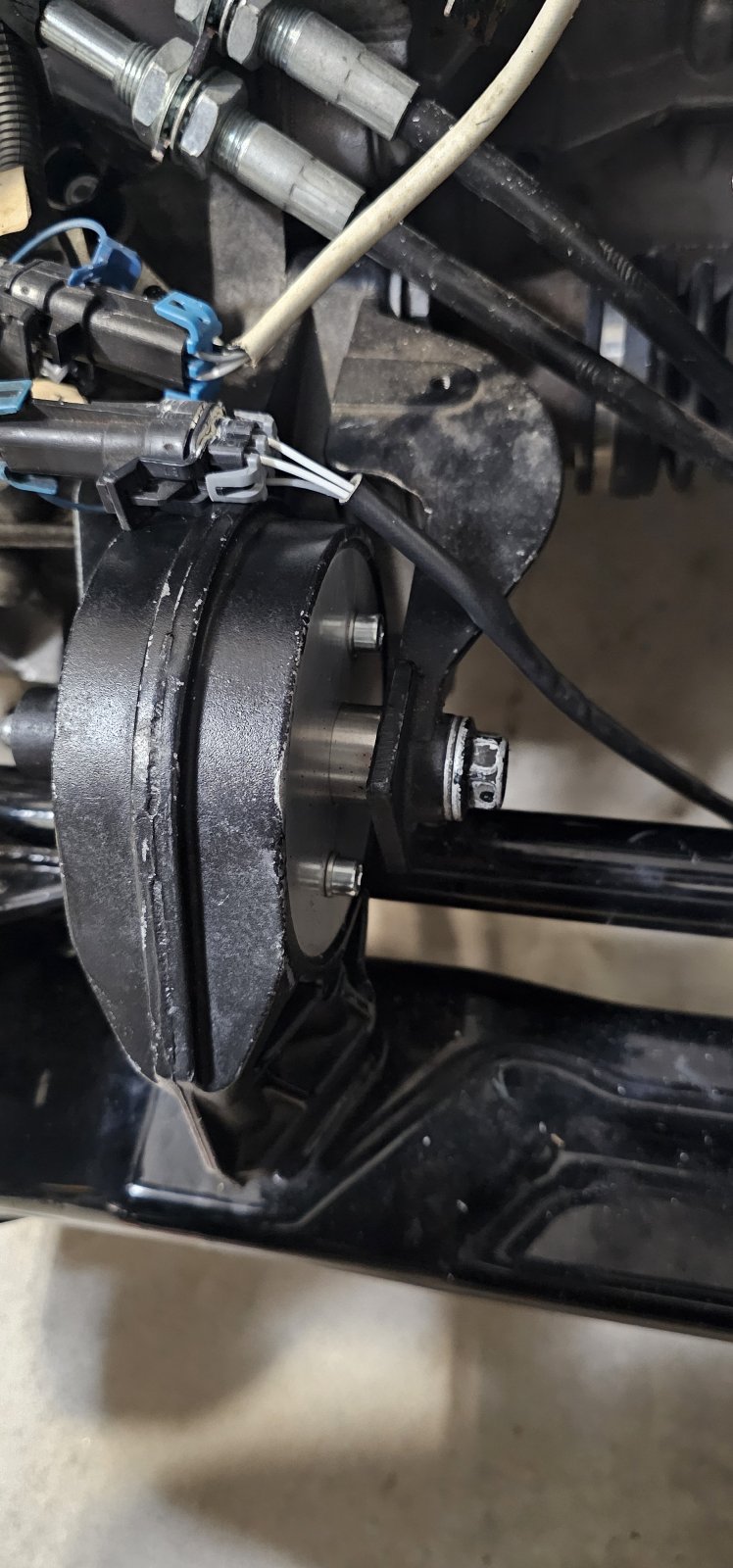

Just had a look at the old mount. I think the easiest is to press the rubber out and press a round piece of aluminum back in. I almost got the rubber out with some WD40 in my garage.

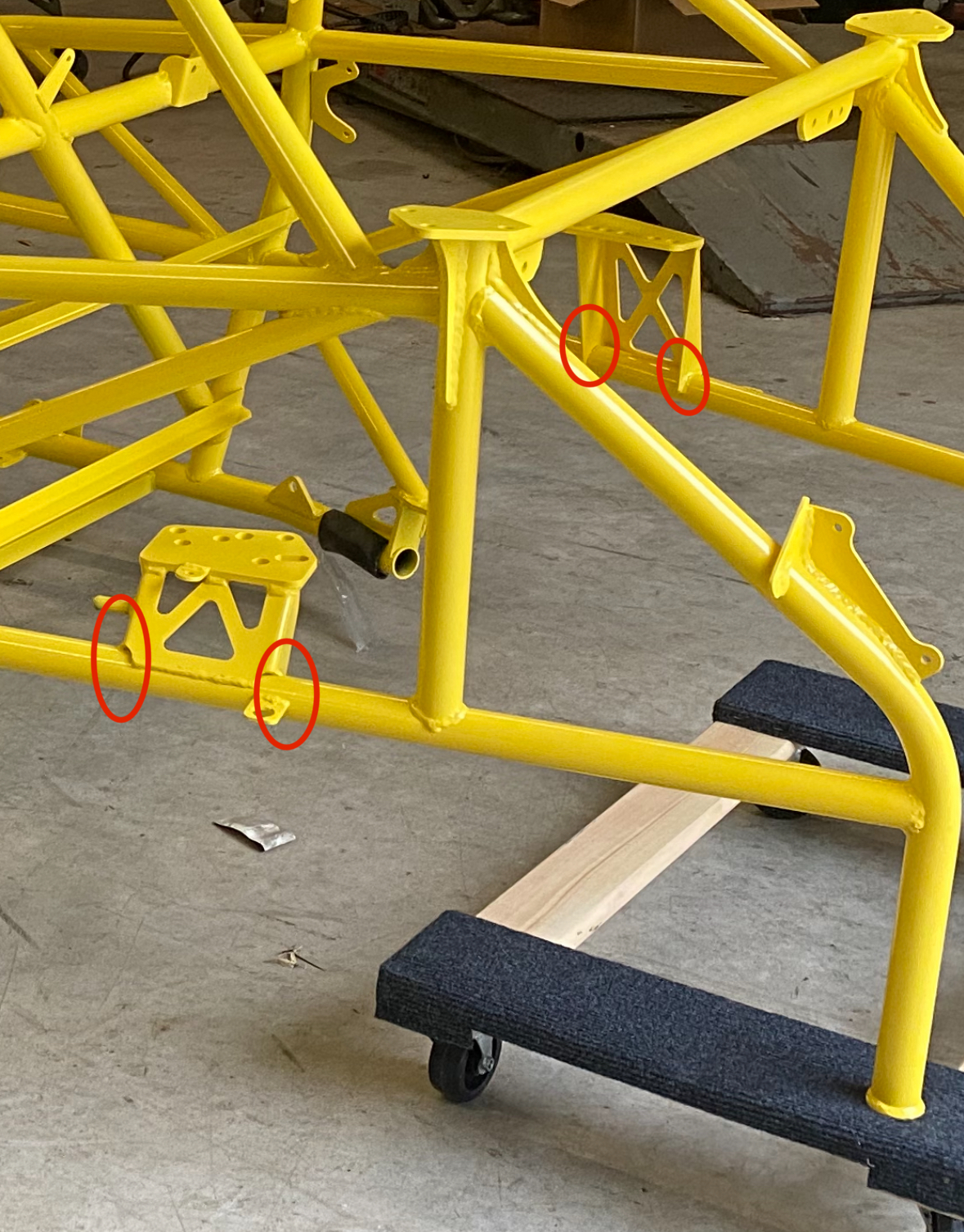

There was a goblin at goblinfest last year that he cracked the frame and welded it to repair it because he was using rubber mounts on the trans. I have both of the solid mounts for the f23 leftover cause I went with the tubular subframe

I am having a bit anxiety at the moment and checked again all rear frame part and welds. I would think the cracks would develop close to the upper mounts. Where did the cracks develop at the frame of the guy at the goblinfest?
If I remember right it was on pass side at one of the corners, but you can look where I circled red

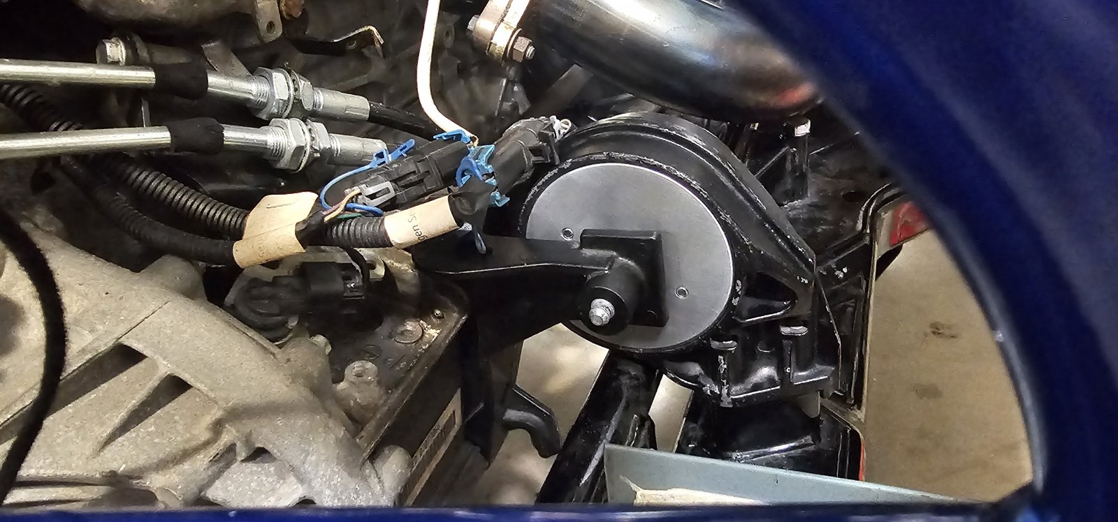

Ready to go for another test. Front mount is currently still a soft one, but I think 3 mounts will do it until I have build the front mount. If ever one wants to build one in a DIY way, the through hole is 2mm eccentric. There was no way that this assembly had 2mm play. That being said the force to tilt the engine like seen in the video must be enormous.
