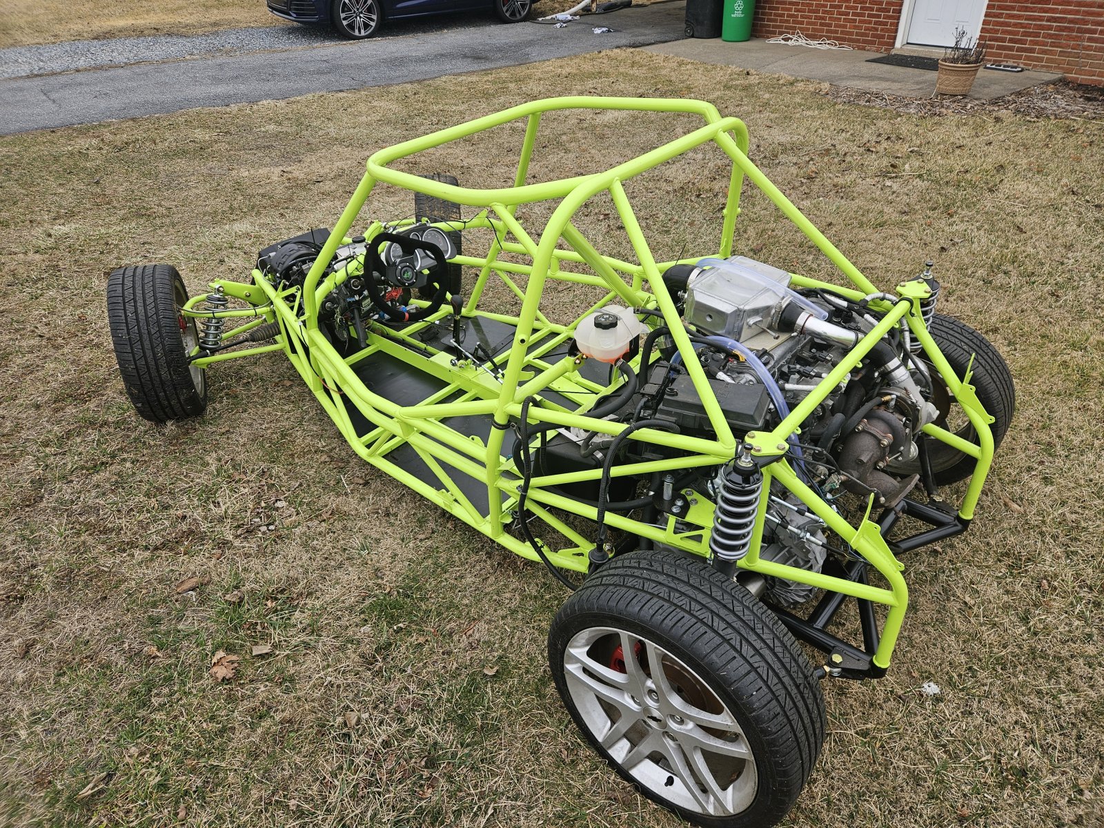

V1 Mikes Extended, Full Frame Goblin - 2009 Cobalt LS with 135k donor

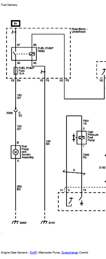

I saw on the electrical diagrams that there are 2 fuel pumps. Does the LNF has 2 or am I reading the diagram wrong? It also looks like the LNF has a fuel pressure sensor, I don't think the LSJ has that.

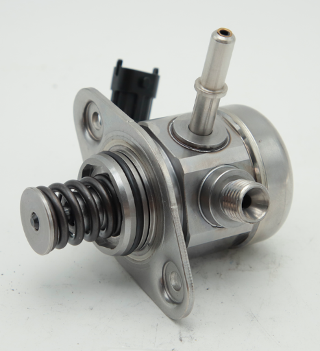

I believe the LNF has a standard, in tank fuel pump and then a High-Pressure fuel pump attached to the engine.
GearHeadz Garage just went through a HP fuel pump diagnostic, so watch that and you'll get a good idea where it is.

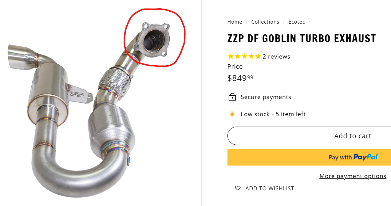

Question 3: The exhaust attaches directly to the turbo outlet is the best I can gather form the question. It looks like this below, your LSJ exhaust will not work unless you get this flange added on. ZZP sells a full Goblin Turbo exhaust for $850. At least this photo will give you a better idea of it all, the red circle is where ti bolts to the turbo.

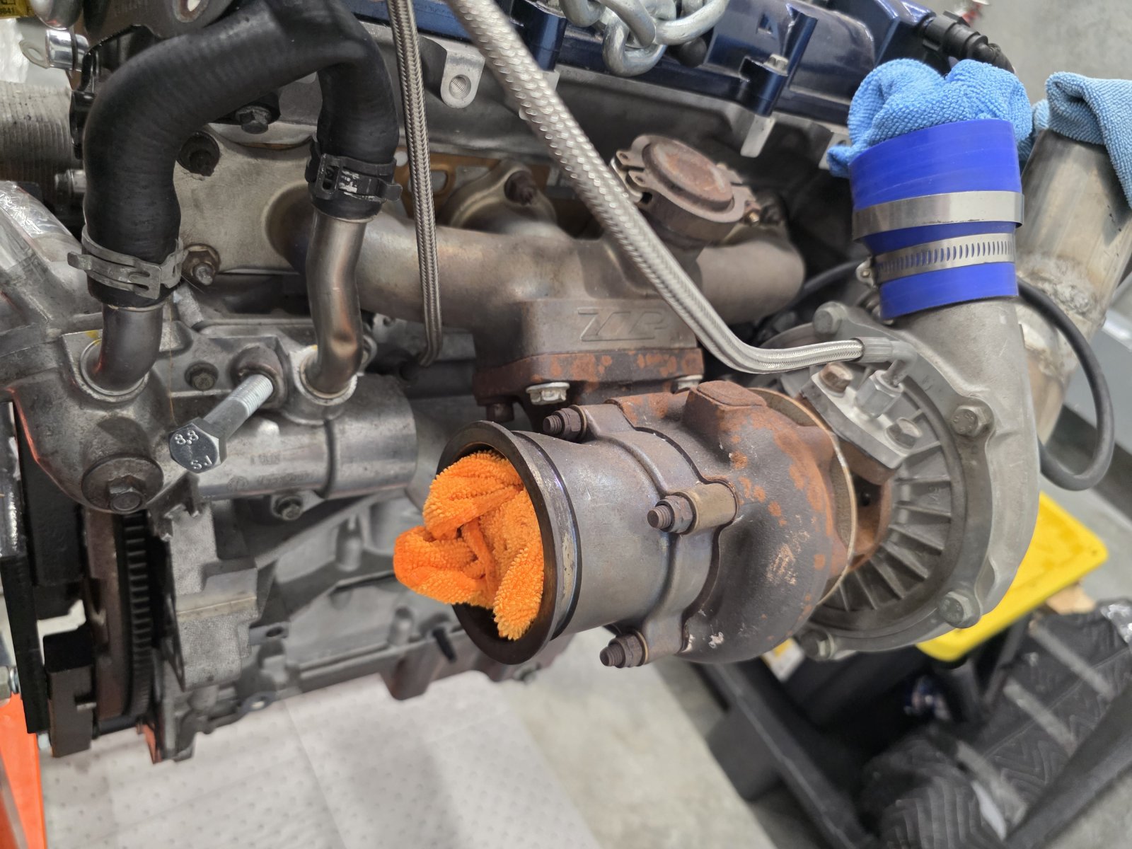

I do believe that even the ZZP has a decouple element. It looks like my turbo the flange looks different. For a hose clamp or so. Please see this picture.

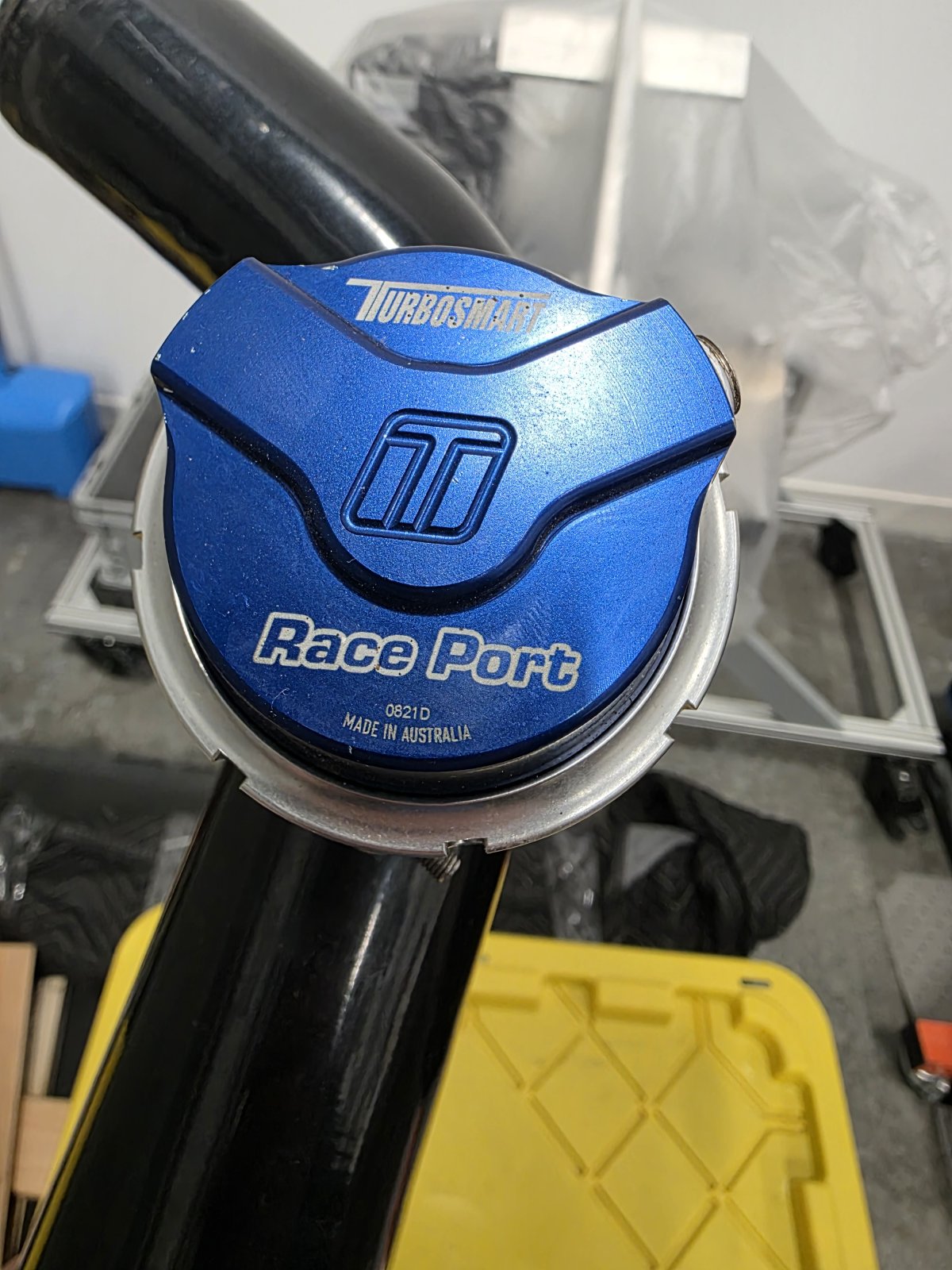

Is this part below a mechanical over pressure protection, if the throttle closes, but the turbo is still producing pressure?

Lastly what type of intercoolers are you guys using? Air to Air, Air and water,??? and where do you mount that.
Basically I need some ideas to mount the intercooler and some ideas to build the exhaust.
Your exhaust is set up for a V-band connector. Any exhaust you use will need the mating band.
The second port looks like an external wastegate V-band port.
The blue item is on the charge piping? If so, that looks like a blowoff valve. A very quick Loogle search comes up with Turbosmart Gen-V BOV.
I recommend you do a little Youtube learning about how turbo systems work. These are basic items that you really need to understand their function and need.

I currently have the ZZP exhaust on the Z57 turbo. I believe you you remove the v-bend adapter you will see the same pattern of the ZZP exhaust.

There’s a lot of options depending on what direction you want to go in. You can run the stock one up front, put 1 or 2 on the side in the back, hide them somewhere, or go big on the back. Here’s a site with tons of rads for you

Im currently using a Frozen Boost type 16.
comegetjoe
If you live in the desert and plan to push a few more ponies than stock, having a little more intercooler is a good thing. :cool: A type 15 is the intercooler of my choice.
Ok... :rolleyes:
A type 10 is a significant upgrade from a stock DFKC A2W intercooler. I know of two that are using this intercooler at the moment. You'll have to make your own mounting brackets though as the stock brackets dont fit this unit. Definitely overkill for most goblin builds.

Ever lived in the desert and survived the hellish temperatures at the end of July, beginning of August? You cannot have enough cooling capacity for your turbo engine, especially with a healthy tune and larger turbocharger. Having a higher capacity intercooler (mass) and dual heat exchangers - that will have water mist to take advantage of the low humidity evaporation - are a must have to pull the heat out of the intercooler.

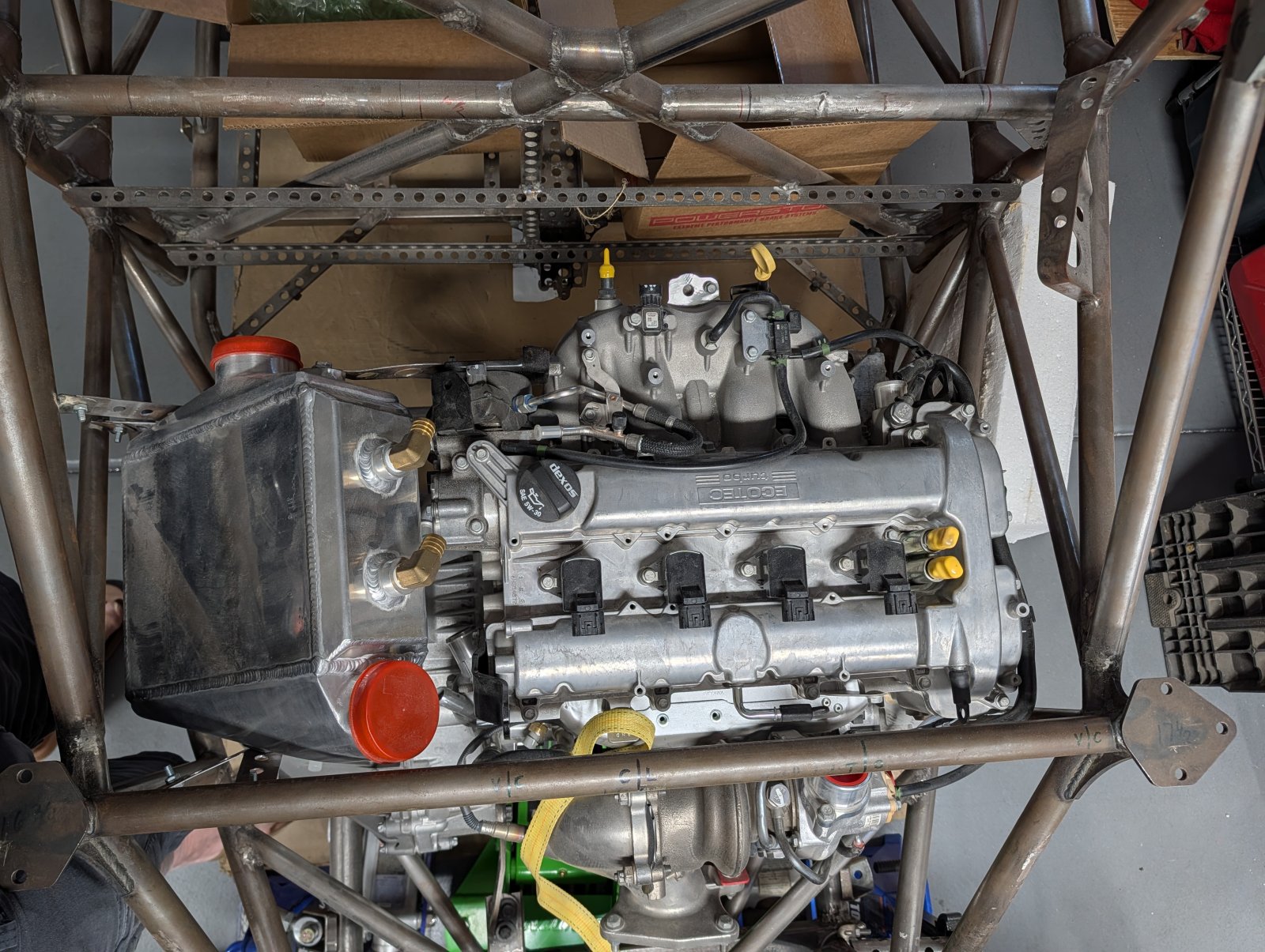

I have the mounting figured out for my larger intercooler, so this has been thoroughly thought out already including the path of the charge pipes from the turbo through the intercooler and into the intake throttle body. At some point when I get further along I will post photos of this in my build log. But here's a sneak peek:
