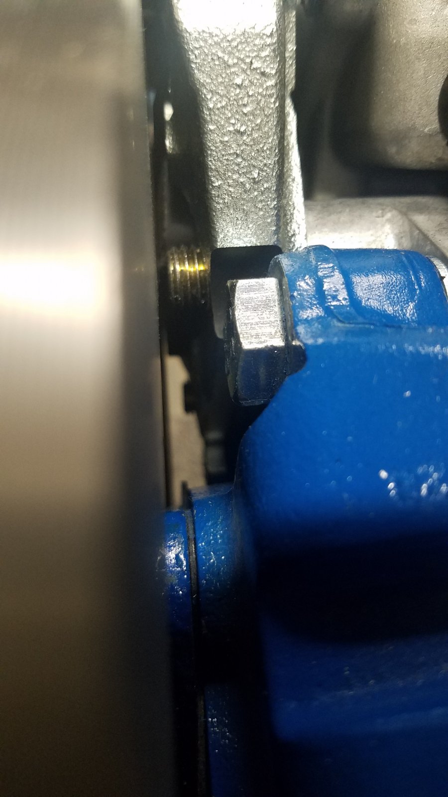

I did have a bag with 2 m12x1.75x55 bolts but they hit the back of the rotor if I don't use at least 2 washers on them. And that only mounted one caliper so, I assume I'm just missing the needed hardware for the brakes all together.

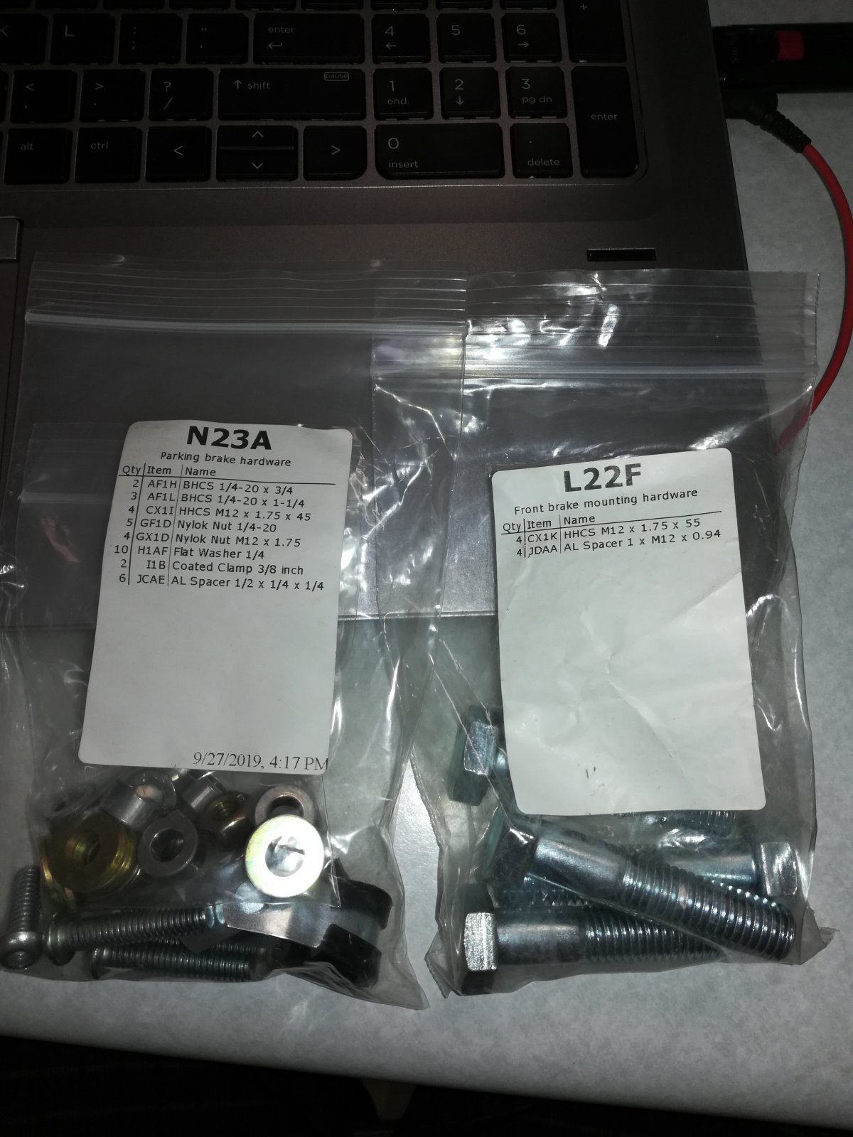

Murcielago311
Here are my brake hardware bags with the parking brake kit. The bolts that came in the rear bag I used to bolt the caliper to the machined adapters. I bought longer bolts and used the supplied nuts to bolt the adapter to the steering knuckle.

Thanks! yeah I dont have any bags like that, so I wonder if it just didn't go out in his original kit when it shipped.
I have several emails and forum PM's to the df guys, hoping to hear back soon. Thanks again for the pic!

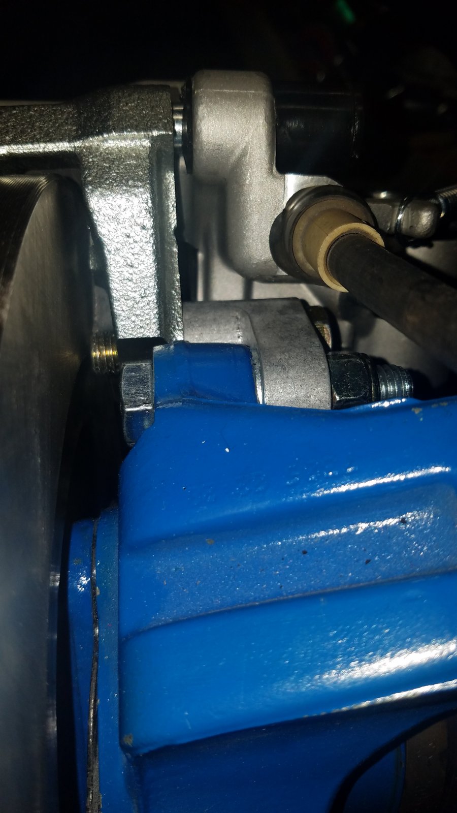

Second EDIT: what are the DF supplied rear calipers?? I just realized, and tested thereafter, that the donor mounting bolts are too short to go through the provided bracket/spacer

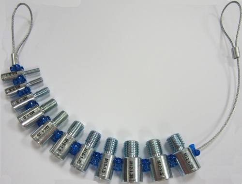

More shop tools that are almost optional:
Thread pitch identification tool is $9
Bolt diameter identification tool is $23
They are nice to have. ;)
love that optimism, every new challenge is an opportunity for a new tool

I think I will get some grade 8's from local suppliers and use them for the knuckle to bracket fitting, at least then I can have the head of the bolt facing the caliper if they are slightly too long
