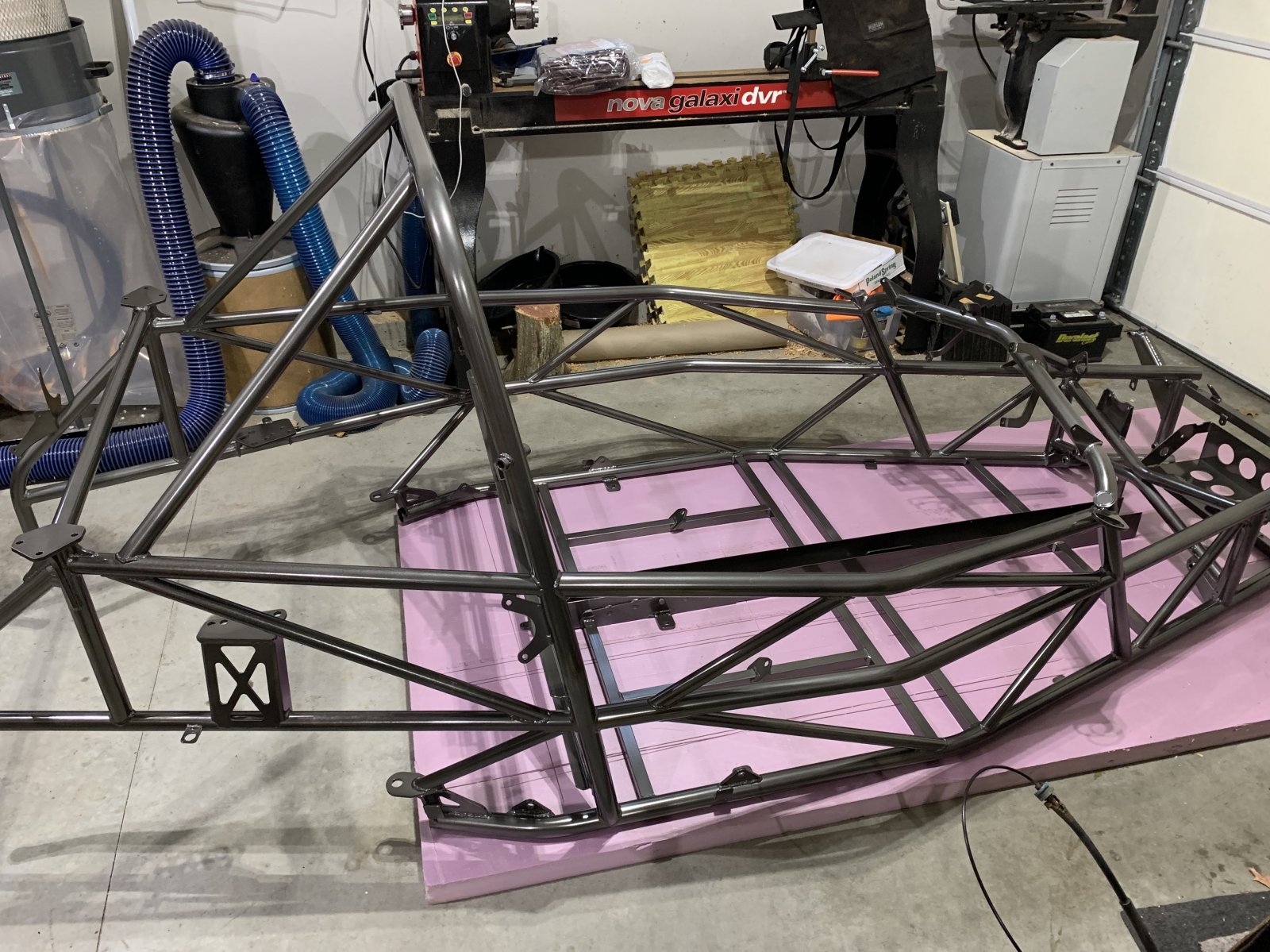

Just got the frame back from powder coating.
Not a great picture to see the color. Looks much better in sun light. The color I chose was black chrome II.
