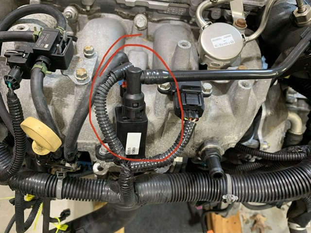

Is this the evap valve? I should remove this?
12062

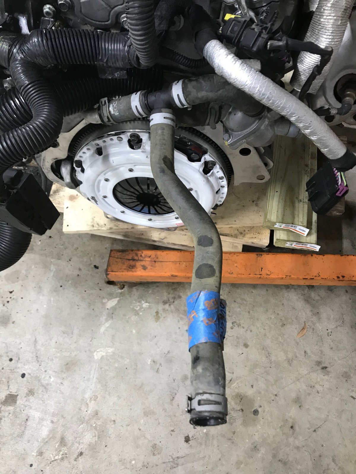

Also, my coolant hose that went to the overflow tank goes to a T. In the video looks like the tank it off the engine. Should I just remove it at the T junction?

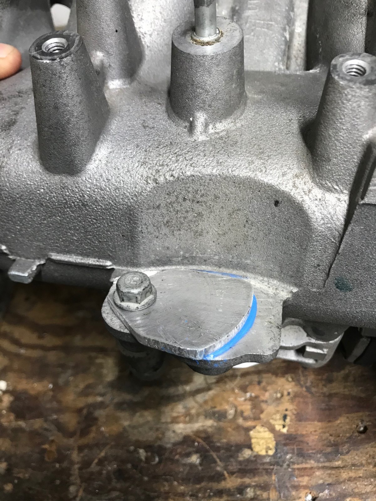

Dave: Yes that is the evap valve. I assume you are in a state where emissions will not be tested. if so, you can remove it and cap off the port.
And, i just removed the overflow into the T for now as well.

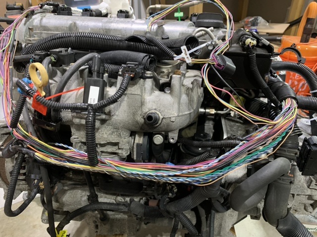

I managed to trace the MAF sensor wires to the other side of the engine. I just have to tape it up now. Trying to follow the video with engine prep... the video says to tape up the speed sensor wire. I looked for that wire where it was in the video, but I don’t see it on my engine. Do I need to do this step on the turbo engine?
