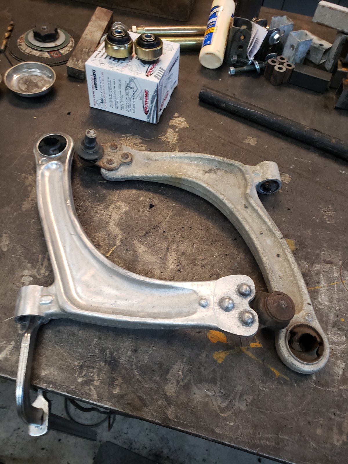

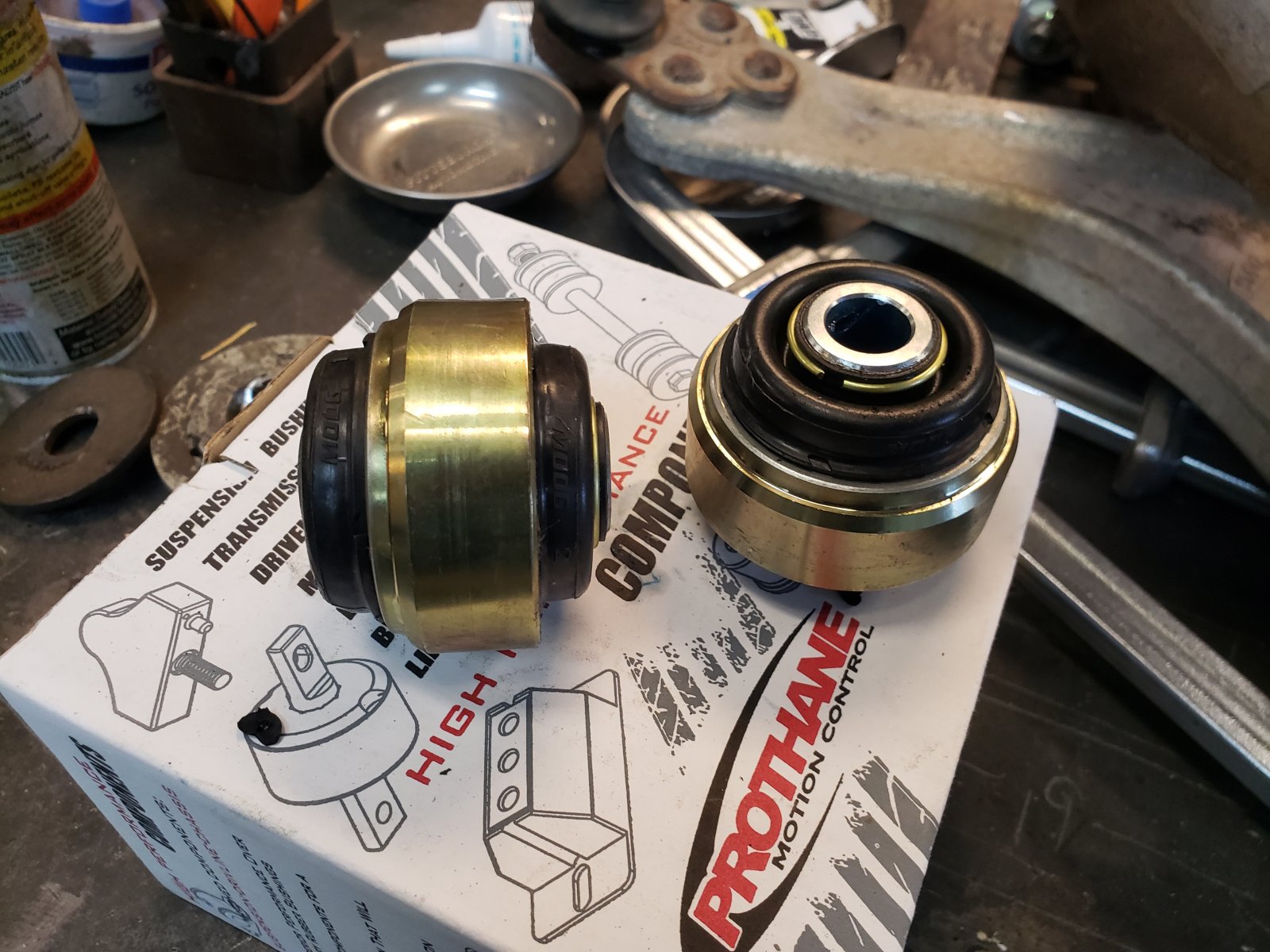

Well my temporary fix is in. the MOOG K201285 bushings showed up. i noticed they are tapered on one side and offset 1/4inch from being centered. So which goes up as the arms are fit in the car?

Does careful inspection of the original parts tell us which way the 1/4" offset goes?
LaunchPad
Not on the ones i have available. We gad to cut the control arms out of the cradle with abrasives because the metal ceters had long since disconnected from the rubber.

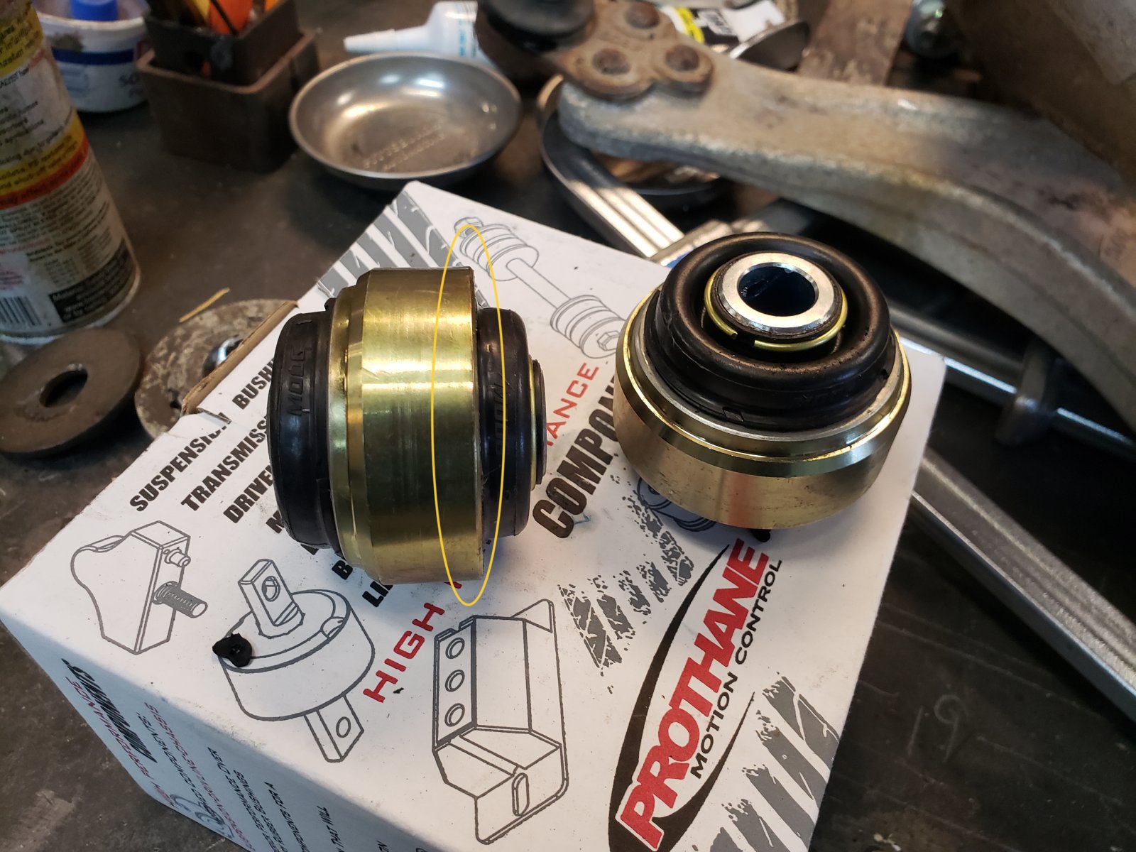

That is a good theory and i looked at it this morning when i went out. unfortunately, BOTH ends of the MOOG have the rubber U shaped like in my photo above.

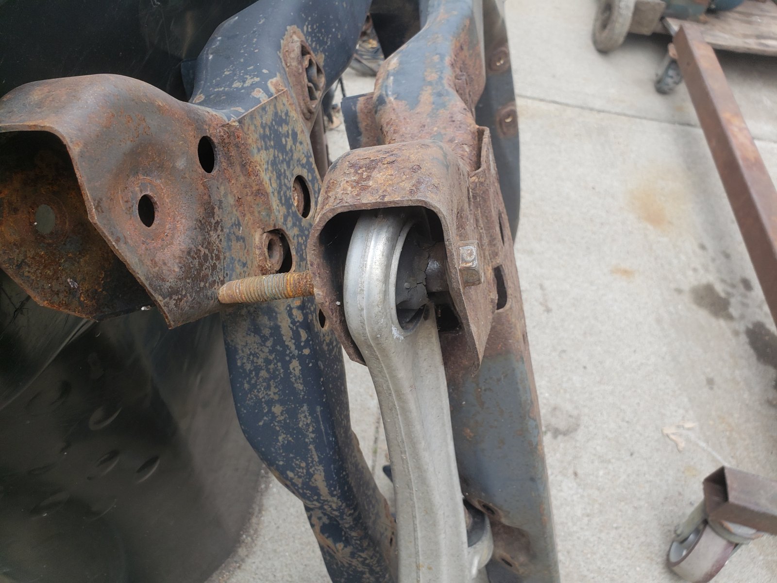

My current line of thought is to install such that the anti-SQUAT component of the control arm gets the extra 1/4 to the lower side on the REAR of the arm. I am currently perusing the site to find image of the arms mounted on a DONE car to verify what the actual rear lower IS. . . I am fairly confident i know which is which but I want a picture in hand before pressing these in because getting the MOOGs out will not be quite as easy as stock and likely expensive.

but i digress. . . still looking for good top down photo of arms installed on the goblin
I don't remember overthinking the Moog install. Tapered in goes in first, stop when the bushing is centered. Don't think it matters which end is up.

Well the Moog joint is a full 1/4" off center so getting it in backwards does change things by a full 1/2". height difference between front of control arms and back of the control arms. At the very minimum I am 100% positive I want the left and right sides to match- at least my error will be consistent left to right of the car. LOL

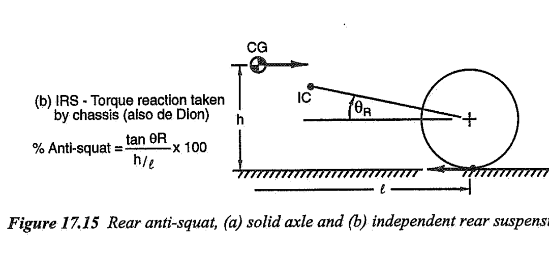

A plane that is perpendicular to the strut's rod axis, that intersects the upper pivot point, is what would be the upper control arm plane for doing geometry calculations. A plane that goes through the 3 joints on the lower control arm is it's plane. The side view plane goes through the center of the tire contact patch. Where these 3 planes intersect at a single point in space is the instant center (IC).
Then anti squat is just:
43541
where "l" is the wheelbase.
