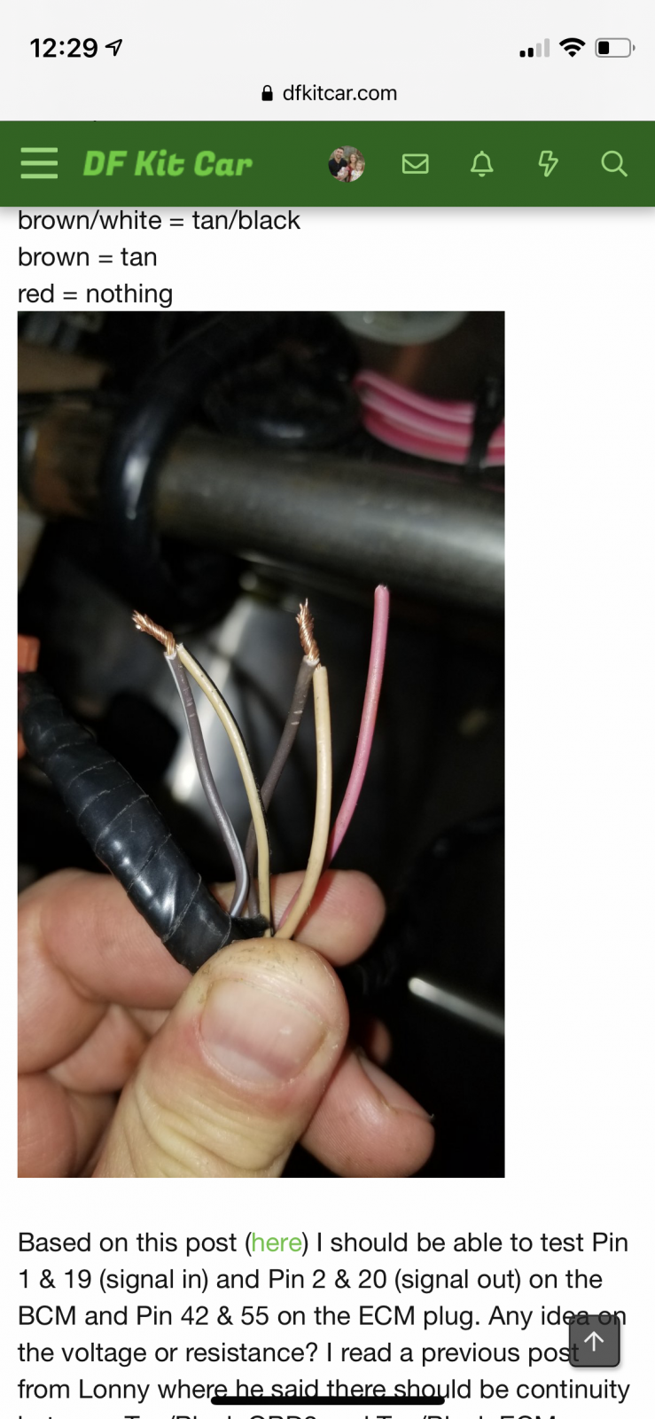

You still don't have data flowing on the GM high speed LAN.
Do you have access to an electrical diagram for your car?
I would trace the GM high speed wires, and try to find where the data issue exists.

I tested my high speed data wires in the car, using a meter. No point in taking the harness out to test the wires.
Did you modify the harness? Just want to make sure that when the EBCM (electronic brake control module) was removed, and the VCIM (vehicle communication interface module) was removed, that the high speed wires got reconnected.
My LSJ engine will run (but not key start), if the high speed wires don't communicate to the power steering and OBDII port, but I think there is still communication between the ECM and BCM. Not sure on the LNF.

This is exactly what my issue was. Connect those wires in the picture like I have listed as your #1 priority - since you've removed the power steering you've lost a connection in the daisy chain.
If you've wired it and your RPD does not show a red SS loading screen and then show your gauges check the plug into the RPD screen itself.

I see. I may need a little guidance on how to test that. Yes I did the harness myself. I remember soldering the high speed data wires from the ECM to BCM. I have a multimeter but I’m clueless on how to use it. I think I can find the correct pins for the ECM and BCM as well as power steering and RPD. I just don’t know what setting to put on the multimeter. I know how to check for continuity with grounds. Is it the same process? I’m also wondering how you would reach from the ECM to the BCM with your multimeter prong wires being so short. Sorry, so new to all of this stuff.
Okay I will try this. I did just plug everything back into the power steering module but it didn’t seem to make a difference. Your saying that by doing what was done in the picture that this would potentially make a difference?

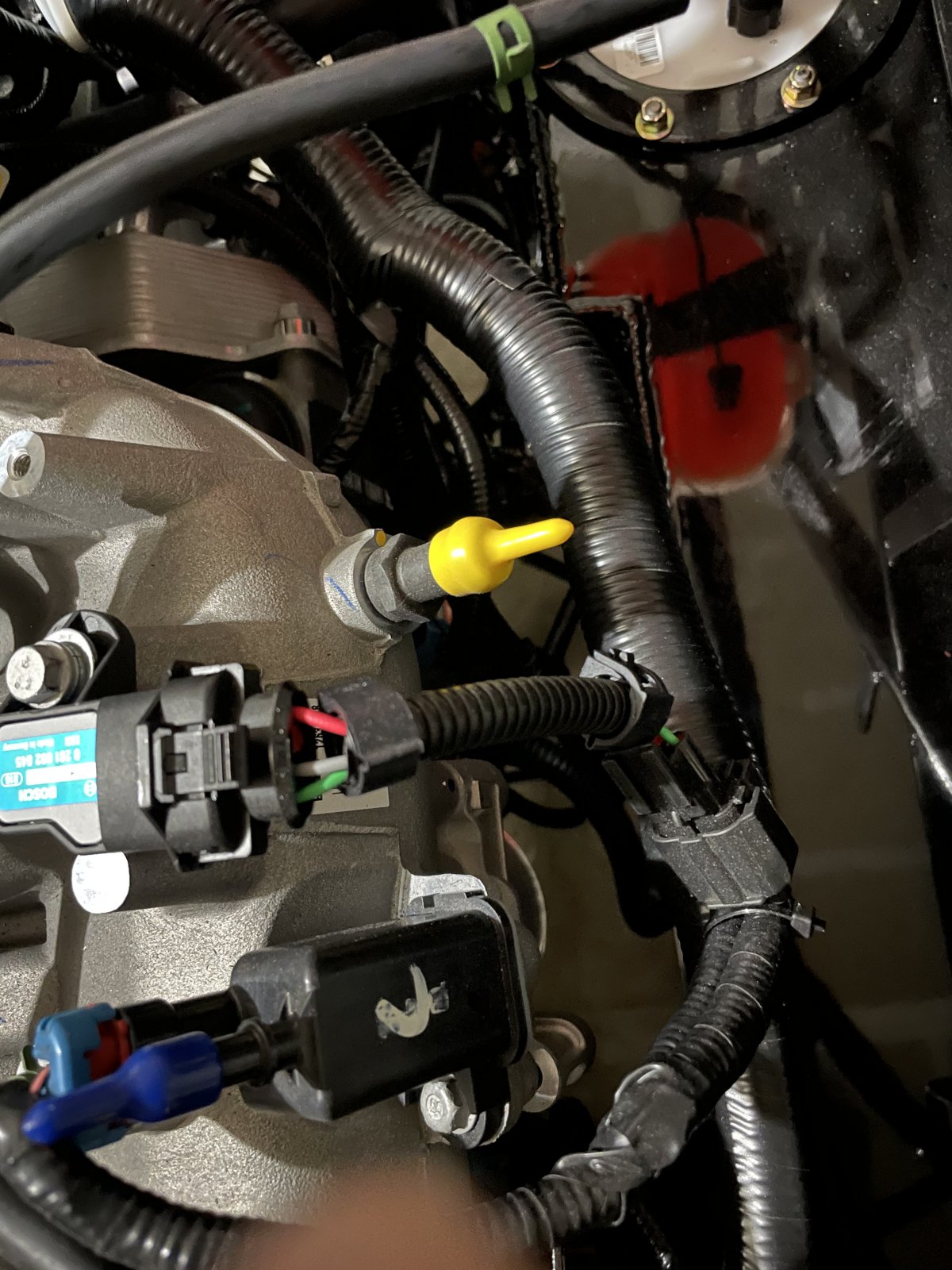

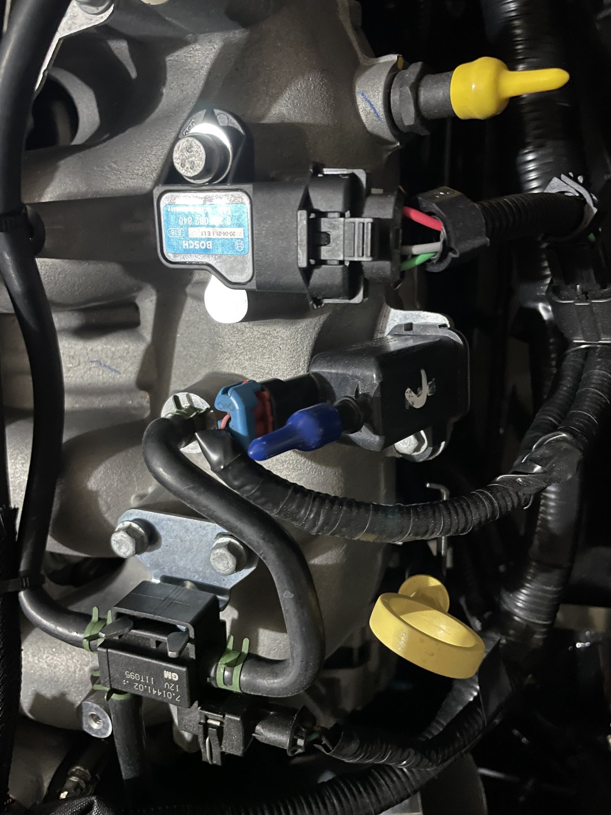

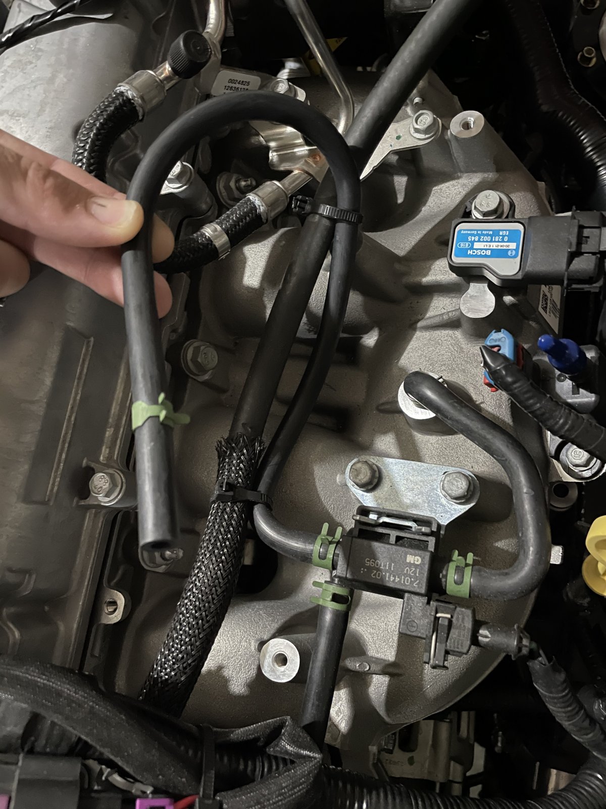

These three things are not plugged in. The blue and yellow cap and the vacuum line. Not sure where they go.
First pic (the open vac line) goes to your intercooler pipe right next to your map sensor - there's a brass nipple you screw into the intercooler pipe
Second pic - I'd assume you're referencing the blue cap. This is for evap, you want it capped off but it doesn't matter if you have the plug connected. The cap should have a clamp on it as boost will send this cap to pluto
Third pic - The yellow cap goes from your intake to your brake booster. If you have your brake booster (and not full manual with a wilwood reservoir) it'll help with braking ( with a vacuum regulator).
Basically I'd hook your intercooler pipes up with all your sensors & maf and close up these boost/vacuum leaks and you should be set (assuming your ps is rewired)

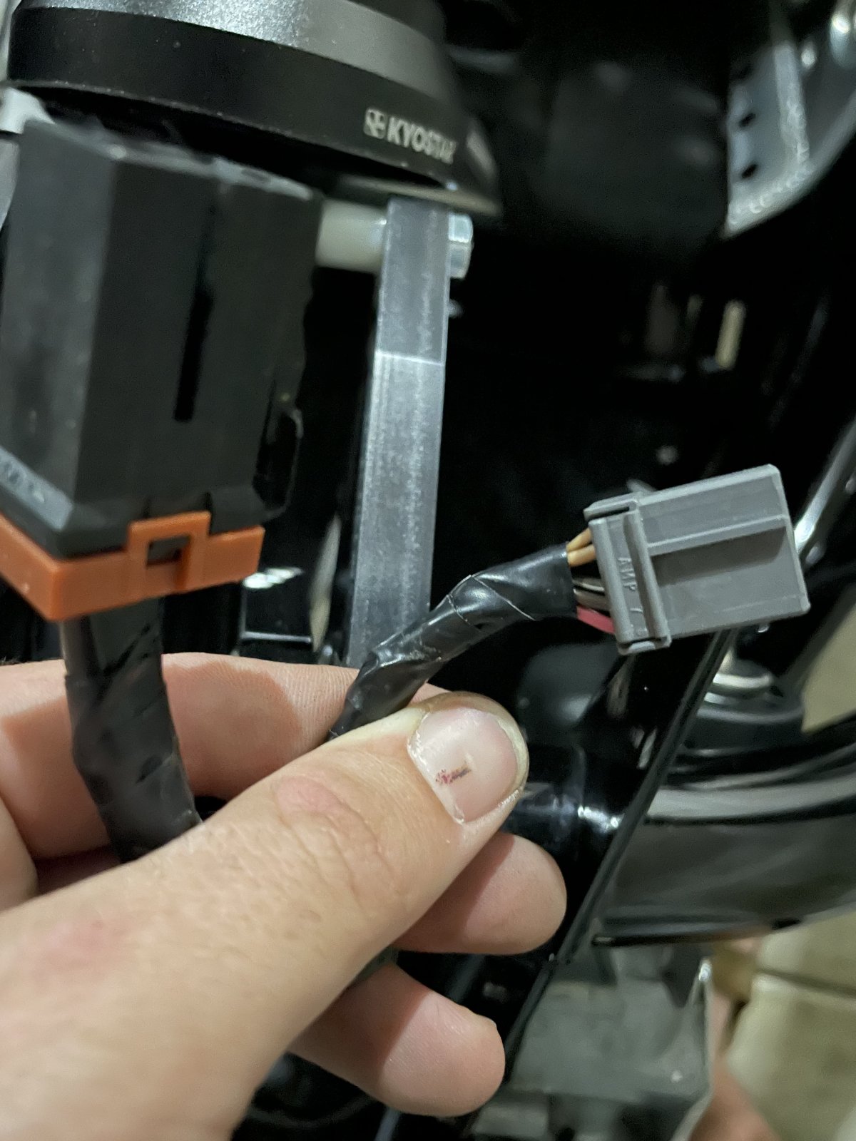

Thank you!! And do you do anything with the bigger plug in this picture? Or did you delete the ps module all together?
