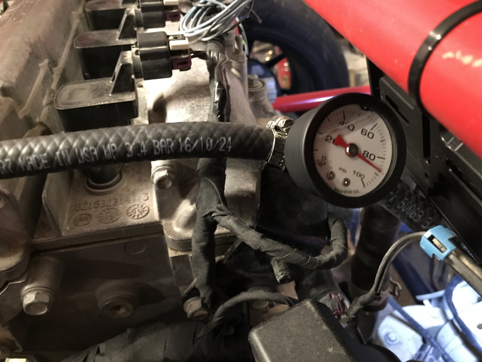

I have wondered about that myself. When I press the valve in only a few drops comes out. Even after the pump has primed and the line is pressurized.
While I would agree you should attach or buy a gauge (the fuel rail valve is -4an making it very easy to adapt) I don't think your problem is with the valve.
I put a gauge in my actual fuel line, and run the nitrous fuel supply from that valve with the plunger removed.
Edit: the pressure is rarely that high. I happened to take a picture right as it was priming. It settles on 55-60 once running.
JSATX
Well I guess this would be a problem lol......
Now what the hell could be causing that out of nowhere. I think I'll go buy another new fuel filter and start there. The fuel pump and filter are both brand new not reused from the cobalt.

Not all fuel gauges will depress the Schrader valve. Are you sure it's being depressed? I'd remove it all together to make sure because depressing it all the way can also mess up your readings.
