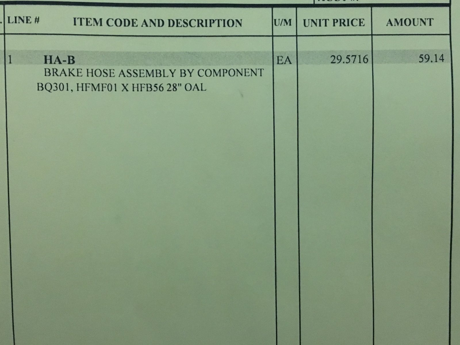

Here is a copy of the invoice so that you can see the connectors that they used on the brake lines.
Nuker-

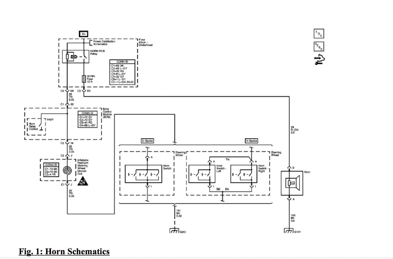

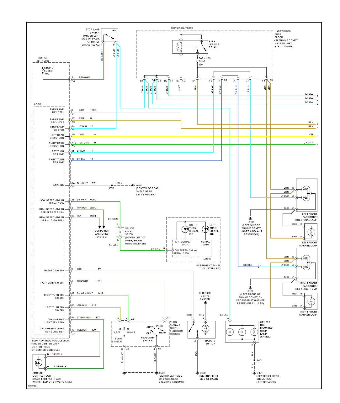

Also I'm having a time with the dash buttons. Anyone recall which color wires go to what? I really just need to get the horn and hazard buttons going for inspection.

Going to finish horn/flashers god willing tomorrow.
