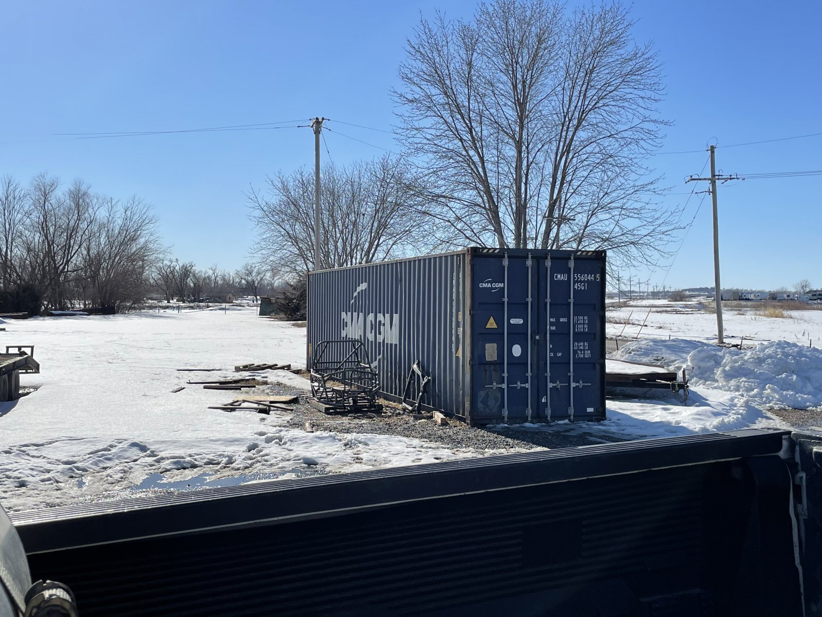

Brown Santa came today
Sand blasting is done frame is ready to go to galvanizing.

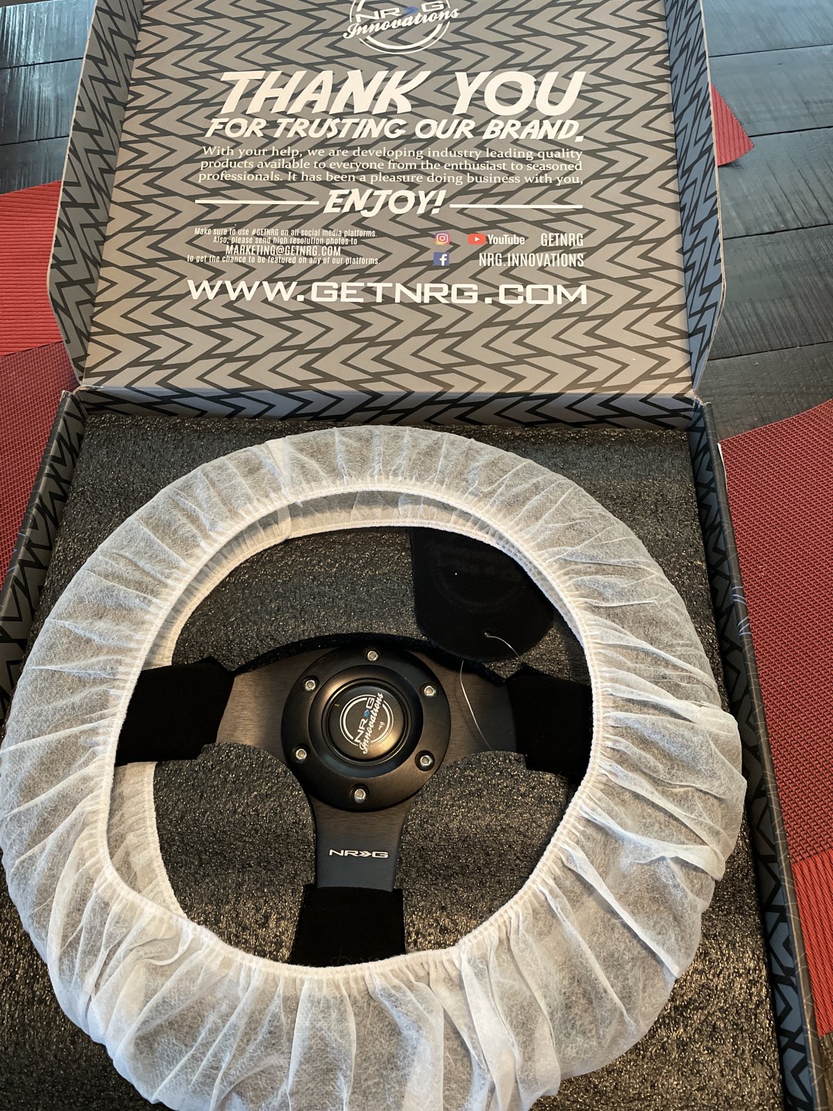

Just noticed, you and I picked up the same wheel. I really like it. Picked it because I was concerned about how close the wheel would get to my chest and didn't want to modify the steering on the Goblin. The wheel is flat, as opposed to deep-dish, so it only gets about an inch and a half closer to your chest than the stock setup. Looks great, too.
I got it so the quick connect didn’t push the wheel into my ribs.
price and style were also significant factors.
I wanted a suede wrapped wheel with some style and didn’t want to spend $300+

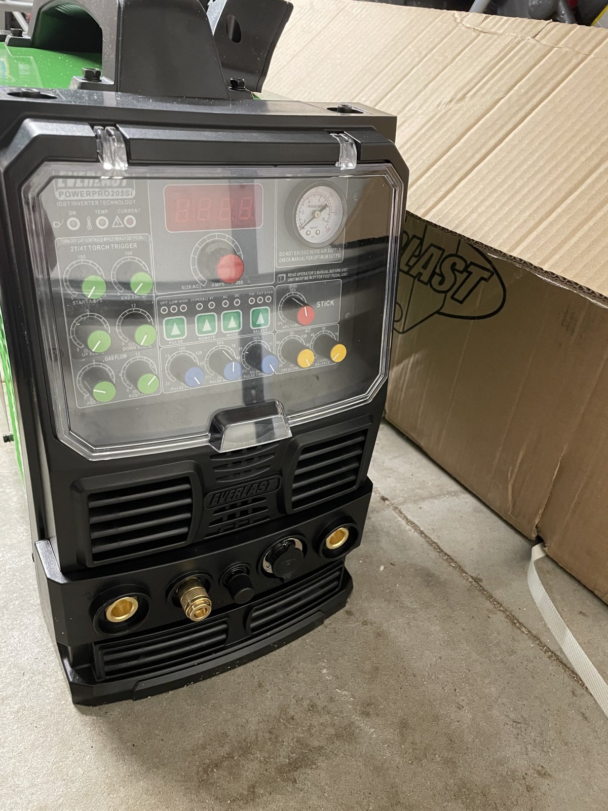

And another toy showed up. On paper it isn’t for the goblin project though I’m sure it will come in handy. Actual purpose is welding aluminum buss bars for a massive LiFePo4 battery pack that is going into a bus project a family member is working on.
they bought a 1969 MCI challenger and it is going to be a home that will drive it’s way to a farm in Nicaragua! Solar is a must on this trip. Maybe I can talk him into sending some pics for the “other builds” section.

I have an Everlast 205 TIG, Really nice welder. Miss my Miller syncrowave 250 water cooled, but the space savings makes up for it.
pisco
I plan to diy a water cooler. Have had a CK-20 flex on a shelf for years from when I worked in a bakery. We couldn’t have any exposed threads and everything was stainless or aluminum so we welded our conduit racks from stainless unistrut.
The comfort and compact head on the water cooled torches is amazing.
probably going to take a few weeks to shake the rust off my technique.
