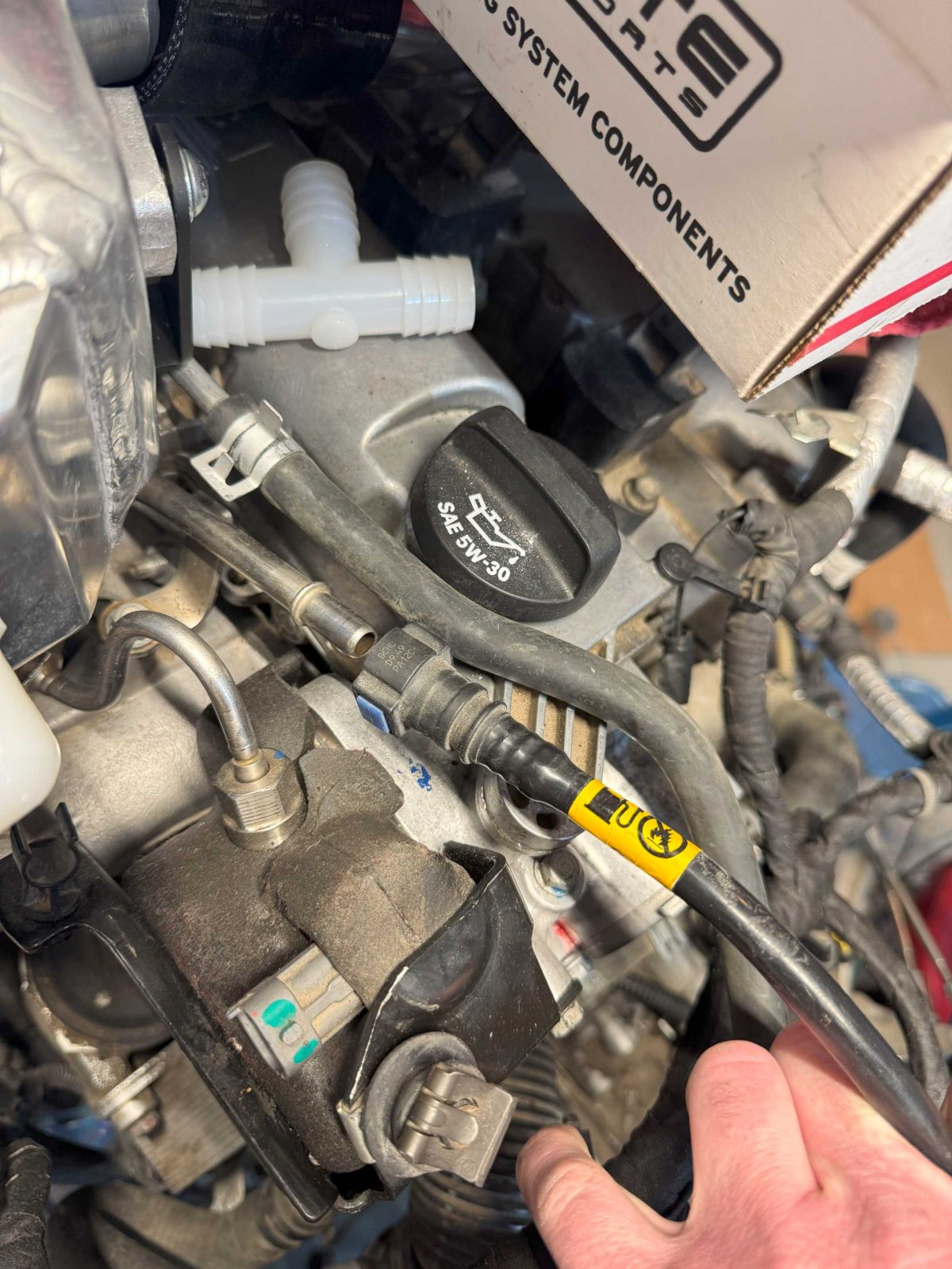

I want an honest opinion as I'm waffling on this one.
I picked up an ethanol content monitor and have to decide how to install it.
I'm debating between adding a T fitting at the connection to the high pressure fuel pump and drain back to the tank with a restrictive orifice to limit flow and allow pressure to build, or a separate loop with an independent pump and its own draw straw welded into the tank.
Option 1 seems more simple but I may be overlooking something
anybody care to chime in with an opinion?
Either way I need to do this sooner than later as I don't want to weld on the tank after fuel has been in it.
Why would you not simply put it inline? Is that not how GM did it on flex fuel vehicles that actually used a sensor?
I don't know that there is a way to tune an E69 ECM for truly being flex fuel, at least with HPT. Have you figured out a way or just going to run different tunes?
pisco
Yeah the idea was just a dash indication of concentration rather than testing a sample every time I fill up but it will also serve as an indication of water in fuel and give me accurate numbers to use for tuning.
I don't know why I didn't think to just put it in line with the fuel delivery.. I want to put it on the high pressure side to watch temp before injection but no way it can handle it.
pisco
I guess I wasn't entirely clear with my initial post. I wasn't sure the sensor could take injection pump pressure, I had looked up installation and inline on the return side or supply for carbureted systems. I don't want a catastrophic failure/fuel leak especially 16" behind my head so I tried to look up pressure ratings and couldn't find any, E-mailed Innovative Motorsport and got a response today. They also don't know pressure ratings, they use a continental oe part and ratings are not publicly available.
comegetjoe
Gotta love it when they sell parts that they don't know specs on. Or when you have to cross reference websites to get 1 complete listing.
How big is it? Unno
Whats this or that? Unno
How high is this rated for? Unno
Why are you wanting to measure fuel temperature anyway? What are you doing with that information? And how would you make the connections on the high pressure side that would not leak?
pisco
I was just curious what the temp is after running through the HPFP, and if that had a noticeable effect on power.
I'm worried it won't handle the pressure between the 2 fuel pumps (60PSI from what I can find) in the directions it says to install in the fuel return line. Since we don't have one I wanted to make one without compromising the current fueling setup. High pressure side is not getting cut into, it would be far easier to attach a Thermocouple or RTD to the fuel rail.
I would research where the oem installed the sensors. GM has used continental sensors and since they don’t have a return on most vehicles it should handle the 58psi ok.

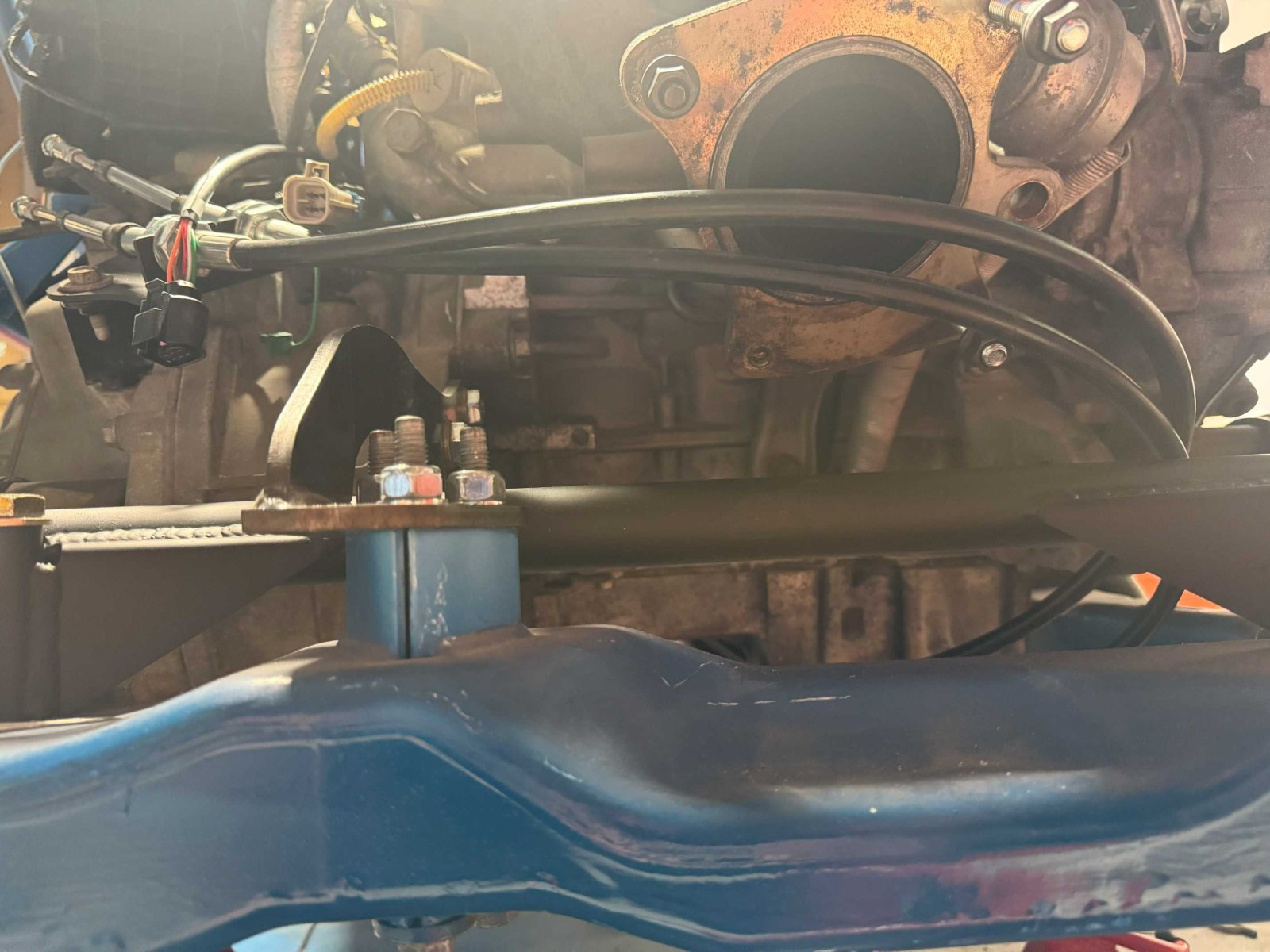

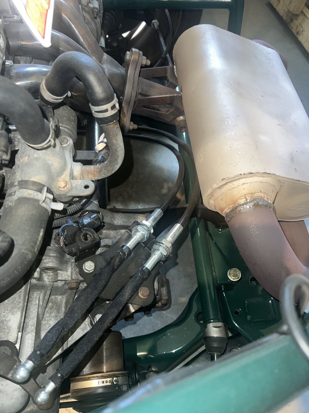

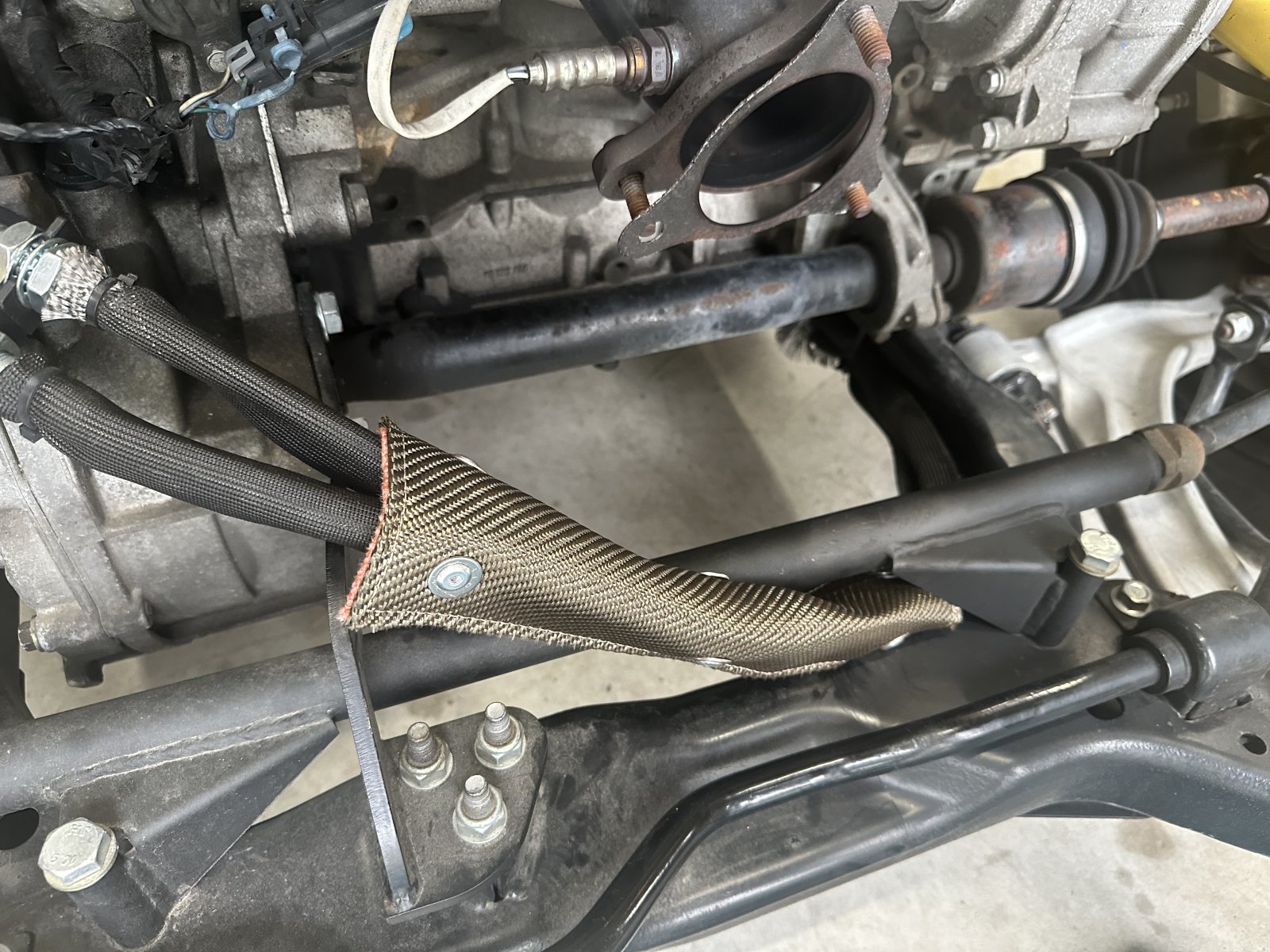

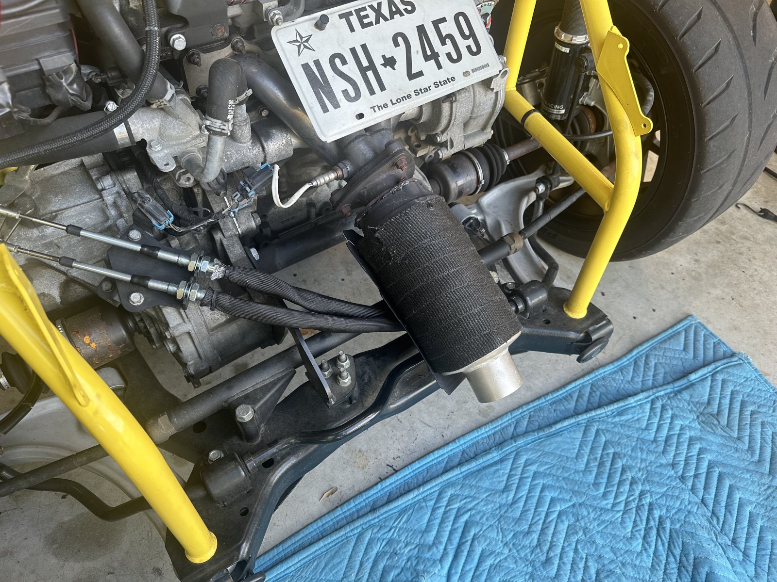

This seems like a problem routing them under the exhaust pushes them fwd to where the shifter is under the gauges,
to me the cables seem too long unless I'm routing it completely wrong
Traé
Force them down and to the passenger side of the engine, they kind of just hangout there against the subframe. I don’t think I zip tied anything but can check tomorrow when I am home and send you some pictures.
*EDIT*
I did zip tie them to the subframe and ran them in front of the toe rack.
51931
51932
pisco
ok thanks guys I was trying to run up the other side of the oil pan for some reason this helps alot
