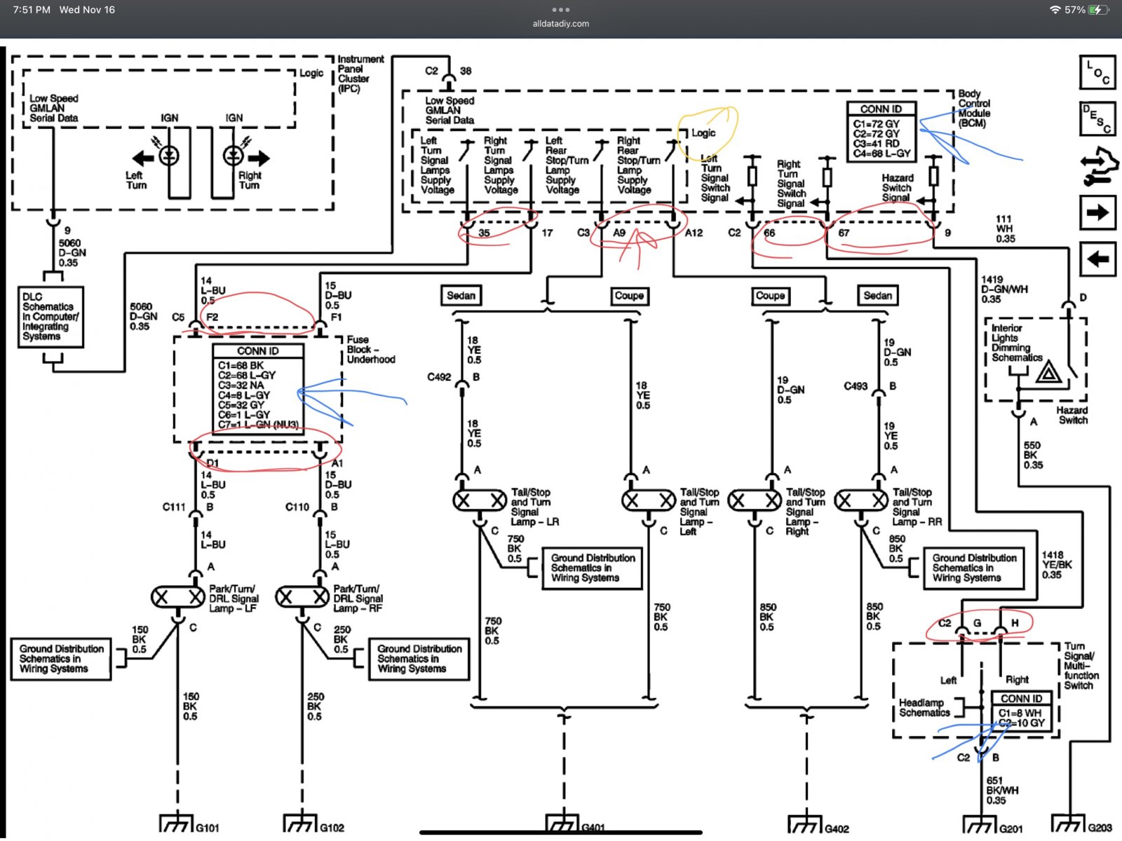

Can someone help me read the OE wiring diagrams? I did my own harness but I am having issues with the Turn signal wiring. I am not really. understanding the Alldata diagrams. Such as the one attached. I am not understanding the symbols and numbers. The box that says CONN ID does not make sense to me. I see the Plugs as J1 and J2 on the BCM. Somehow I guess the plugs are called X1 and X2 on the schematics? Im so confused......
The connectors that are connected with dotted lines mean what???
How should I read the CONN ID boxes?
What does the "Logic" part mean?
The Red is the Connectors??
The Yellow is the Logic I dont understand
Blue is the CONN ID box i'm talking about.
IF ANYONE CAN HELP ME BY SENDING ME A SIMPLE DIAGRAM FOR "ONLY" TURN SIGNAL WIRES THAT WOULD HELP ME :)
Conn ID = Connector identification

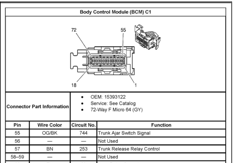

C1 is a 72 pin grey connector.
C2 same,
C3 41 pin red connector.
37036
37037
The dotted lines are wires that are all on the same connector. One of the wires will mention the connector, eg: C1.
Logic just means there is a computer inside, that has some programming logic to it.

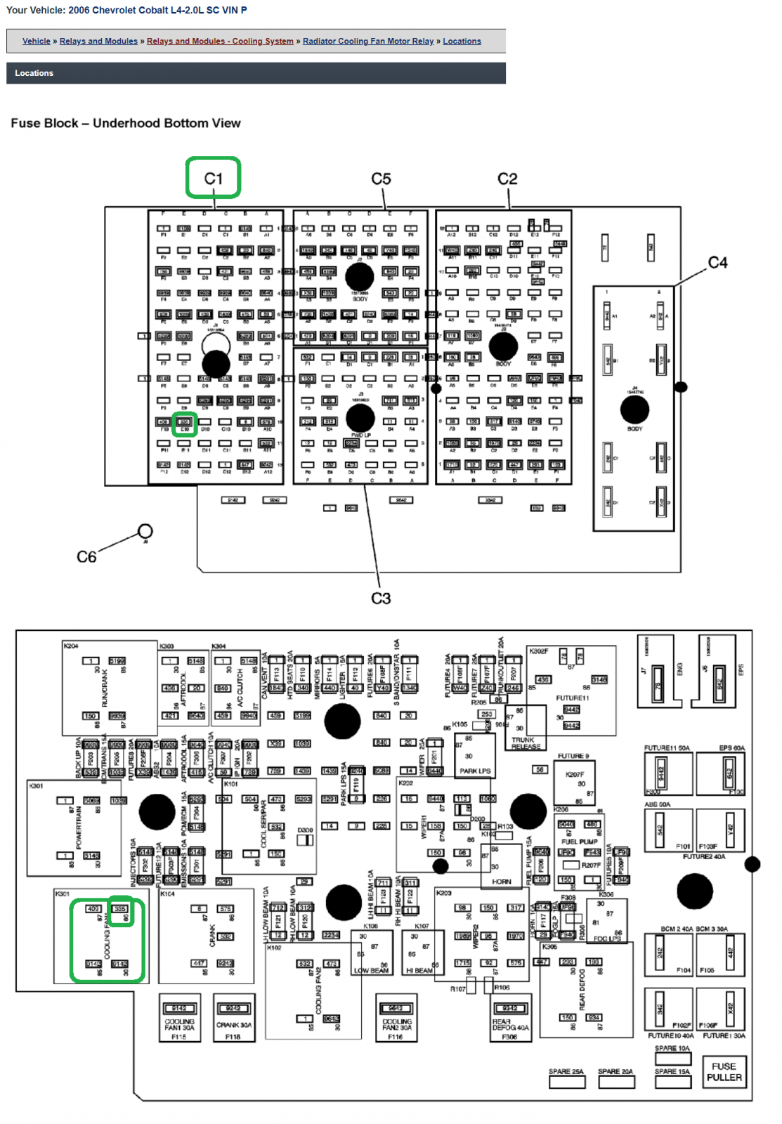

Your blue arrow just tells you about the 7 connectors on the fuse box.

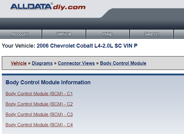

I don't think there is a forum thread on explaining the AllData wiring information.
So this will serve as the first one. I am now including a AllData header in my images, so people can see where I got it from on AllDataDIY. Some of this info is hard to find on AllData, and I use the search function a lot.
The more I look at the AllData wiring, the more I learn about it.
The connectors are sometimes referred to as C1, X1 or J1. The first letter doesn't seem to be consistent, but the connector number does.

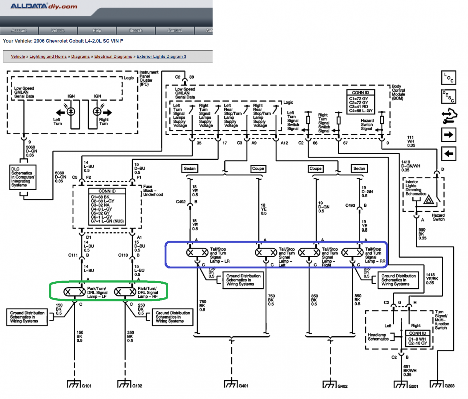

From what I understand the front turn signals go through the Fuse Box? and the rear do NOT go through the fuse box? that would seem ok for a cobalt but with the fuse box in the rear do we flip them using the DF wiring videos?
You can't flip them, as the goblin needs the stop lights at the rear.
I used the wires in the blue box for the rear tail lights, because they have stop, running and turn signals combined.
The green box is for the front turn signals, as they have both turn and running lights combined.
PS: if you plan on flat towing your goblin, you connect the trailer electrical plug to the wires in the blue box too. Then the tow vehicle will use the goblin tail lights, even with the key off.

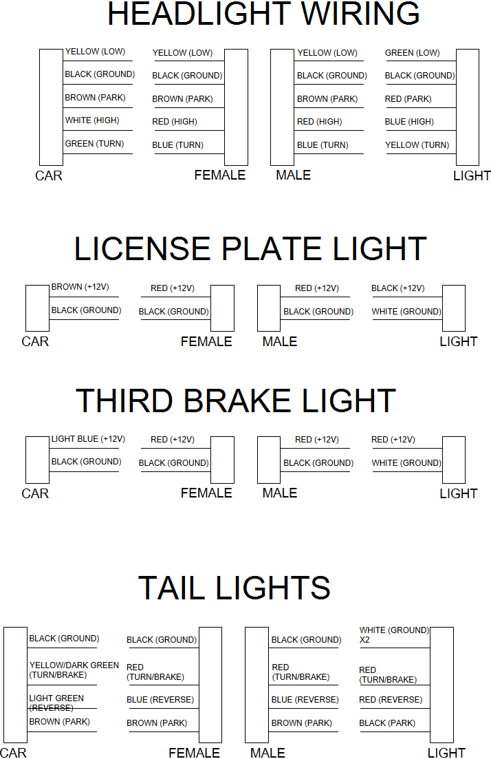

if anyone wants to see how "goofy" my wiring is check out these diagrams I made up. pretty straight forward though. I moved the front turn signals into the headlights since I have integrated turn signals in mine. used cheapo waterproof amazon pre-wired connectors. (load resistors not shown here)
