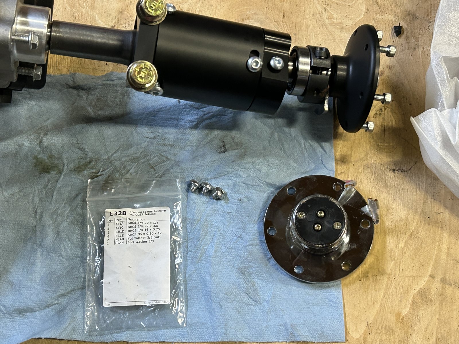

Installed power steering motor as per video. I seen video of cutting ignition lock. Is the rest of steering column reused?
Looks like I'm in the same boat as you. Really wish DF had some instructions on how to assemble the steering wheel.
I have it mostly together (I think) and I have two questions:
I have (3) stubbly little screws left and no holes to put them in
39366
And is it even possible to use the horn on the DF quick-release wheel? I don't see any way that would work.
DF put the horn on the button panel for a reason. The horn on the steering wheel is cheap, junk in my opinion. It sometimes jams when depressed, there is no proper electrical contacts, instead it uses a bolt head as a contact. It would require a clockspring and a hole drilled thru the side of the steering stem to provide wires to the center of the steering wheel. I debated installing the Cobalt clockspring and drilling a hole, but when I realized that the horn jams, I decided the DF dash mount would work better.

The horn on the button panel doesn’t bother me at all, but I been thinking about going old school and doing a foot button by the clutch like my 74 Camaro had. Just not sure if there is enough room to make it usable without hitting it all the time.
