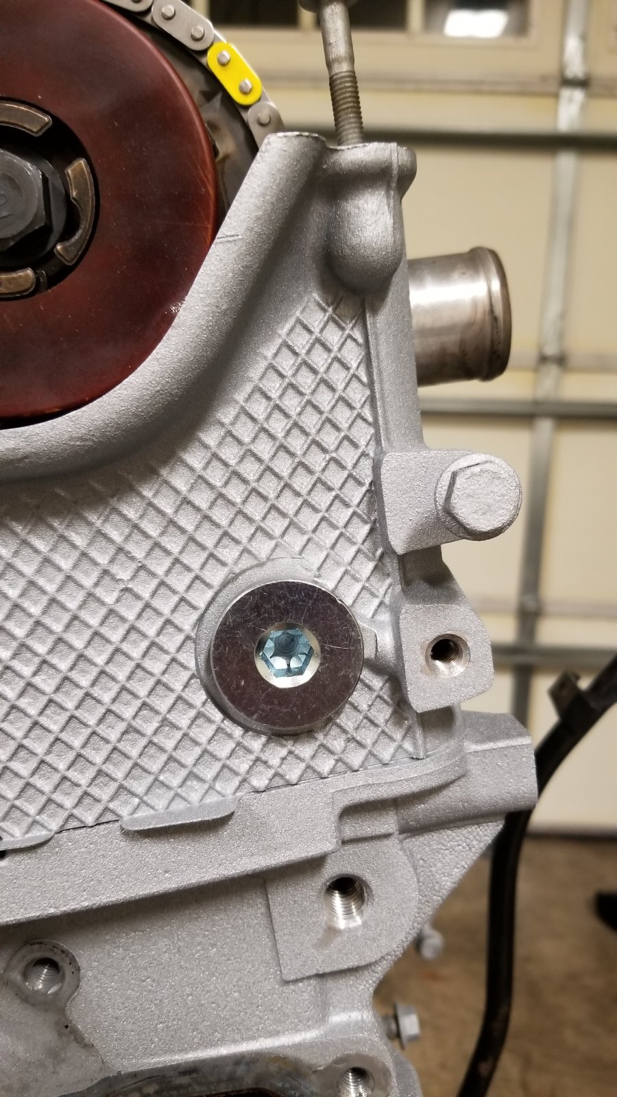

Looking at the timing chain side, top right. Do you have the upgraded bolt that threads into the cover and replaces the shouldered bolt that's holding the plastic guide there?
The stock shouldered bolt in this position is notorious for breaking and the guide will be loose and create slack (or even break off). Check here first before diving in

I have about 500 miles on this timing set from cloyles which includes the upgraded tensioner, new guides, and I purchased the upgraded guide bolt that is solid metal all the way through to the guide.
I’m reaching out to cloyles maybe my tensioner is not getting pressure?
