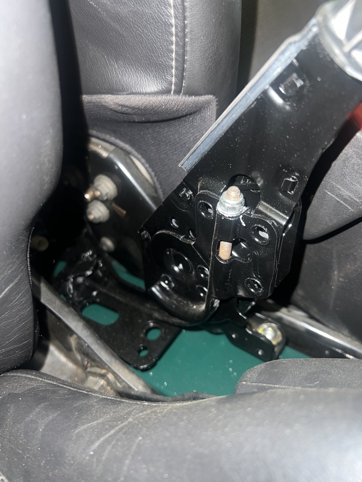

Just about done with my kit. 2023 with 2.2 5 speed. Is there any way to adjust the emergency brake cable. You can feel it grab a little but not nearly enough. Also, have an annoying rattle when shifting up. Checked the rocker arms and the lash adjusters and they seem fine. Third, the idle speed is around 1000. Any way to adjust it down? Thanks .
The slack could be taken out at the threaded rod under the plastic handle cover.
Also, don’t pay attention to how far out mine is adjusted. I don’t have any cables at the moment.
