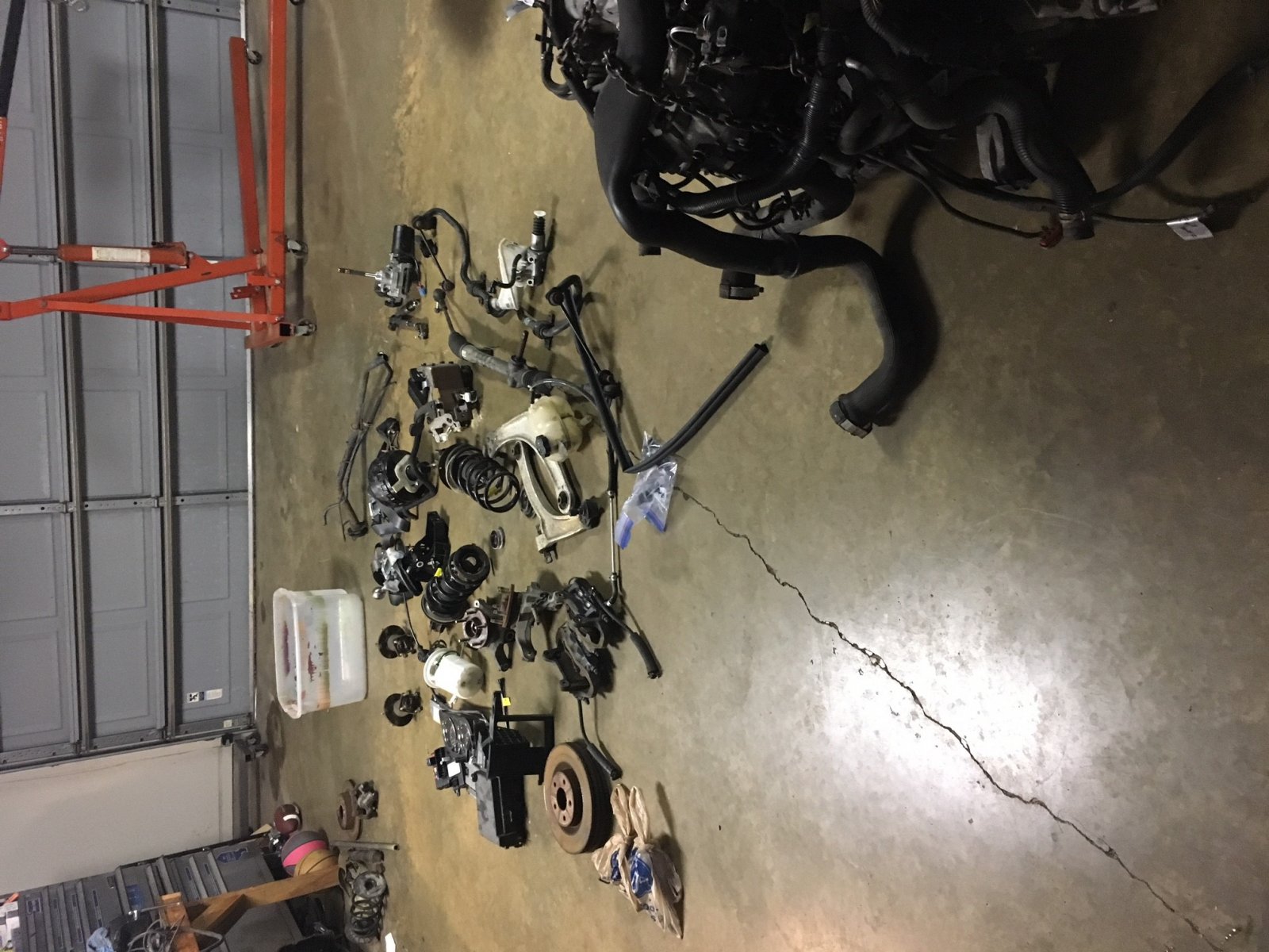

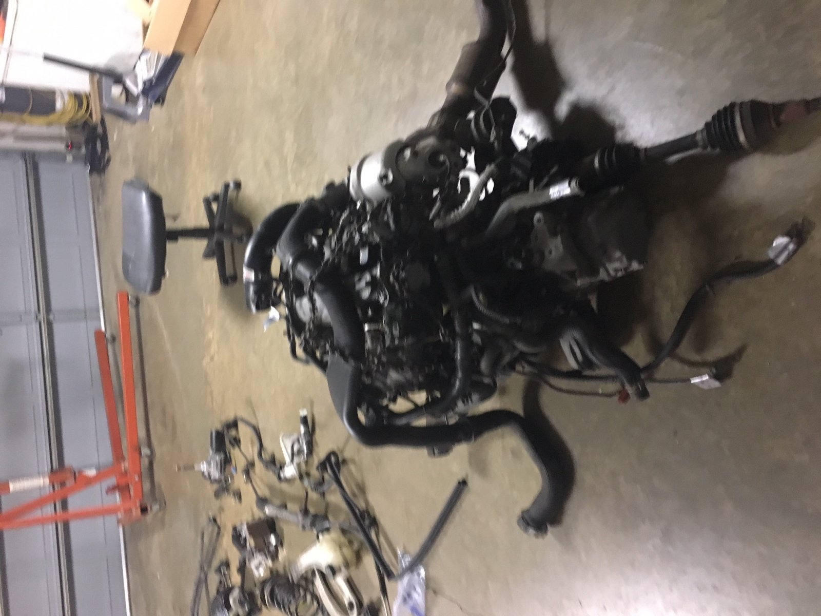

Car is completely stripped. I do have a few TC questions. car is manual so I have clutch pedal and clutch Pipe/hose. I have the shifter (bonus it had a short throw aftermarket shifter) was wondering if there is anything else I need to keep that is not on the standard checklist???
Items I would question are - rear rotors and calipers? in the video they are drum so not sure if I should keep them.
rear suspension?
steering tube(part the shaft came out of)?
Anything else I should hold onto for now?

The TC kit comes with 4 rotors and calipers.
No need to keep anything from the rear suspension.
For steering you need the u-joint shaft, the bearing, and the steering wheel tube. And the power steering module, but that's obvious.
