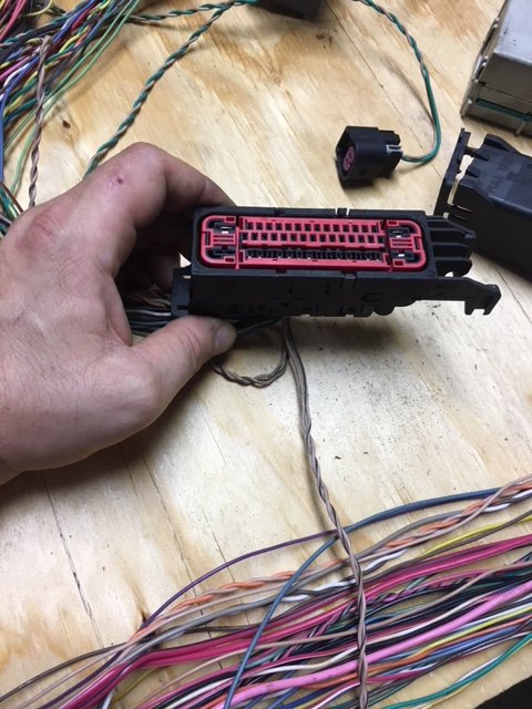

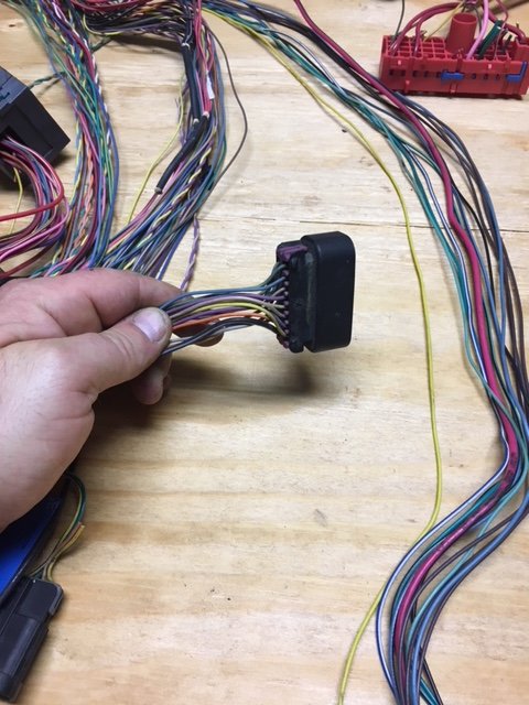

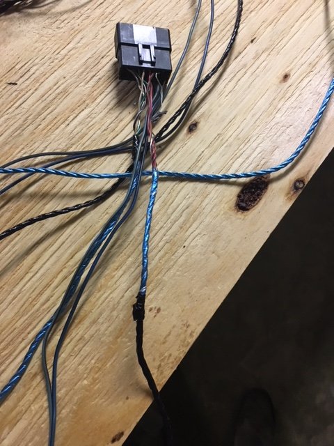

is this the dash connector that gets removed? I didn't have it labeled and the video doesn't show it very well.
It looks like it. As far as I can tell the wire colors in your picture line up to what I see in my service manual. What's strange is my connector was a 40 pin, and yours is a 16 pin. They're both labeled as a dash-to-body harness in my book so I don't get it. The connector must have changed in the 09 TCs.

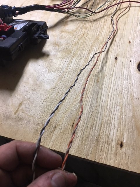

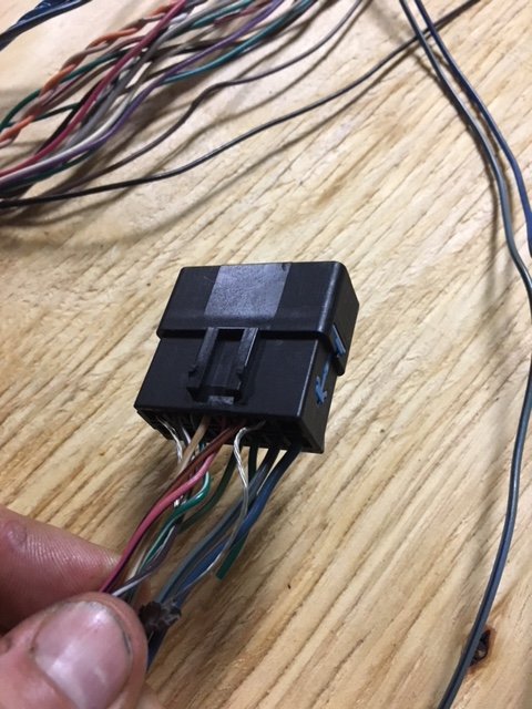

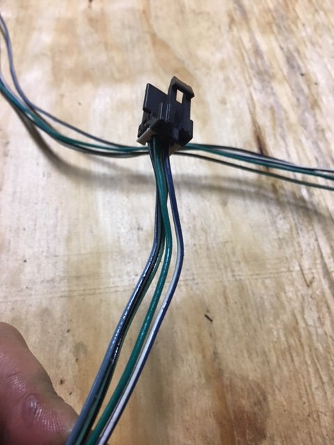

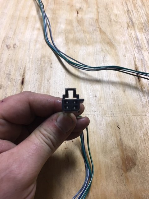

ok, when removing my on-star wires everything went good until i got to the twisted pair that you roll up in the video. that set of twisted pairs went to a black and purple multi plug. on my harness it goes to the plug shown below. Not sure if I should remove these or what????
JSATX
Im not exactly sure what youre asking but...When the onstar plug is removed you must solder the tan&tan/blk wires together. They are your Canbus wires and must remain intact.

I believe this is the connector they go into on the video. In the video they are just wound up with this connector. on my harness they go to that different connector.

I never could keep track of which connector is which, I’m just saying If you cut a connector out, like onstar, be sure that the CAN bus wires get soldered together.

i left them wound up with that other plug, but I need to find out why it is not the same plug as in the video. just another difference due to year/model??

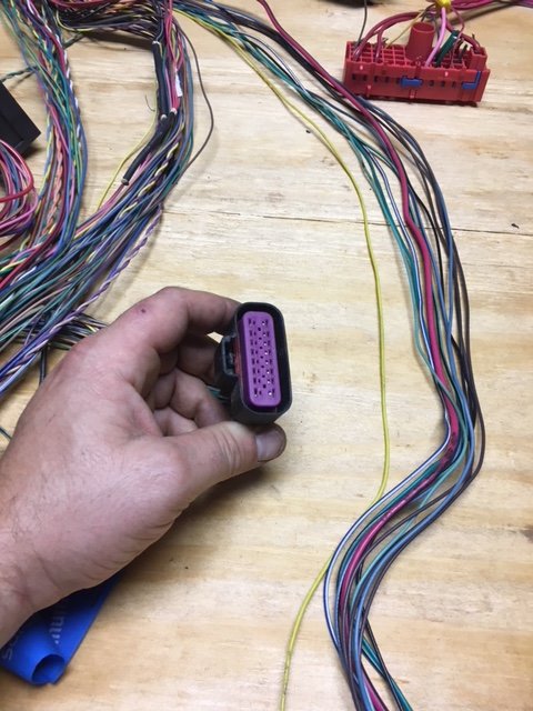

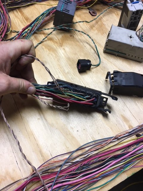

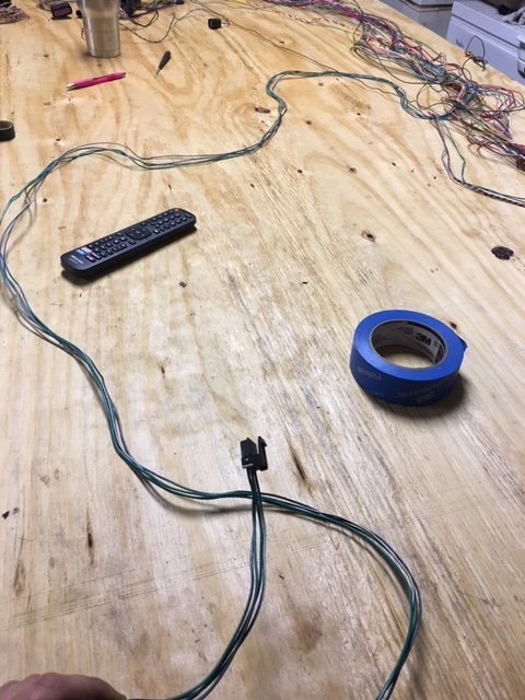

still need to figure out the above but now I am complete with video 11 I have 2 twisted pairs I don't understand on the passenger side of the car.
And I have one connector on the driver side I do not know what it is?? on the driver side i never found the battery current sensor plug or wires???

Brian74
That looks like the subwoofer plug. SS cars do not have current sensor. Those twisted pairs look like ABS or SRS module wires, IIRC.
