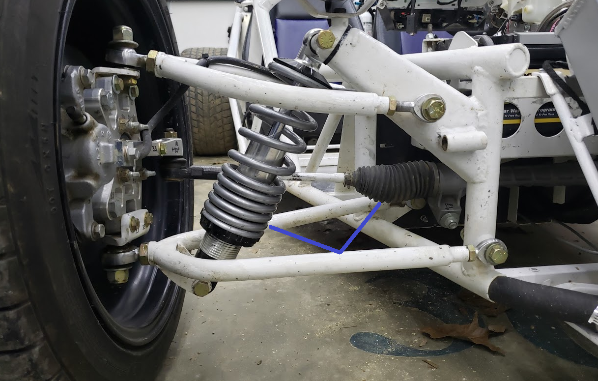

On lower control arm, I think I will weld 2 tubes in a V shape. Need to check the full suspension swing, to get final positions.

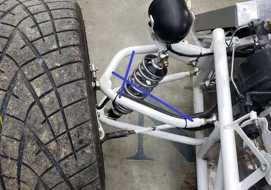

On the upper A arm I don't have as much room. Maybe this X pattern will be enough.
