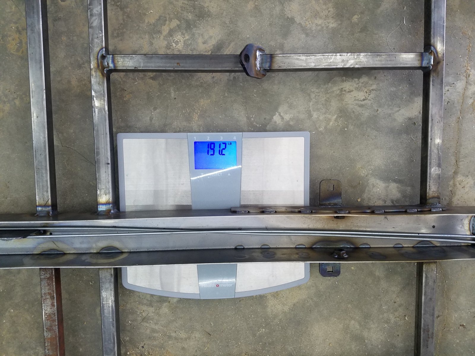

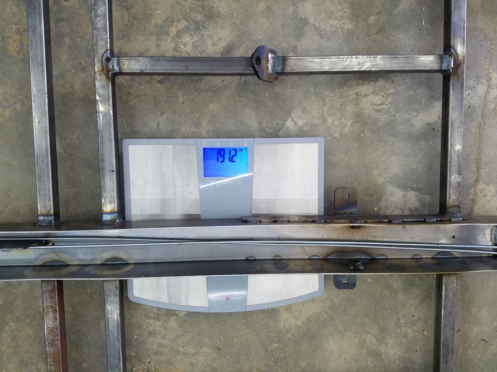

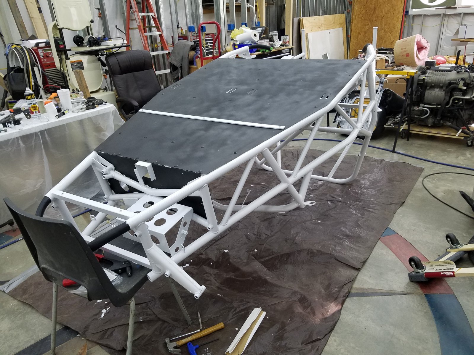

Spent the day degreasing the metal frame, getting ready for primer. Took out the clutch and brake lines, reweighed the frame.
Actual frame weight: 190.8 lbs. So the oil and brake lines only added 0.4 lbs.

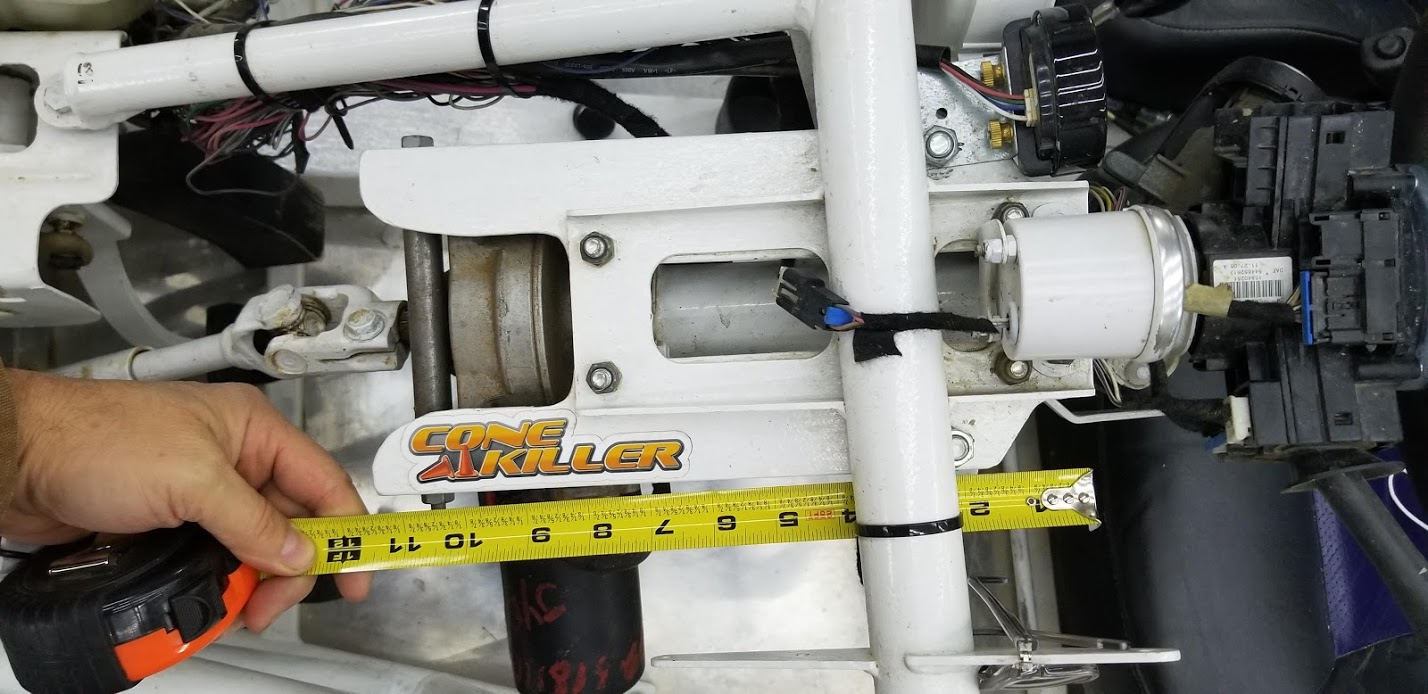

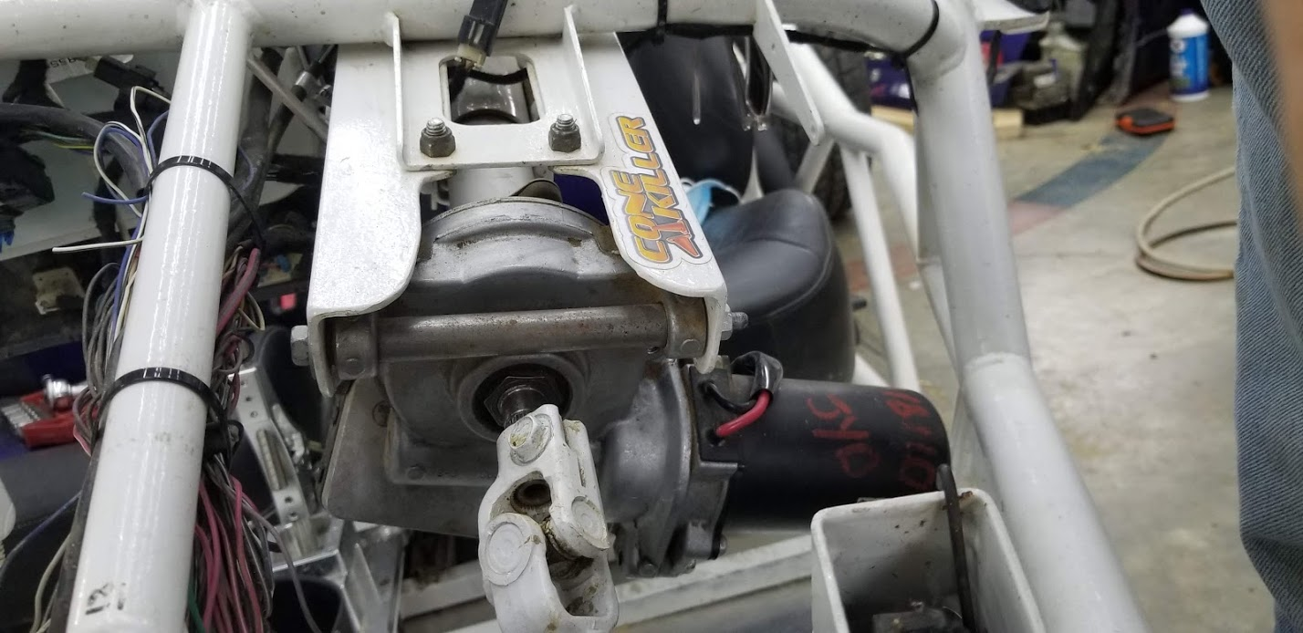

I want our DF Goblin kit car to fit both my wife and I, so I am test fitting the stock Cobalt seats, sliders, adjustable steering column, stock pedals, and stock shifter. The only things new to the kit is the stock adjustable steering and keeping the locking steering with the key on the column. I fabricated a quick modification to the Cobalt column, and demonstrate it here.
To make this I cut up 2 pieces of 2" angle iron, 11.5" long.
18781

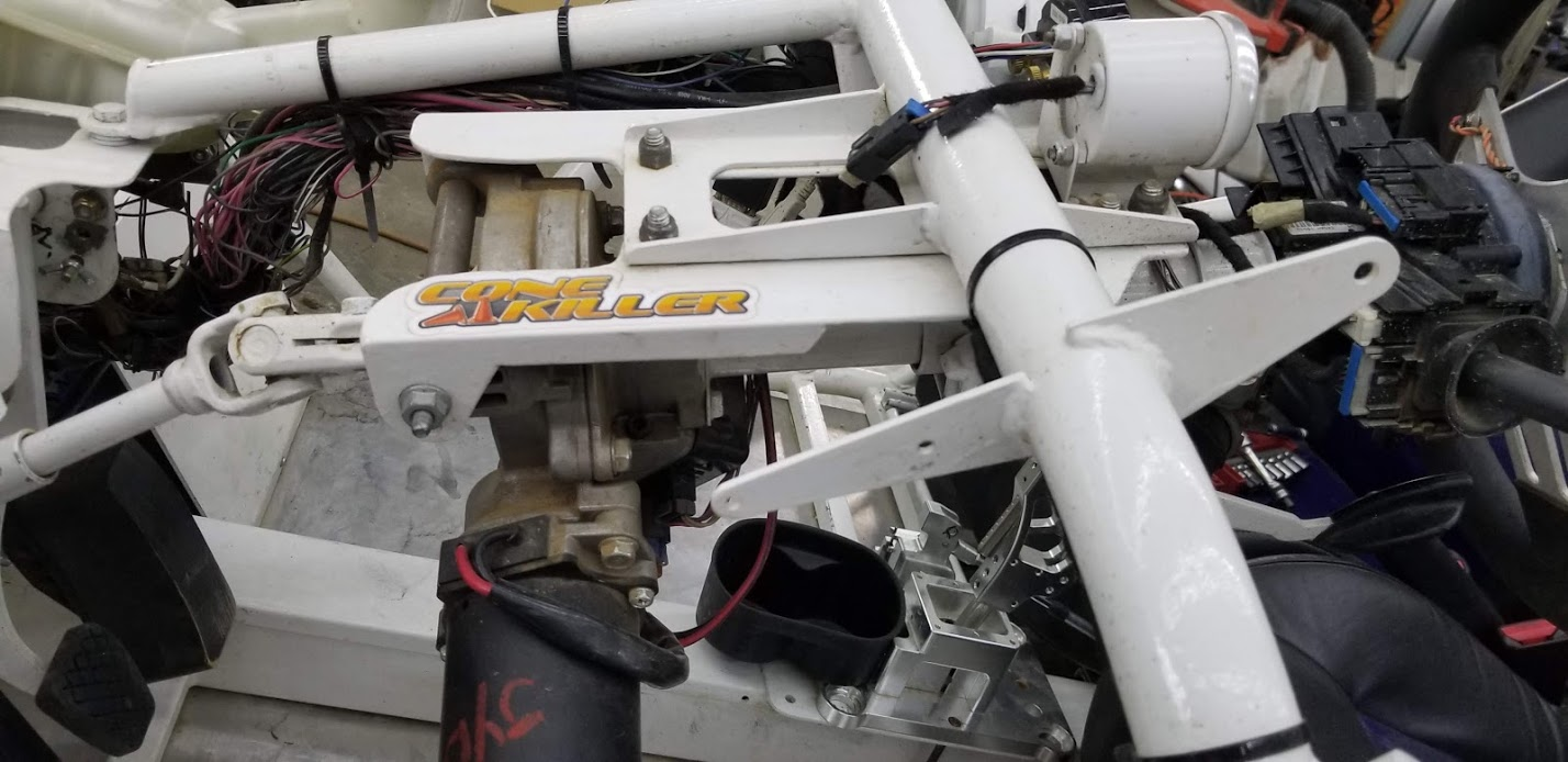

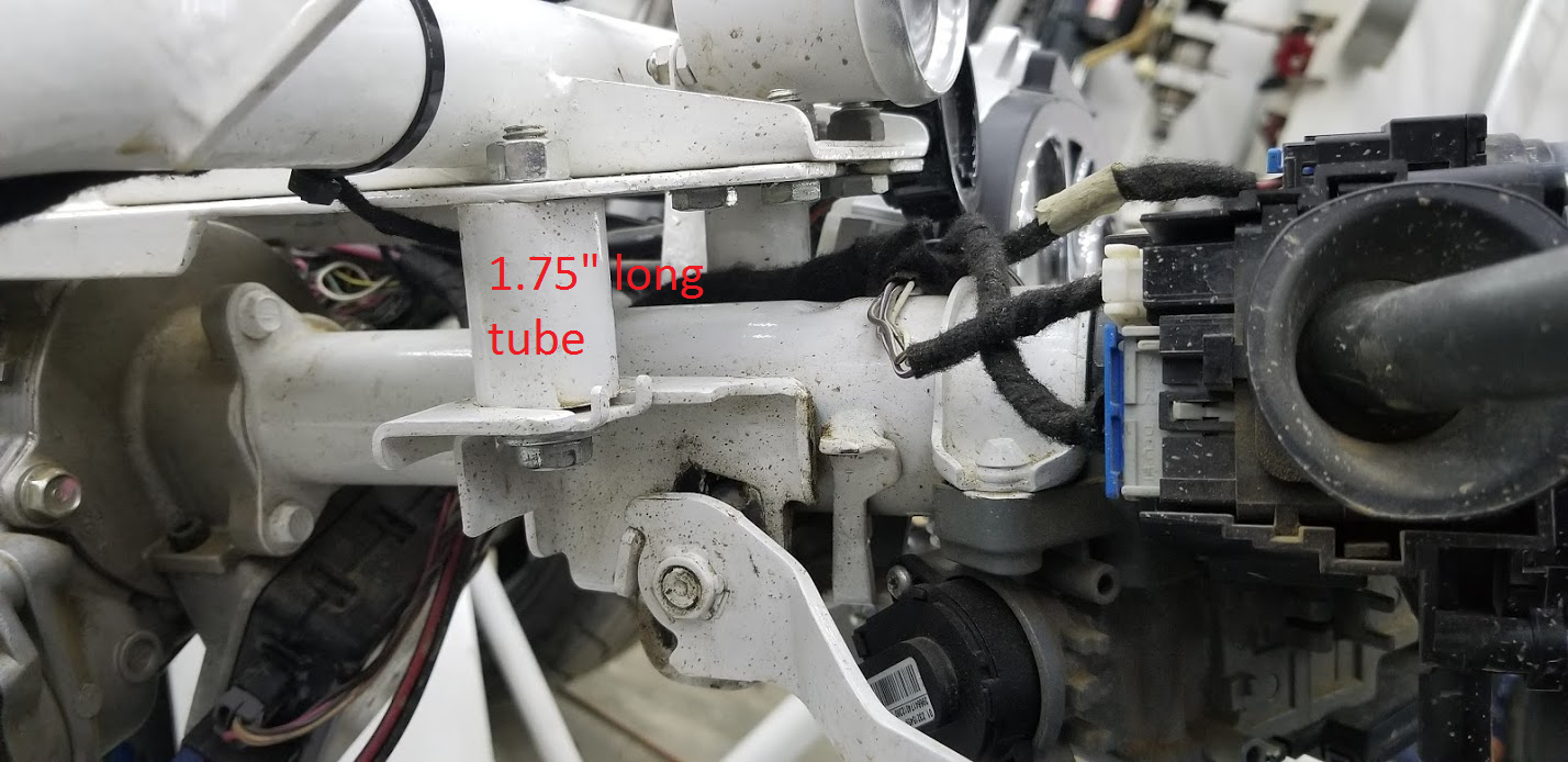

Also two 1.25" tubes that are 1.75" long. Inside these tubes is 3/8" bolts that are 3" long. This dropped the steering wheel to the proper height for my wife and I to drive. Below the tubes is the Cobalt adjustable steering mounts. I think I hammered them flat, then put the bolt and washer on.
18785
The rear pivot was located 3 3/8" behind the DF steering motor bolts.
18784
The DF steering motor bolts just catch the 2" angle iron.
18783

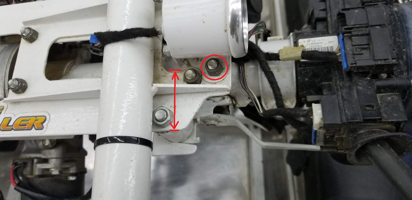

The DF mounting bolt hole (circled) was used to mount my boost gauge, but it wasn't able to catch enough of the 2" angle iron, so I drilled a new hole beside it to bolt my angle irons.
18786
Don't forget to add a "cone killer" sticker. :)
18787

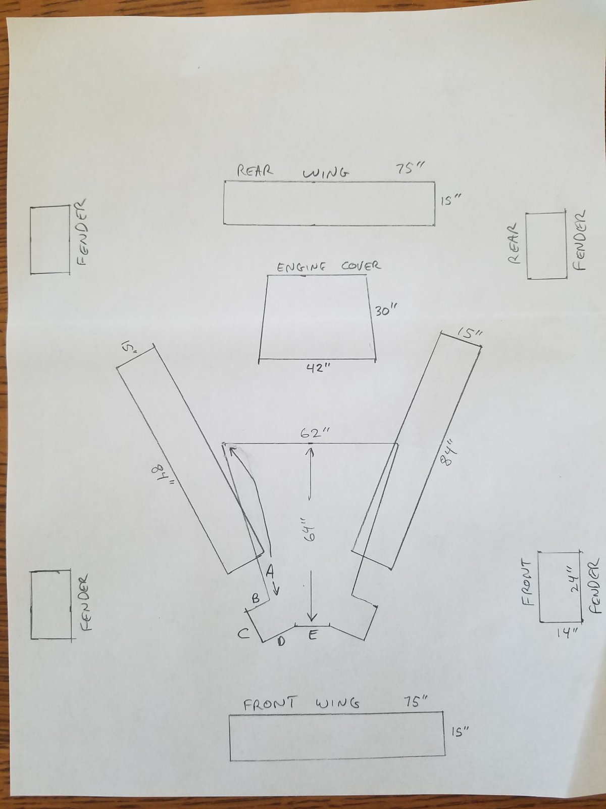

I am wanting to design a wrap for our Goblin, and I need some measurements of the body panels (Since I don't have Stage 3 yet).
What is the dimensions of A,B,C,D & E?
Is any of my other measurements wrong? (I was guessing on most of these)
What is the dimensions of the overlap between the side panels and the fiberglass hood?
