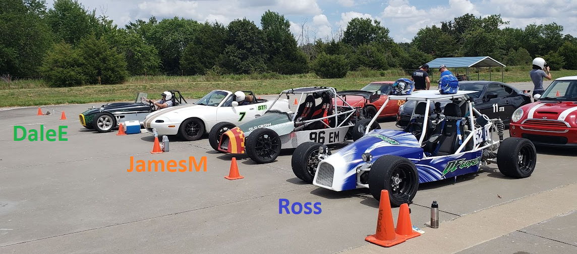

Fun day playing at the
OMR SCCA 2022 Solo Event #7
at Crowder College, Neosho, Missouri

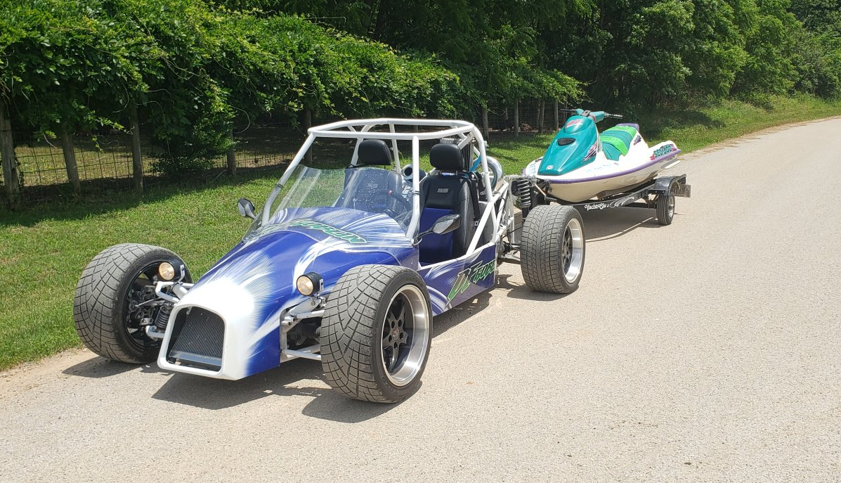

Went for a 5 mile test drive, to get an estimate of my range while towing the goblin.
Our model Y uses about 500 watts/mile when flat towing the goblin.
The nearest CCS charger was 123 miles away from GoblinFest 2022. (this was a few months ago)
My model Y range was ~147 miles while towing the goblin thru twisty roads in the Ozark hills.
I arrived at Lonny's place with 20% battery, after fully charging the model Y at the nearest CCS charger.
Got home, and someone on Discord captured a pic in the wild of my test drive.

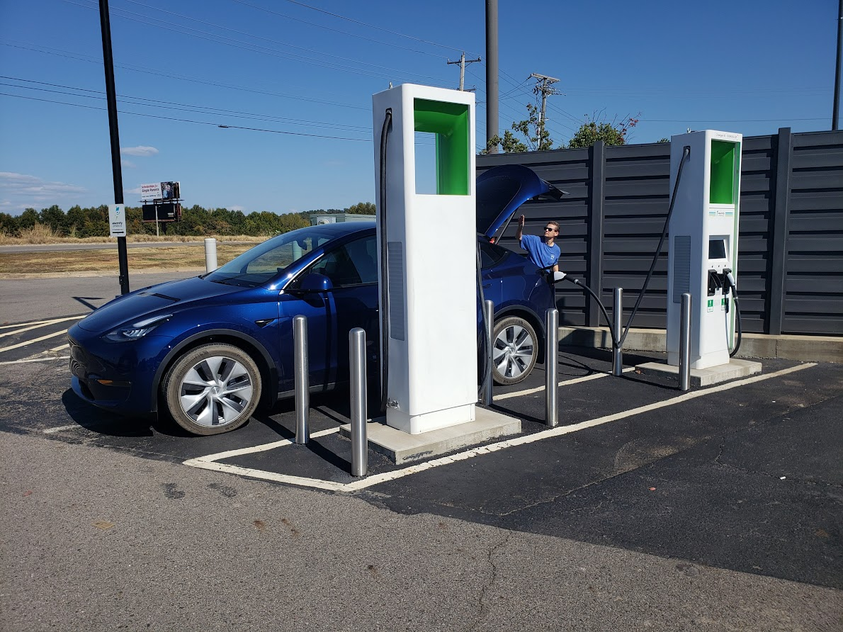

The nearest CCS charger. Had to disconnect the goblin to charge the model Y.

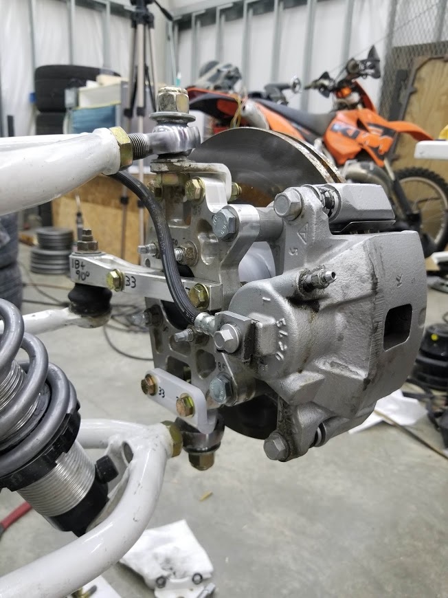

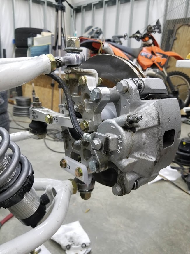

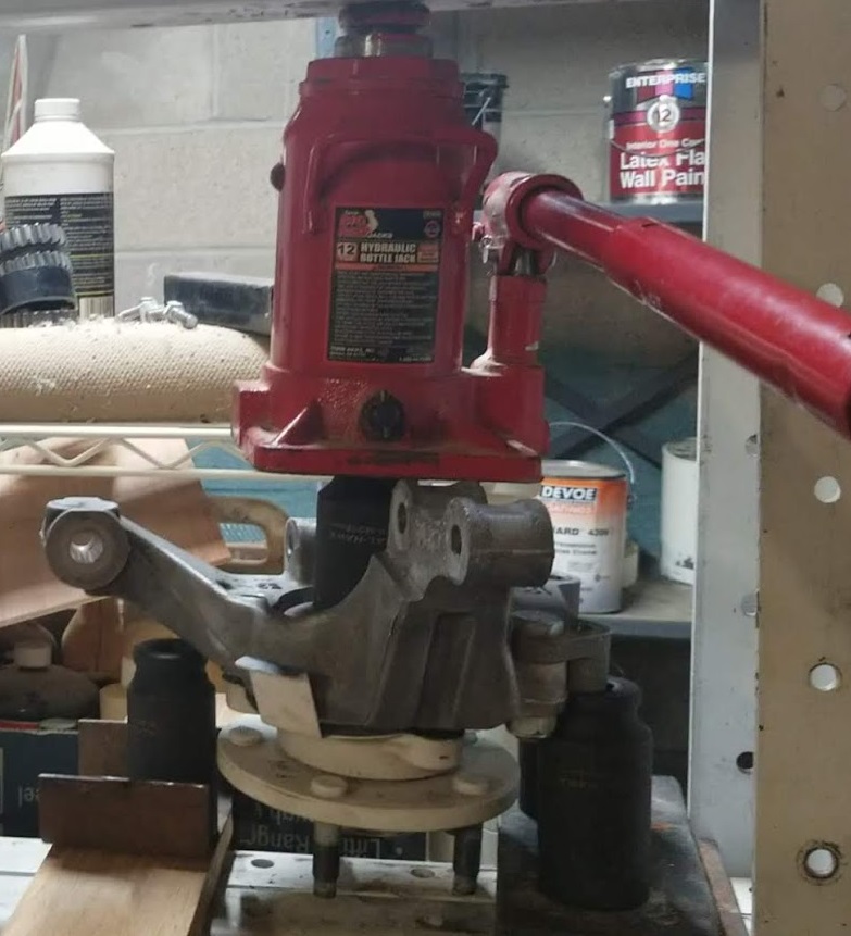

Assembled the front uprights today, with the new hub bearings, thicker rod end mounts. Torqued everything.

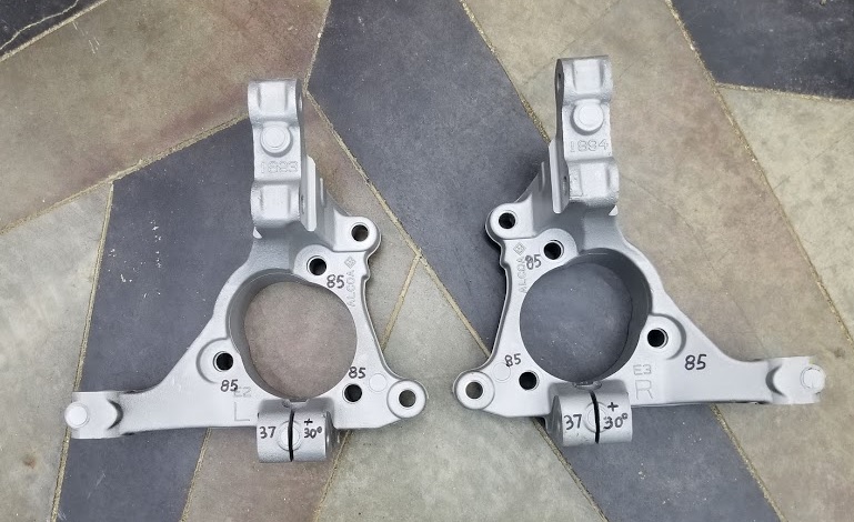

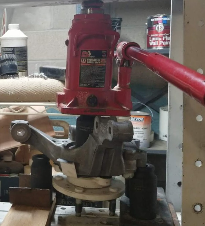

Pressed out the old rear hub bearings. The aluminum had a reaction to the steel bearings, so they were stuck.
The rear Moog wheel bearings arrived today. Test fitted them, and painted them white.

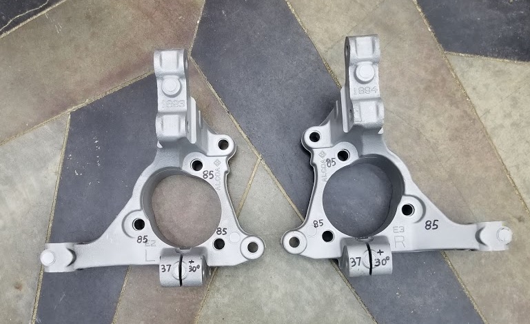

Cleaned, sanded, dremel wire brushed & painted the rear uprights. Reapplied the torque numbers.View attachment 9980
Maybe tomorrow I can get it back on the road. A guys gotta dream.

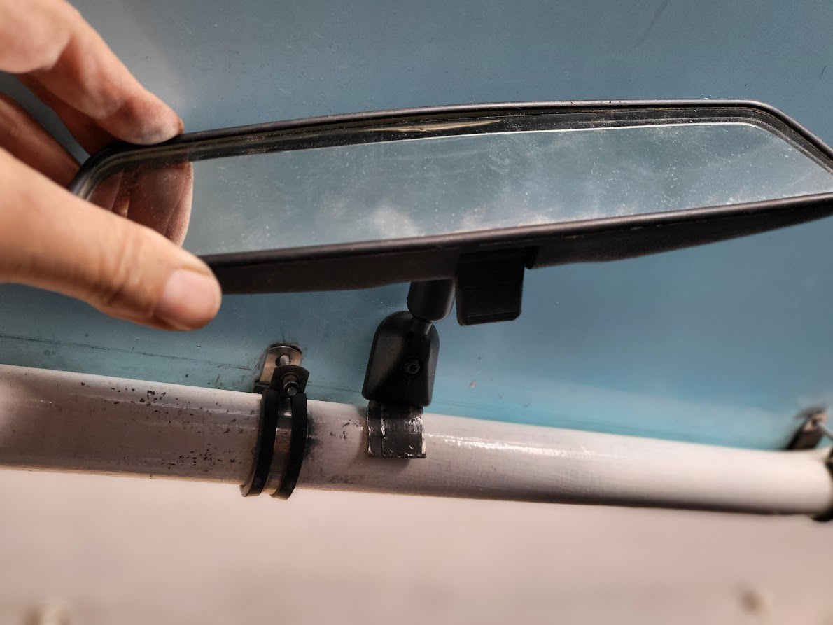

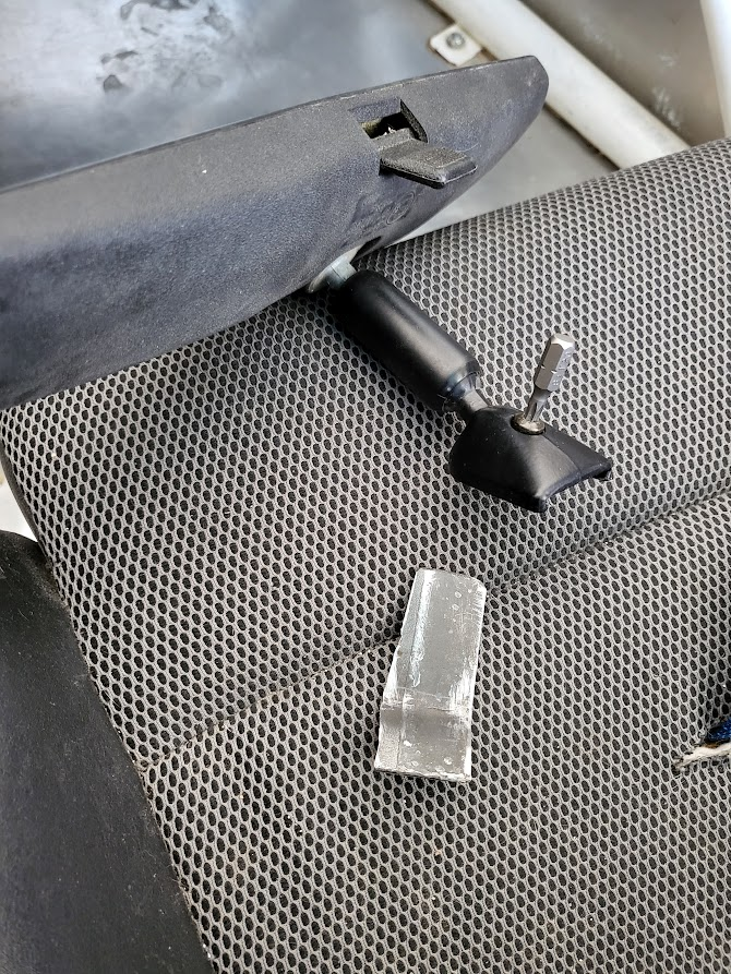

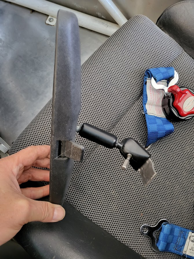

I shaped a piece of metal to slide into the Cobalt rear view mirror. The stock mirror mount has a double taper, and a set screw.
My metal piece needs to be welded to the top of halo bar, and then the rear view mirror will be aerodynamically behind the halo bar.
It is under my roof panel, and barely visible from the front... so kind of hidden from view. It has the Cobalt 2 pivot points, and the Cobalt headlight dimmer for night driving. My 2nd donor has a rear view mirror with cabin lights on it... I debated using that, but would have to add wiring.

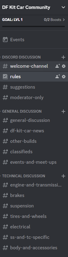

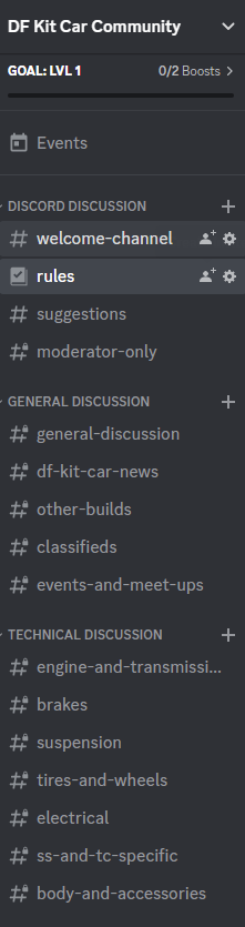

I will get to work on one then! I am going to make the layout just like this forum.
Will have roles for people that are staff, moderators, registered users and verified builders
Little preview
38130
Just having a presence on another platform can spread the word to more people. Even if that just references this forum.
