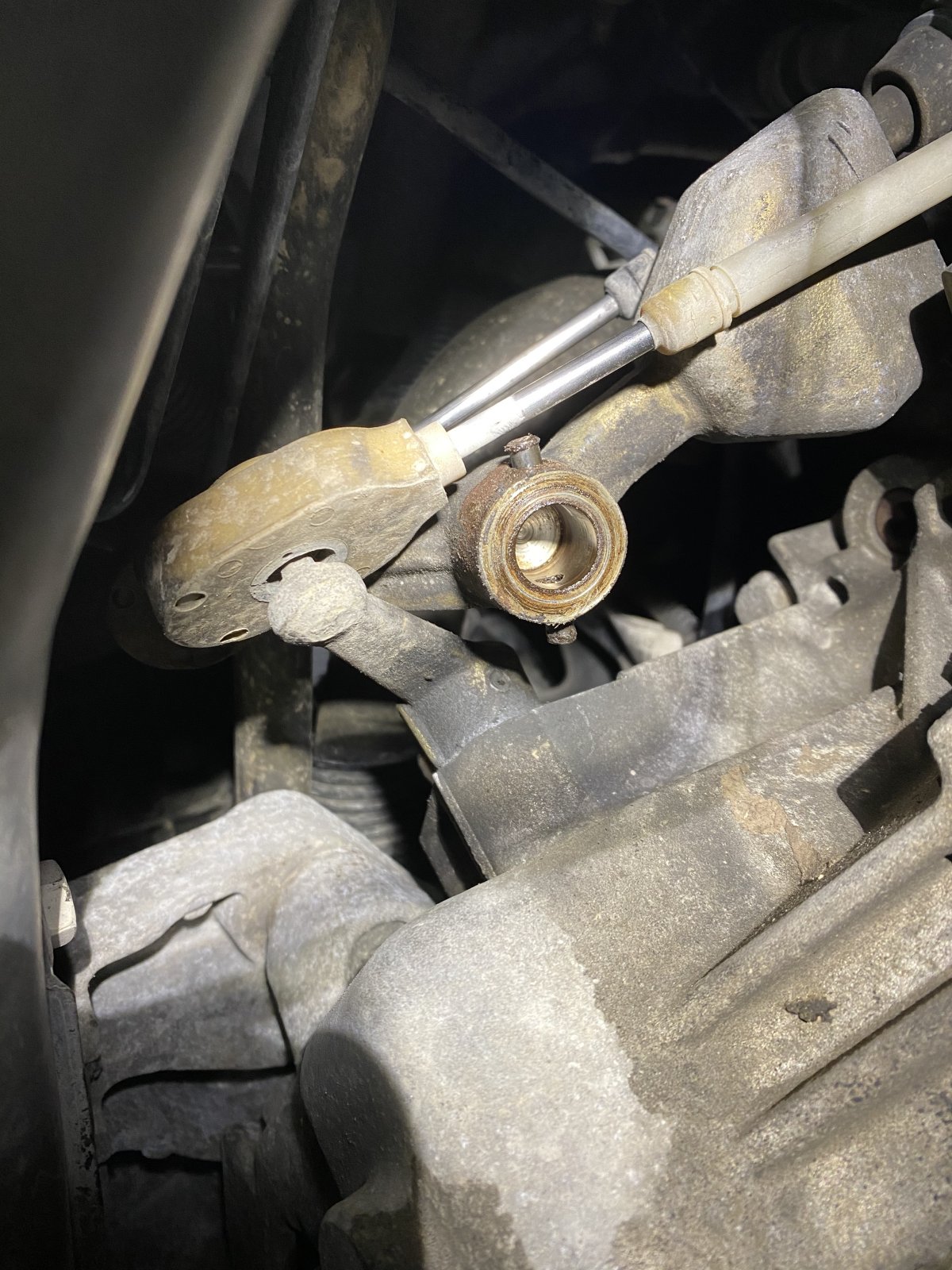

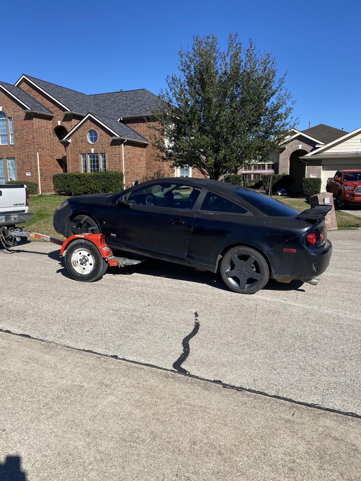

i have been keeping a eye out for a doner for a few years now and pulled the trigger on a 06 ss/sc model. It was totaled in 2012, rebuilt somehow and kept on the road till it wouldn’t shift anymore. I saw it on CL for a good price, but I was hesitant about the trans issues. Hell, it could be anything. After a few text, I figured “what the hell”. I rented a car hauler and went to look at it. Kid selling it and he was up front about the issues. He jiggled the shifter and the levers moved on the trans, so I was pretty certain it was internal. :(. I offered him a bit lower price, to cover these expenses and he accepted it. . We pushed it on the car dolly and I headed home.
Once I got home, it just killed me to know what was wrong with the trans. some interweb search and some thinking, I tore into it the next day after work. Bam. The dowel pin on the shift lever on the trans, was broken. Sweet. I put a bolt and nut on it, and I had a drivable car for $1400.

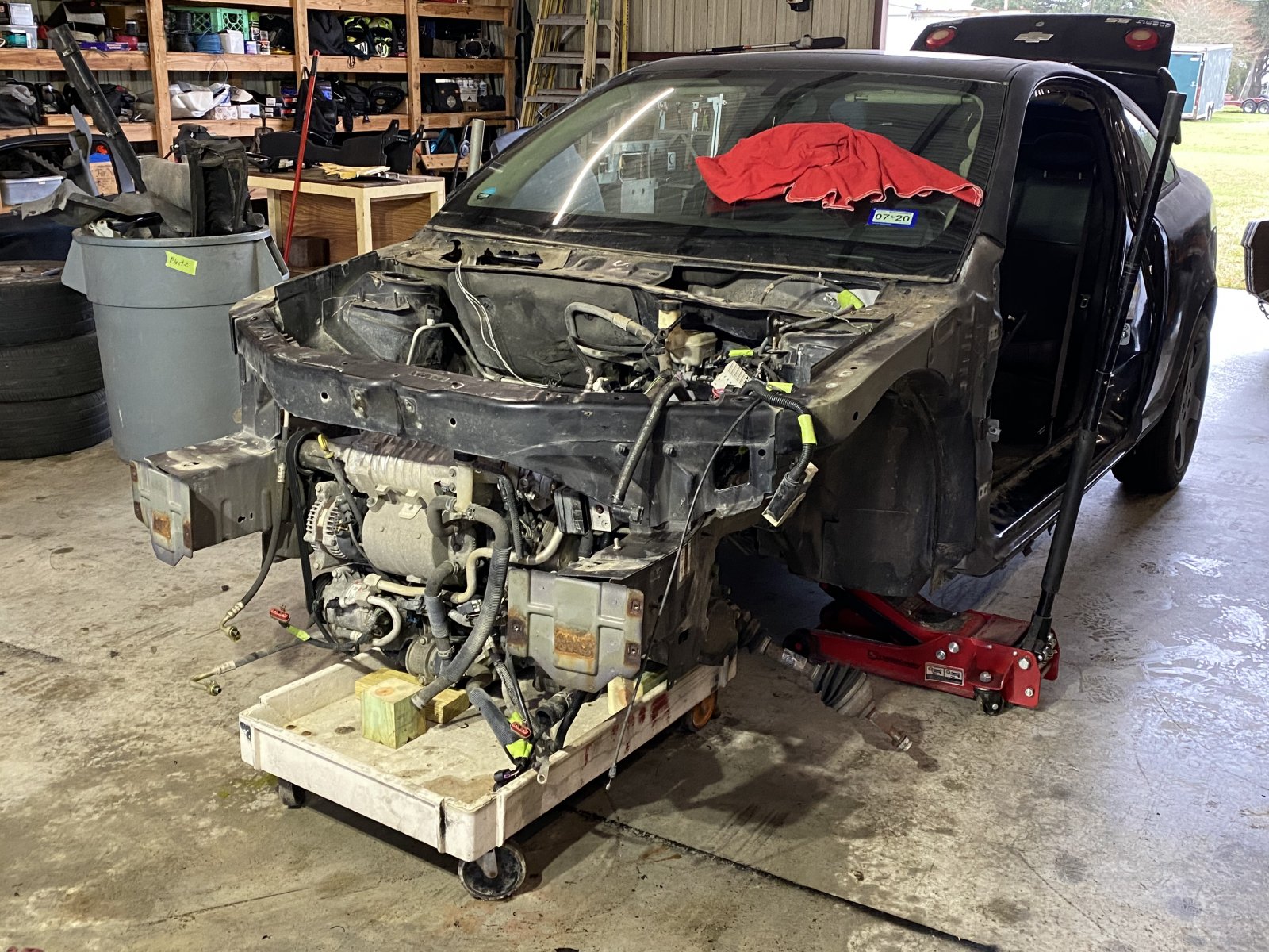

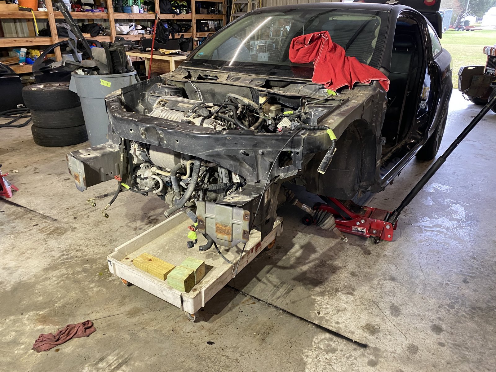

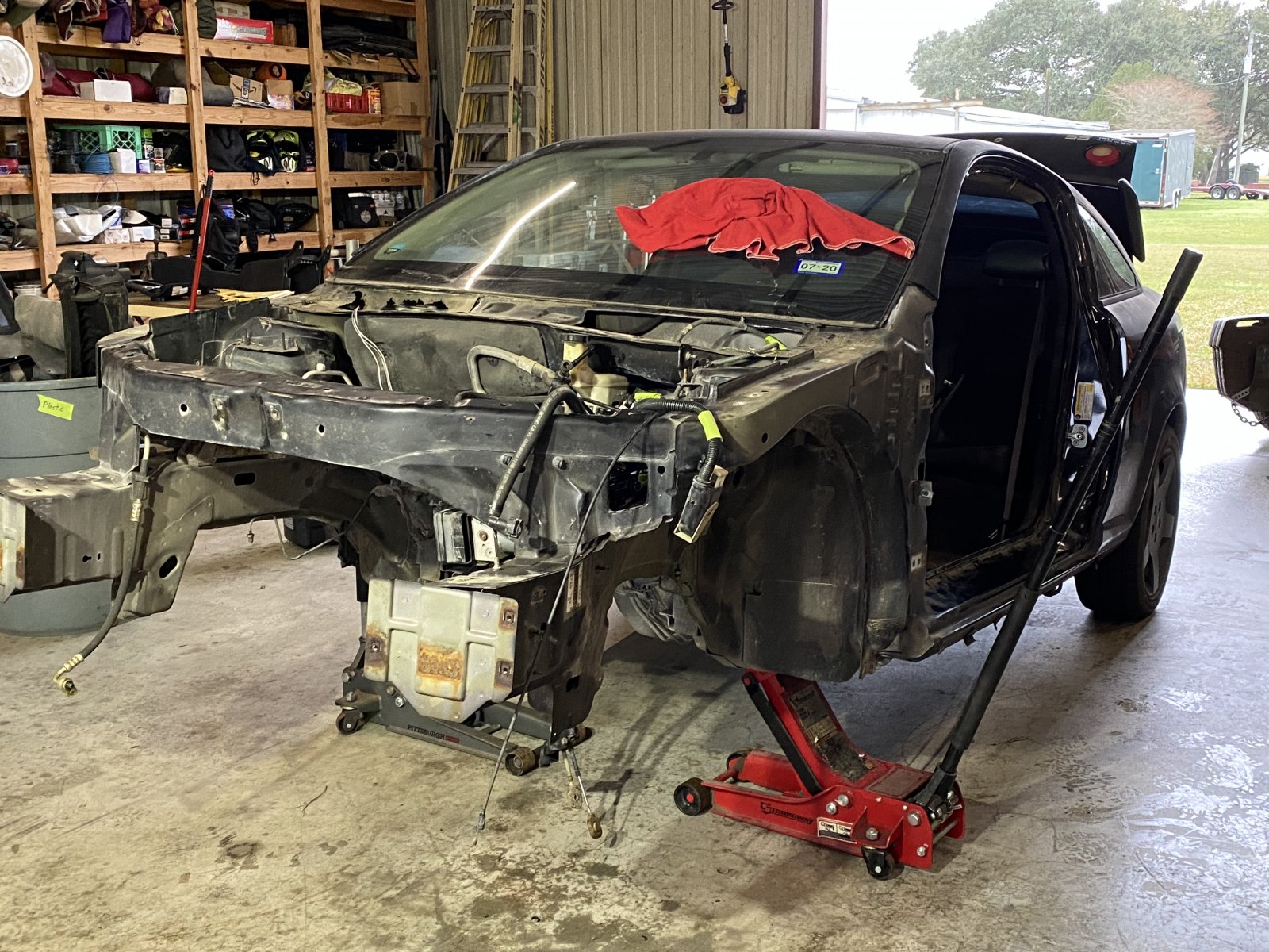

Tear down was simple, no major snags other than the front bumper was held on with whatever screws, nuts and bolt that were laying around. no biggie, this car served 2 kids through high school. It’s all good.
As I noted in another thread, instead of hoisting the engine and trans out of the car, simply raise the car off the engine/trans.

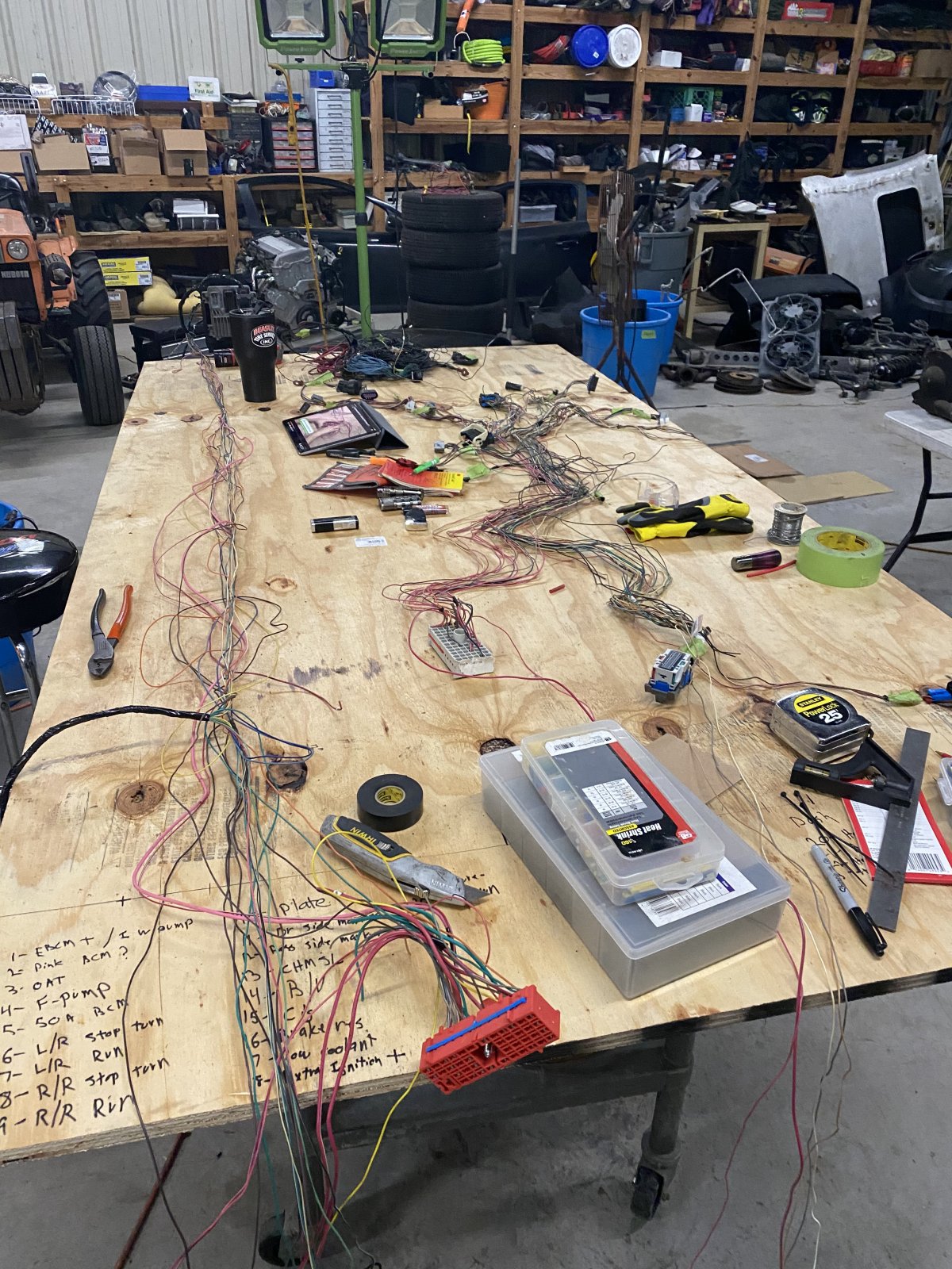

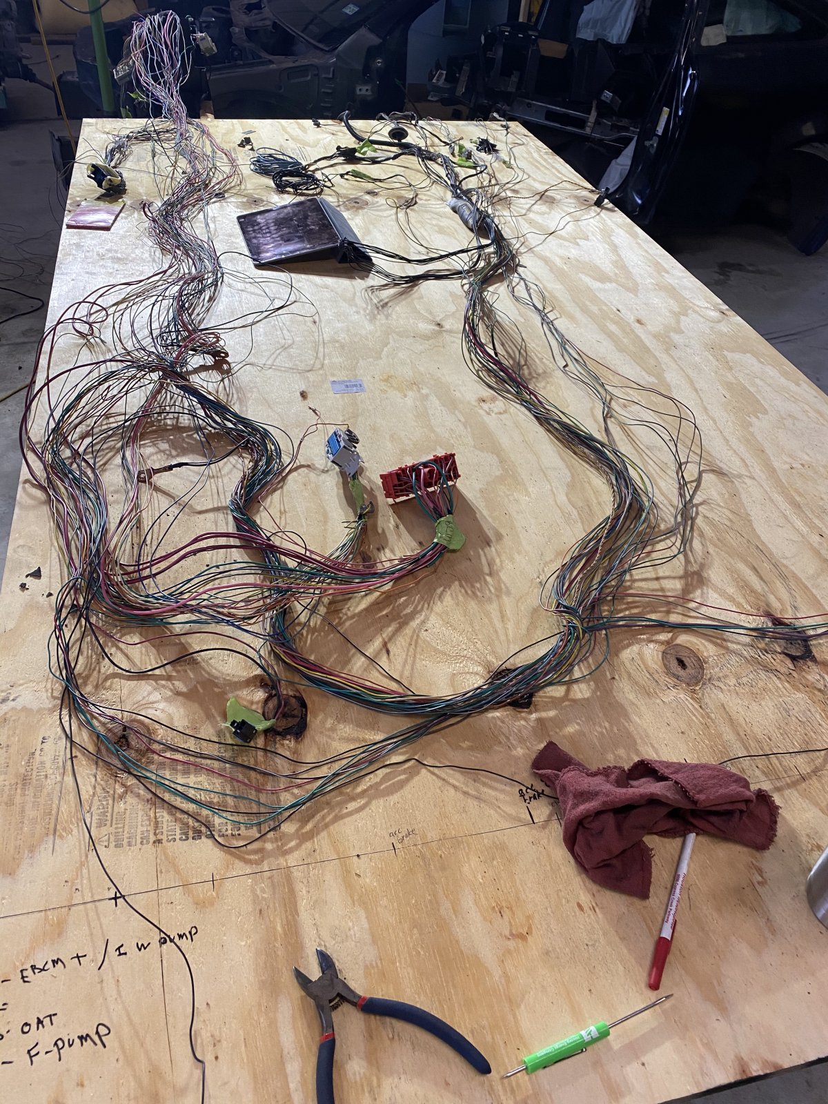

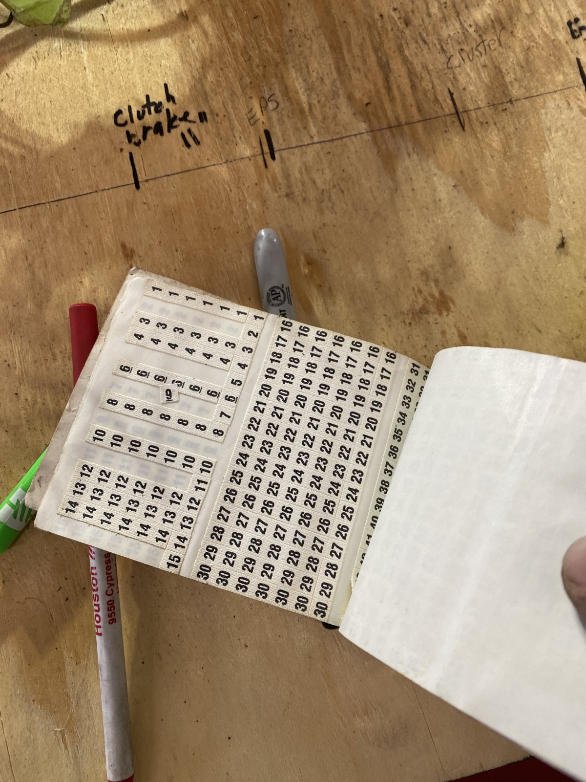

When you are colorblind, the wiring harness will be a challenge. :( I have labels, charts and graphs to help. It’s still taking forever.

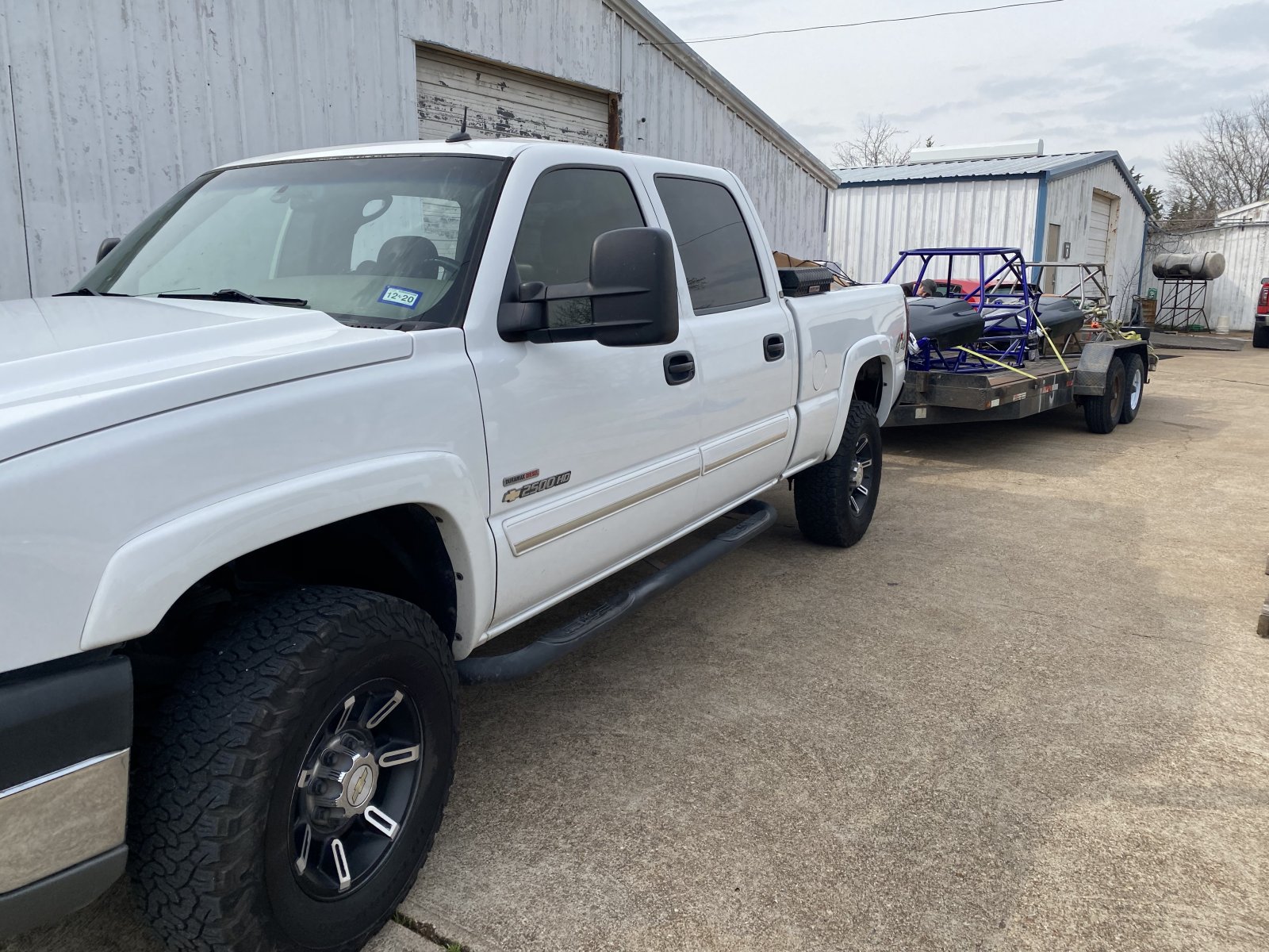

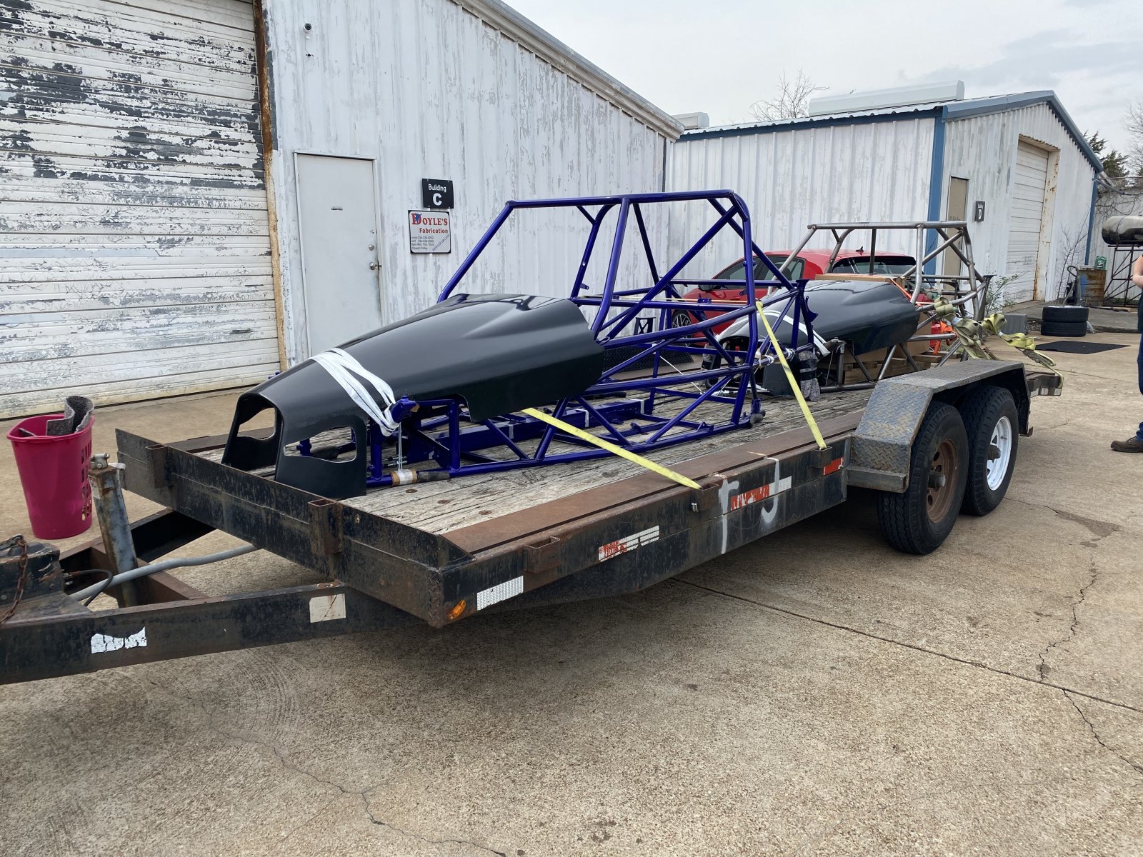

Time to get the goods. Jason #186 and I live close together and have become friends now, so we rode together to go get our goblins.

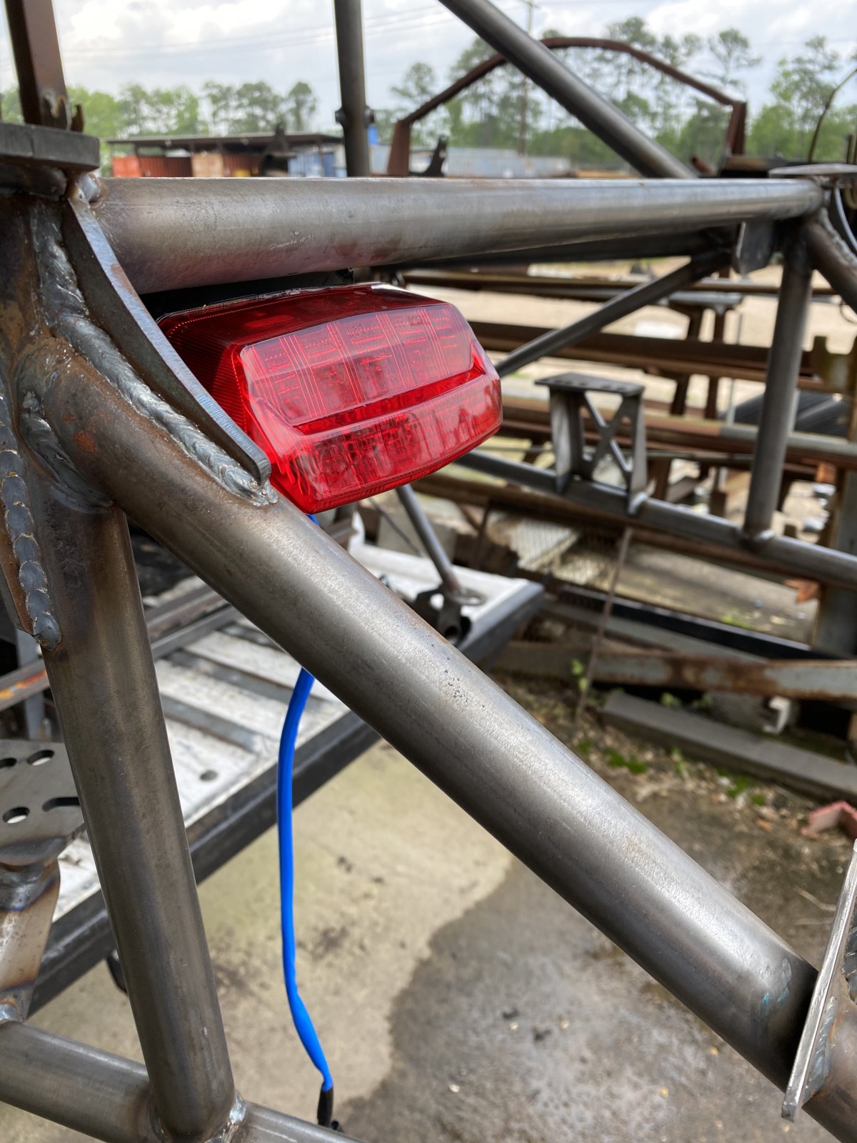

I want mine a little different. So to make mine a little different, I changed the lights. I’m going to use Honda Grom tail lights in a little different spot than the others. *hopefully* they won’t interfere with the engine. :oops: We will see.

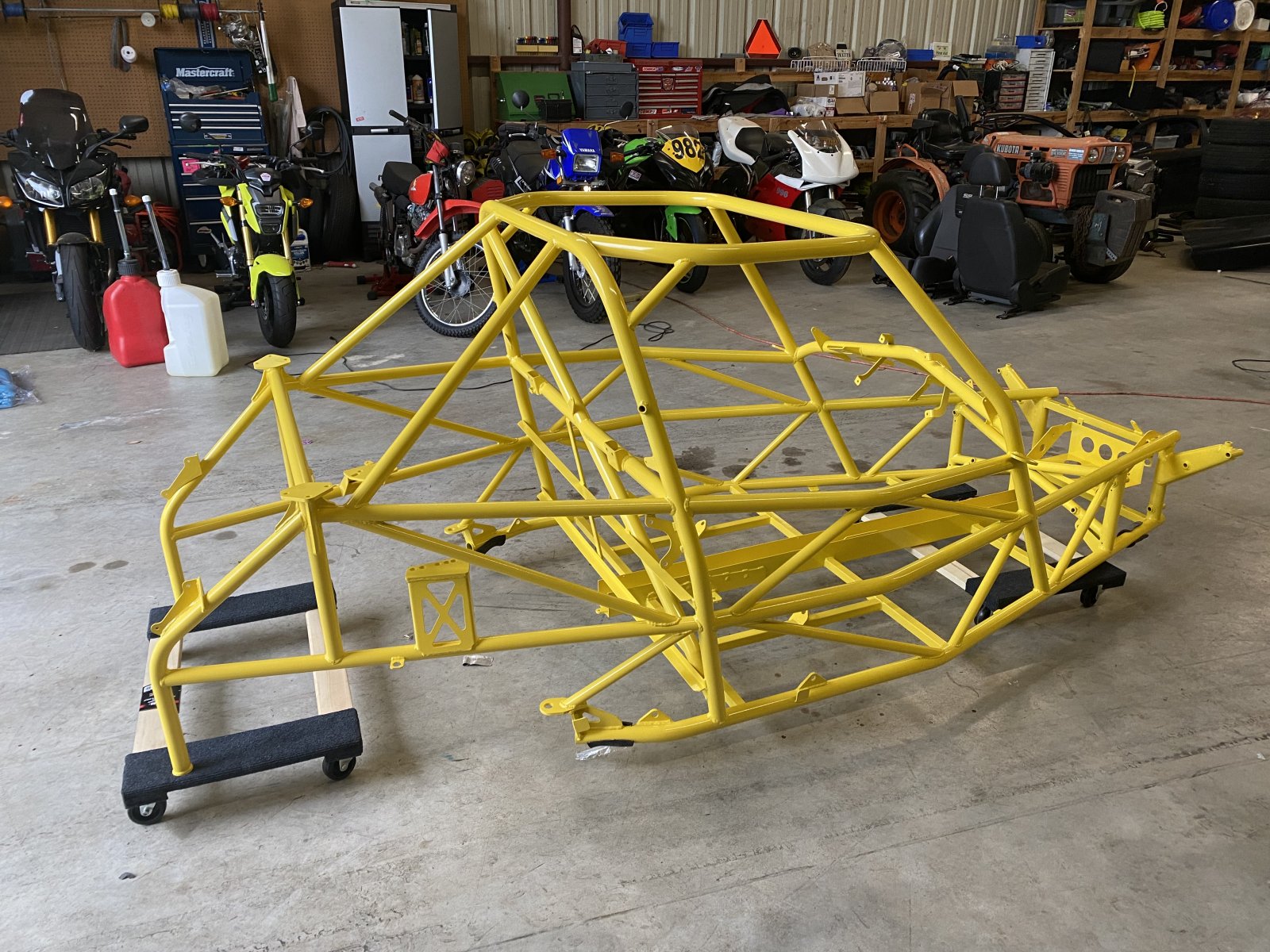

I sent it off to the powder coater and I have a bright safety yellow frame now. :oops:
One hour, and you have bought your donor, pulled the engine, bought your frame, had it powder coated.
Man you move fast. Looks good!

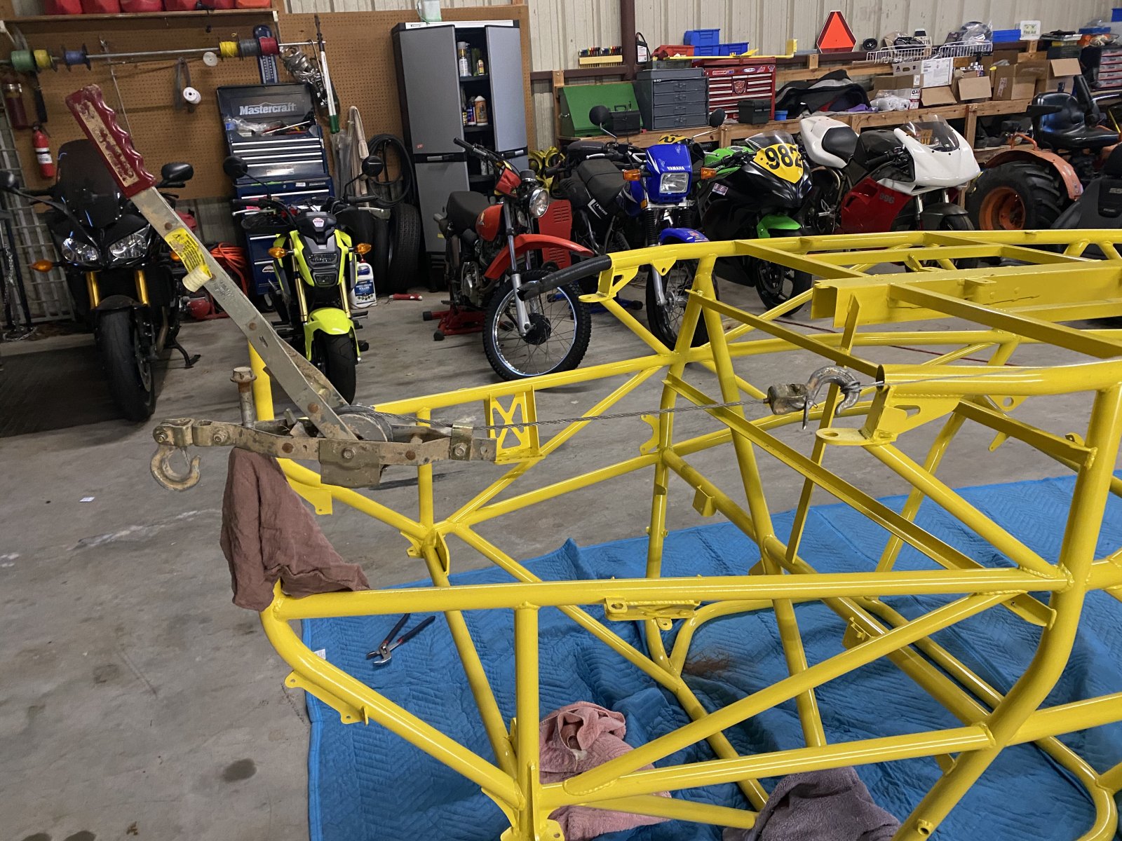

So, we are not supposed to go anywhere and it’s a rainy day, so it’s work on the goblin time. I have been working on the wiring harness off and on for a while now. It’s not easy being colorblind and trying to figure out wire colors on a faded harness :( When my frustration gets too high, I have to take a brake. Anyways, I got a bit further, then my buddy showed up, so I had him help me pull the hoses through the frame.
The first one wasn’t too bad, until the end, Then it took some “effort”. :rolleyes: The second one fought us right off the get go. We tried a few different options, then decided to use our heads for more than just a hat rest and came up with a solution. We put the bolt in the end of the tube, slid a come-a-long on top and bam, done. :cool:

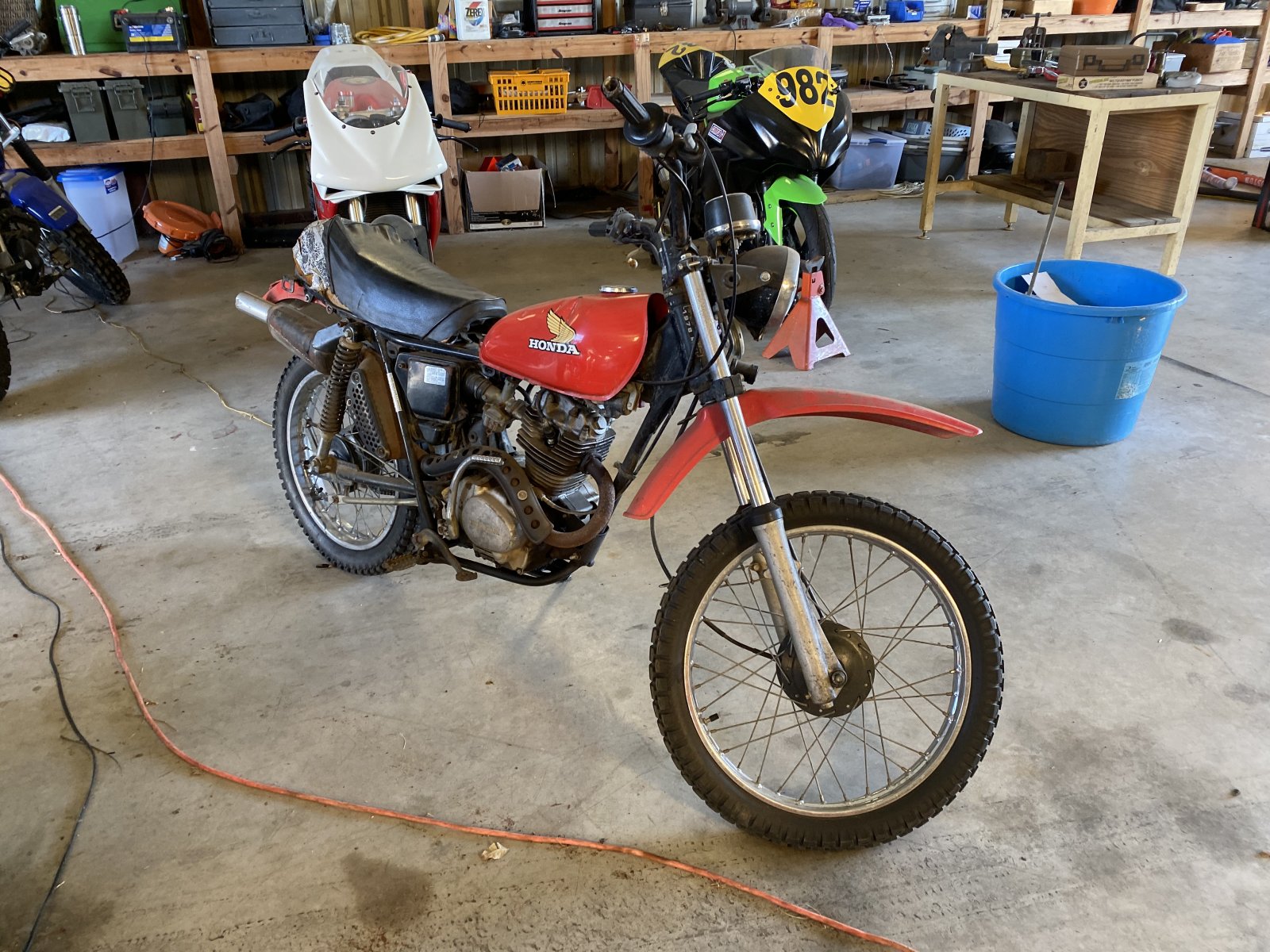

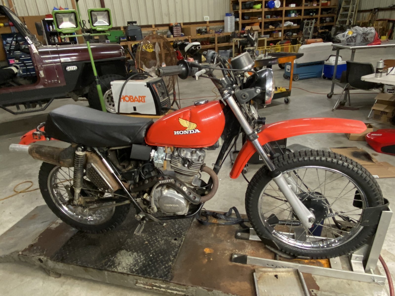

I see an old Honda XL. I have my dads original `78 XL 175 he got for his 15th birthday in my shed that I'll rebuild one day. When I was a kid we were starting it and the kick starter sheared off flush with the case. That was probably 17 years ago.

yep. ‘78 XL100 I picked up a few months ago for next to nothing. It’s amazing how much stuff is still available for those. That thing runs and rides great and I don’t even think I have $500? In it :cool: they are a ton of fun and very easy to ride.
lol. We used the winch on my 4 wheeler on the second pull, but couldn’t get the frame to stay still, so the winch could do its job. :mad: The come a long, actually worked perfect. Almost no stress on anything.

I strapped my frame to the tree behind it. What you came up looks like it worked well.
Someone needs to start a thread on the different ways to pull the hoses, and sticky it.

no way!!!!!!! o_O You could have pulled BOTH hoses at the same time with that!!!! :)
