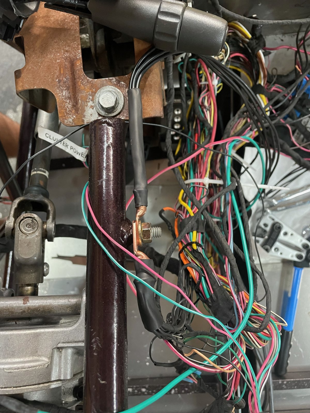

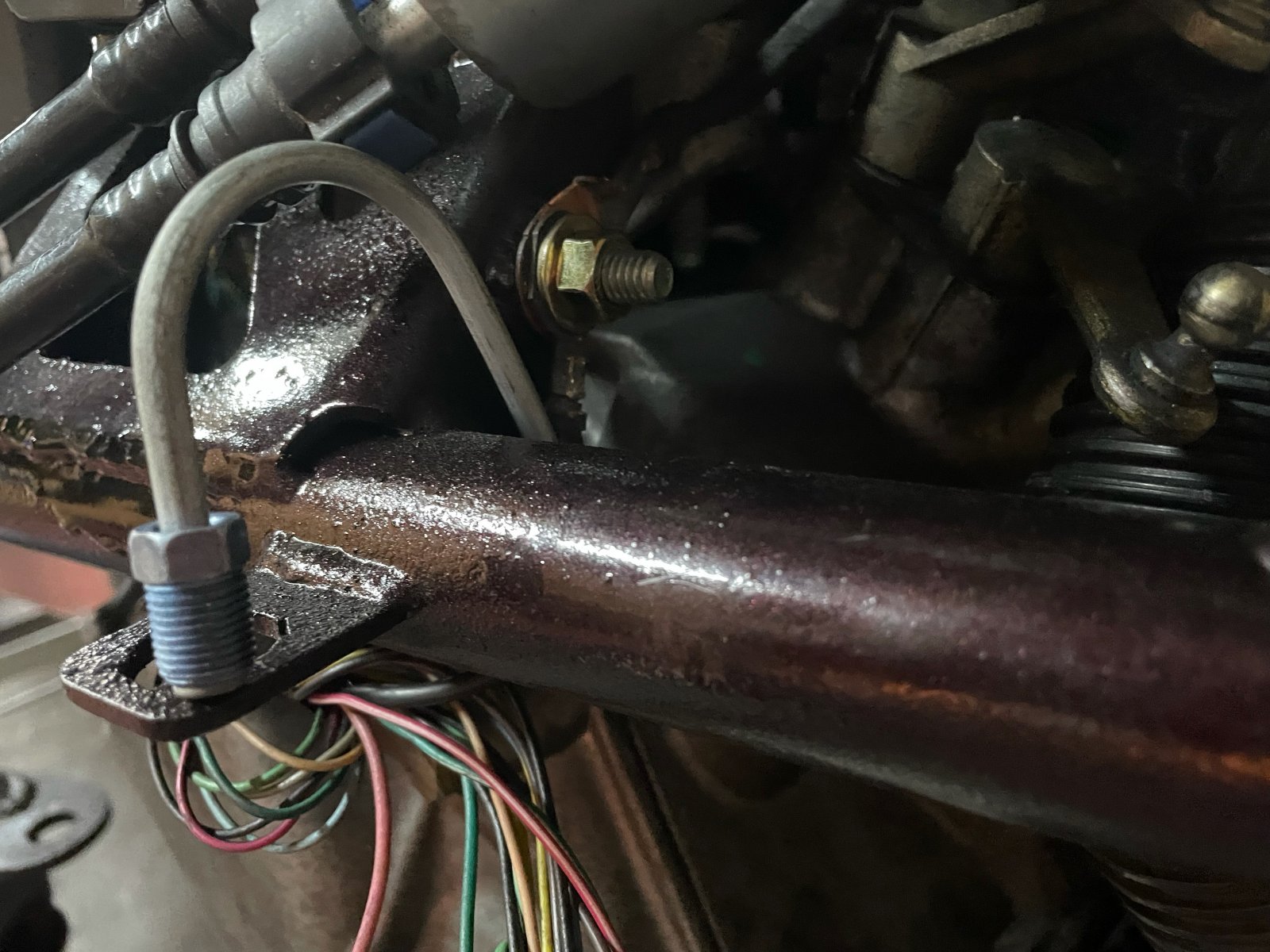

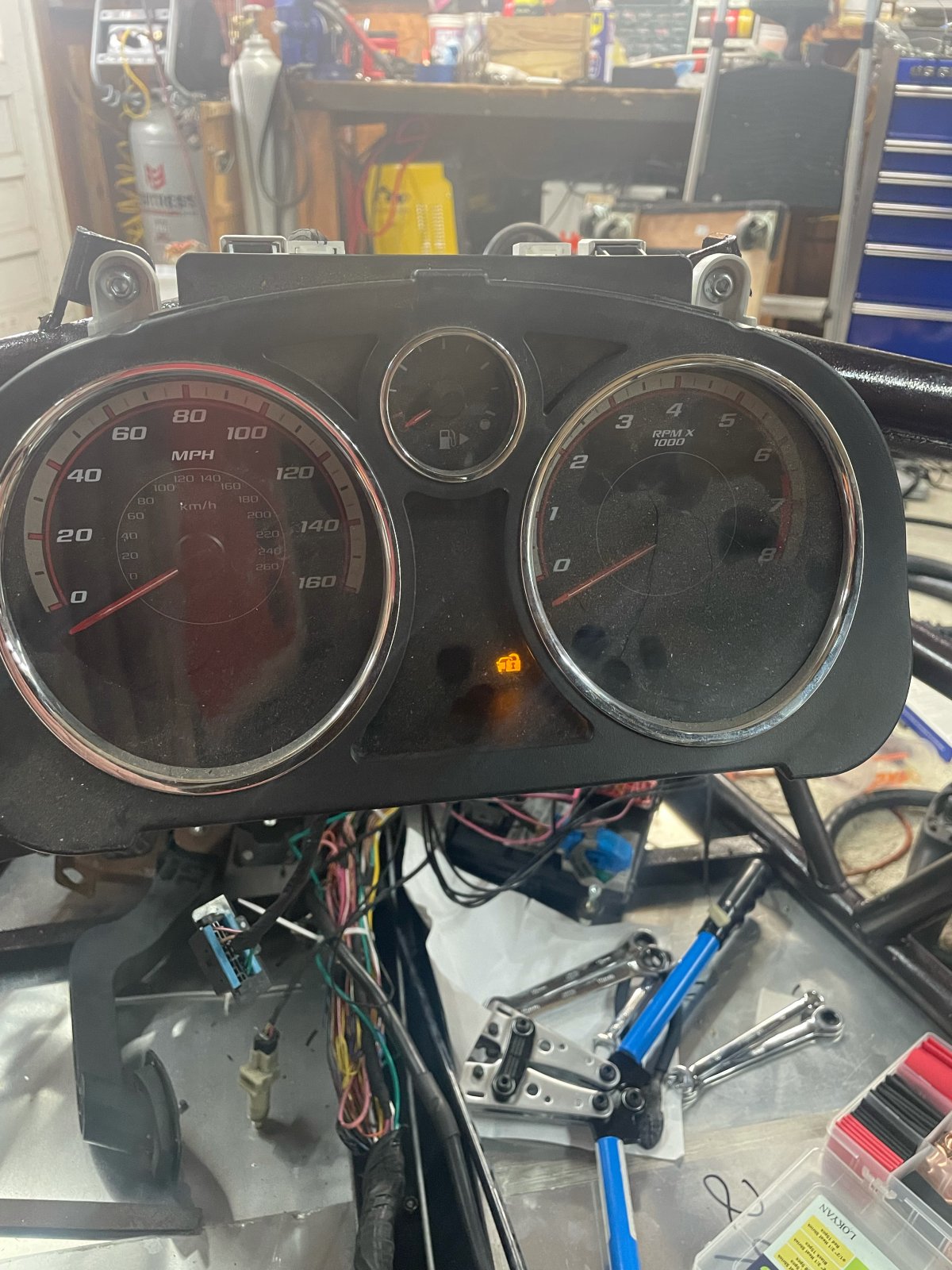

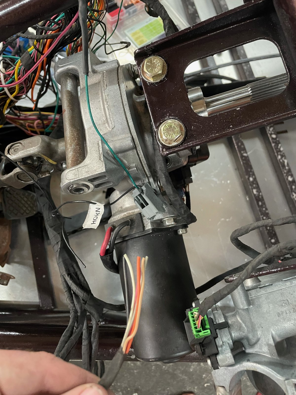

2006 LSJ Donor. Trying to attempt a first start or at least get the fuel pump primed. I hear a click from the BCM when turning the key to the on/ready/prime position. Console displays a security light. At first attempt, I didn't even have the light come on and rechecked all my grounds. Starter has the extended wire + purple wire setup correctly. I can get 12v to the fuse block. I have a few connectors not connected in the rear, the radiator fan, a purple plug and the coolant overflow tank sensor. All grounds up front go to the steering box ground since the tunnel ground did not have a good connection, thinking of just running the extended tunnel ground directly to the battery ground post. Two grounds in the rear, which I believe is fuse block + harness. Looking for some advice on troubleshooting further.

C

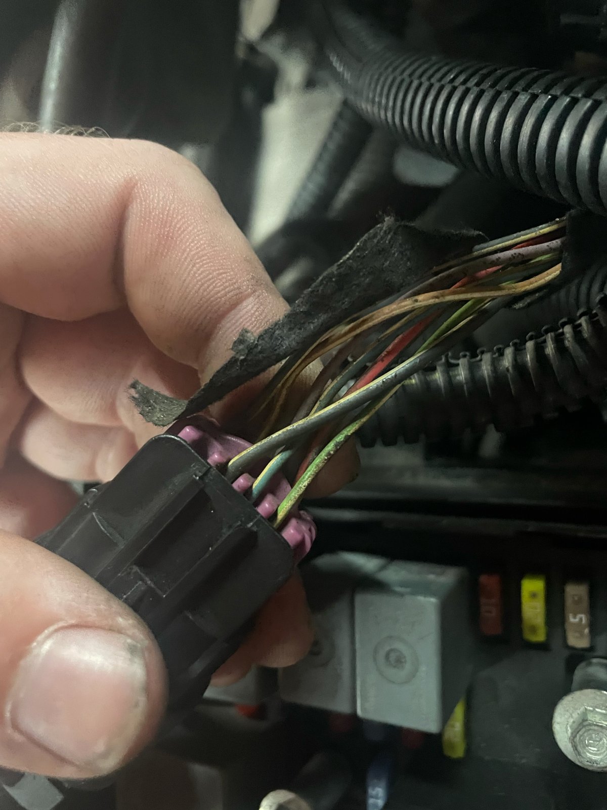

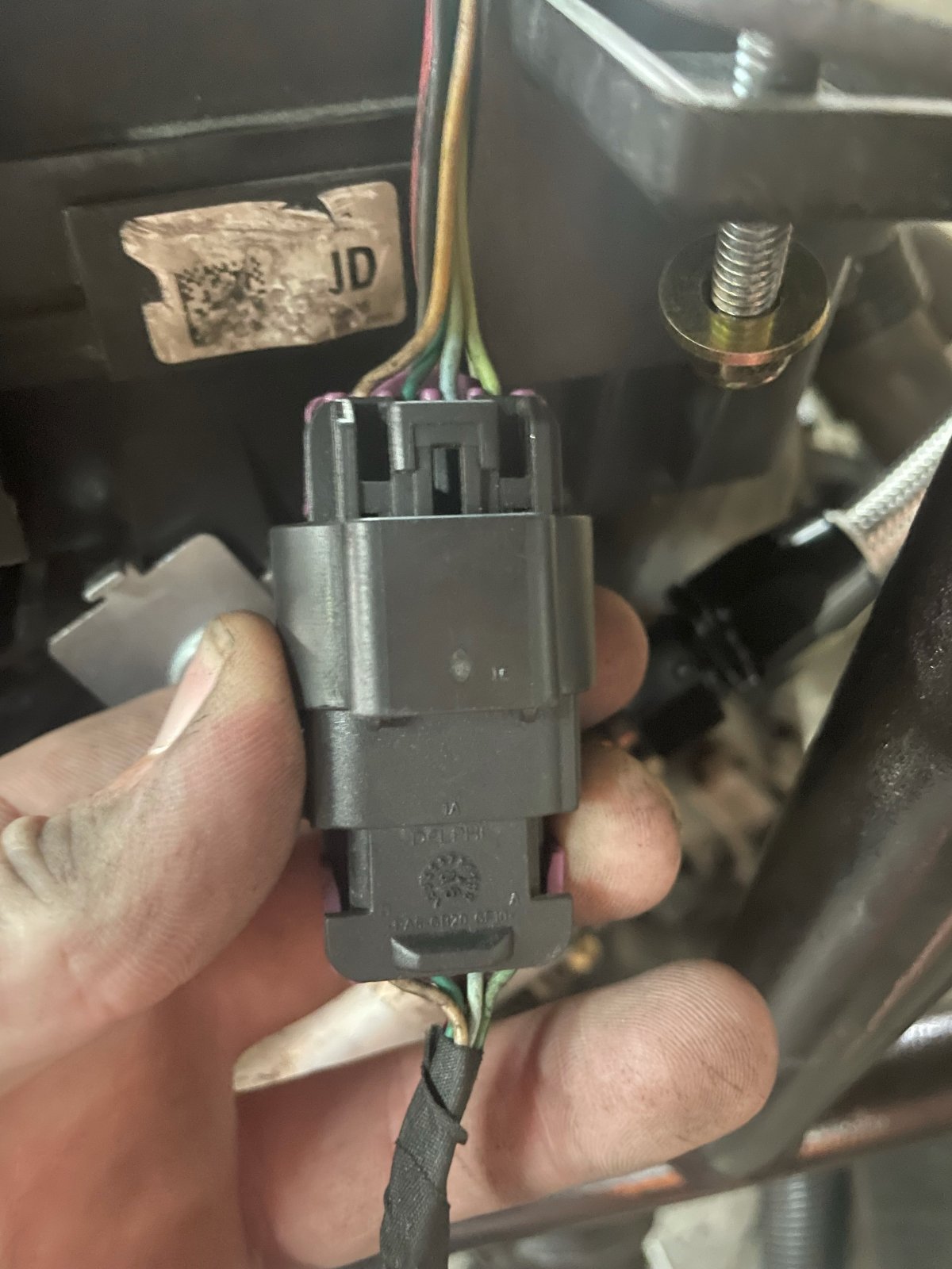

There are 3 purple plugs that need to be correcly connected.
Does your OBDII port work, and allow you to pull the codes?

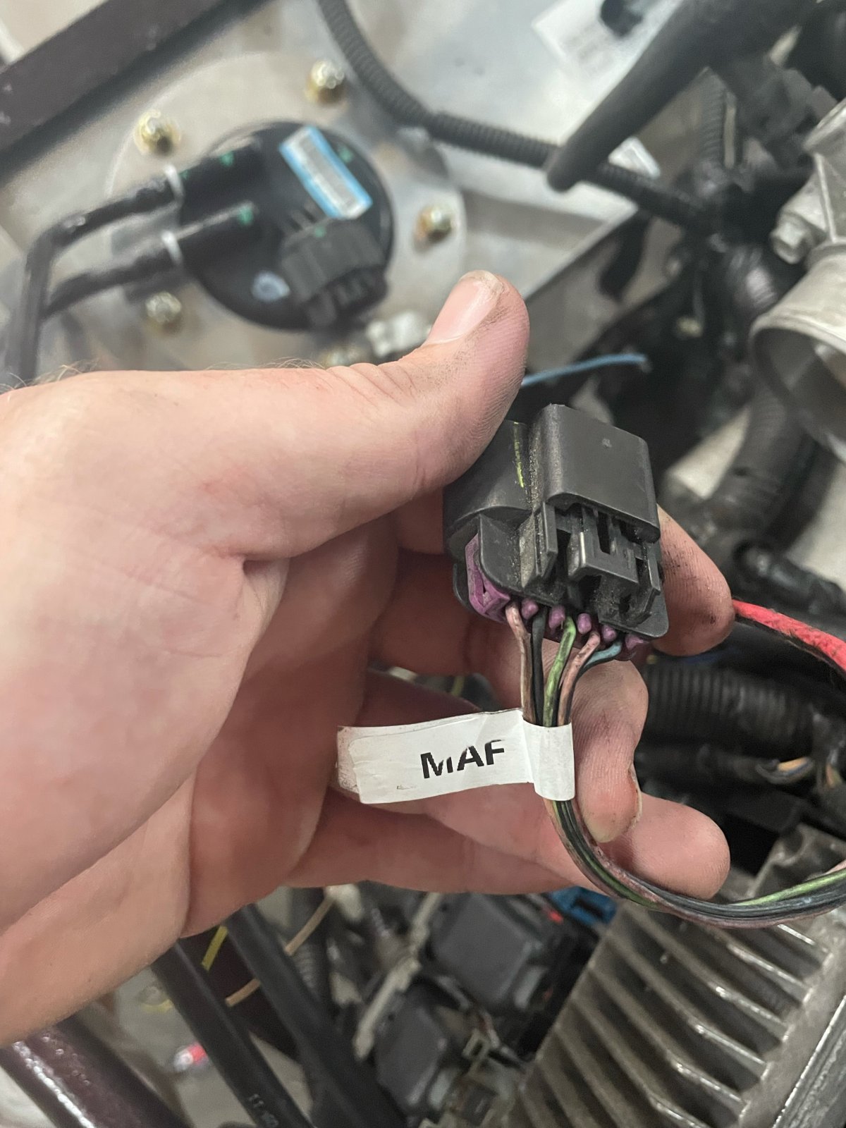

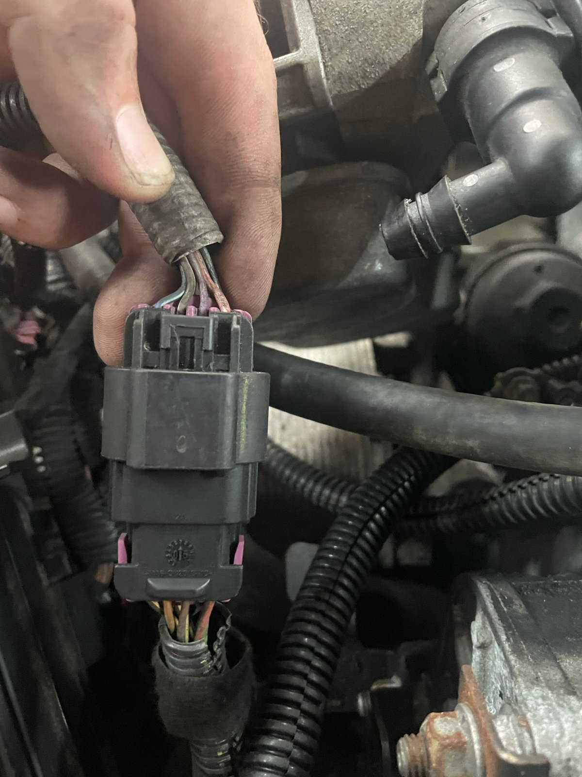

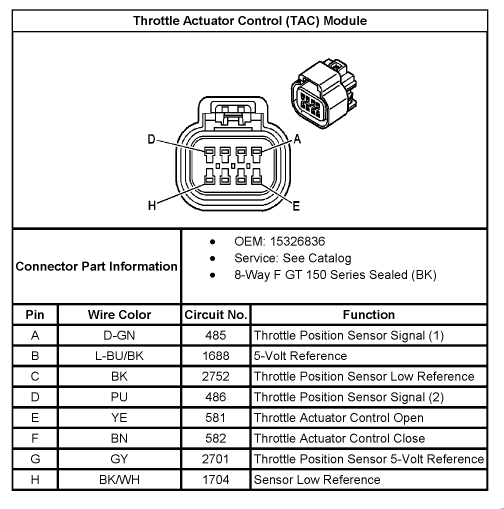

I was missing the purple plug that goes under the throttle body. Still have the security light and my OBD2 does not seem to work/getting power. I assume this is because of the lock out and hopefully not a wiring issue with the obd2
C
Looks like my routing was messed up, one of the connectors had the wrong color wires with the other 7 pin purple plug which is now fixed(power to engine). But now the purple 7 wire plug that goes to the coil pack doesn't have the same color wires...the throttle plug is the correct 8 wire plug.

I added this to my Purple Plug post. Is this the color of wires that you have going to throttle body plug?
The coil pack should have the same color wires in and out of the 8 pin connector.
26930
The coil pack connector, top row has: no wire, black, light blue with a white stripe, green with white stripe.
next row has: blue with white stripe, brown with white stripe, purple, pink with white stripe.

That connector is connected to the coil pack via this purple connecter. The wires look different; black/white, blue/white, light green/white one side then red/black, brown/white and blue/white.

Those are the right wires. My red wire has faded to pink, you missed the purple wire, but otherwise we agree that is the coil pack connector.
I updated this post with all the wire colors.

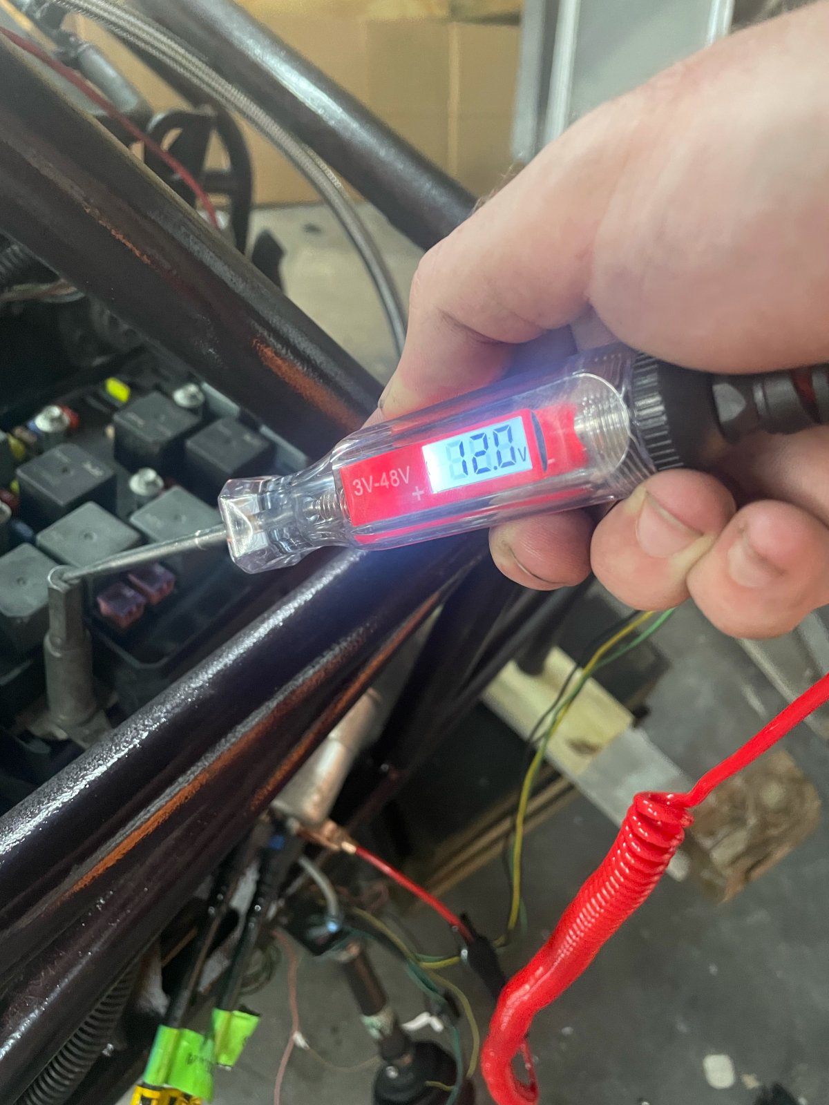

What is the best way to test this? I know the fuse is good, so I would use a multimeter to verify that no voltage is on the fuse pin(I would use the red multimeter pin on one side of the fuse pin, black on the other)? If that is a yes, then I could test continuity between D5 on the fuse block and pin 16 on the obd2 to verify the connection is good.
To test the fuse pin, put your meter on DC voltage,
put the black probe on a ground post, bare engine, or bare frame somewhere,
put the red probe on the fuse, or fuse pin if you have the fuse out, and one of the 2 pins should read 12V (if the key is on). The other fuse pin should be a direct connection to your OBDII port, pin 16.
C
Update: While testing the pin, I saw 12vs on the fuse block side. I only saw like .05V on the obdII. I then started messing with the rear fuse block and heard the fuse pump come on. It may just be some loose wires causing the issue. I ran the pump dry so I'm going to fill her up with gas and check everything over.
edit: After reseating the fuse block, the dash and obdII seem to be working. The fuel pump didn't prime going to pull codes.
C
Yeah now the dash is lighting up completely. Just seems like I have some loose wires and have to go through everything a little more thoroughly.
