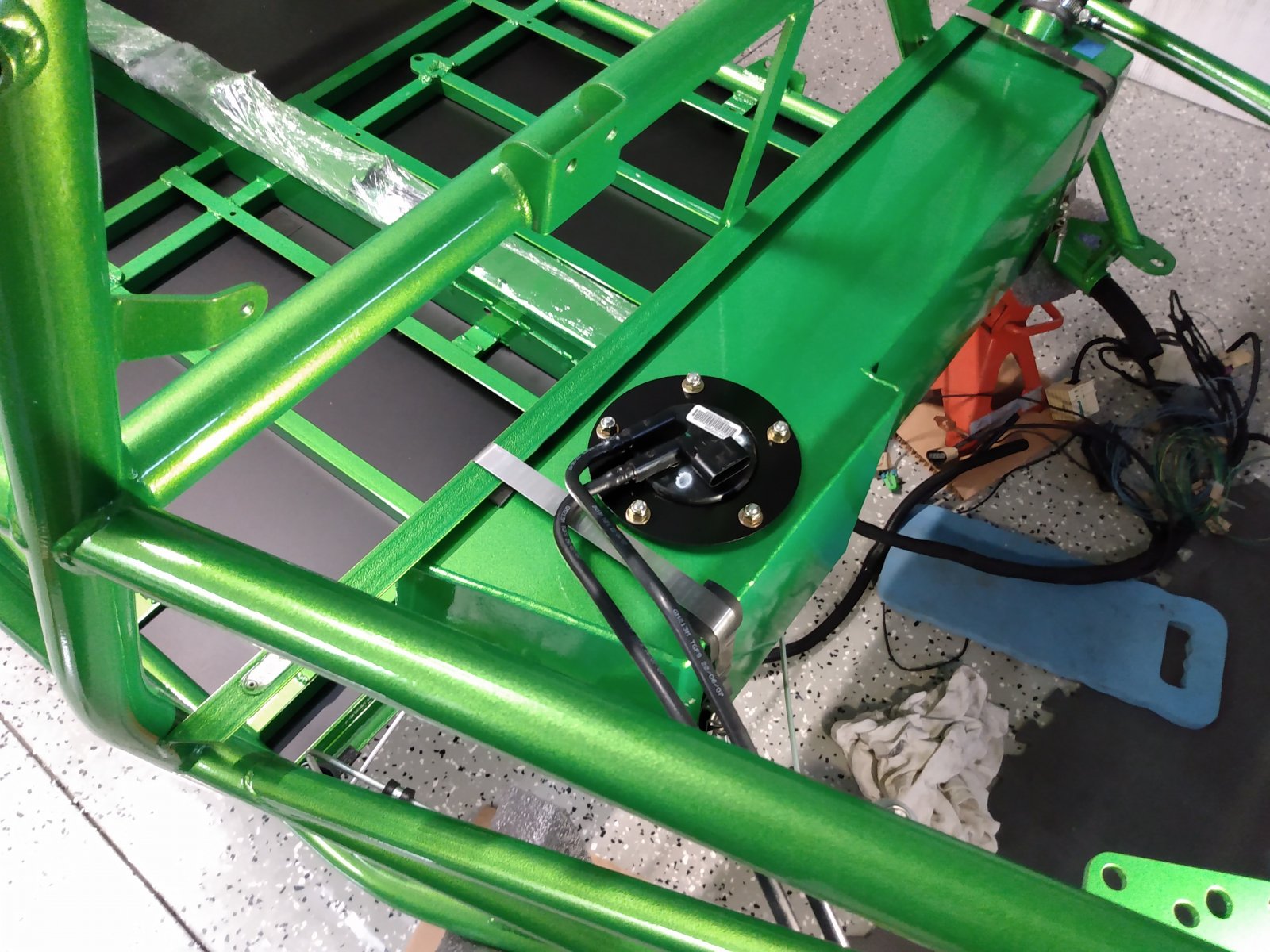

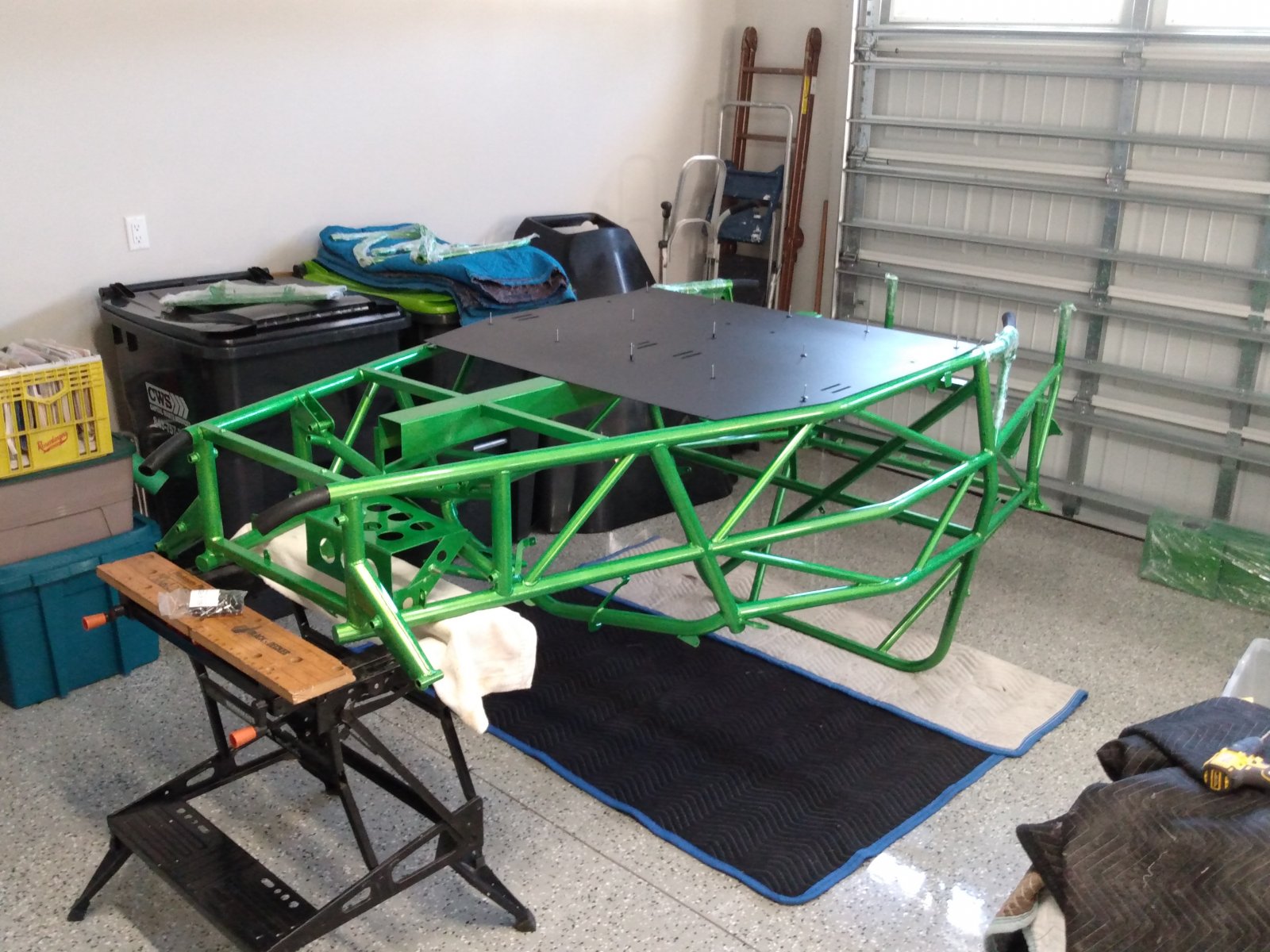

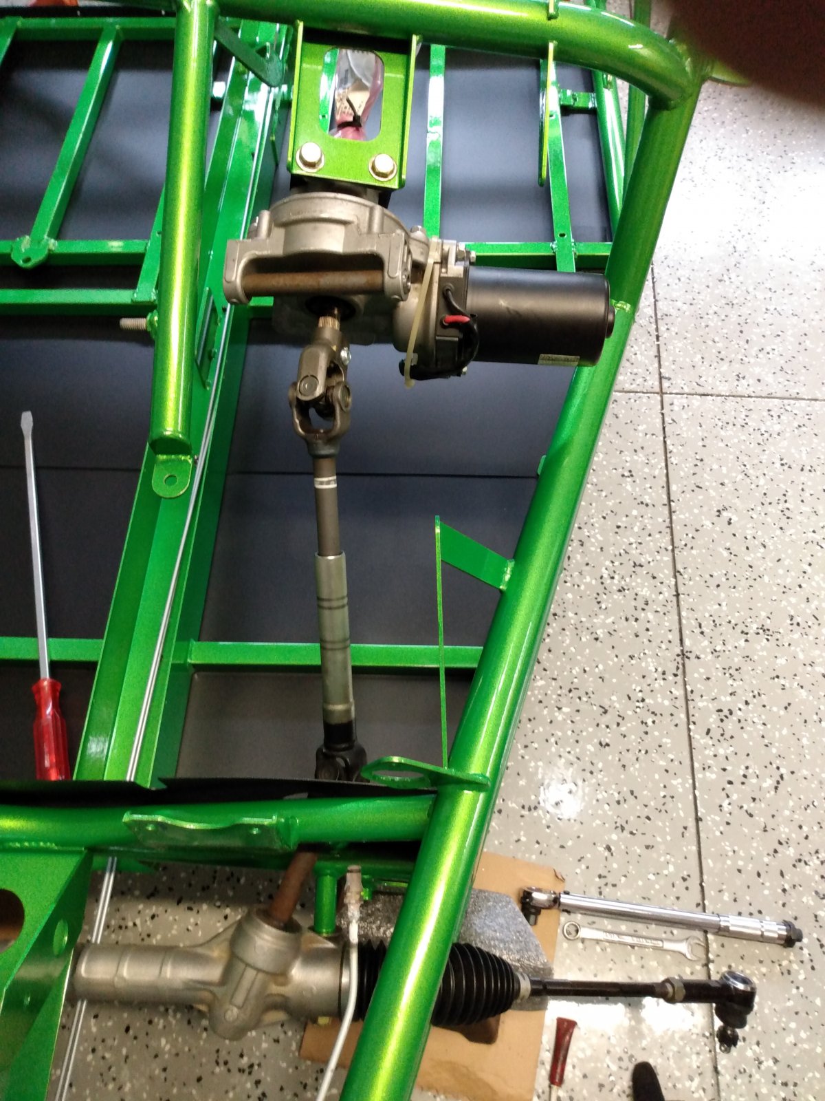

Did the frame, tank, rad support, A arms and tunnel cover/s in lime green. The sub frame, windshield mount, rear steering rack floor strap, passenger kick plate, coolant reservoir bracket, front & rear engine mounts, headlight brackets, shifter cable bracket and fuel pump ring in semi-gloss black. The aluminum panels, floor pans, fire walls and the side panels in a textured semi-gloss black.
