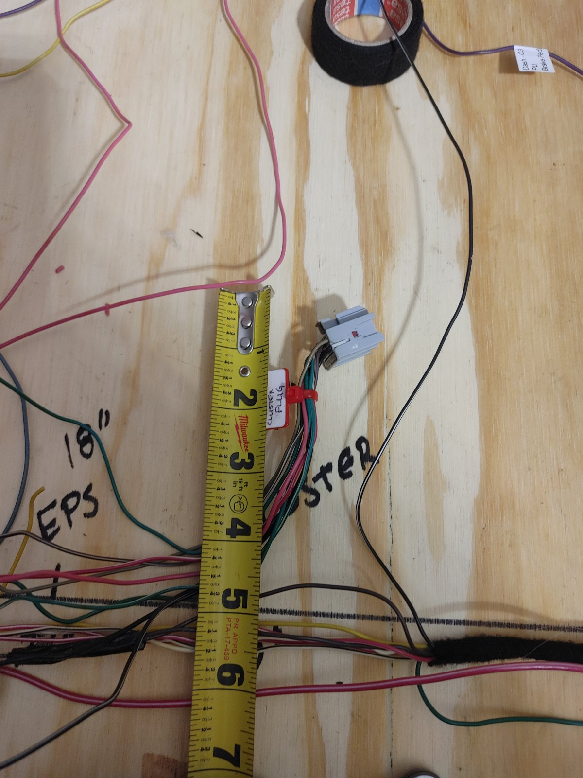

My sensor harness is 12' and if I place the sensor connector around mid-fusebox and run it up to the BCM, around the screw and across the dash layout, it makes it to the turn signal mark on my board with a couple of inches left over. I planned on mounting my 2 gauges above the steering wheel, so I'm not sure that's enough length. If the sensor's pigtail makes it to the fuse box or allows me to mount the harness a little further forward I guess it would be long enough. Again, hard to know or visualize until I get my kit but want to integrate it into the harness now while I am working on it.
My gauge is beside the steering column, the sensor's connector is near the F35 shifter cables mounting point. I ran the AEM cable from the gauge, thru the tunnel, under the fusebox to the sensor. There is a 2nd AEM cable that goes from the gauge to the BCM for 12V+ and ground lug.

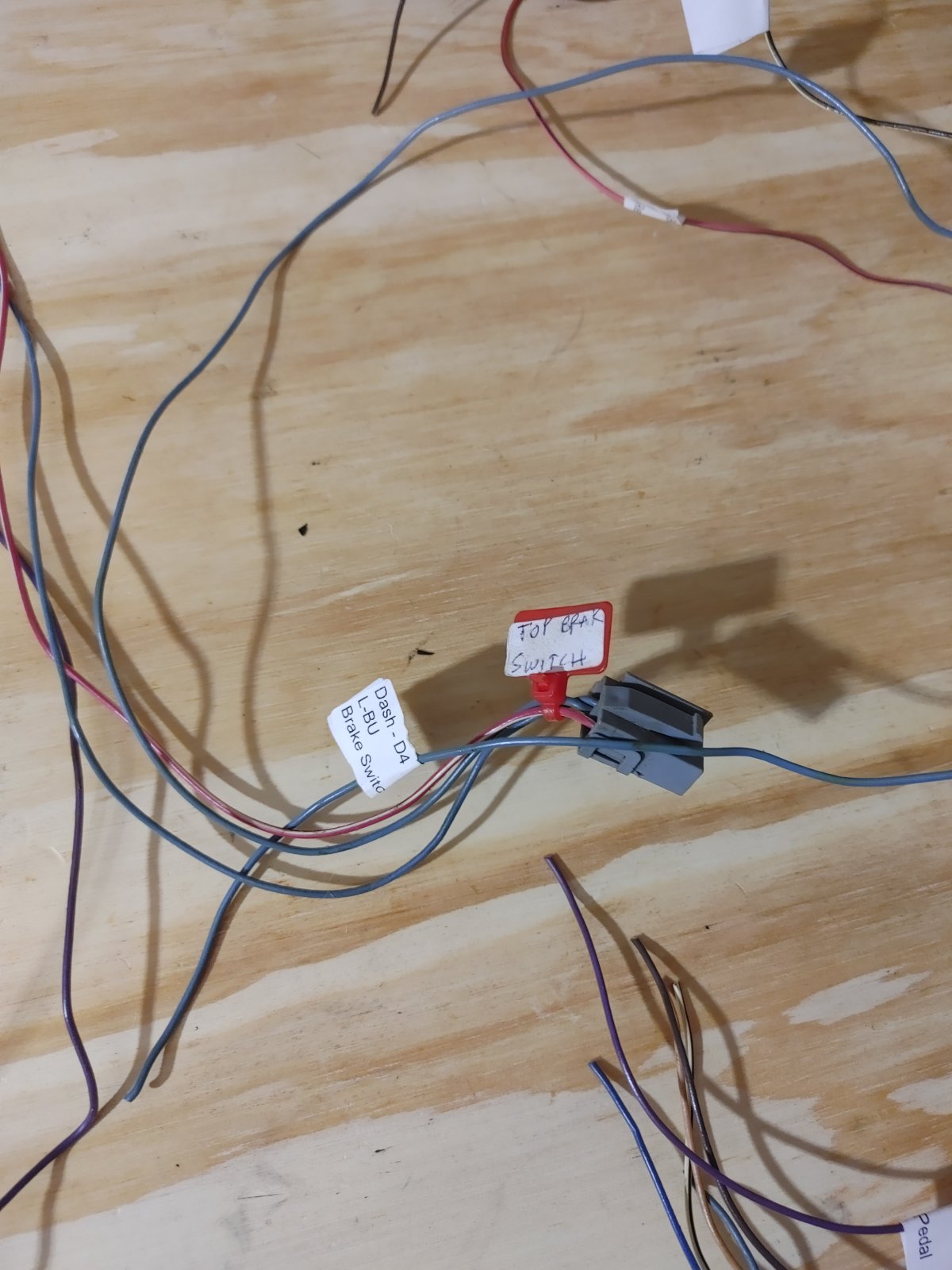

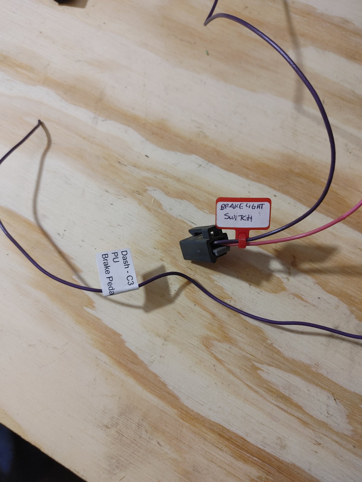

I got to the 3:47 mark of the Organizing the Dash Harness video and it shows a brake connector that is cut and tied. I know the connectors vary between years/models but I have 2 brake connectors and not just 1. Also, each of these connectors only has 1 wire each that runs to the BCM, 1 wire that was labeled previously (Brake Pedal and Brake Switch respectively), and one of them (Brake Switch connector) has a loose LT-BU wire:
29078
29079
I'm not sure which one of these relates to the single connector style referenced in the video nor does cutting either of these in the middle make sense when only one wire for each is still attached with another wire already requiring extension.

I got to the 3:47 mark of the Organizing the Dash Harness video and it shows a brake connector that is cut and tied. I know the connectors vary between years/models but I have 2 brake connectors and not just 1. Also, each of these connectors only has 1 wire each that runs to the BCM, 1 wire that was labeled previously (Brake Pedal and Brake Switch respectively), and one of them (Brake Switch connector) has a loose LT-BU wire.
Watching ahead, it looks like the brake connectors get reconnected again.
I think my approach will be to not cut anything, as the single wire between each connector and the BCM is plenty long enough to reach where they get reconnected. Both connectors have a wire to be extended back to the main harness so I will just extend those after taping the connectors where they belong in the dash harness.
I still need to figure out what the light blue wire does that is hanging off the Brake Switch connector (it was the top connector on my donor) though.

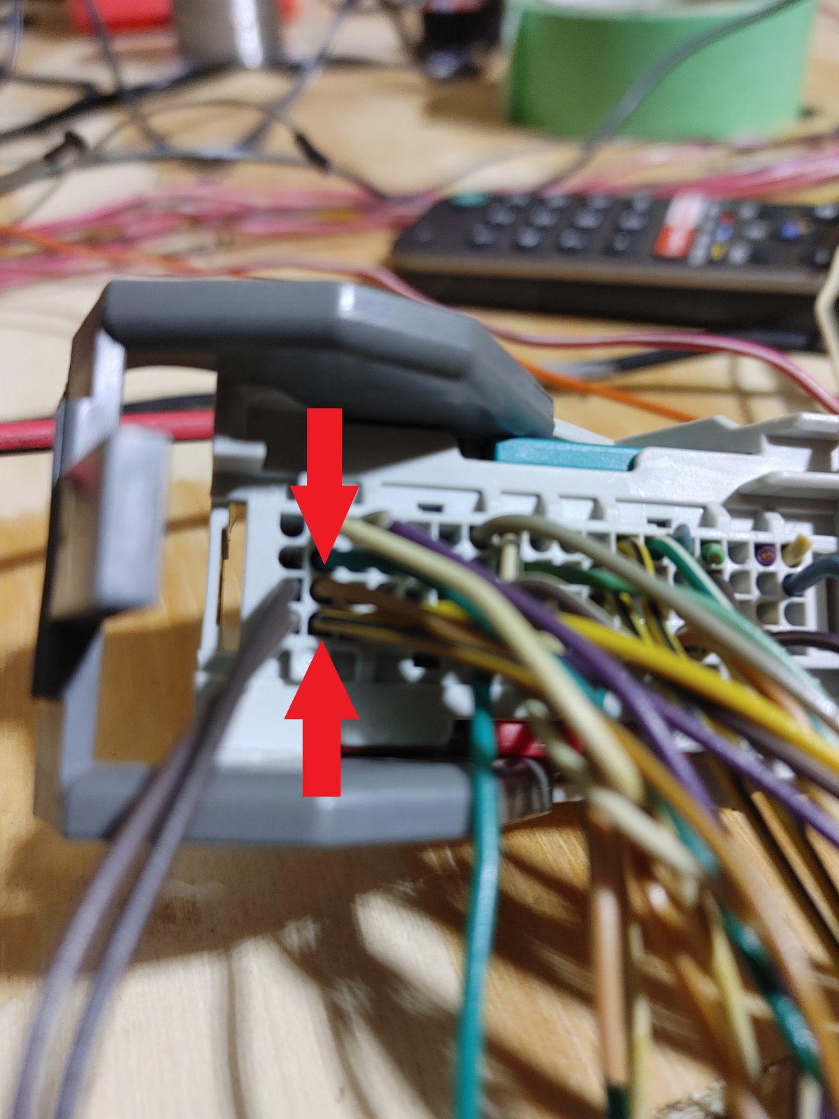

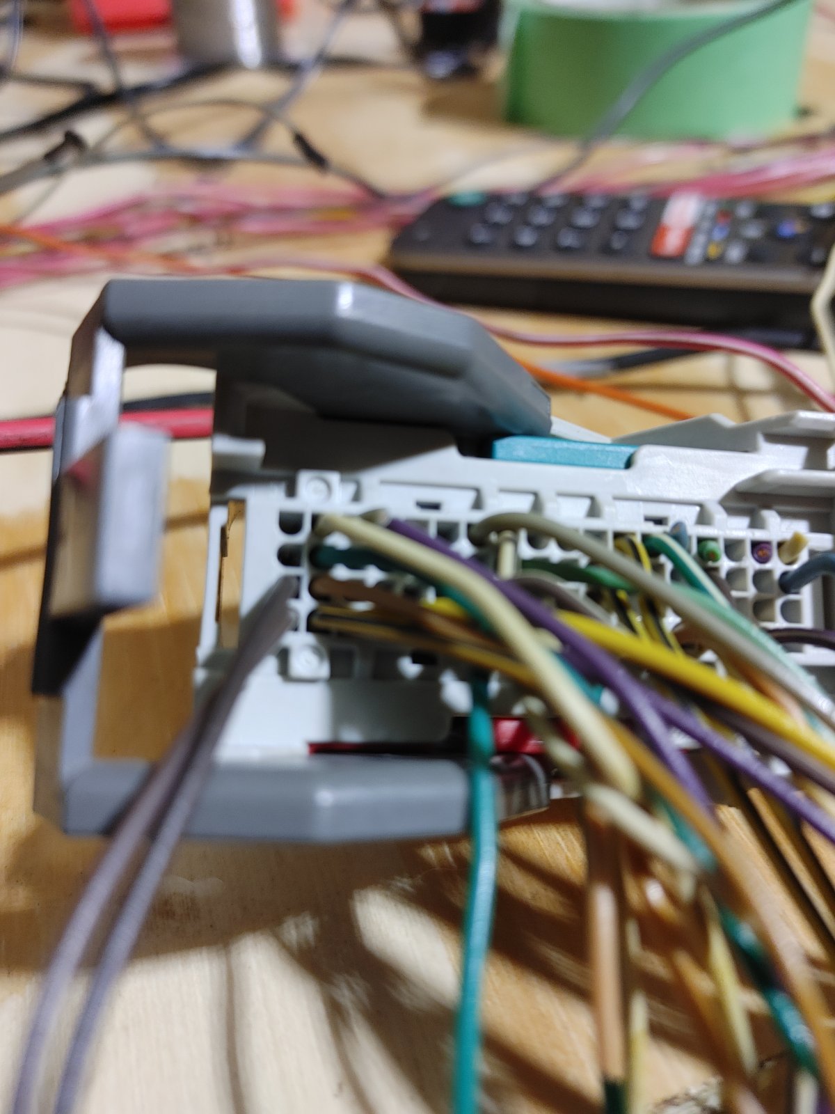

I am at the first step in the Combining Harness video where I need to extend the twisted data wires. Way back at the beginning, I added the extensions to the data wires by the ECM and ran those down to the BCM.
A few posts ago, I mentioned the problem I ran into of not having either the RPD or Boost Gauge connector as expected in my 2007 SS/SC, but I did have the twisted brown wires coming out of my body-to-dash connector (pins C5 & C6).
The brown twisted pair wires were cut at the connector to get rid of the connector and they run into the already taped bundle at the BCM. I'm not sure where they go, but I can cut open all the wrapped bundles if I need to. I don't have any other twisted brown wire pairs left, so I am assuming these are what gets connected to the extensions from the ECM. I just want to make sure this is correct as it doesn't make a lot of sense to me, nor does it resemble either option in the video - running to the RPD/boost gauge down by the ignition or connecting back on the main harness.
Mine has twisted brown wires coming out of the BCM headed towards the ignition on the dash harness with the ECM extensions coming around the main-to-dash harness corner and meeting there. If there was an RPD/boost gauge at the end of the data wires I understand where they are going but if they are just running to the BCM, is it terminated in there somewhere?
Any insight from anyone would be appreciated.
Thanks in advance!
edit: I just tore everything back apart on the BCM side and the dash-to-body C5/C6 wires go to this spot on the BCM connector:

If this is BCM C2 pins 2 and 20, then these are the High Speed GMLAN Serial wires (+ and - respectively) and should be connected to my extension coming from the ECM. That's as close to a solution as I can come up with, but not sure.
You should have a pair of data wires heading toward the front from your ECM.
You should have a pair of data wires coming out of the BCM.attach those to the ECM data wires.
Tan to tan and tan/black to tan/black.
If you follow the two brown twisted wires next to your red arrows they should arrive at your power steering connector. A tan pair should leave there and go to your OBDII connector.
Sluggonaut
Yes, the brown wires at Pins 1 & 19 go to the power steering bundle and the tan pair from the PS bundle go to the OBDII. That makes a lot more sense and easier to figure out once I identified the BCM connector as C2 and could match up the diagram.

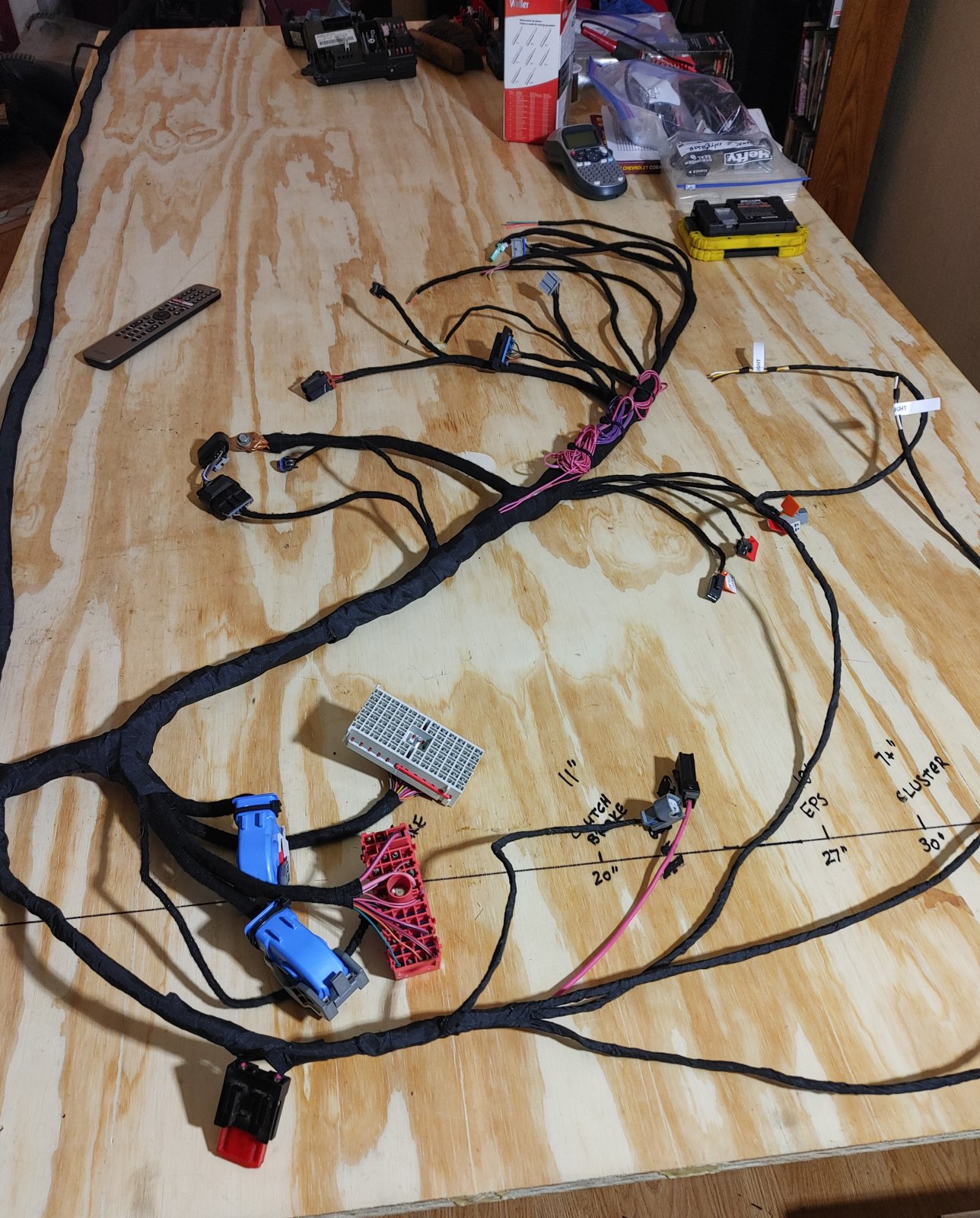

Finished the wiring harness tonight and just in time for my deadline of tomorrow. I still have to tear down the harness table and finish cleaning up my work area but the harness is officially done. The only real hurdles down the home stretch were some wires that got taped up along the way in the dash harness and I had some tape removal and replacement activities along the way.
Note to future builders: Make sure the TPMS receiver wires stay by the BCM so they don't end up taped down somewhere in the middle of the dash harness. Tessa tape works great on all fronts except unwrapping unless you have a nice unwrapping tool (aka knife or razor).
All the grounds tested good and the major 'gotchas' have been traced (i.e. LSJ green wire from DLC/Pin 2 back to the ECM). I will try not to have anxiety about the first start until it's time to cross that bridge.
