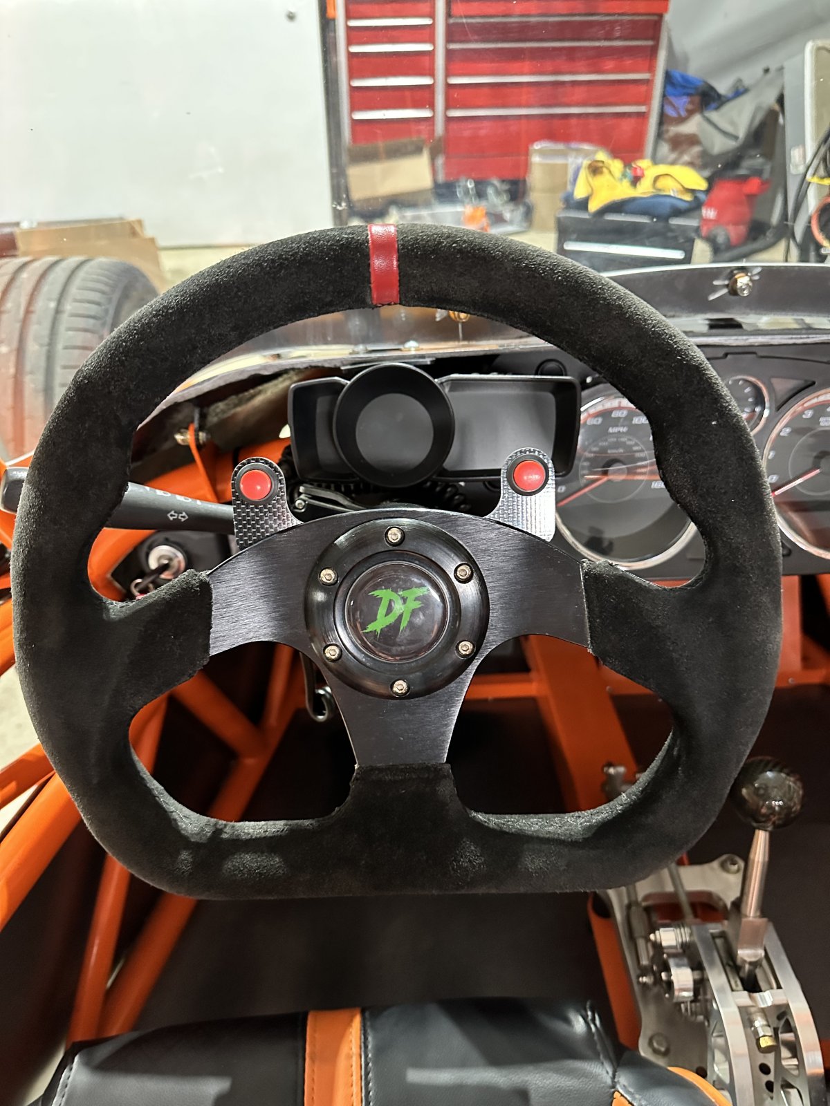

Latest change. I got tired of reaching to the dash for the horn. Got this off of Amazon. Got the one with 2 buttons in case I need an additional one later.
I could find the buttons here, but couldn't find one with a coiled wire. Searching for coiled wire led me to telephone cords. Is that what you used?
Any plug-in for the cord so you can remove the steering wheel from the car? At least further than the cord will reach.
Like one of these:
Plugging into one of these:
The plug would go into the receptacle mounted in the dash. At least that's how I would envision this to work. :D
Edit: doh! This is only if the buttons are part of the steering wheel!
SmsDetroit
Like one of these:
nope just a male and female spade connection. If I need to I’ll unplug them.
