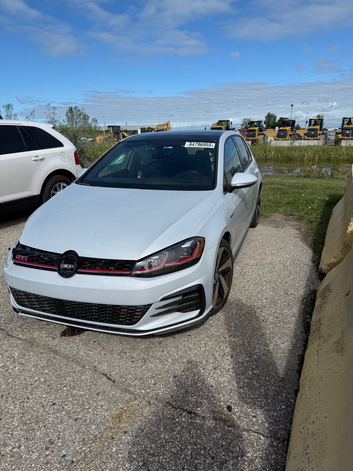

Well, I did it LOL. Put my deposit down for a V2 and purchased my donor.
2020 GTI with 23K miles on it. Hit lightly in left front. Actually, drives pretty nice. LOL
Chassis # V2-018 Run #2
Run #1 expected to start shipping very soon.
