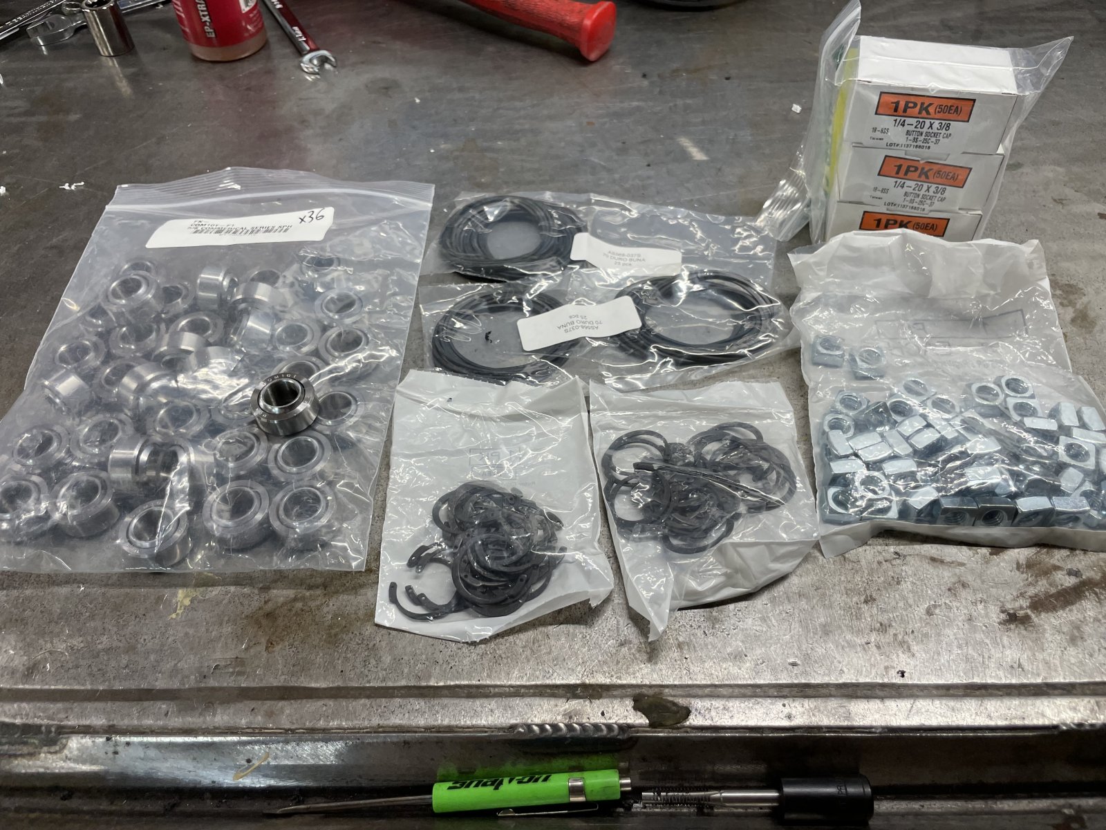

Status/updates:

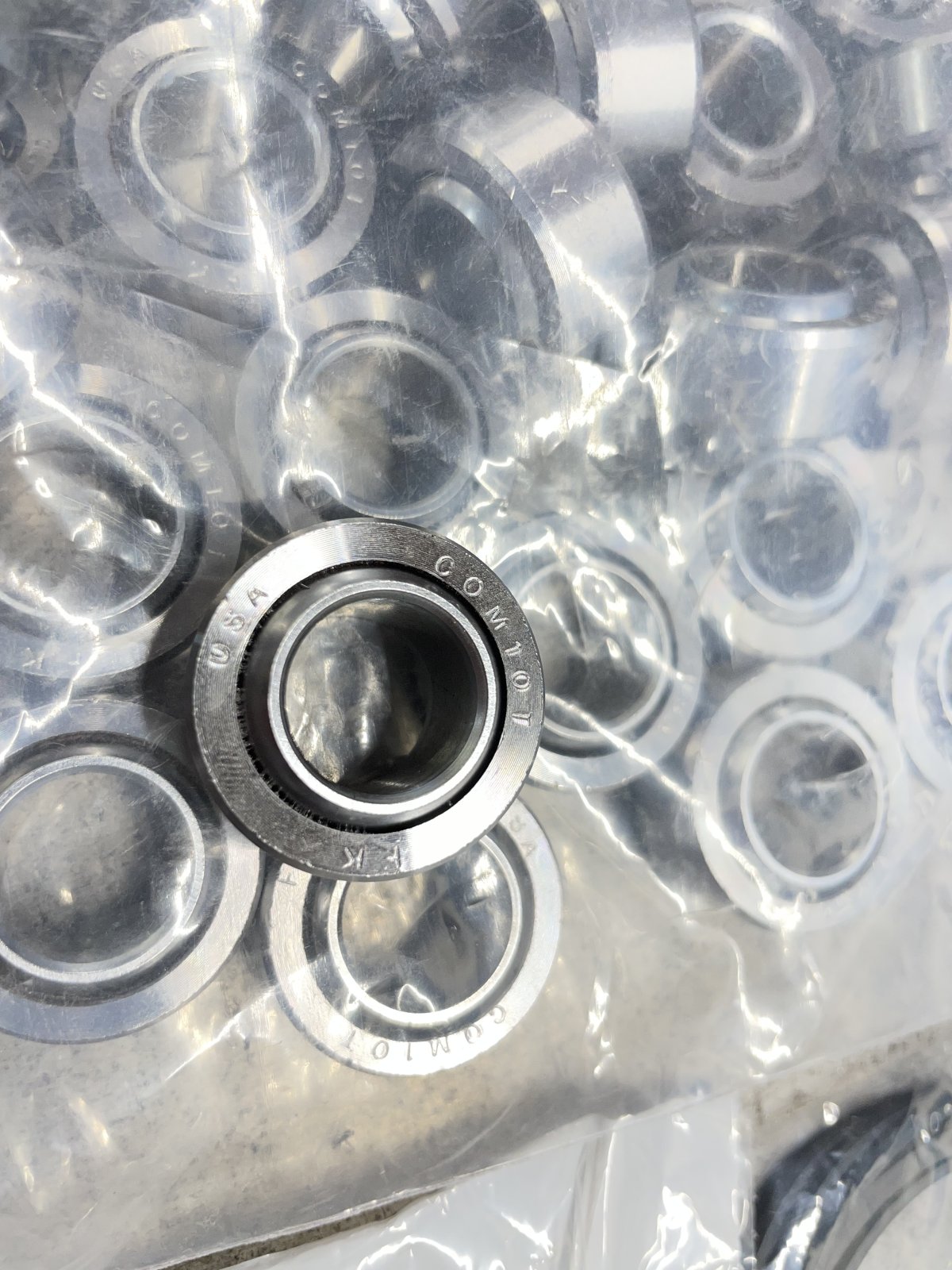

-Bearings and Mcmaster hardware is in! The bearings are really nice; they’ve got a nice tight fit, just what you need for cyclic axial loading.

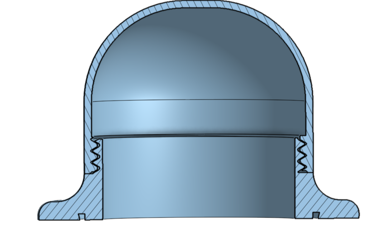

-the 2 piece dust cap design is done. I’m all for change if it’s better, and tool-less access to the adjusting knob is better even if you rarely touch it. The only downside is the cap is no longer submersion-proof (just rain and dirt proof), but last I checked nobodies Goblin is amphibious. I’m assuming most of us would prefer the 2pc cap, so I’ll be switching to that as the default. However, if you prefer the 1pc cap (might be better for an AT goblin?) let me know and I can definitely ship you a 1pc cap. I’ll post both designs once everything ships, so if you have a printer at home you can print both and/or change to a different color and/or modify the design for aesthetic preferences.

Yeah I kind of like the thread on cap. Hopefully it prints such that there's a little resistance/friction between the two halves so it won't free spin. I can see it working loose and flying off going down the highway :D. This is my kind of luck anyway

Already ahead of you, my luck is the same haha. Typically for 3D printed threads you add quite a bit of clearance between male/female because the thread effectively grows from layer height, overhang, and the threads are always a bit "messy" (you can see this clearance if you zoom into the cross section picture). With that said, I'm tightening that a bit more than I typically would so the threads have some drag.

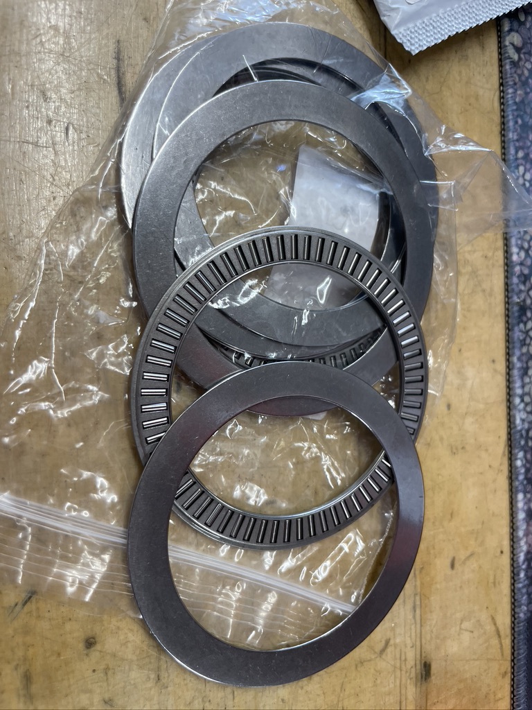

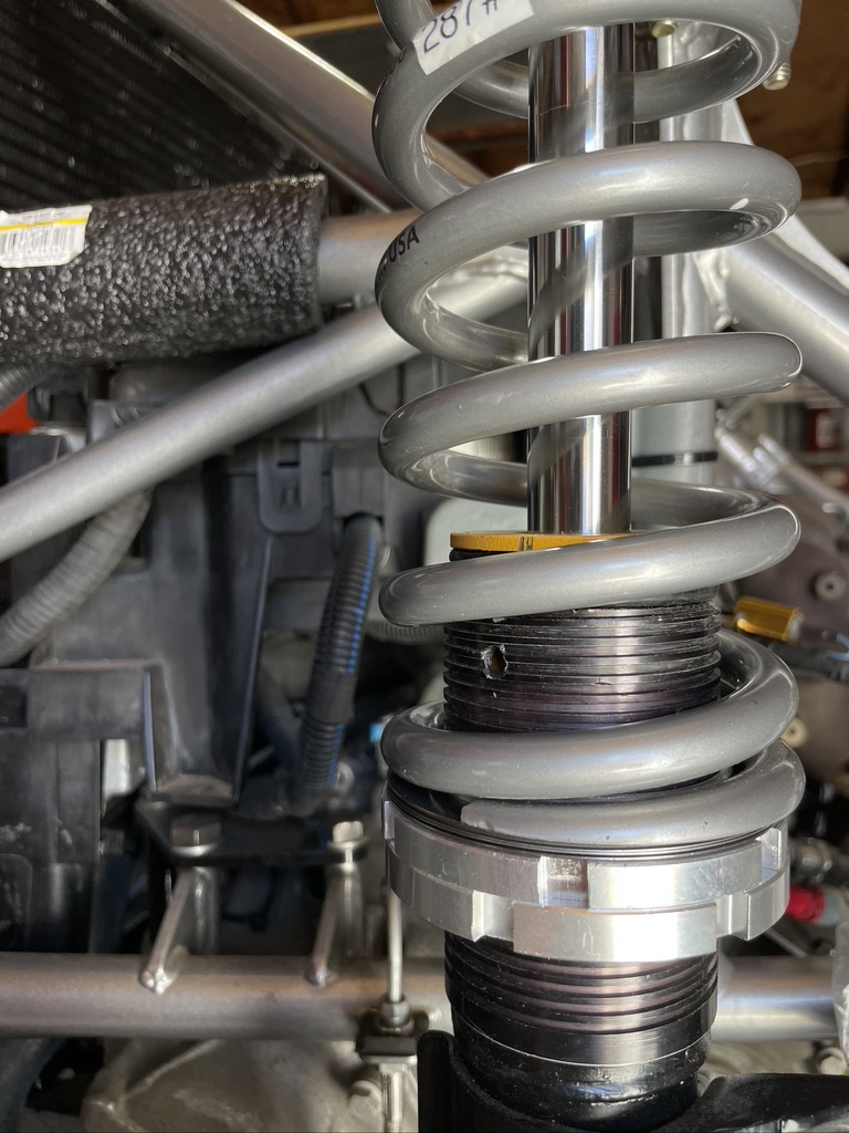

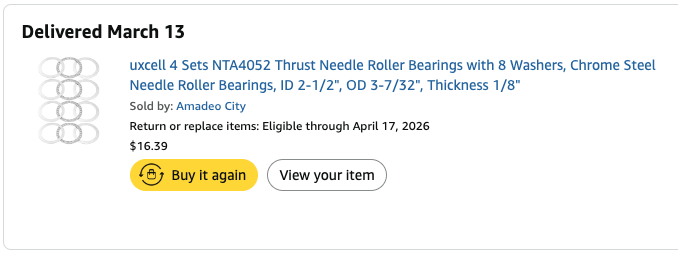

Torrington bearings: This is semi-related, and I don't want to turn this into a torrington bearing discussion thread, but if you are interested in torrington bearings while you are installing this kit, as a "while I'm in there" upgrade, I found a really inexpensive source. I came across these 2 1/2" ID torrington bearings for less than half of the price of what I'm used to paying for them through motorsports parts distributors Update: it looks like we bought out the rest of the inventory. There's a couple postings from other vendors with low quantities, but the brand/PN I ordered is Uxcell NTA4052 2 1/2" ID bearings. I ordered them for fun, assuming they'd go straight in the trash at this price, but they seem identical to what I'm used to seeing so I'm assuming they're just white labelled. I have no affiliation and I still haven't installed or tested them, but the nice thing about torrington bearings is they're incredibly low risk if they seize... the worst that can happen is you are back to where you started before you installed them.
-What are they? They're a type of thrust bearing that you can place at the end of your spring. Springs exhibit a slightly twisting motion as they're compressed axially, and these allow the spring to twist without binding. The result should be a more linear and consistent spring.
-What are the downsides? More maintenance... most people don't, but you should keep these bearings clean and lubricated. I recommend spraying some IPA on them, blowing them out with shop air, and then spraying them with dry film lube. I also recommend coilover covers, even if you aren't running these. I only need to clean/lubricate torrington bearings every 2-3 years with coilover covers.
-Do I need them? No, not really, but for $5/corner, I'm going to run them. They have no relation to the performance of this spherical kit group buy, but I figured I'd post in here for the 18 people who might want to consider dropping in torrington bearings while they have their rear springs out.
