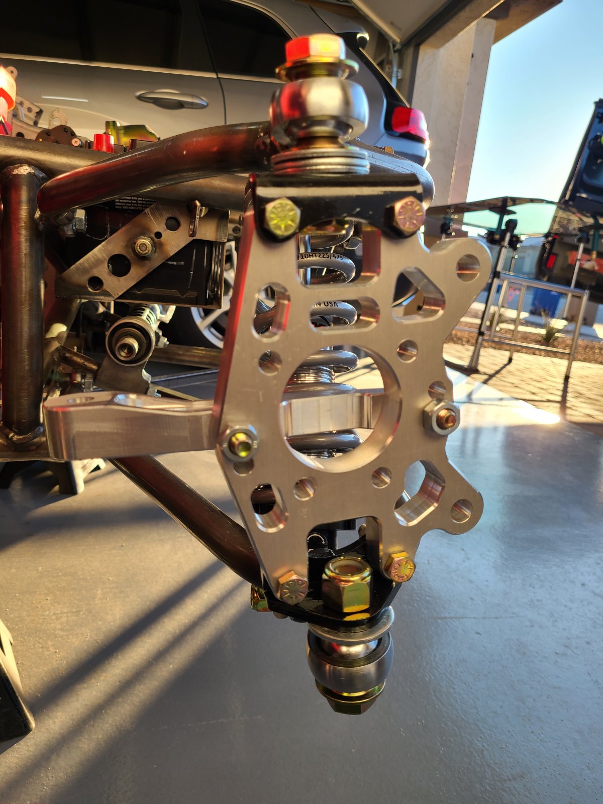

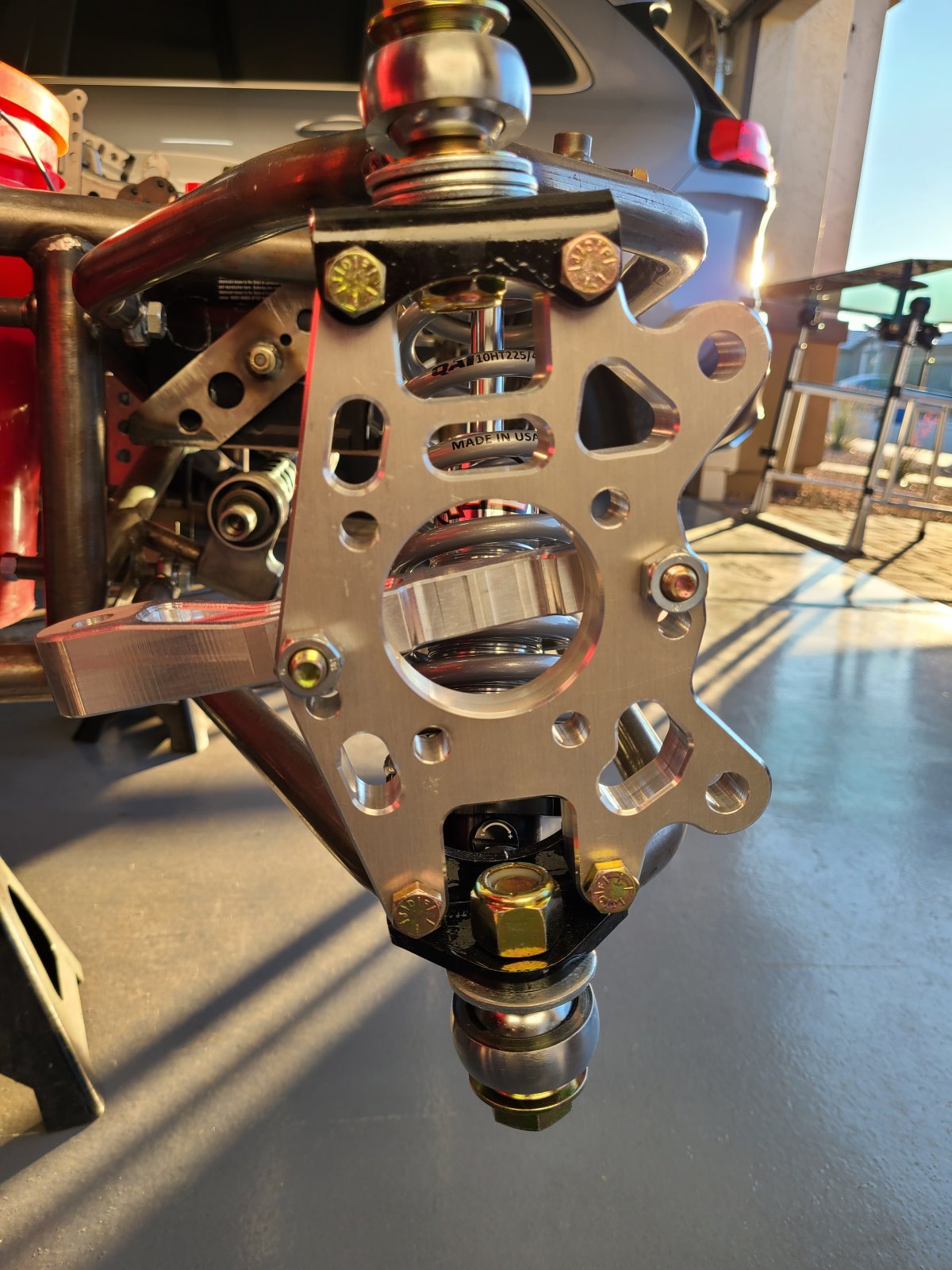

But, after playing with some measurements on the upright, mounting upside down pushes the steering arm 1 inch lower than being mounted the 'right' way. Also looks like there may be more adjustability to height of the steering arm? Another change is the bearing hub mounting location is lowered about 1/4 inch which would raise the ride height. Hmmm...

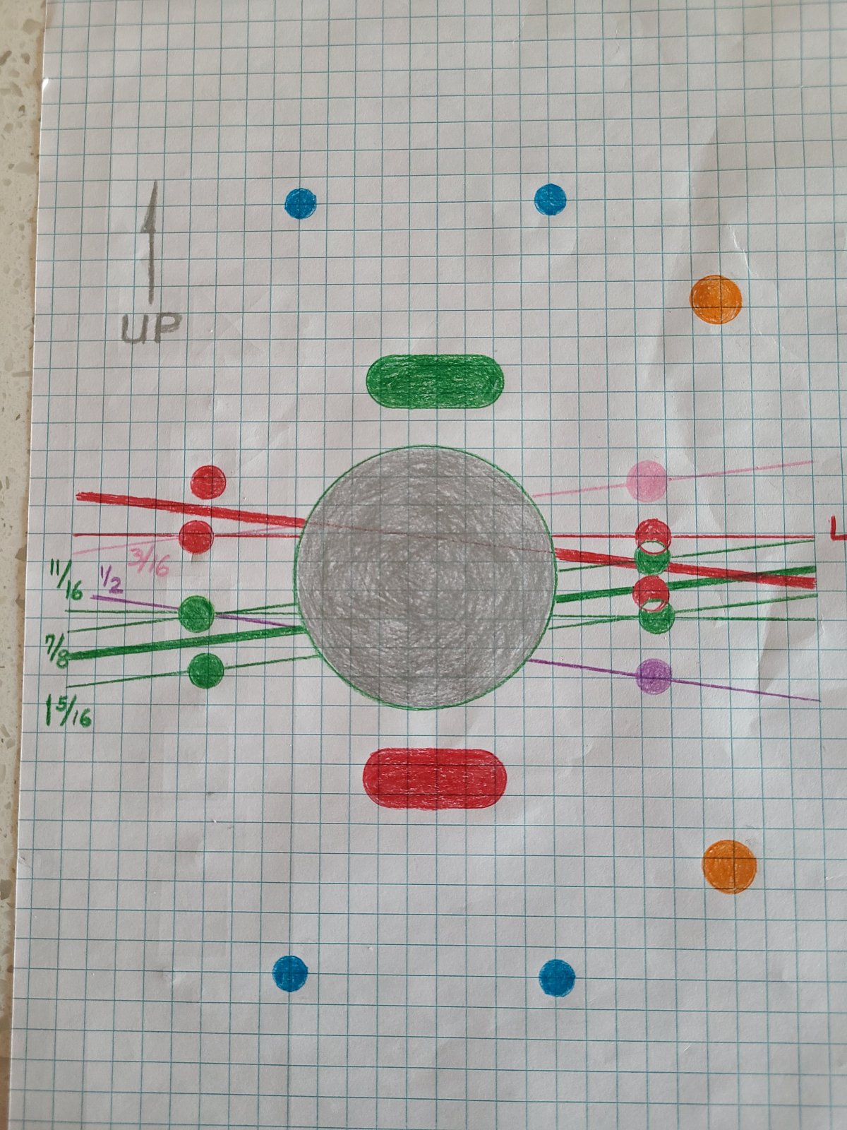

Took some precise measurements of the upright - right side up versus upside down. The steering bracket holes, top and bottom, remained the same for both orientations. I was wrong on the location of the bearing hub hole, it doesn't change position if the upright is flipped. The red dots are the steering arm holes in the right side up orientation, the green are for the upside down. The wide lines, red or green, are the bisecting lines between the sets of holes for steering arm. The thin red line (L) is the lowest possible position for the steering arm right side up. The 3 green lines are the possible positions upside down. The measurements on the left indicate how much lower the steering arm can be mounted versus the lowest red line. Any thoughts?
I think the green will likely be to much (to low). I have castor set to about 9 degrees which I think is about all you would want so any lower on the steering arm will be to much. But I don't know that you are going to be able to determine what you need to do until it's assembled and you actually cycle the suspension and determine exactly where the steering arm needs to be. I would assemble with the upright/knuckle in the normal position, steering arm on the thin red and correct when doing wheel alignment as necessary.

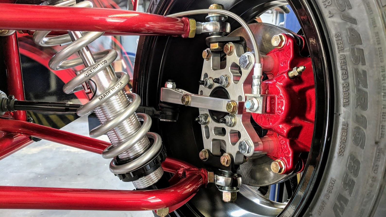

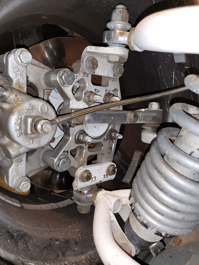

You guys got me wondering if I installed mine correctly. Here is a pic of my right wheel then Adam's left wheel.
37371
37370
When Dale & I checked bump steer, I needed to go a little lower than I currently am... but if I flipped the upright, I'm pretty sure it would be too low.

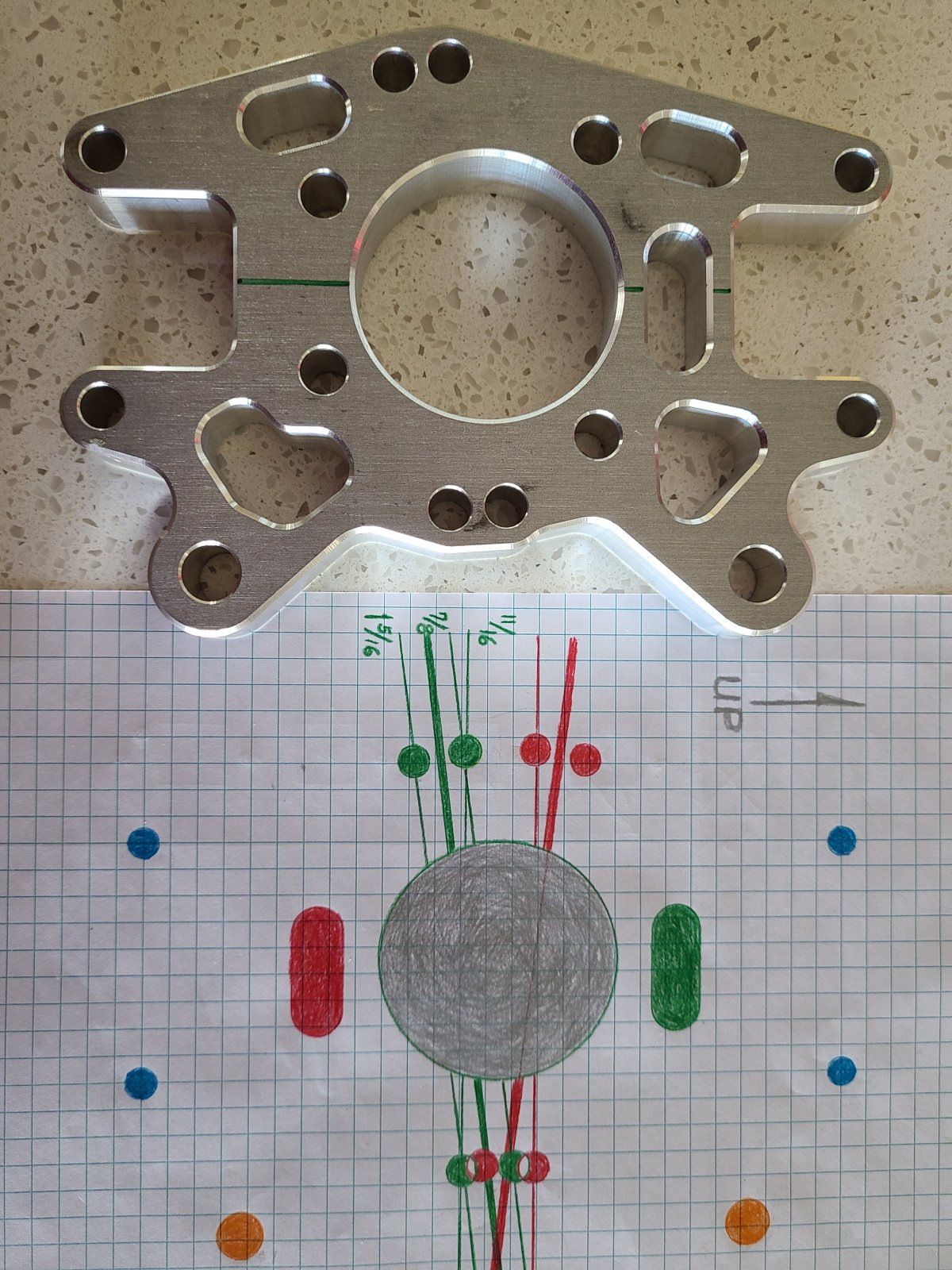

Ok, idea time. If a 3rd steering arm mount hole is drilled on the caliper mount side of the upright nearest the largest lightening hole, at the same 1/2 inch center-to-center spacing and in the correct arc spacing to the opposite side, the following positions are possible for the right side up - pink dot and line - or the purple dot and line. The pink line is 3/16 inch lower than the original red line (lowest right side up upright orientation) or 1/2 inch lower (uppermost upside down orientation). This would give more options to achieve help minimize bumpsteer.

I’m not sure that the position of the “L” bracket really matters if you got the alignment where to want it without screwing the heim joints out to much.
Ok, idea time. If a 3rd steering arm mount hole is drilled on the caliper mount side of the upright nearest the largest lightening hole, at the same 1/2 inch center-to-center spacing and in the correct arc spacing to the opposite side, the following positions are possible for the right side up - pink dot and line - or the purple dot and line. The pink line is 3/8 inch lower than the original red line (lowest right side up upright orientation) or 1/2 inch lower (uppermost upside down orientation). This would give more options to achieve help minimize bumpsteer.
That looks like it will be close to where I ended up.
