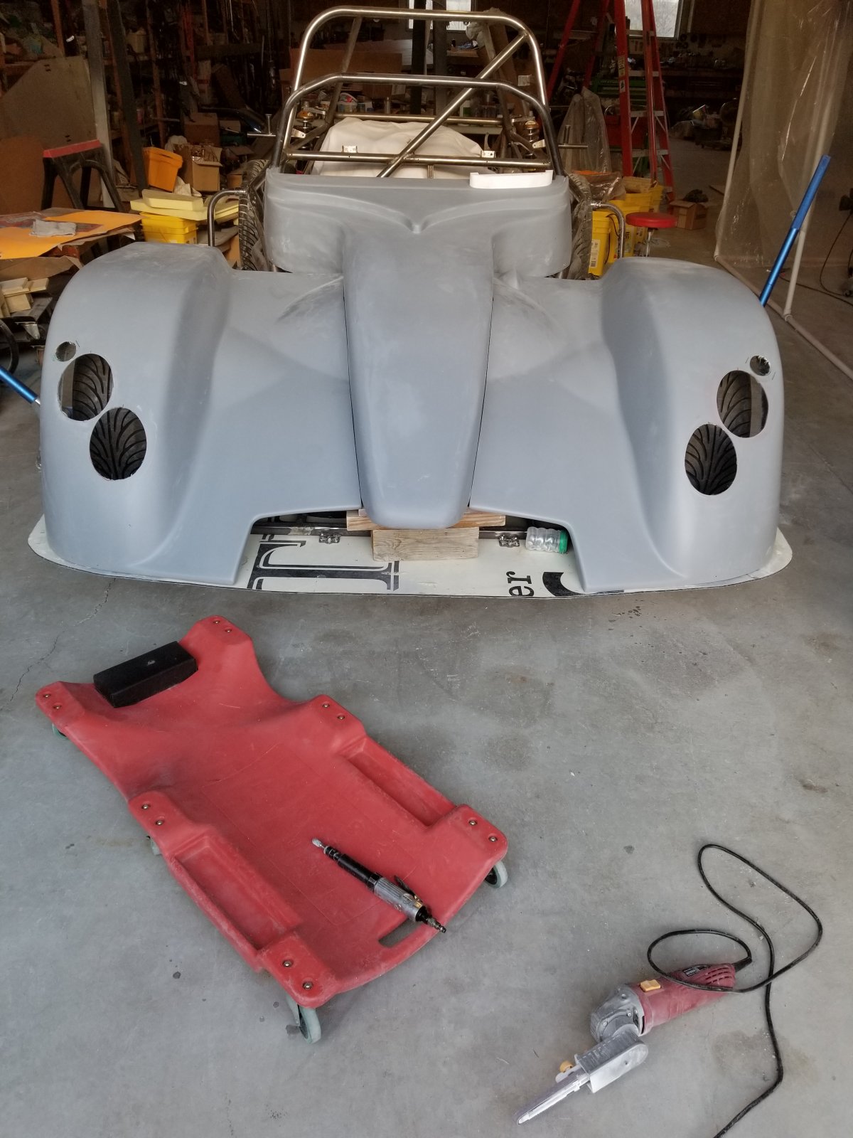

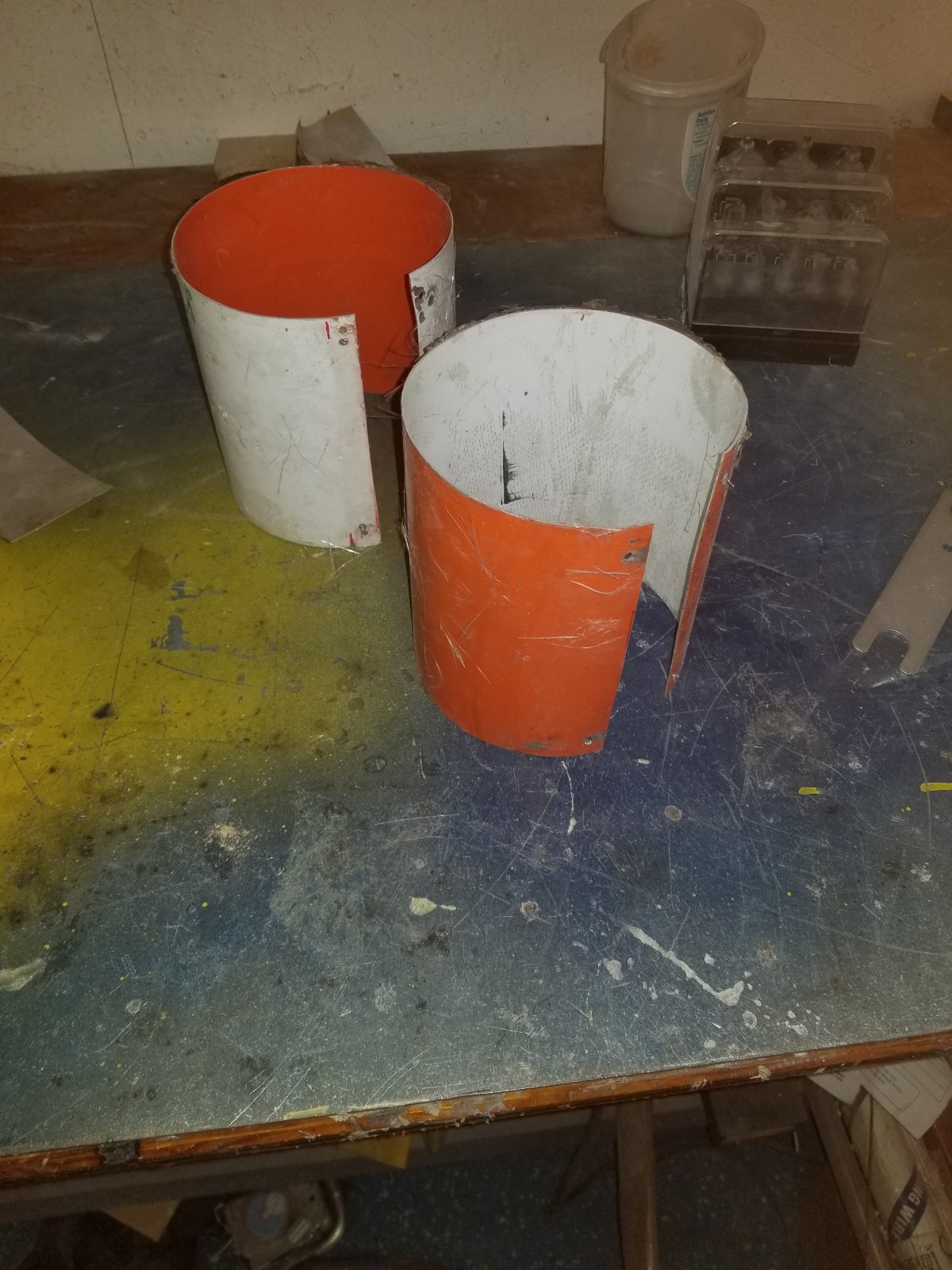

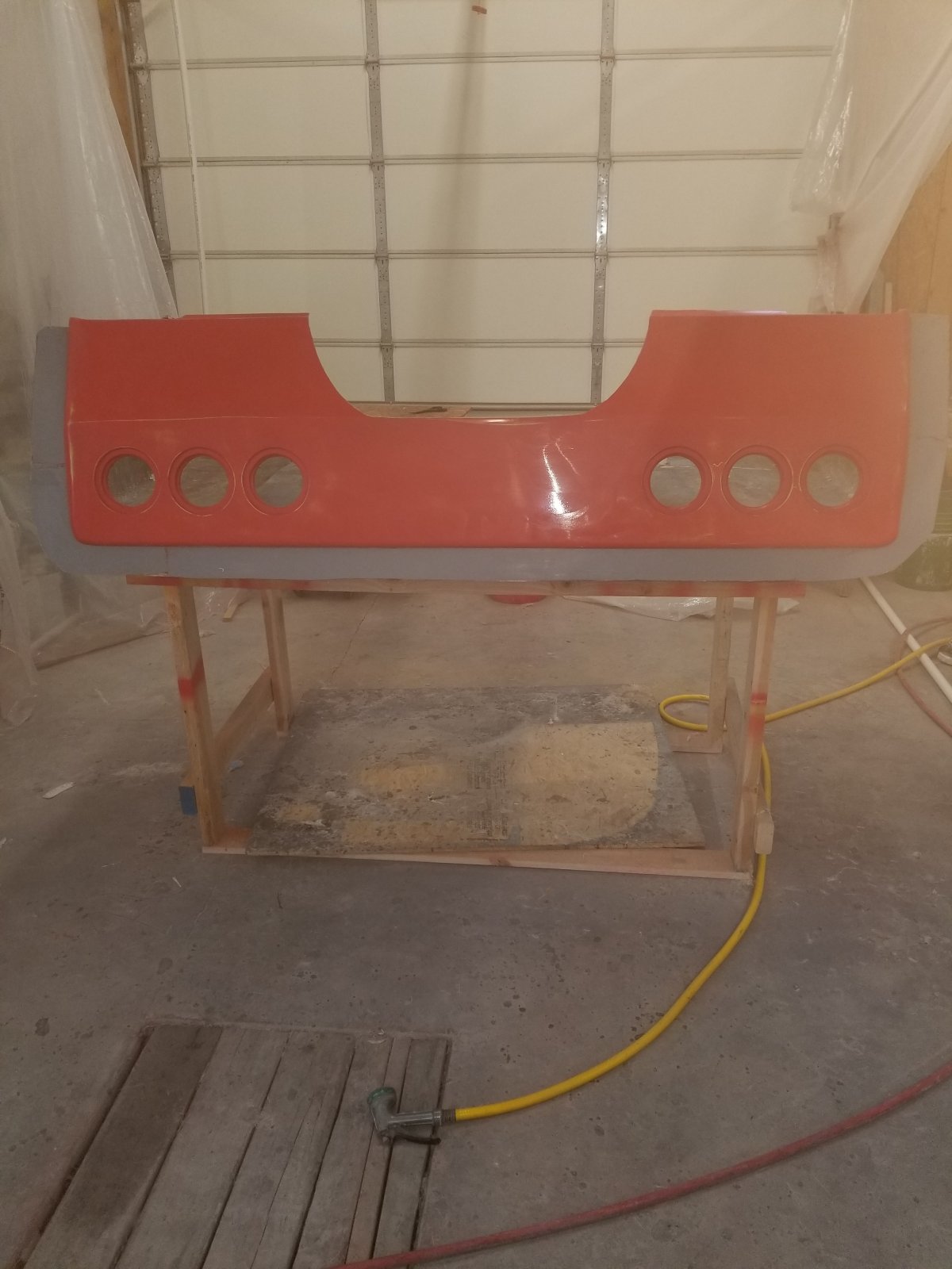

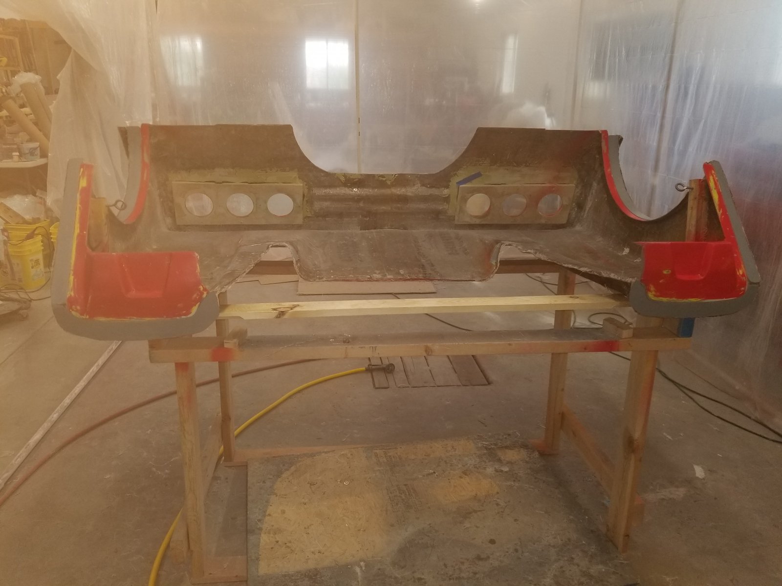

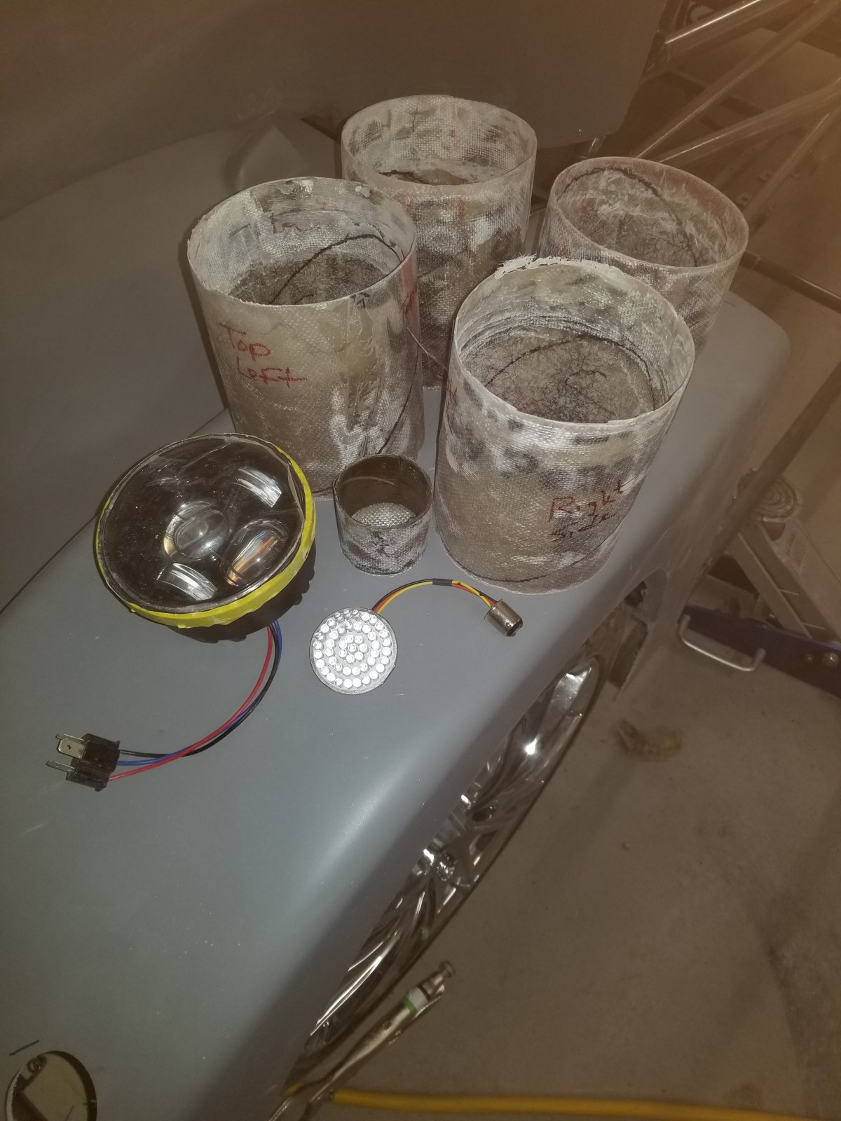

First pic is the front with the cutout for the lights. Second pic is the light buckets and the front headlights and turn signal lights I will use. It took me a while to find something that was DOT legal and not too big to over-power the front fenders. I wanted to do something different, but I couldn't make it happen. Third pic is the what I used to make the headlight buckets, just rolled some aluminum, riveted it to complete the circle, then glassed the inside. Once hardened, I drilled out the rivets and pulled the aluminum piece apart and wallah, my buckets. I need to grind on them a little bit to make the headlight unit fit inside the bucket . I didn't make the circumference of the aluminum piece big enough. Once that's done I will cut them to fit the front fenders and glass them in.

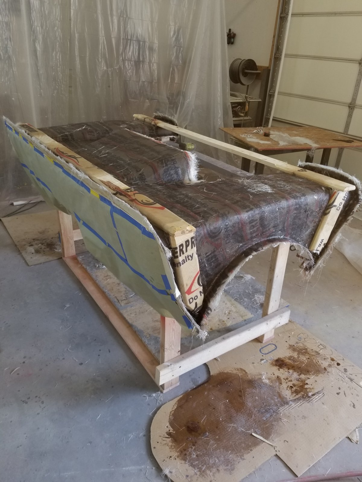

Forth piece is the main part of the tail section mold that is completed. The fifth pic is the tail upside down. The sixth pic is the tail section ready to get gel coated and then I start glassing and the other two parting line sections which are the wheel wells and the front part that will attached to the side panels. I wanted to do something different in the tail section like Lamborghini style lighting , but I ended up being symmetrical, and boring, matching the round front lights. I guess I can always change it later.

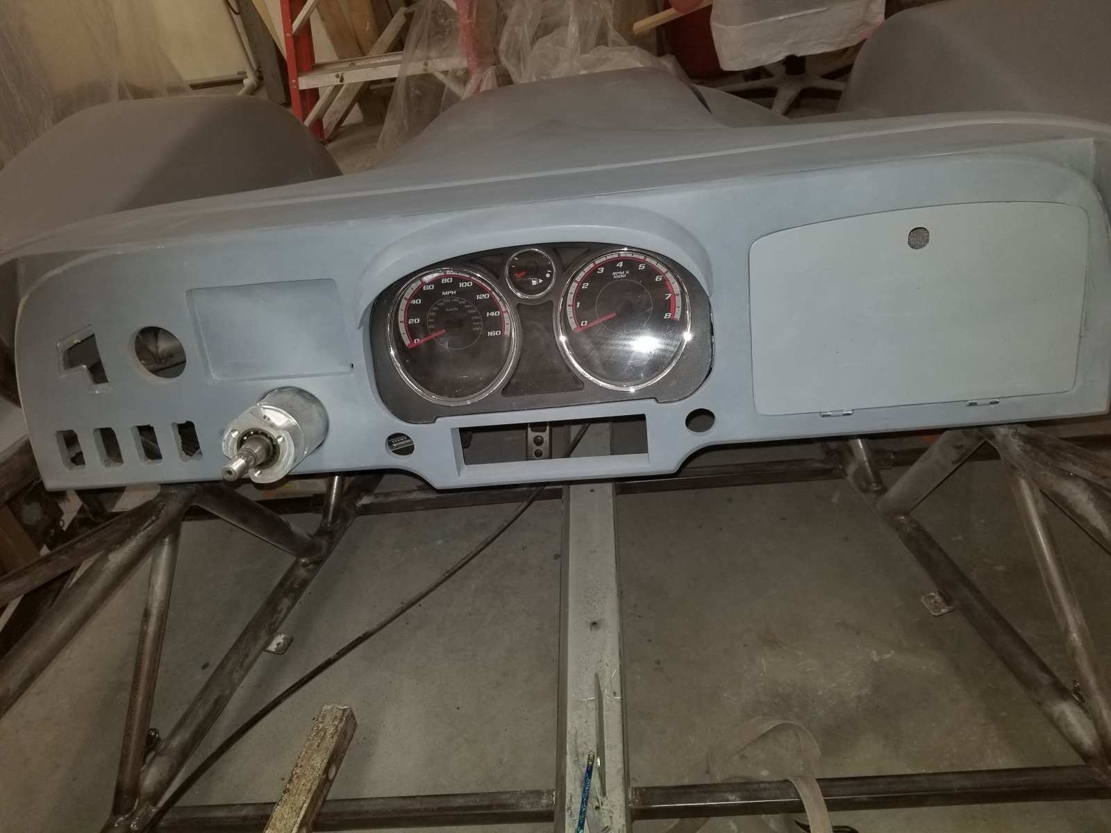

The last pic is the dash which I made a glove box for it as seen on the right side. I need to do some more work on switches yet.

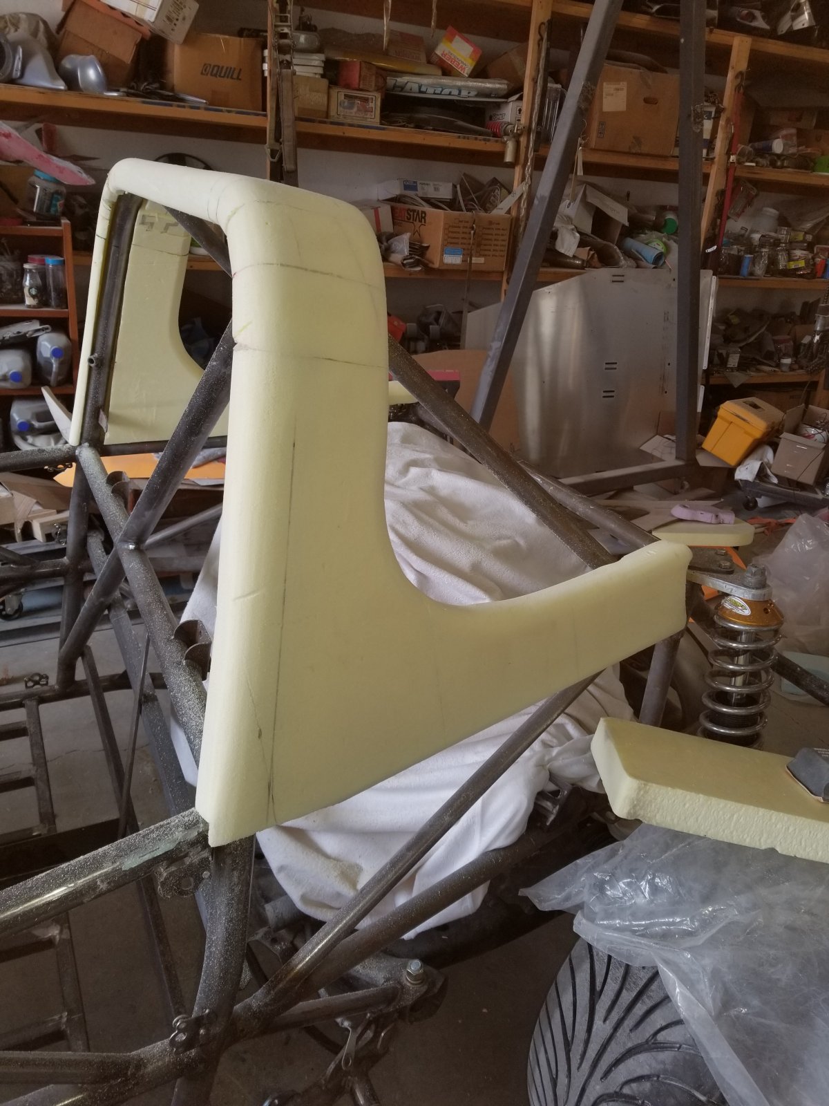

I had a break between fiber glassing coats on the tail section so I made this rear cover for the roll hoop. It's still in rough form, need to cover it with fiber glass cloth then a bunch of body work, then paint, then make a mold. Not sure if I should try to cover the tubing on the underside or not. What do you guys think?
I am having a hard time picturing the difference in my head.
Put it together without the extra underside fiberglass, and decide later if you like it or not.
AleX1/9
I think part of the awesomeness of this body (and lots of racecars) is the skateboard look - totally flat and low
Don't screw it up with more roll bar
Plus, you don't have to do all that extra work!
