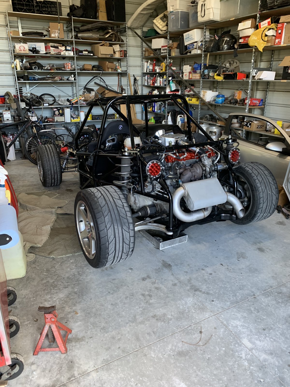

The pros are that the intercooler setup is all on and hopefully all the leaks have been fixed. The firewall is also finally in since I won’t have to reach back there too much hopefully

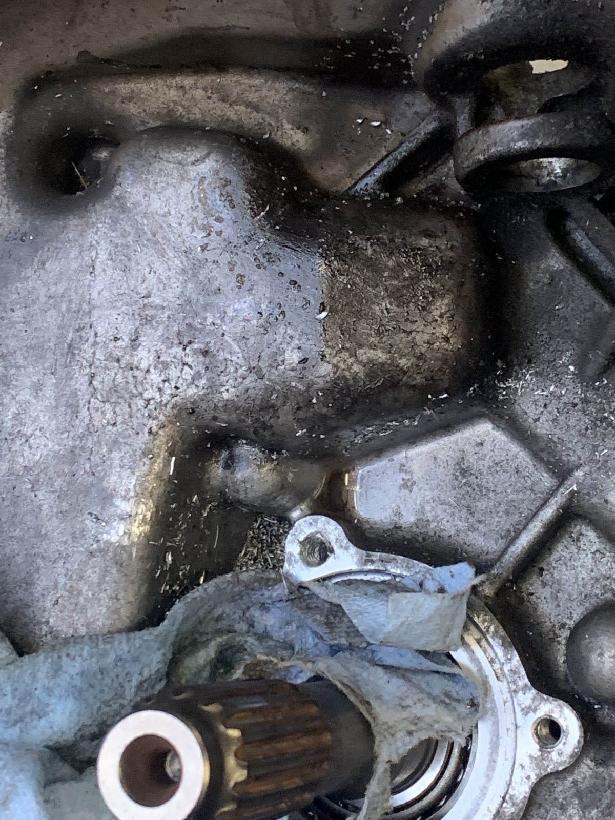

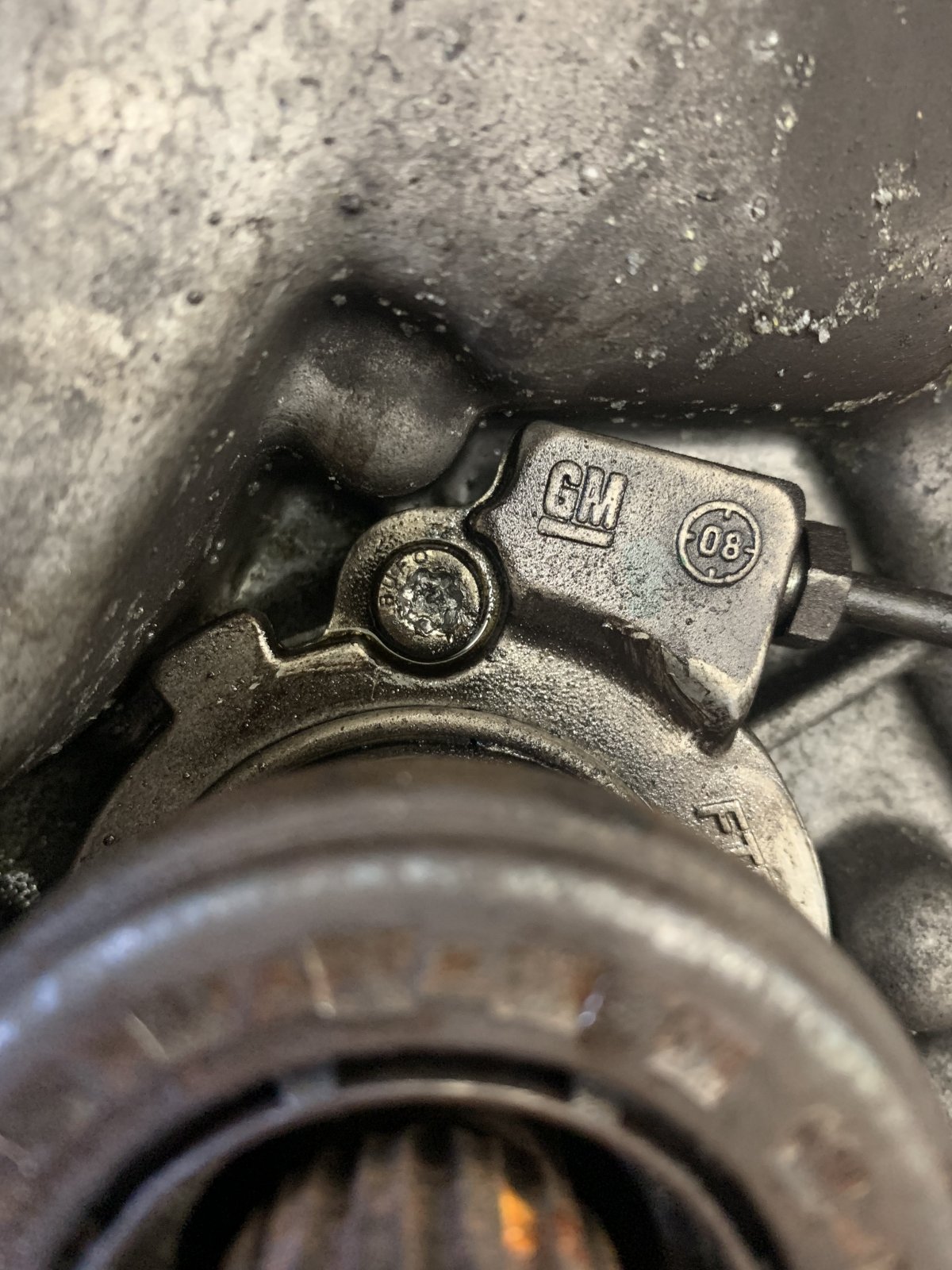

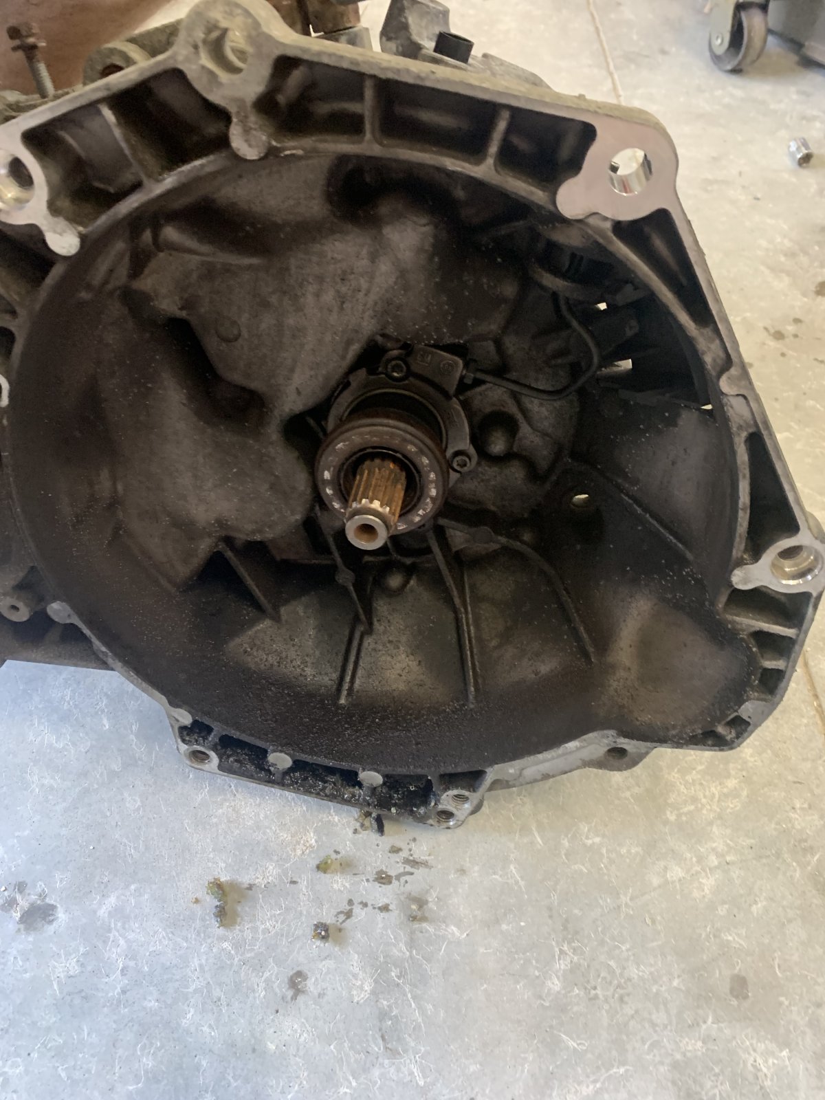

Got everything out. That starter bolt is definitely not easy. Now I have one torx bolt holding the bearing in and I stripped the head even putting my weight on top of it so I’ll have to improvise now. I can’t tell where it’s leaking yet because the housing was full of fluid and it fell all over the floor. Any ideas for the torx bolt?

I think I used a chisel and maybe needle nose vice grips on the torx bolt when mine stripped. I replaced with a socket head hex bolt.
I have an extractor kit I’ll probably use later. I don’t think I’ll be able to get vice grips on the head because the bearing sticks out just enough. Definitely not putting torx bolts back in
Lonny taught me a trick to get that torx bolt out. Hit it with a punch & hammer, hard enough to crush the aluminum washer that is behind it. That will take the pressure off of the bolt, and make extracting it easier. I also use my welder, and weld a nut on top of the stripped bolt. I replaced that bolt with a normal allan head bolt, as that stock one was a half height bolt head on it.

So this transmission has become a good hurdle since the bolt head broke after using an extractor, and after drilling the shank still won’t come out. So much for 89 inch pounds and some Loctite.
