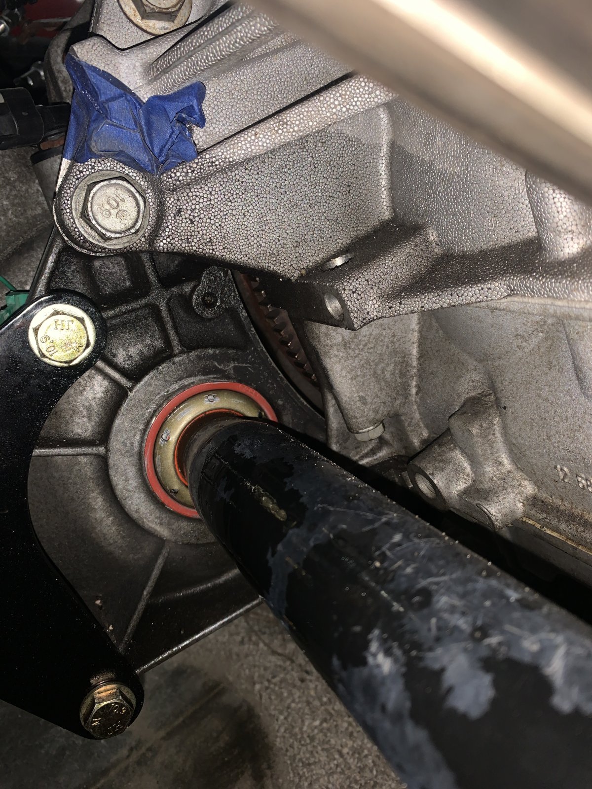

So I have another small leak coming from the bell housing area. It’s not the clutch this time cause it drives great and it doesn’t smell like brake fluid. I think it may have been residual trans fluid that I spilled along with me not tightening the case with a wrench rather than the small impact. I went around the bell housing and it leaked a little again, but less.
I’m hoping it’s just a little excess from filling and/or needing that extra snug on all the bolts.

Yeah I’m confused to. I had leaking axle seals before and just replaced those. It looked like the leak wanted to slow down so I guess I’ll keep an eye on it. I’m hoping it’s just residual from when I had it out and me spilling the trans fluid from a series of unfortunate events

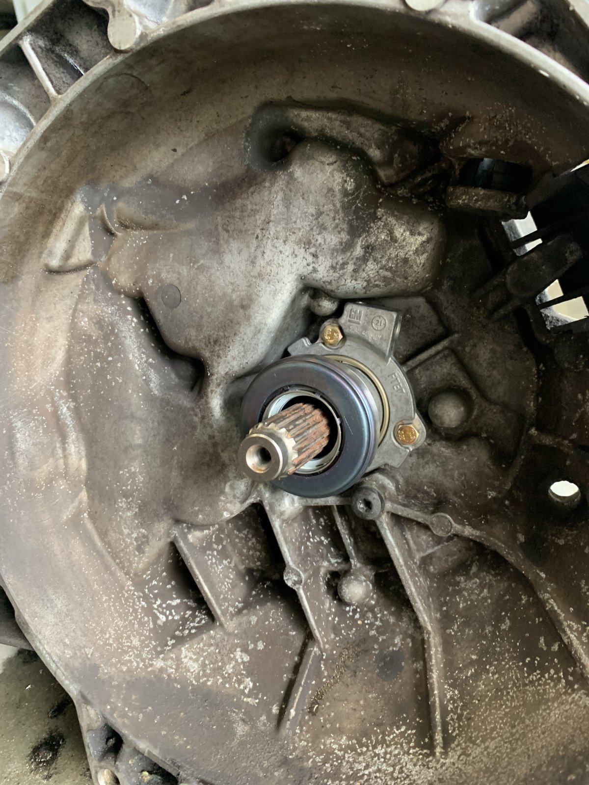

I pulled the top plug and nothing came out so now I’m worried it’s low and there’s something else wrong or it already drained all down. It looks like it’s coming from the bell housing but I have no idea where it would be coming from. It seems to splash off the center shaft-flywheel area but I don’t know where it originates.
Stretch2126
See the hole closer to the flywheel? It would make sense if it dropped out of it onto the shaft and flung it everywhere. It only does it when it’s really driven. Not crawling.
