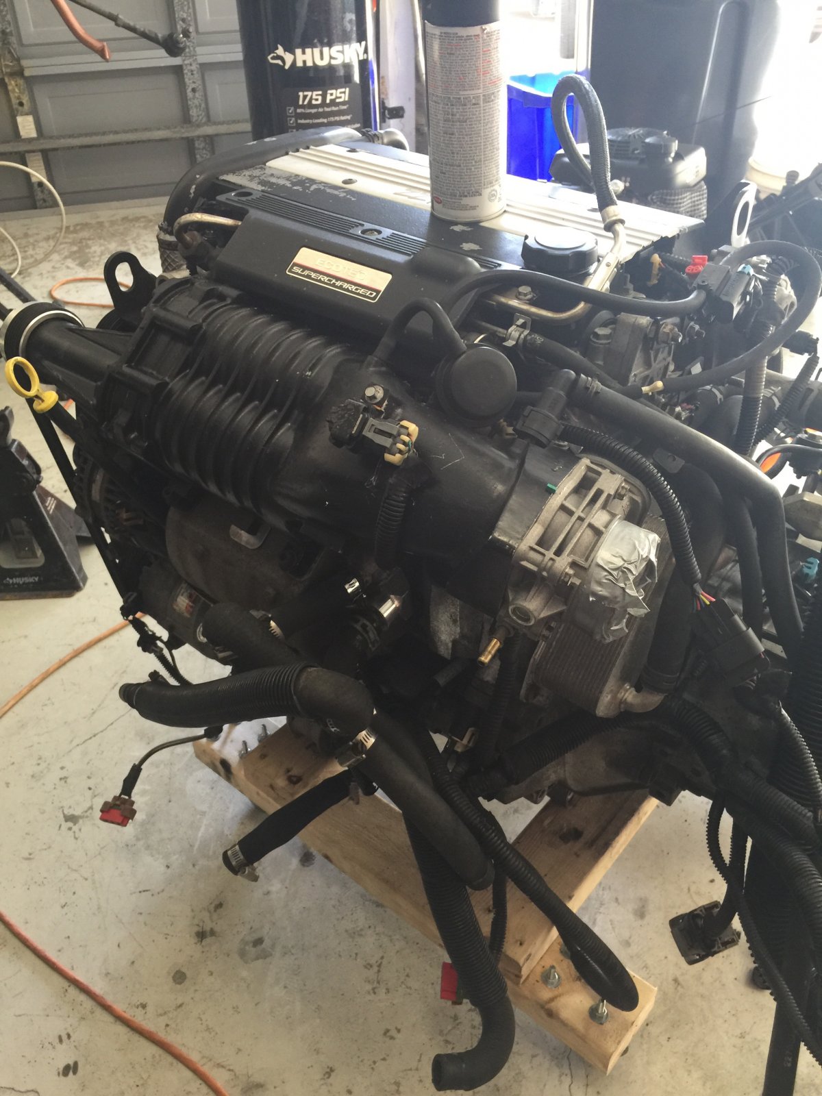

Hey does anyone know what I need to do to my 2006 supercharge motor before I install it in the kit body. I watch the build video but it’s not a supercharged model. Besides the AC. What else should I eliminate from the harness or the motor?

I don't remember eliminating much from my 2006 SC donor. Just these 2 little things:
- The vacuum hoses on the top, and a solenoid.
- removed the extra fan wire & connector that use to go to the radiator.
I bought the DF solid mounts for the engine, as the transmission mounts were solid, it didn't make sense to have rubber engine mounts.
baustin
Also an 06 SS SC here. Things I removed: evap canister (wires plugs are still there), aluminum tape over the AC condenser ports, 1 plug is unused from the AC condenser area but I just left it and covered it. I covered the other radiator fan plugs, didn't remove.

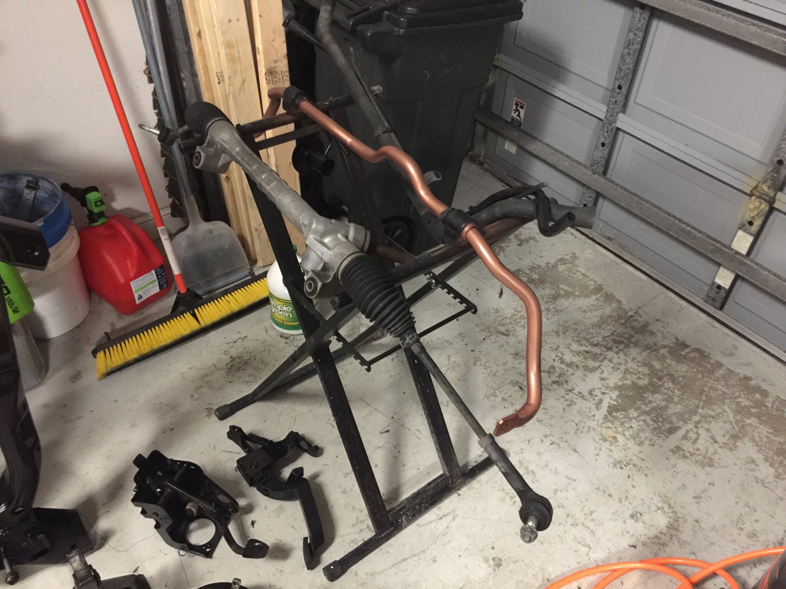

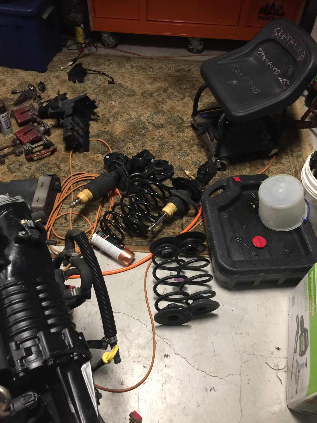

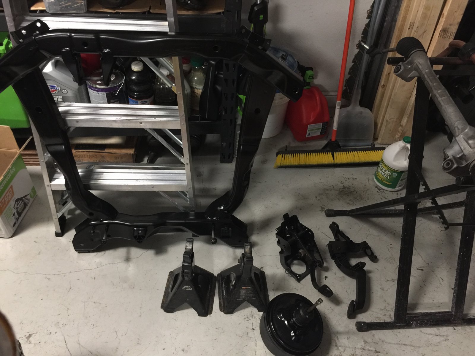

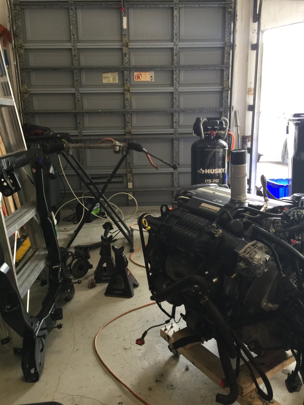

Just waiting for the kit now.
