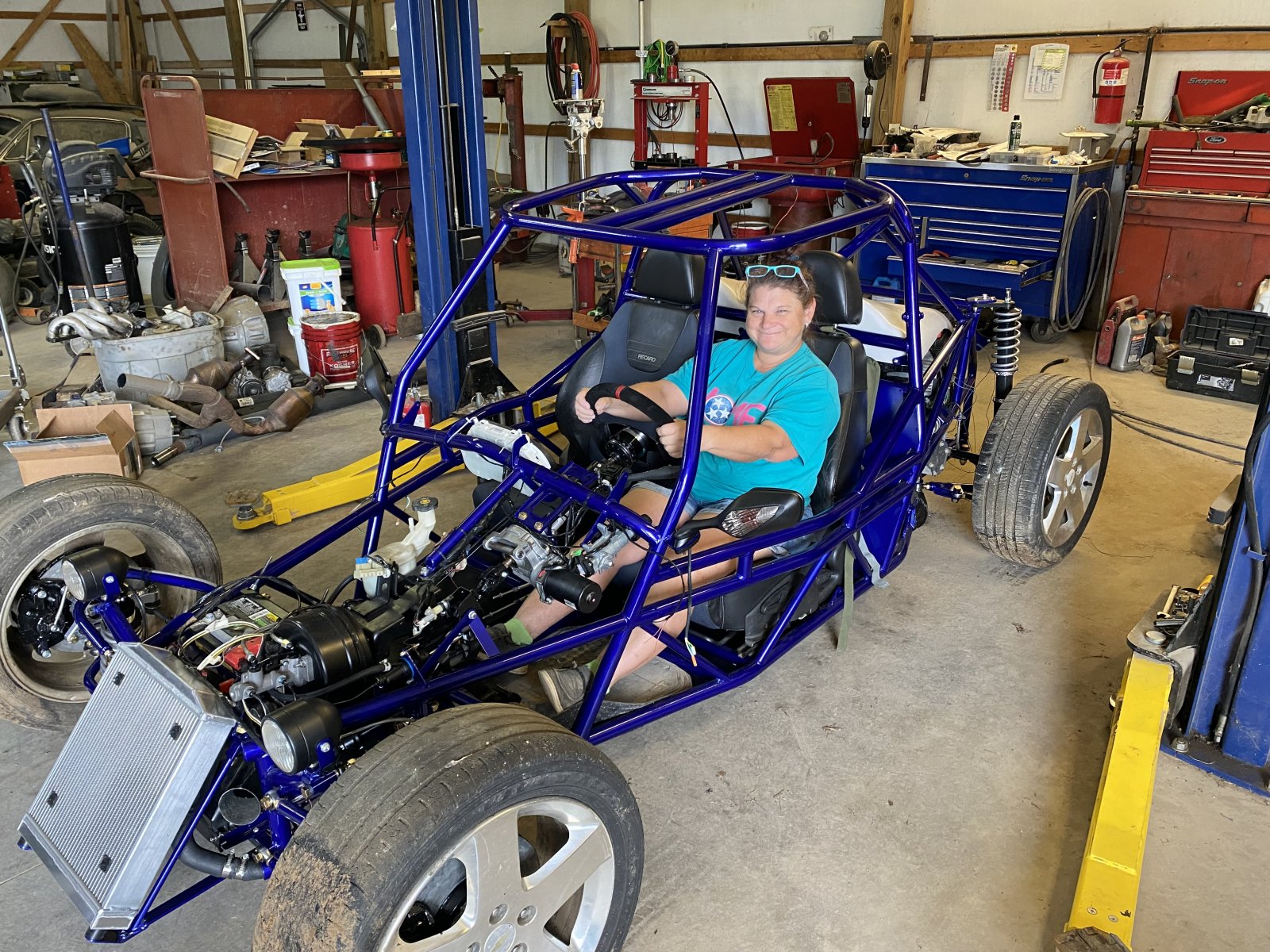

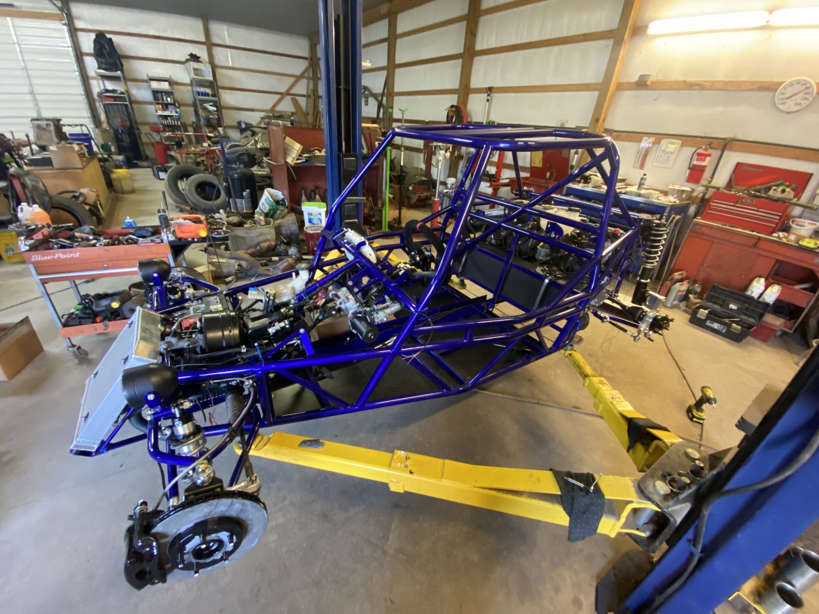

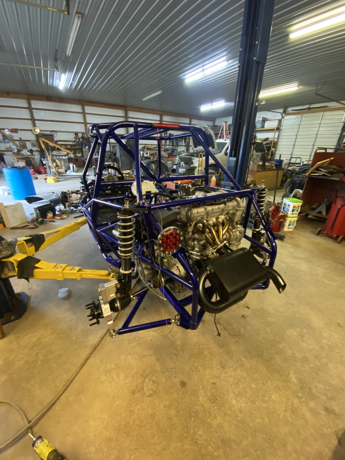

Well I’m not sure if you could consider it a first start since I ran the engine with the harness on the table but it’s a first start in the chassis. I probably could’ve started it a couple days ago but I wanted to get more of it finished before the wife gets home. I pretty much finished up the tubular subframe and tidied up the wiring. I still need to add coolant but it does start and run and now I guess I’ll get onto lighting since I’m missing a few pieces of hardware for the shifter and am waiting on solstice calipers

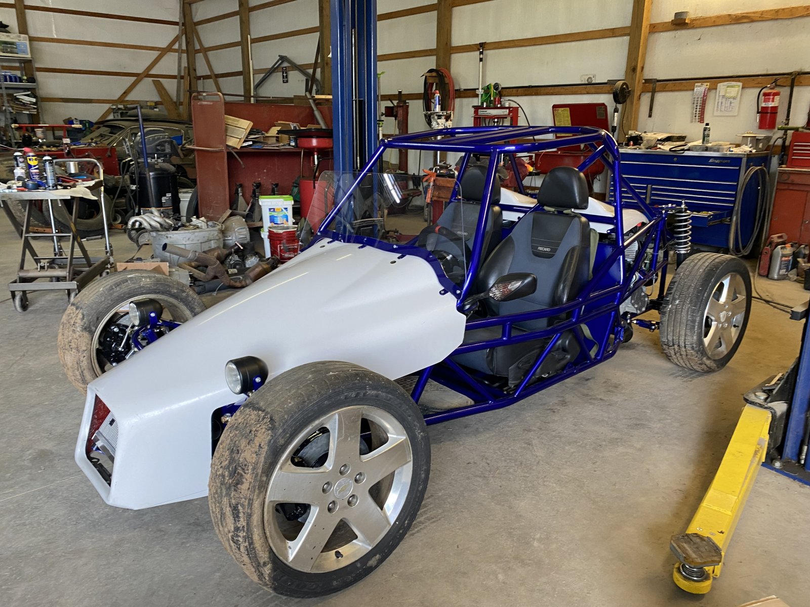

I mocked up for pictures for the courthouse. What a bunch of clowns they are. Anyway though the wife is super happy. Veronica got to start it when she got home on Monday and you could not have smacked the smile off her face. Anyway though these will be the temporary wheels for now and I have the tires so they’ll be put in soon and I’ll work on the alignment.

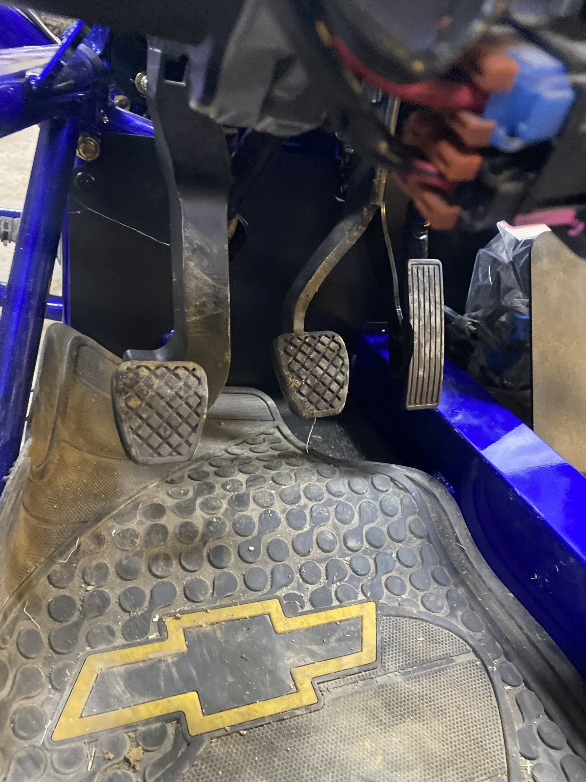

Cutting it close but will go for a drive tomorrow since the rain is finally moving out. I moved the accelerator pedal up an inch and is much easier to reach, my wife said it was ok as was but I’m certain she’ll be much happier. Not a lot left other than cosmetics and a button panel.

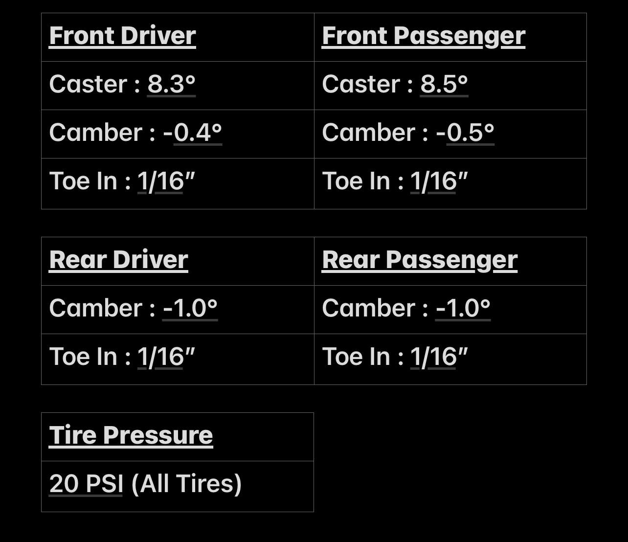

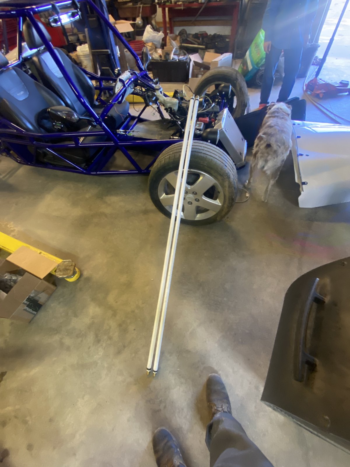

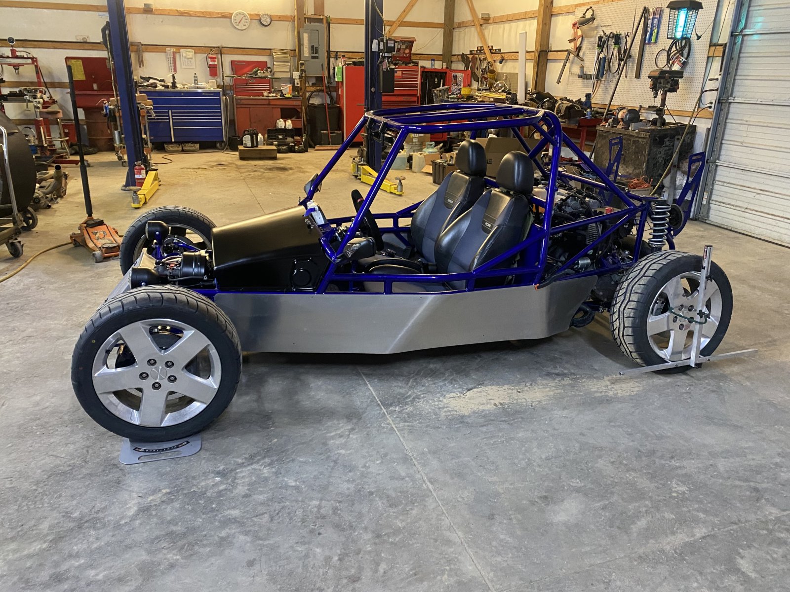

Getting started on the alignment. What would y’all suggest for a good starting point on alignment specs? I’ve read through many posts and they’re all over the place. This will be probably just street driven so I was going to start with 0 camber and 0 toe on the rear and probably-.1 camber 7 degree caster on the front with a little tow in. What do y’all suggest?

This is what I ended up with;
49320
The only thing different than the DF recommendations was less camber based off others posts for mostly street driving.
I have not been able to really drive it but for others to have luck with it made me shoot for these numbers.

Awesome. Thanks, I shouldn’t have a problem getting these numbers
