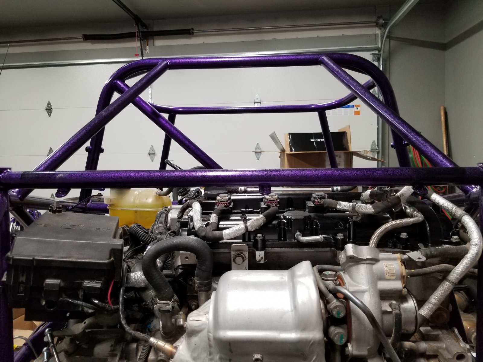

Got out and checked the level yesterday - as far as I can tell the engine and frame are at the same angle. I did notice, however, that the strut brace bar is slightly bowed - lower in the middle, curved up at the outsides... is that normal?
Waterdriver
I'm not at home at the moment to verify, but I'm pretty sure that tube should be straight.
Did you lay a straight edge on that tube to verify what your seeing? With all the tubes around there, sometimes it can cause an optical illusion.
Not saying your not seeing it bowed, just hoping that it's not.

I had a digital angle finder, which I put at each end and at the middle, and the ends were about 1.5 degrees off from the center.

I went and looked at mine, it looks perfectly straight. I wouldn't think that it would throw off your subframe engine alignment though, even if it was just slightly curved

I had the same thought, I don't think it'll make too much of a difference. Unrelated, is that the stock turbo for your engine? The compressor outlet is different than mine. Also, it looks like you have a lot more clearance between the engine and the strut bar than I do.
I would say you need to use a straight edge. If the angle gauge was turned slightly it will read an angle.
I did that yesterday. I didn't get a picture, but it was about 1/8" difference between ends and center. Again, though, I don't think it matters too much.
