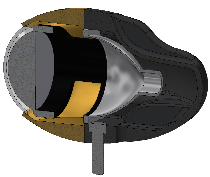

In an attempt to not clutter Nuker's thread, I'll move discussion here.
While the 3D printer will be good for Porto-typing, it won't work well for the final project. The ABS or PLA will not hold up well to the heat generated.
I did some more research, and got a little bit of data from a couple sources.
https://goo.gl/PFcFyB
https://goo.gl/oWtg2t (in Celsius I assume)
From this, I'm estimating a max temp that the surrounding components will see of around 200F. Glass transition temps (where deformation would likely begin) of common printing materials are 149F for PLA and 221F for ABS. I'll probably try with ABS and see if it works. If not, I'll likely get some PC-ABS, which has a GTT of 257F, and a Vicat softening temp of 234F (~205-210F for ABS). The measured bowl temp in the first link's data didn't exceed ~230F, and my parts won't be in contact, so I'm hoping I can make this work.

theeulogy
View attachment 2234 View attachment 2234
Do you have the CAD file for the headlight assembly? I would like to have one printed and start specing a projector for it.

Maker Select V2, plus some mods. Relay board for the heated plate, all-metal hotend, enclosure, etc. For the price ($255 with coupon), it's hard to beat, plus there is a huge community support base.
It's designed around a standard Mini H1 projector. I'm not quite finished with refining the design, but this is something I'd like to develop further and possibly sell in the future. I'm happy to share the model with you, but please keep that in mind if people ask you where you got them ;)
