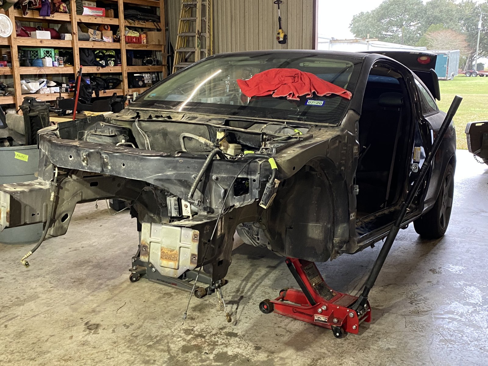

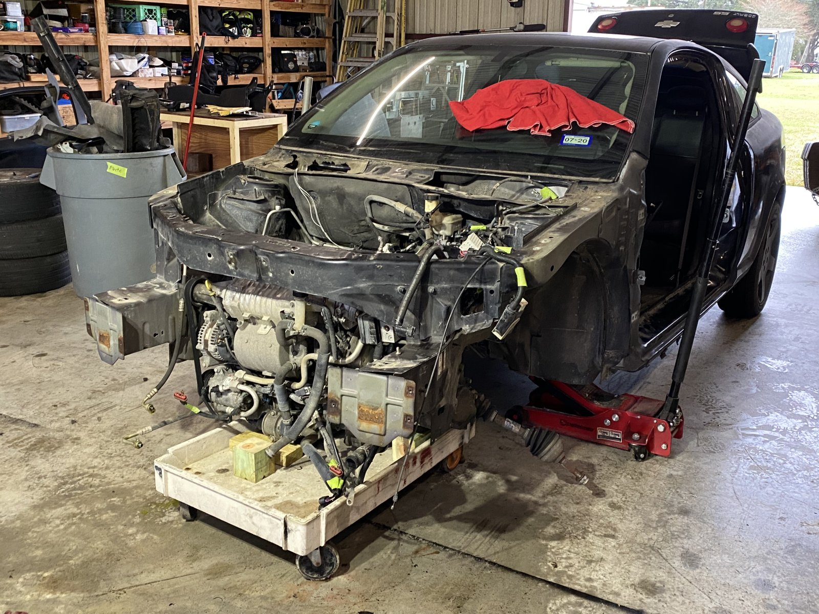

I lowered the Cobalt subframe, engine and transmission onto a couple of furniture dollies.
51007
Then with the radiator and bumper removed, was able to lift the remaining Cobalt shell up, and slide the subframe, engine, and transmission out.
