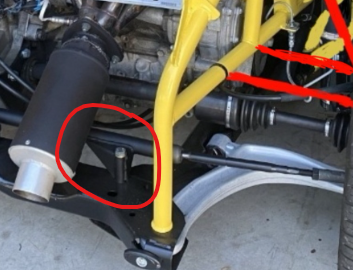

The sway bar hits my exhaust.
I didn’t put this together in my mock up. :-(
Anyone run into this or have a solution other than a new exhaust?

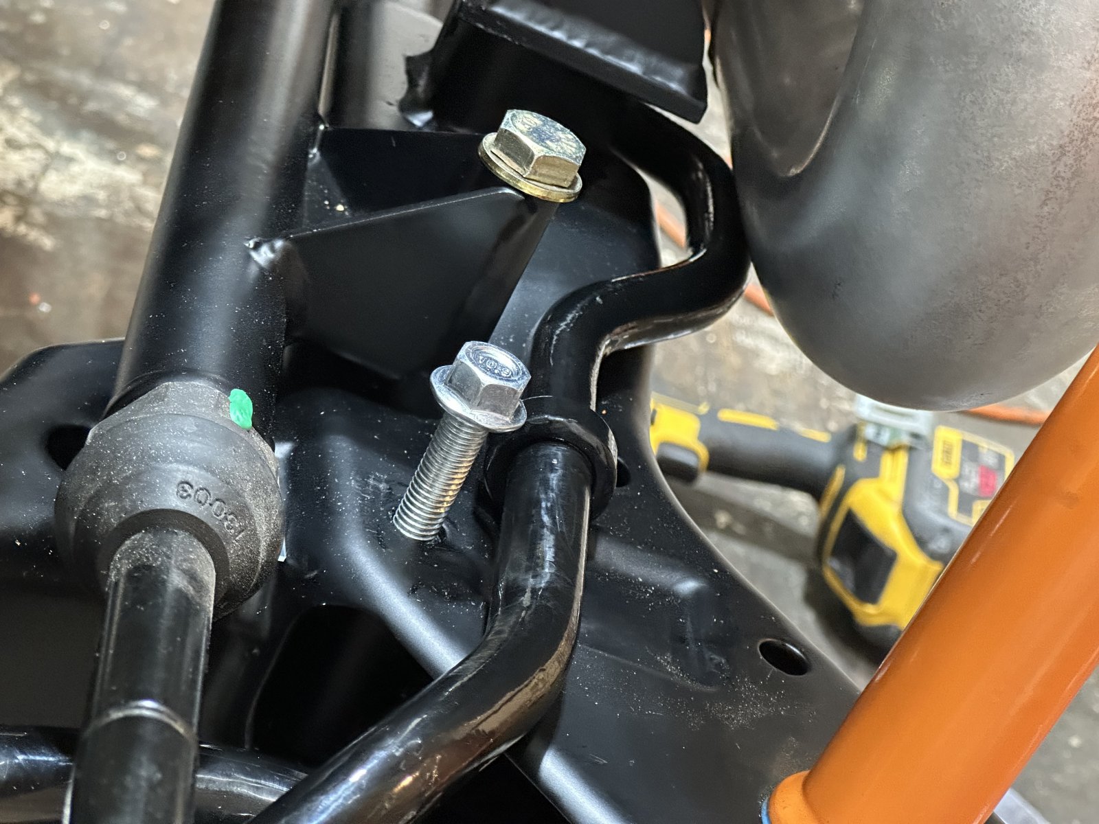

Technically the swaybar arms should be 'parallel' to the ground so the maximum leverage can be exerted on the bar, evenly, for both upward and downward movements. The adjustable links are meant to help achieve this setting, and could be used to 'preload' the swaybar in one direction (example, favoring a left turn over a right turn) to help prohibit body roll in one direction - but will be less effective in the opposite turn, like running a vehicle on an oval track that requires a 'stock' suspension. Rotating the arms upward will lower the kink, as stated, but limit the rotation to what just works to prevent contact for the best results.

Then make them short enough to rotate that kink down.

I’ll take a look and see if it clears if I can get it rotated down.
The adjustable links won’t be used to add any preload, instead they will be used to ensure there is no preload when the corner balance in complete
Is it possible the sway bar is on wrong as well?
I ran the sway bar on mine with DF supplied exhaust for a while and it cleared just fine. The part that sticks out that seems to be hitting on yours is supposed to sit down in the recess of the subframe I believe.
It will drop down into the recess as the suspension is compressed but it might need to shift sideways some also.
