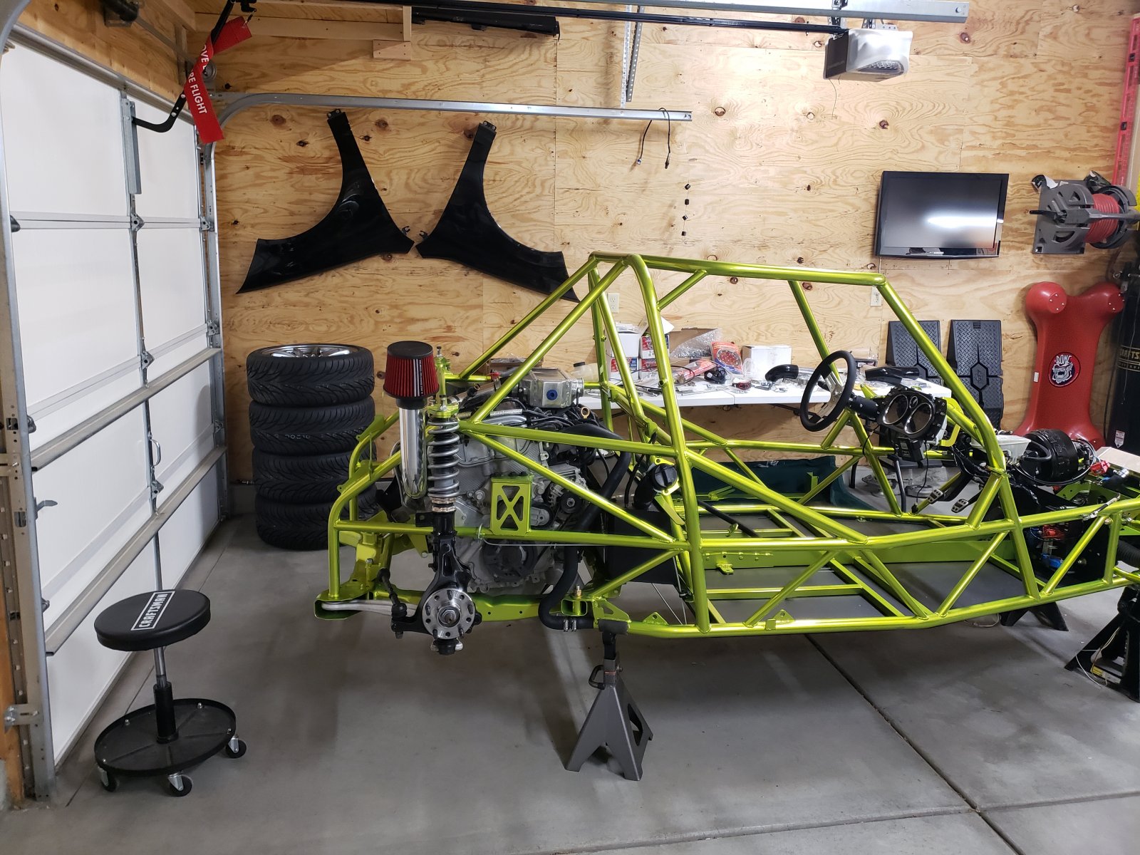

Anybody thought about doing this?
It's an acquired taste. You would have to get the sensor plate welded onto this piece, but it would put the air filter out in clean cool air. You could use one of the shock tower mounting bolts to secure it with a clamp. Would it have a negative effect on the sensor readings?

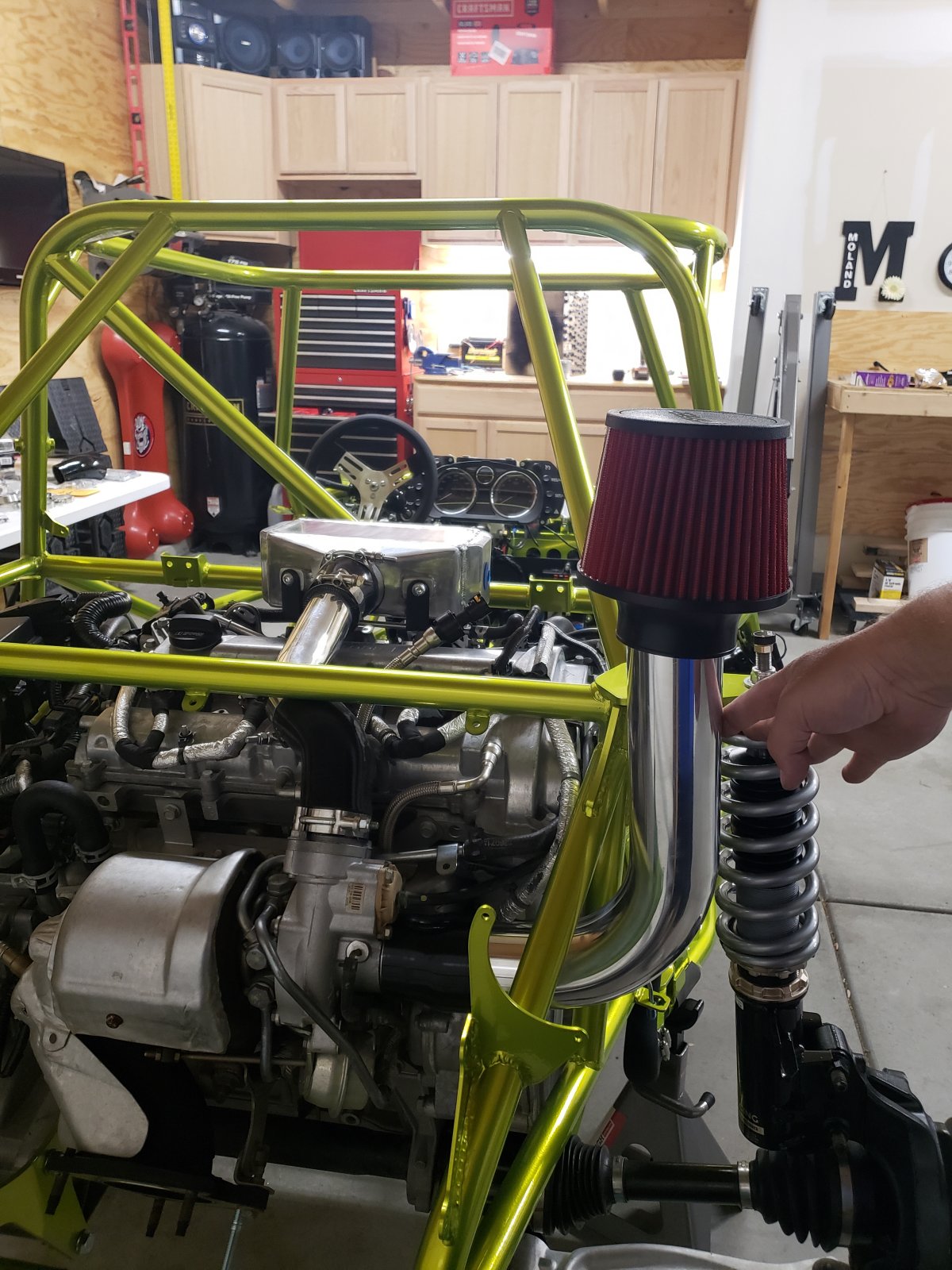

I've been contemplating where the intake should go on the TC and your positioning is close to what I am thinking. I will try running the piping on the inside of the frame rails - will be a tighter 90 degree into the turbo inlet - and still route the piping in the vertical to get the intake filter up into the cooler air as you have done. This routing is shorter piping and gets the intake away from the stock location where there is too much hot air circulating in front of the engine. I like it.
The other benefit of relocating it--and this is a big one for me--is reducing the sucking sound. It's very loud and annoying in the stock position. Even with ear plugs it still drives me crazy.

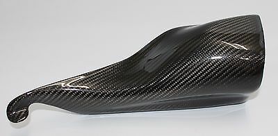

Intake stack! I like it. Any issue if you get caught in a rain storm?
This was my biggest concern. Although if you get caught in the rain with the other set up, it too would suck up water that went into the filter(especially sitting at a red light). The rear position would be a funnel and channel the water directly into the turbo. It would be more exposed to water when driving as opposed to when your stopped(due to the plastic top of the filter). I guess the question is, how much does the higher IAT's effect the performance? Is it even noticeable? Are we mostly concerned with heat soak?
