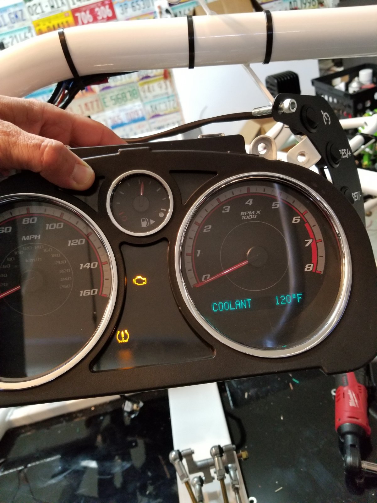

I've heard there's a thread out there with instructions on how and what to snip inside the cluster. I'd like to eliminate the abs, traction control and srs lights. Oh and the e brake light too

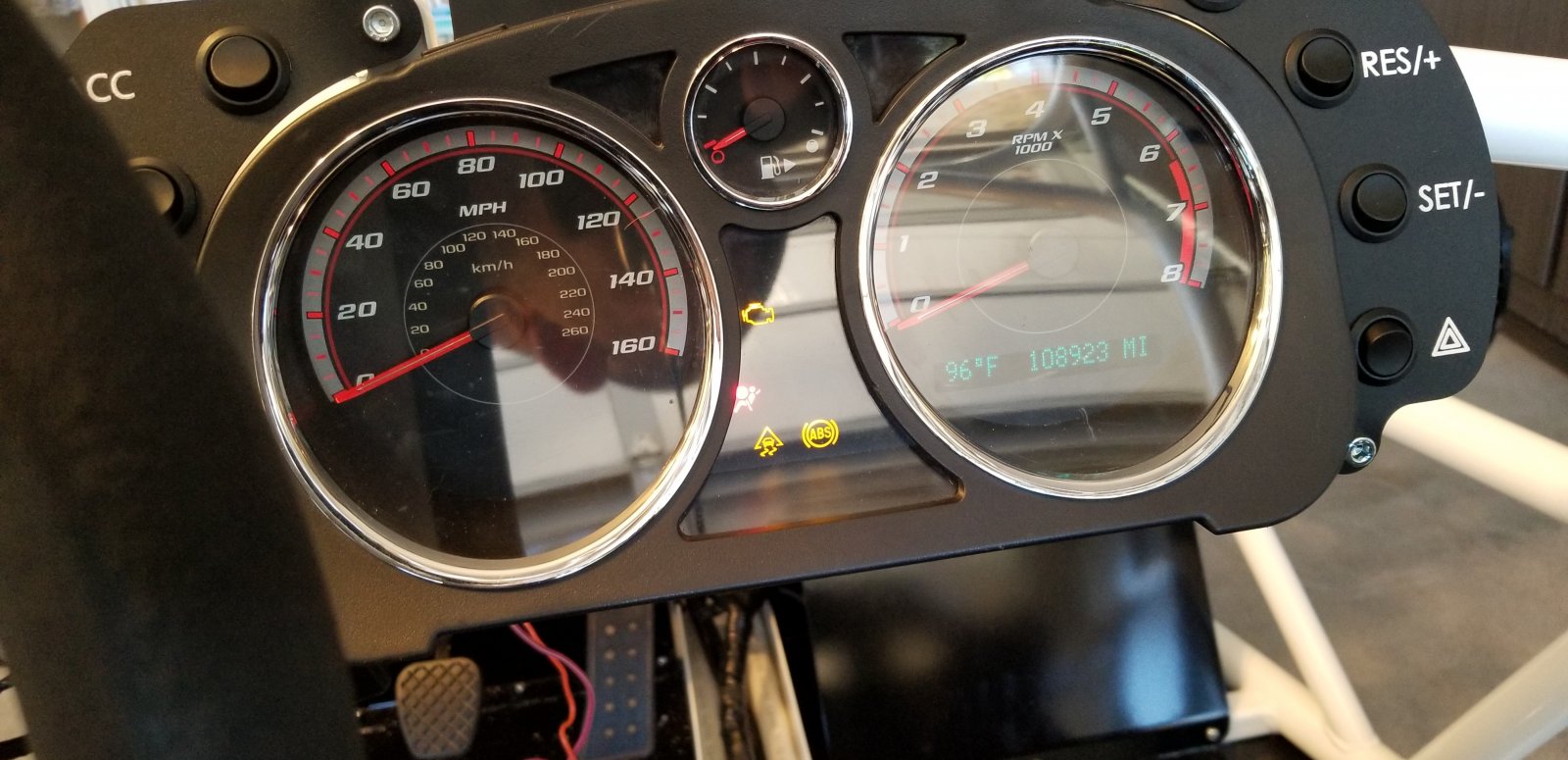

I just severed those leads. The low pressure light is on, but the others are gone. Did I not get one all the way?

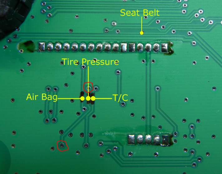

They are hard to cut all the way through. You might not have cut it completely. You might try using a meter to ohm out the connection between the two closest through holes.
Check with an ohm meter between the two holes marked in red. It should be an open circuit.
